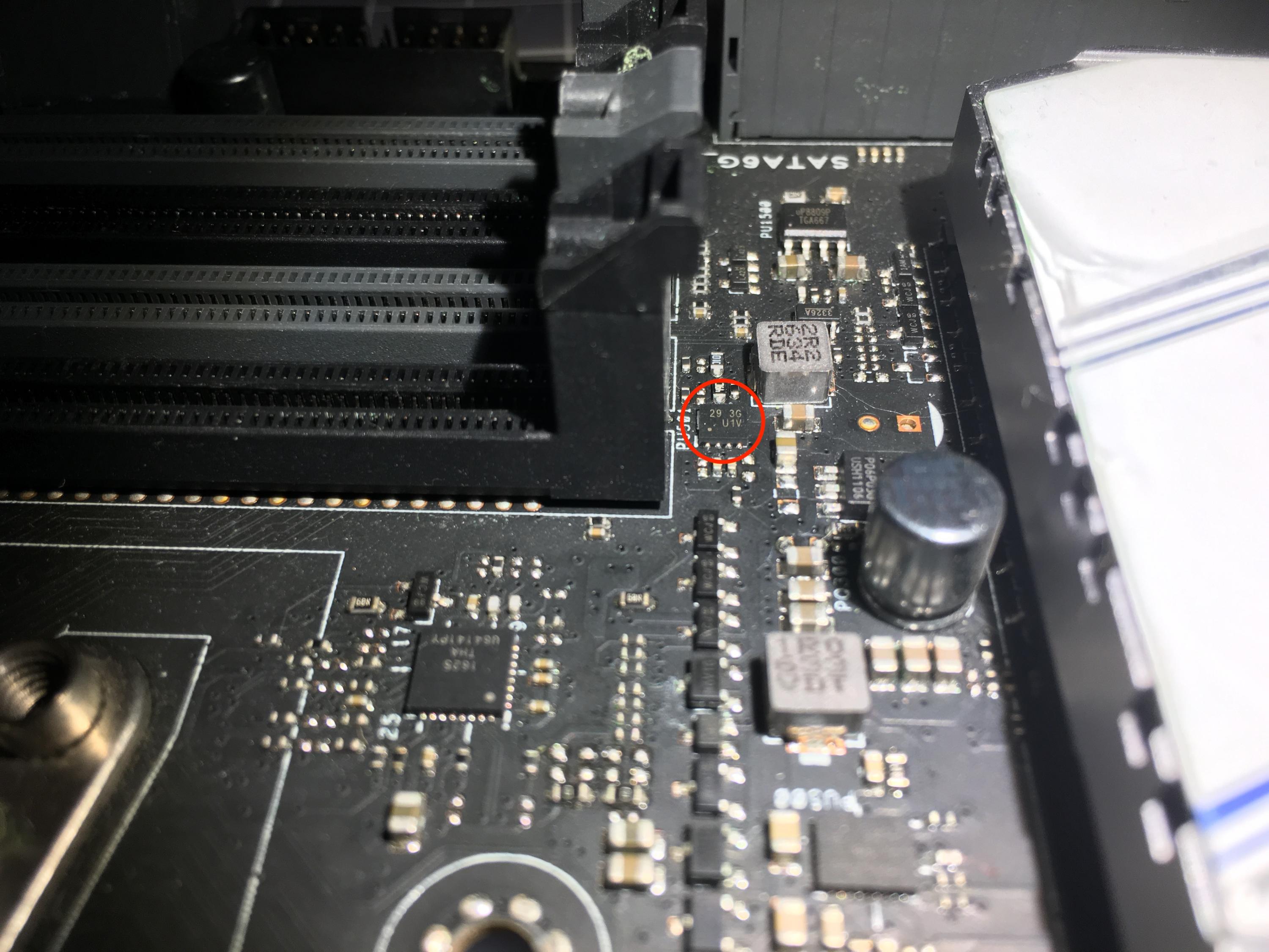

    I have an Asus X99-a II board that has been my main computer for a few years now and I would like to continue using it as I cannot afford to move to a newer platform and it still serves me well.
    Here's what happened. I had a leak in my house a few weeks ago, and my guess is that a few drops of water fell on the chassis and found their way to the motherboard, either that, or the board just decided to die on me now but the coinsidence is too high to be ignored. I had used it prior to the leak and it worked just fine, then I turned it on last week and the following happens since:
    The board will light up for a second or two, code 00, then switch off. Every few seconds it will try to turn on again, same results.
    I removed everything, tried with/without memory sticks, CPU, GPU, same result.
    I inspected every cm of the board, there is nothing visibly wrong in it.
    There is an 8 pin IC that sits between the X99 chipset and the right-hand DIMM slots that gets very warm, almost too warm to touch, its marking is 29 3G U1V(photos included).
    I know it's a long shot, but is anyone familiar with this or can guide me on how to solve it?

    Re: Asus X99-a II Short-circuit
    Richtek RT8065ZQW

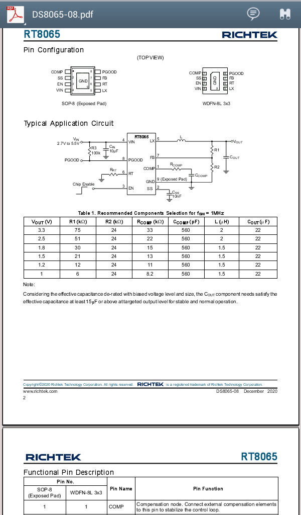

      Thanks a lot for your reply, I'm sure this will be useful for many things in the future
      I went through all the Richtek PDFs found in that post, but found none with a 29 marking code.
      I put 29 in the cross-reference tab at Richtek's site, got nothing, as it needs at least 3 digits. I added a 3(the first digit from the rest of the code on the IC which should be the date and therefore should not be used) and got LM2936 as a result which at least is an 8 pin IC but definitely wrong. I desoldered the IC and it has an exposed pad where GND is, none of the side pins are GND btw.
      Any ideas how else I can look it up?
      Thanks again.
        Google:
        "29 YM" "Richtek"
            "YM" is the placeholder used in Richtek marking information for datecode "Year Month".

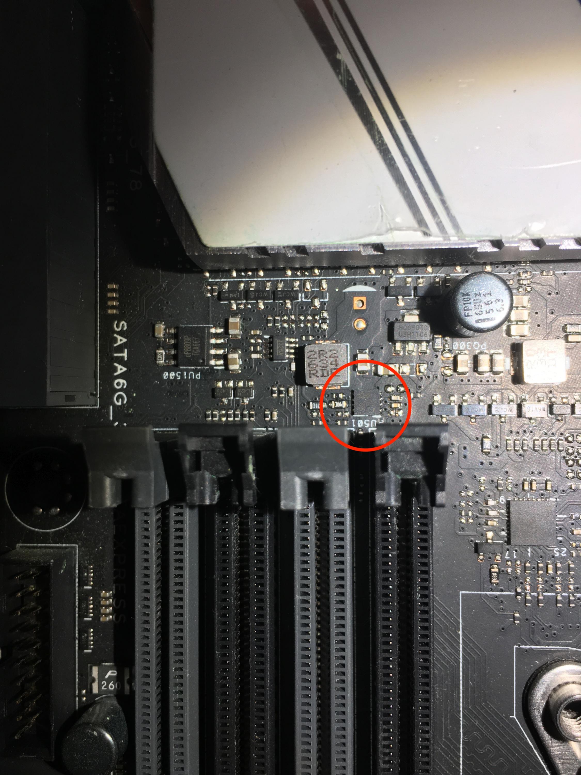

                  Maybe somewhere near that chip there is short circuited capacitor or other component. Did you checked them with mutimeter?
                  • petrosssss
                    • Oct 2023
                    • 10
                    • Greece
                    There is a possibility that the 2 capacitors in the photo need to be replaced, but I have no way of knowing their value(don't have a capacitance meter, Ohm meter shows they are open). If you can get your hands on a schematic(couldn't find anything) and get their values I'd be happy to replace them and see what happens. The rest of the components are so tiny that I'd never be able to replace.

                      The caps is Cin 10uF and Cout 22uF, but if you measure it open then they are probably good.
                      When you replaced ic, is it still heating up or not? Have you check for shorts with multimeter while is ic out?
                      What is voltage on pin 3, 4 and 5 of ic, does it work now?

                            Disconect from power and wait few minutes to discharge. On multimeter set resistance mode and measure resistance between ic pin#5 and ground.
                            If you trace R1 and R2 divider from schematic, you can determine output voltage from included table and see or calculate if 1v is correct output.
