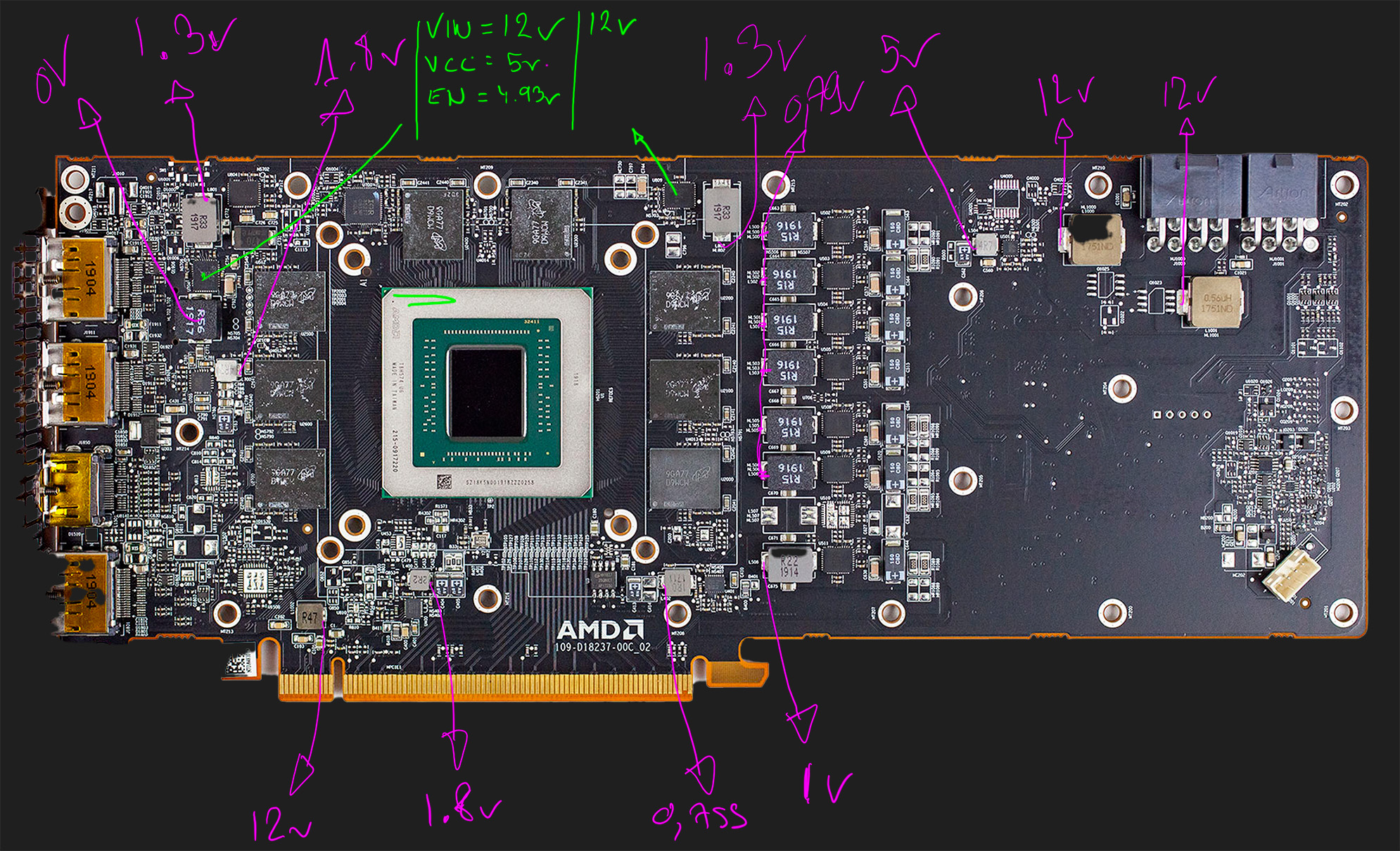

    I am trying to fix a rx5700, please find attached some measurements.
    The VDDCI coil has 0V (I presume is the VDDCI, I haven't a boardview or schematic.
    Both mosfet (green data on lmy picture) have the same exact voltage.
    If you can help me to find the issue, i am pretty new to this kind of stuf.
    Thanks and sorry for my english, I am not native speaker.
