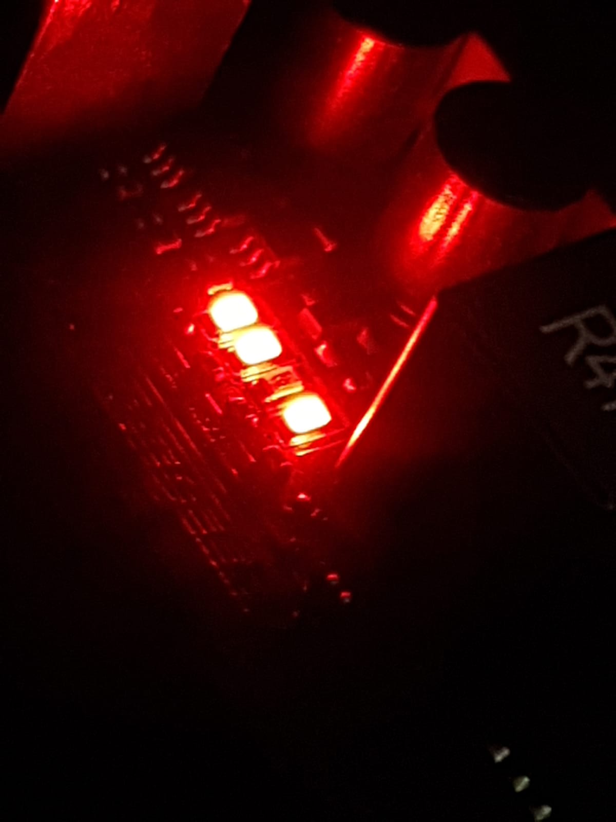

    It does not have any display, no posting, no bios. After pressing power on, cpu fan starts and led on motherboard lights on.
    All the 4 debug led for cpu, gpu, memory, boot are lighting on also.

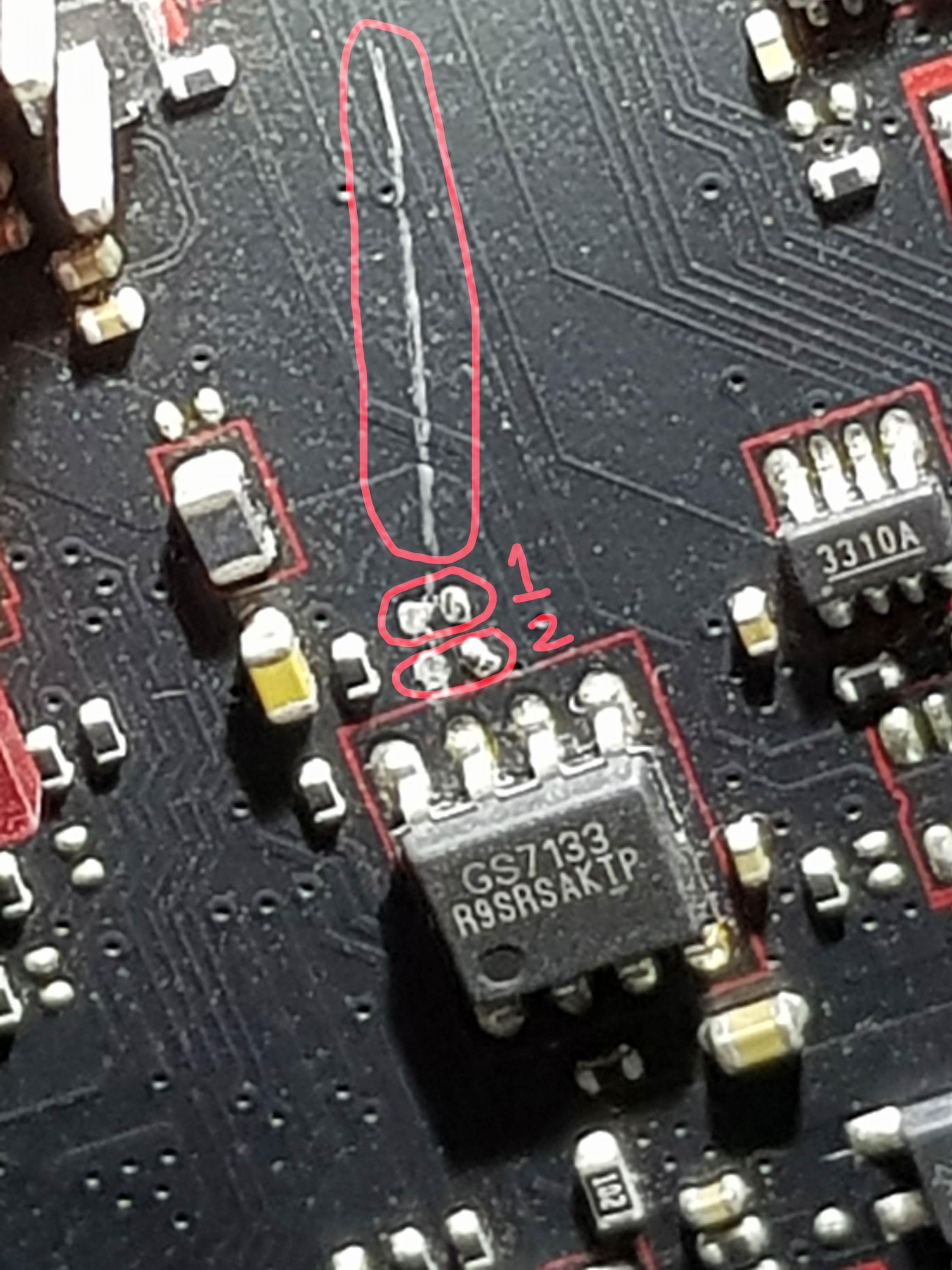

      Update:

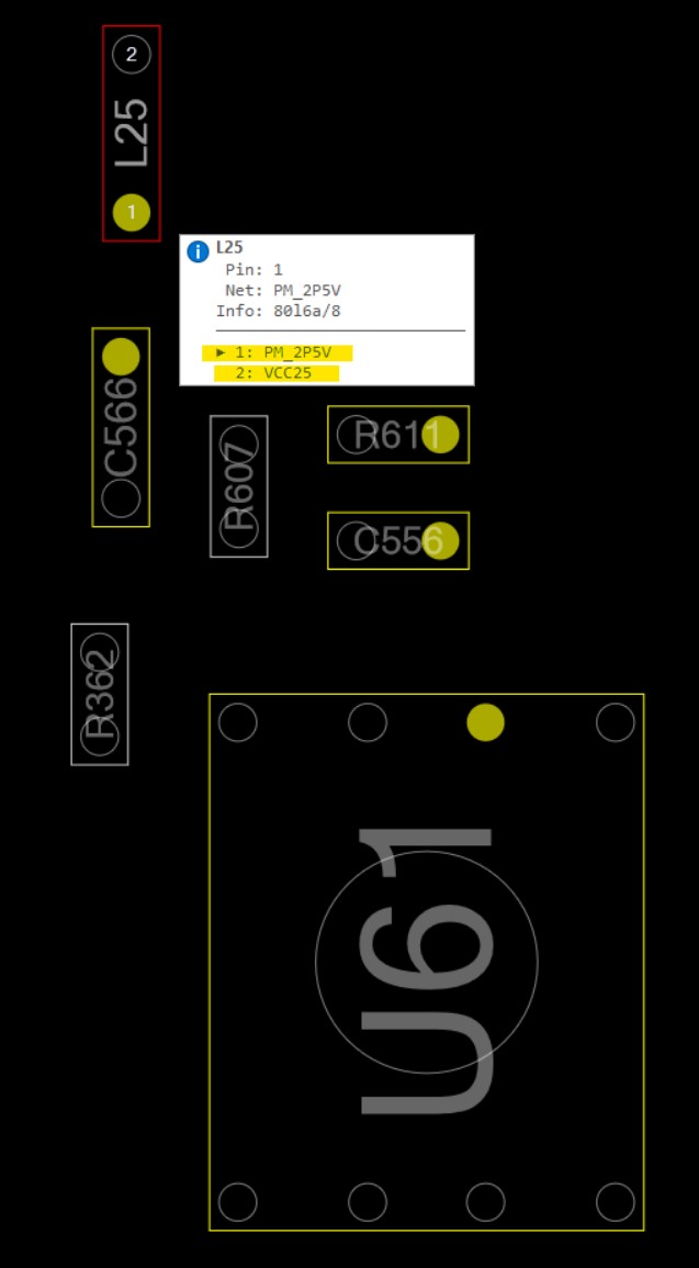

      I dicover from the above list of "L" values compare to what is mentioned in Boardview file, it seems that "L25" which i measured as 3.307v should be 2.5v instead.
      Also I noticed a scratch on the board and some weird shape solder pads. On the boardviewer file, these pads should reside a resister R611 and a capacitor C556.
      I can't recall how and when this scratch happened and I am not sure if these 2 components were there in the first place.
      It would be really helpful if anyone owning this same board check if these 2 components are on the board or not?
      I wonder what these components serves and how much do they affect the overall function of the board.
      Any advice on fixing the board would be appreciated.

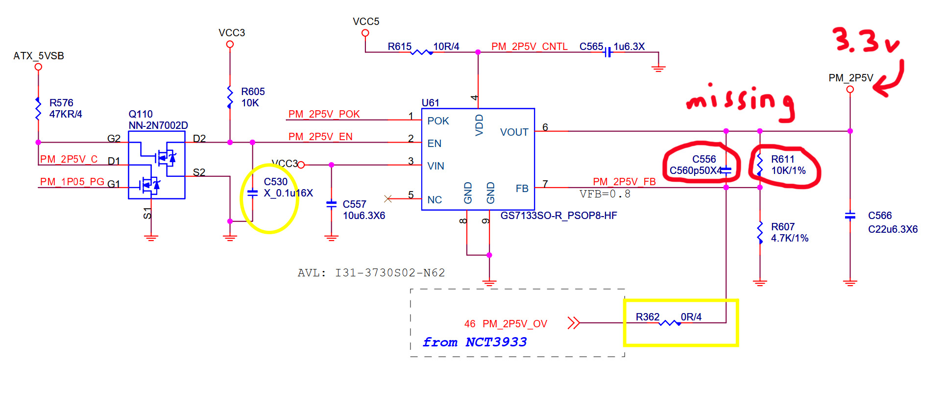

        Re: MSI B350m gaming pro motherboard
        Looks pretty important to me: https://cdn.badcaps-static.com/pdfs/...abd2305ab8.pdf
        Values should be in the Boardview?
        • udonome
          • Jul 2023
          • 14
          • United Kingdom

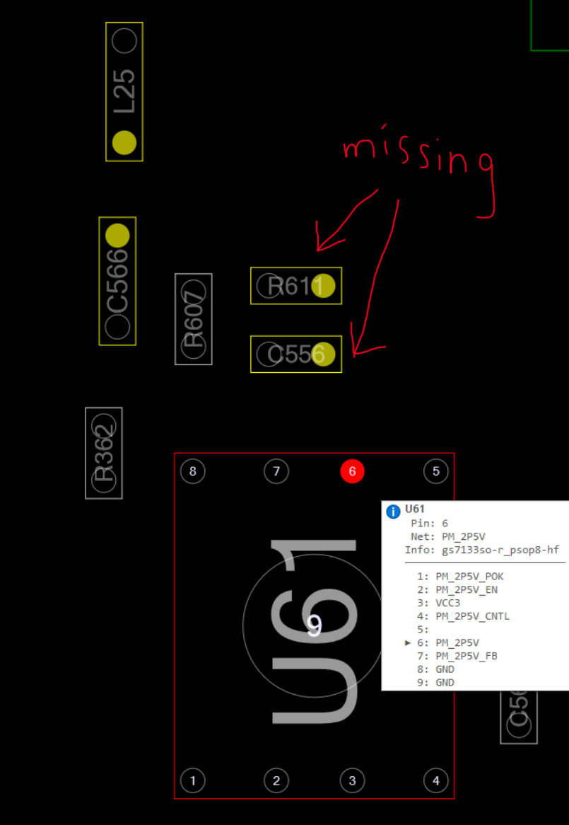

          In the boardviewer file, it describes pin 6 on the Linear regulator GS7133 as "PM_2P5V" so i assume it should be 2.5v constant output. And this goes to L25 which then goes into the AMD A320 chipset.
          But i am totally new so i may be thinking wrong.
          1. What i don't understand is why my pin 6 output is 3.3v instead of 2.5v. Is it because this linear regulator GS7133 is faulty?
          OR
          2. Are the missing R11 and C556 affecting the linear regulator GS7133 to not properly producing 2.5v output?
          • Per Hansson
            • Jul 2005
            • 5895
            • Sweden
            No 2 is correct, read the datasheet that I linked in my previous post, in particular related to feedback (pin 7)
