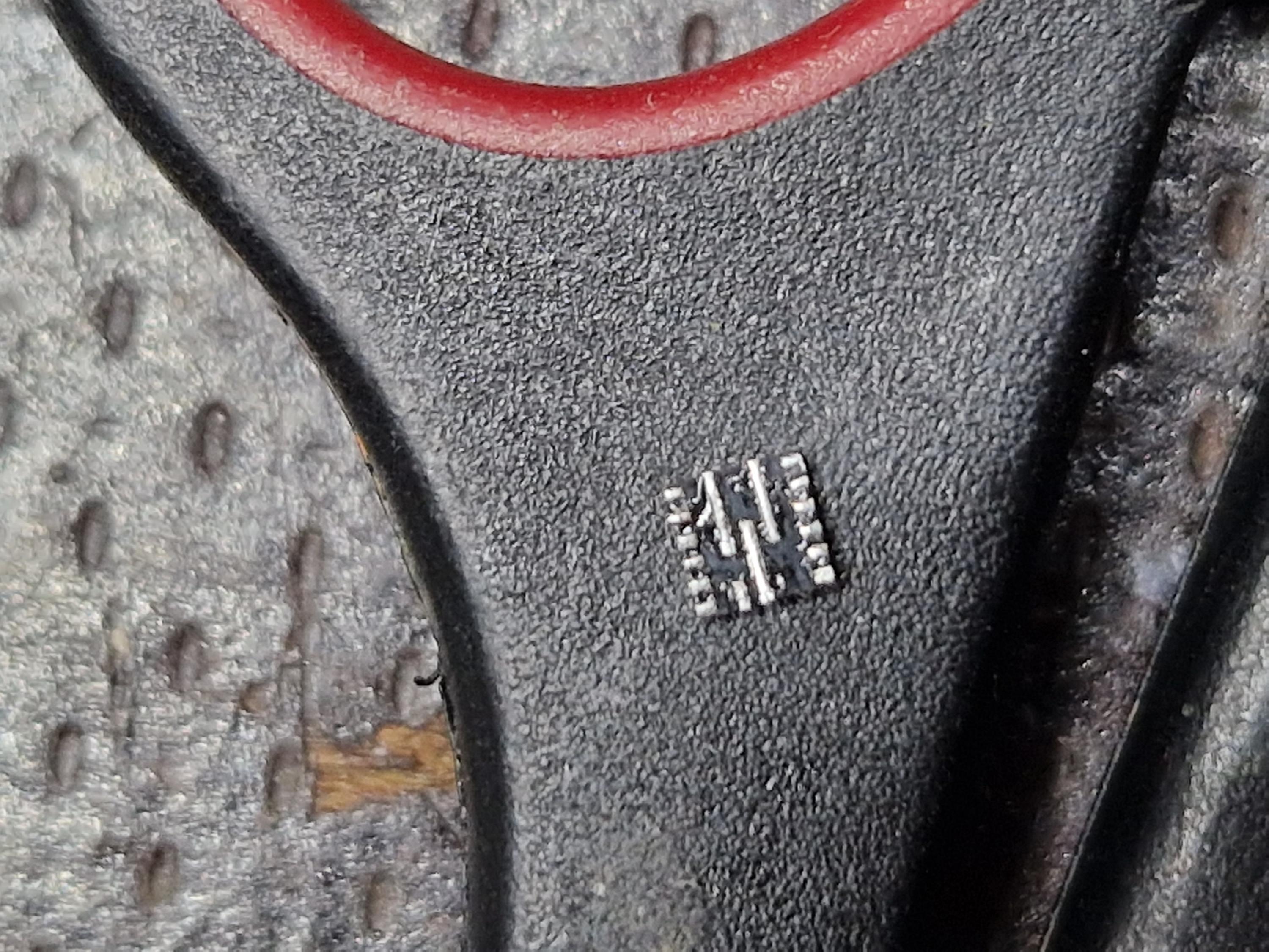

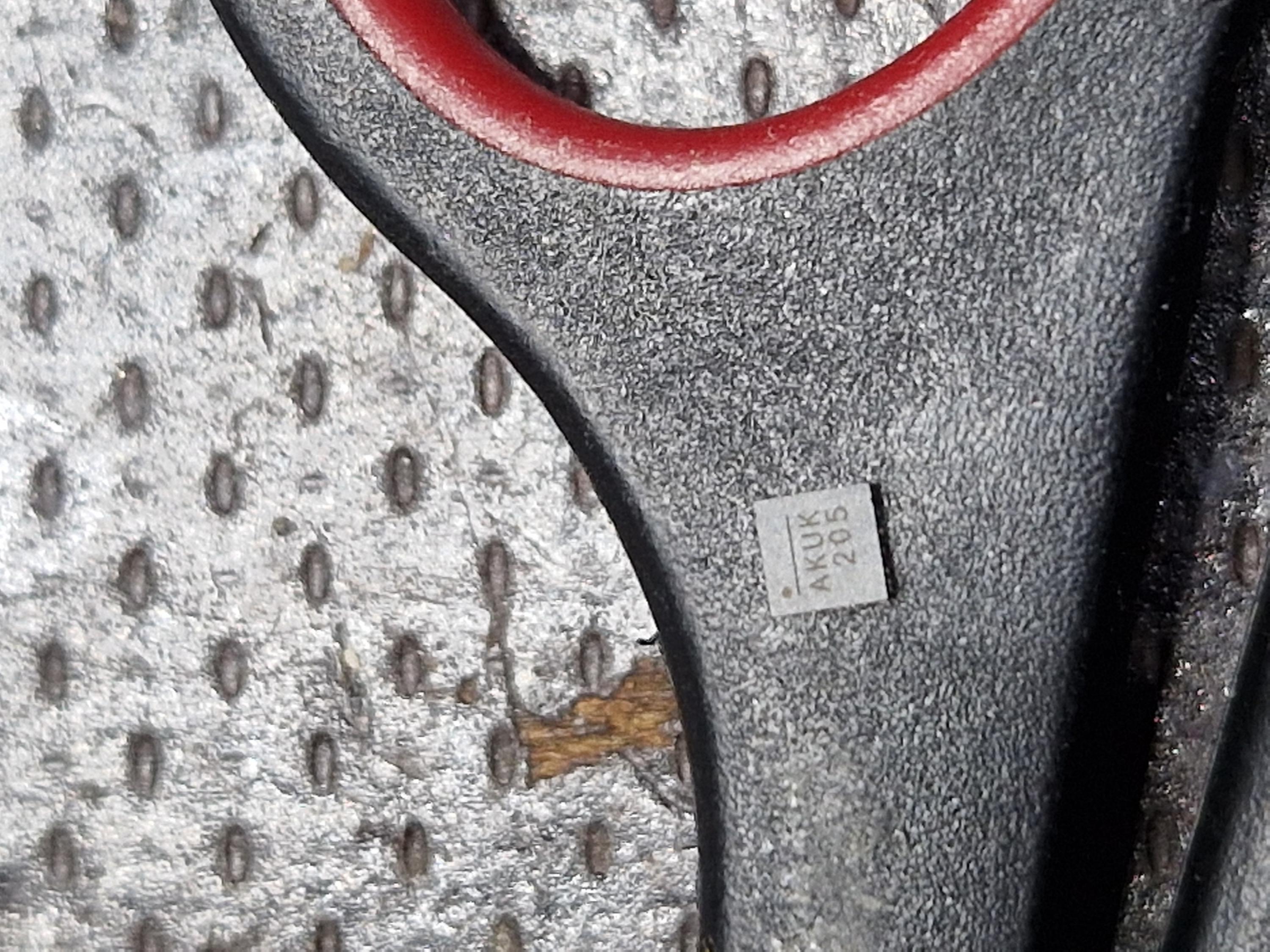

    Hi guys,
    I need your help. I just got an Intel NUC (NUC8i3BEB) that was fried by a bike charger (30V). There's a short on the 19V power rail which I traced down to a chip with "AKUK" on it. I looked all over the internet but wasn't able to source this IC. I guess the manufacturer is MPS (Monolithic Power Systems) but I don't get any further. Any help is appreciated!

    Monolithic Power Marking List April 2022 -> https://www.badcaps.net/forum/attach...3&d=1652723341
    AKU* NB685GQ
    https://www.badcaps.net/forum/showpo...85&postcount=3

      Many thanks!
