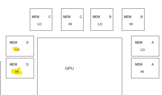

    Working on an MSI 2070 that has mats/mods errors on memory D0. Tried re-flowing with no luck so likely to swap with another chip.
    However, I noticed on a schematic for an MSI 2080 that the D0 is located prior to the D1 spot on the counter clockwise rotation.
    Is this a schematic wrong or do some cards actually not follow the D1 then D0 layouts?

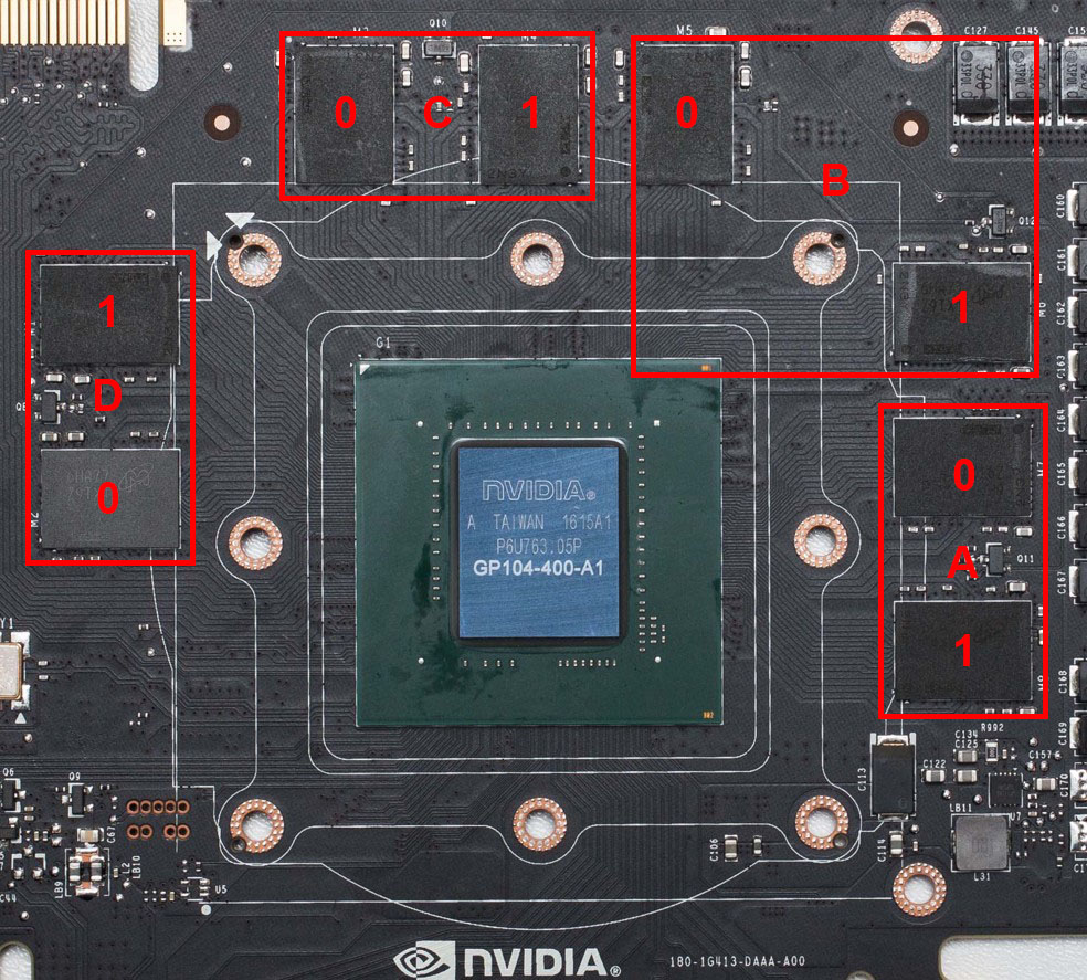

    From my point of view the arrangement of the FB chips around the GPU has not changed. The picture shows the correct layout.

        Thanks for the help. The chips start with 8, so I think this means 18 and likely need replacing. Board revision is 373 v4.0.
        As far as the chip arrangement, was following this image so still confused, but will study it some more.

          I removed what I suspected was the D0 chip, following the usual high low pattern a shown in the picture, and not the schematic.
          The picture and typical high (1) and low (0) pattern is correct. I verified running mat/mods and indeed the D0 chip is missing. Not sure what is up with the schematic.
