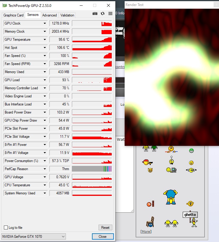

    Ok, so I have changed HOLTEK mcu and now voltage reads are ok, led GIGABYTE is working but fan stop is not. and again I have PWM fan control, BUT Watts are not, thus TDP is not, and it still gets 93ºC.
    I have checked a couple of resistor too high and changed them but same results. I have attached a capture of GPU-Z.
    As TDP is not reached, (still thinking of a sense resistor, but which one?) I suppose GPU is eating more power, until it hits thermal wall, put it does not get TDP limit, so it gets HOT almost instantly....
    The thing is this card was working fine a couple of weeks ago, and it was in a drawer, so I have checked for any phisical damage to any rear component, but the only thing I have changed that helped in some areas was to replace HOLTEK chip, but it is under the heatsink....really weird issue....
