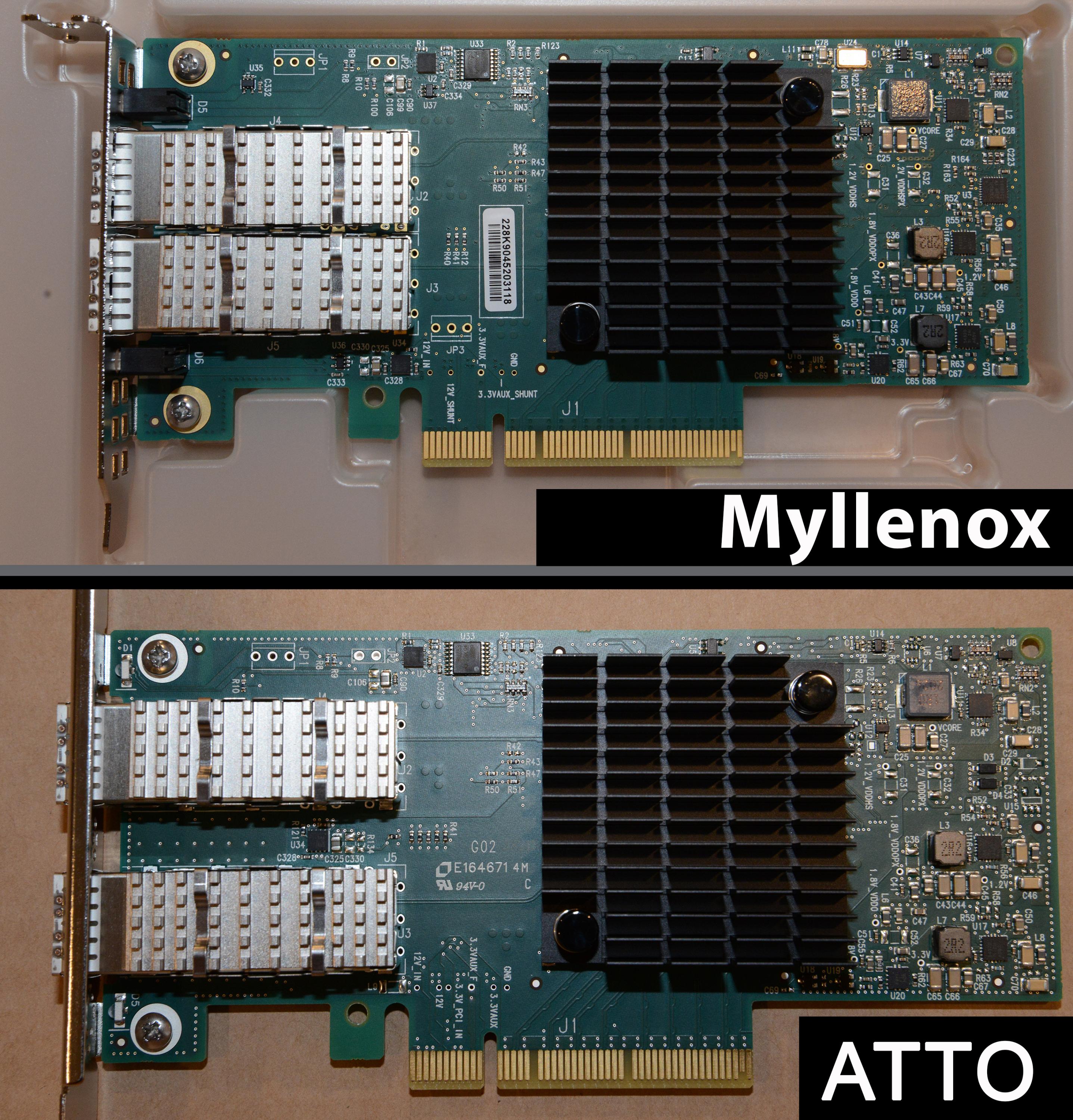

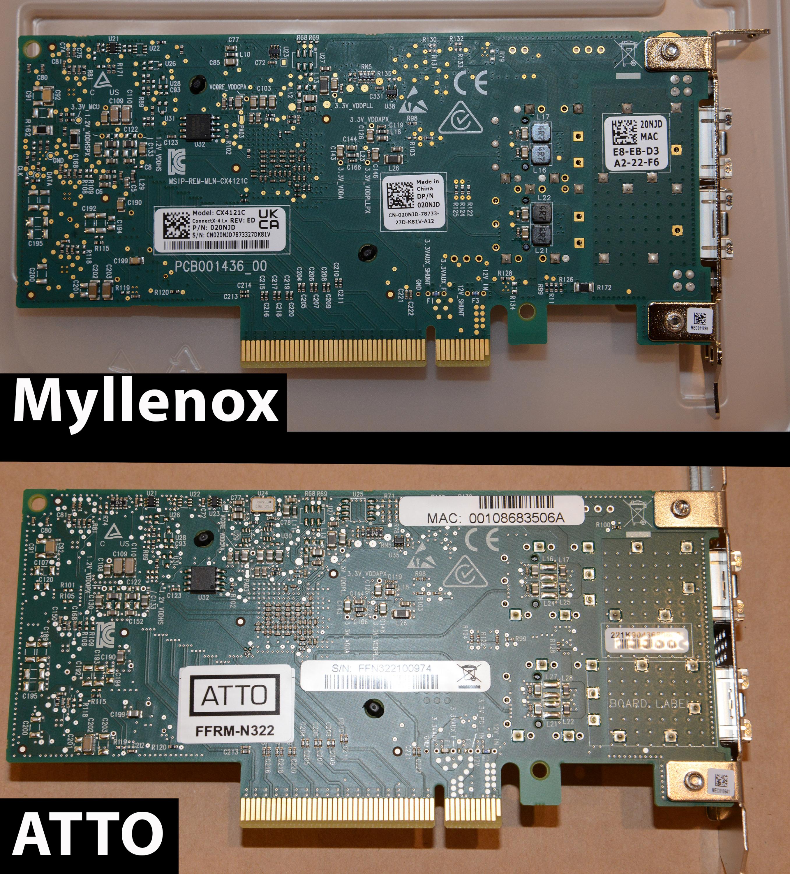

I tried to order the Myllenox model that looked most similar to the ATTO NIC (as the ATTO card [is] a Myllenox NIC with modified ROM). Unfortunately, what looked like (close to) identical board+chip layouts in blurry & stock pictures were slightly different once purchased. Still, as the ATTO has a ROM which lets it get identified by a MacOS ... I wanted to try the ATTO ROM on the Myllenox NIC.
Any reason [not] to:
1. Back up the Myllenox ROM
2. Copy the ATTO ROM
3. Write ATTO ROM to Myllenox & test if the NIC is recognized by MacOS?
4. If anything doesn't work, just revert the Myllenox ROM back to factory..?
Myllenox ConnectX-4 LX CX4121C // MCX4121A-ACAT, Dual Port, SFP28
ATTO NIC Model: N322, Dual Port, SFP28

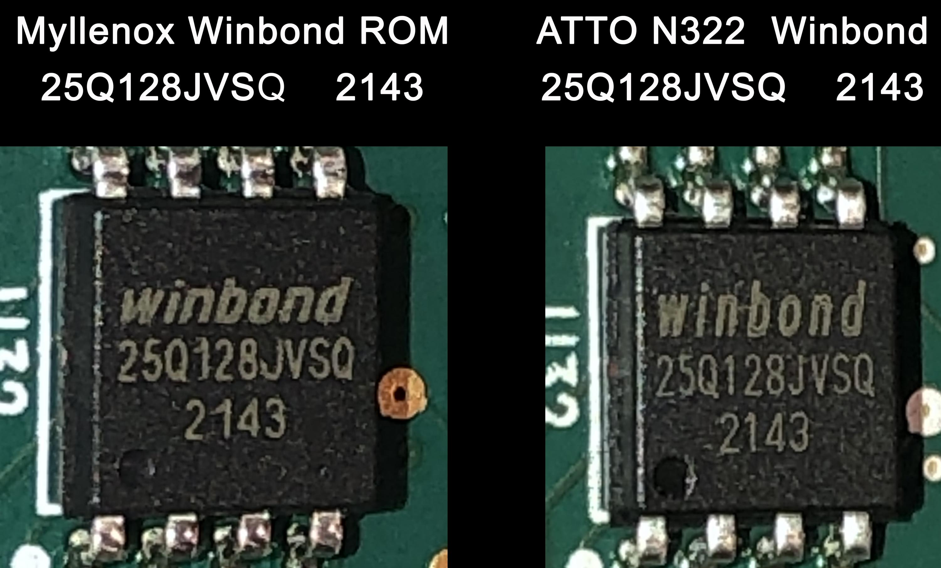

Attached pictures are actual pictures including the (identical) ROMs.
Both ROMs are: 25Q128JVSQ 2143
