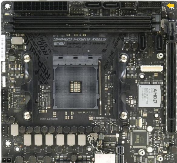

    Hi!,
    I'm missing two adjacent resistors what it seems to be USB Vbus detector line. New ones are easily soldered, however resistor values are mystery. Anyone knows or having similar mb on hand to check, thanks!
    A Pic included, resistor pair is upper right corner.

    Upper resistor 4.7K OHM 1/16W (0402) 1%
    Lower resistor 8.2K OHM 1/16W (0402)1%
