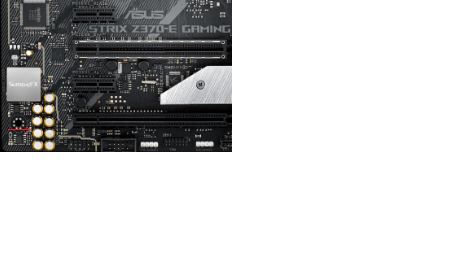

            Update:
            For some strange reason the board is now booting. As mentioned before, I had 3.3v at the two power pins.
            After some reading & watching YT, I believe this is the start-up process:
            When the power button is pressed, which momentarily shorts the pins, the 3.3v should drop to zero because the pins are being grounded, and a signal is then sent to the Super IO chip to power up the PSU & boot up the board. If the voltage doesn't drop to zero then no signal is sent and the board won't power up/boot
            I checked to see if this was happening, which it wasn't. I then bridged the ATX green wire to the ground pin of the boards two power pins. The board kicked in to life, but at the same time I noticed a tiny capacitor start to glow red so I quickly turned the PSU off. Since then the board boots up but the said capacitor doesn't glow red but gets too hot to touch.
            Would this indicate a short? I've arrowed it in the pic. The tiny one left of the round ones.
            Regards
            Ian

              It's now your skill to catch the culprit .. Look for , on its rail nearby resistances , a heating mosfet , or if there are a schotky diode and check if any of those electrolytic capacitors was lifted from one of its legs by accident ..Those are my first guesses .

                Re: Asus Z370-E (Dead)
                ... check everything else, but ignorring red glowing capacitor?
                  That one is already toasted ..Why should he check it ?
                    Maybe because:
                    "... but the said capacitor doesn't glow red but gets too hot to touch"
                    So, it is not yet dead.
                    Maybe the glowing one has burnout pcb... inspection is needed.
                      Maybe because:
                      Its value has changed definitely .I recommend changing it anyway .
                      When he changes it , of course he knows how to solder and I know he's capable.
