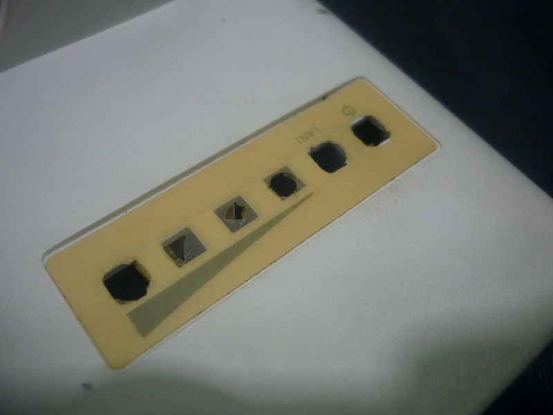

    I have a LocoM5 unit, water came through the holes of the LED diodes.
    The unit does not turn on but a buzz is heard.

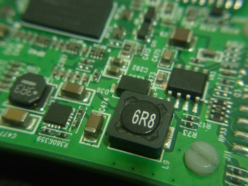

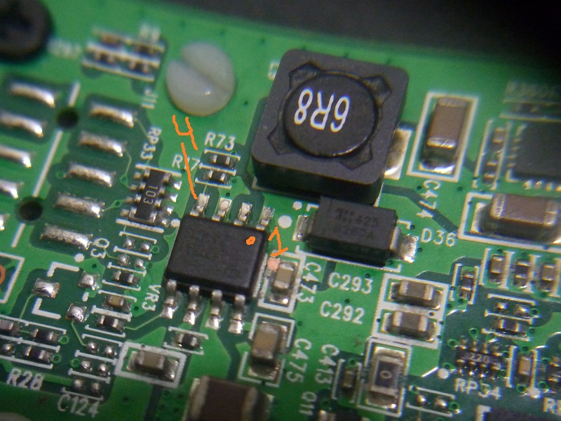

    Check the integrated circuit: VR3 AOZ1212. The output voltage on pin 1 is 1.69vdc when you touch the pin4 with the tester, the power led and the buzzing sound frequency change were turned on.
    Interestingly, if I put my finger on that pin, the unit turns on the led, the voltage goes up to 4.9 vdc. and the buzz stops being heard.

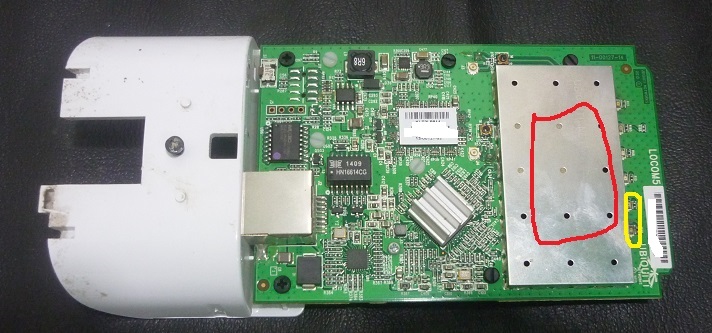

    The signal LEDs remain off. In that zone, rust is observed. (Yellow Zone)
    I measured the voltage at C91 and C92 and it's 4.52vdc. (area protected by metal mesh) (Red Zone)

    How to test the chips that are inside the maya, red zone
    I measured continuity between both pins of the antenna and it shows resistance close to zero (1 ohm approximately antenna vs gnd), however, I have a Crazy M2 unit and it marks the same, can I assume that this is normal?

      Take the IC and the 2 caps above it off the board and clean the board with alcohol. Take the old solder off and resolder the taken off parts with fresh solder. See what that does. Other than that you can try to replace the IC. Usually antennas are DC grounded, so you should measure a short. The 4 LED's on the top on the case are for signal strength, then there is LAN activity and a power LED.
      I think you have a problem with the feedback circuit. Probably something is corroded.
      datasheet: https://cdn.badcaps-static.com/pdfs/...7072def78e.pdf
