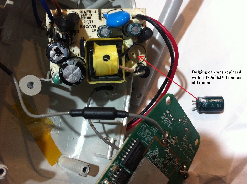

    This thing showed no signs of life when plug into mains. I tested the bulging cap with an ESR meter and it was double the resistance. I replaced with a 470uf I had lying around. The space is confined inside this unit. the 470uf was the smallest with higher voltage I had on hand...it worked! I am including a pic for anyone else that runs across the DEAD unit. It is an easy fix
