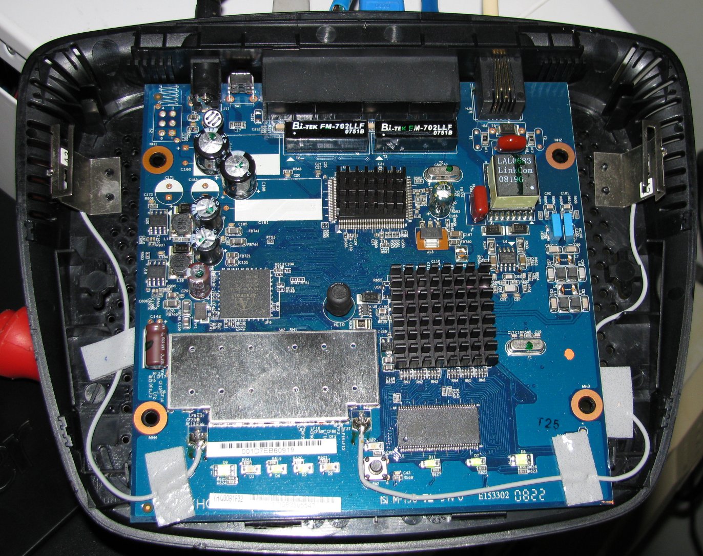

    I found that a Linksys WAG160N would keep randomly losing its Internet connection (and access to configuration pages) on the wired Ethernet ports (Internet connectivity of the wireless section was OK even when this happens), of which required disconnection and reconnection of power to temporally fix this problem.
    Upon opening, it revealed the following electrolytics:
    C165: 12V (Teapo SC - bulging near wired LAN switch IC )
    C186: 1.8V (Teapo SY - not bulging)
    C187: 3.3V (Teapo SY - not bulging)
    C188, C189: DC input (Teapo SY - bulging)
    C142, C143: 1.8V (Chemi-Con KY - OK)
    Replacing all of the Teapo SY and SC series units fixed this problem.
    It was rather hot inside this unit too, like a number of others as well.

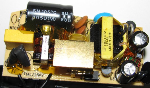

    An update:
    The modem works, but still has some intermittent problems.
    So I decided to open the AC adaptor and found that it also had bad electrolytic capacitors (Luxon LZ Series before and after the output inductor; the one before it was bulging). The other two were Luxon SM Series.
    Fortunately, I was able to seal up the adaptor after replacing all four electrolytic capacitors.
