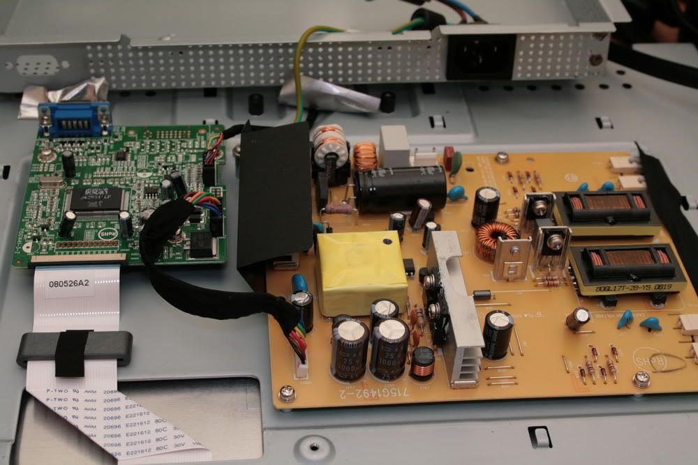

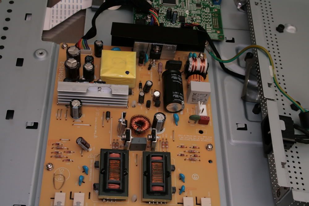

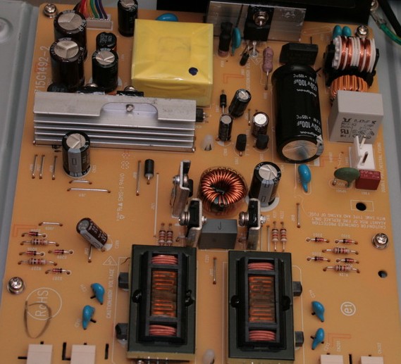

    Hi all, I'd like help in determining whether this issue is likely due to bad caps or not.
    Hardware: Lenovo ThinkVision L191 (19"), black, from 2nd-hand shop.
    Symptoms:
    • The monitor switches on and the ThinkVision logo appears on screen, but only for less than a second, then it goes blank (led stays on - not sure if it's green or changes to yellow - I'm a shade color blind!).
    • Similarly if I hit the function-F4 thing on my laptop, the desktop appears on screen for a moment then disappears again. Similar behaviour on multiple PCs.
    Could that indicate a bad-capacitor issue? Here are photos from a couple of different angles:

    It looks like someone already tried to recap this because I think I see United Chemicon and Rubycon caps on it? Unless Lenovo spent some $$$ and got quality caps to begin with. When was this monitor made?
    What you are describing is "2 seconds to black".
    You can search this forum for what others have done, but it could be a number of things
    1) bad CCFLs
    2) bad transformers
    3) bad PNP transistors (like c5707)
    4) bad caps
    5) poor cold/dry solder joints
    6) possibly something else

      Could the caps sitting at an angle indicate that they've blown? I've recently read that that could be the case.

        If the caps sit at an angle, it could be sign that the "bung" is leaking or bloated on the bottom. Most of the pics show the tops or vents blown, but one monitor I fixed and the caps blown on the top and bottom.

                  To add my $.02 worth, I am especially interested in pictures of the back of the inverter, and the part number of the inverter controller (usually a 16 or 20 pin chip).

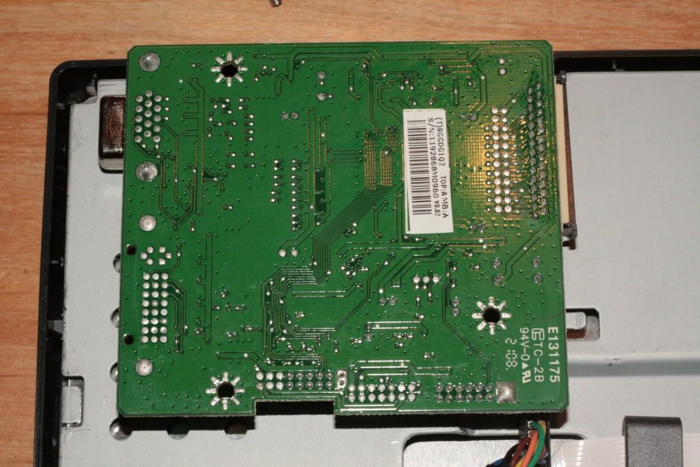

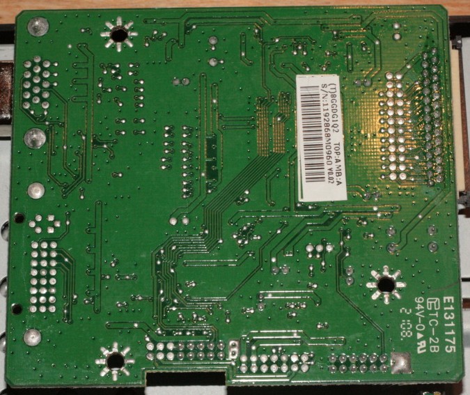

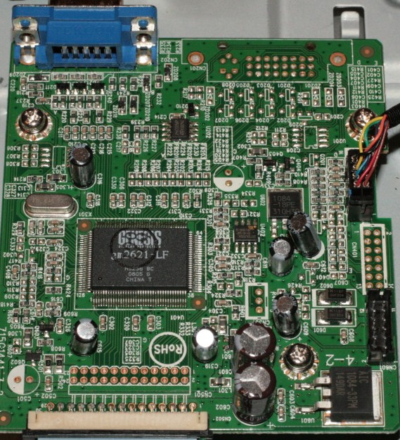

                    Thanks. Yeah, date-wise that seems likely. And yes, the ones which I can see a brand on are Rubycon; the slightly bigger ones near the ribbon cable on the small board don't seem to have branding - though I could be missing it.
                    More pictures below to cover both boards. I'll do some more reading on existing posts. Thanks again for your help.

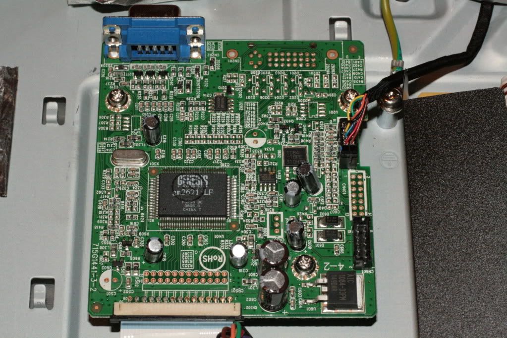

                          Thanks PlainBill - I completely agree. Hands-up and admit that I didn't fully read the forum rules. The picture guidelines are ideal.

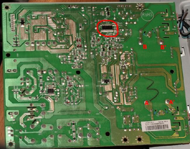

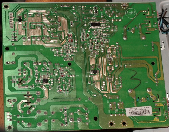

                          Attached are more appropriate images of the front and back of both boards - as clear as I could manage, and I'll follow-up later after I've hunted for the inverter-controller.

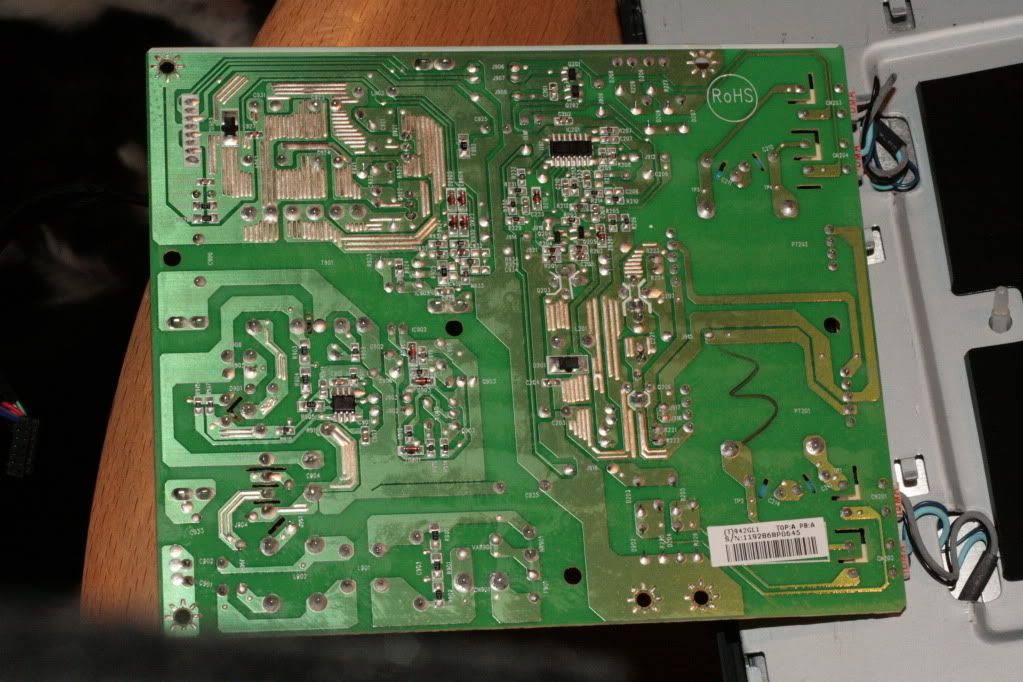

                          Here's the back of the bigger board as that might be of interest:

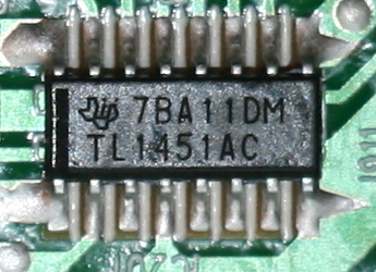

                            The inverter controller is the IC circled in red. What is the part number, please.
                            This design is unusual. It uses two transformers and a Royer oscillator. It does not have an output voltage limiting, so the controller is detecting an open lamp condition. What is the resistance between the points marked A - A' and B - B'?

                              Sorry for the delay - dad/husband duties were calling. That part number is 7BA11DM TL1451AC. Here's a closeup:
                              p.s. - this image is upside-down relative to the big image above.

                                    Did you measure this for PlainBill?

                                      Ah yes, sorry - here's the resistance info PlainBill asked for:
                                      A - A' was 2.28 (on the 20k setting, I'm guessing that's 2.28kΩ ..?)
                                      B - B' was 2.27

                                        That indicates the transformers match to within 1% - good enough. Which probably means either a problem with a return line, or an aging CCFL that's drawing too much current. The inverter controller is a TL1451AC; the same as used in Dell monitors.
                                        I AM going to need a better picture of the back side of the power supply / inverter card, preferably get as close to 2000 x 2000 pixel resolution as possible. We're going to be tracing some circuits.
