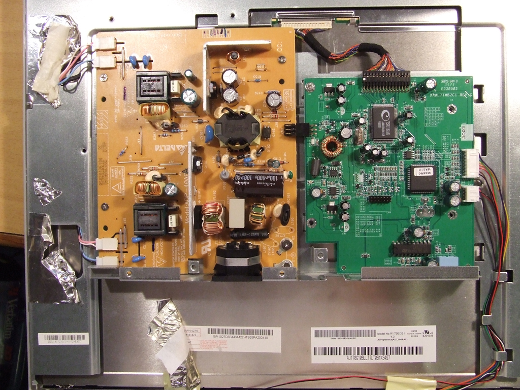

    I have this acer AL1715 S witha a missing Green Signal color, monitor will turn on normally with NO missing color, when menu button press, OSD came out normally with NO missing color.
    But when monitor vga cable plug in a tested OK display card, monitor pic become bluesiest. when menu button press, OSD is perfect with its color, i can see RED, Green Blue at the color setting menu. if i try to set the Green color setting, i cannot notice any changes compare to Red & Blue setting

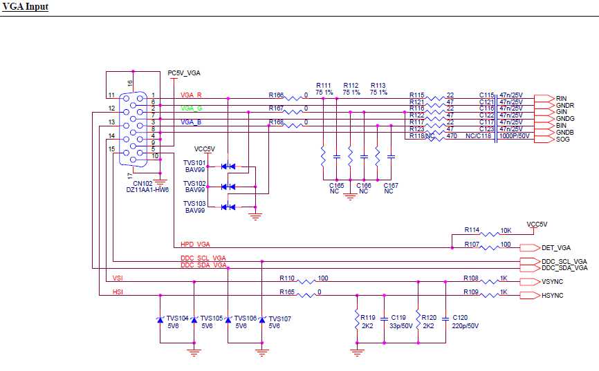

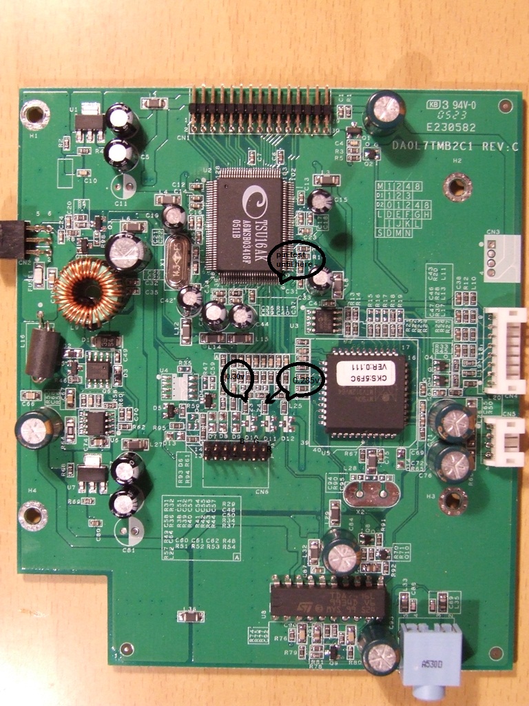

    I have check the PSU board - all seems to be working fine with 3.3v 5.0v 12.0v stable, I also check the VGA cable pin continuity to display board pin that came out tested ok, no broken cable...i have also measure the voltage with signal in ( vga plug to display card ) at the RGB pin on display board with R-0.285v G-0.282v B-0.30v
    i have even measure the reading after the smd resistor mark 0 until the spider IC which came out same reading as shown on the attach picture.

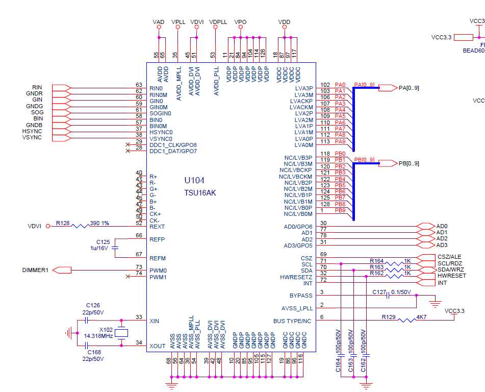

      Your problem is likely on that logic board with the TSU16AK IC. The signal to the LCD panel is no longer RGB. It is digitized. So, if there is no green, then the problem is within this board you have been checking.

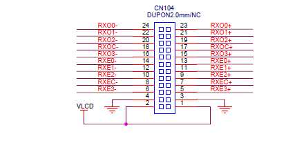

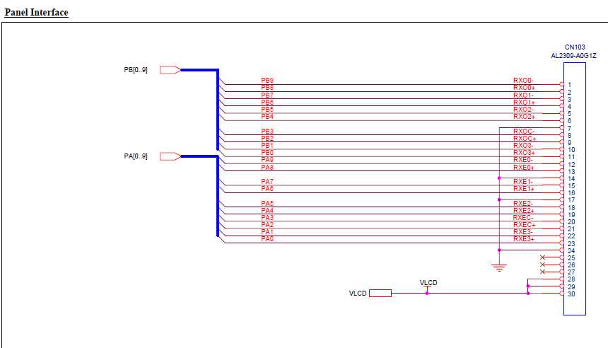

        Re: Acer Al1715
        This might help you to trace it thru... but with just DMM, I dunno....
        • lucky13
          • Aug 2007
          • 412
          Re: Acer Al1715
          OK, there are from a different brand & model that uses the same IC.
          So I think you are stuck...

            thank u retiredcaps & lucky13 for ur input... lucky13 thanks for the pin out diagram... is very helpful, i will try to trace the output signal from ic to LCD panel but i have to agreed with u that most probably this TSU16AK IC is failing, is it posible to get this IC?? & where??
