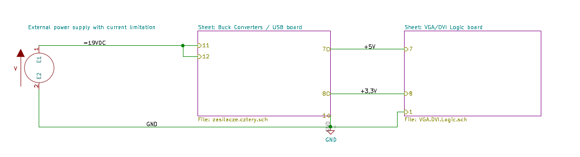

        I did some experiments. The measuring environment is shown in the attached figure. Two boards "Buck Convertes" and "VGA / DVI Logic" connected together, powered by a laboratory power supply with current limiting.
        1. Current limit set to 1A.
        After being turned on, the power supply works in C.C. mode, gives the permissible 1 A from the power supply, the voltage instead of 19V is about 5.5 V. Output voltages are too low. It behaves as if VGA/DVI Logic board has a short circuit.
        2. Current limit set to 1,5A.
        After switching on, the current drawn from the power supply remains at the level of 0.36 A. The 3.3V buck converter is at the correct voltage. There is 0V on the buck converter to 5V. There is no short circuit. Current on the +3,3V wire between board is about 1,8 A.
        I don't understand that very much.

          Here is a test that you can do and it does not require the VGA board
          Take your converter board and use some incandescent light bulbs that are the correct voltage and see if it will work on the 3.3 volt rail and on the 5.0 volt rail if that works correctly then your issue is with the VGA board now if you have two power supply you test this board as well but use an automotive incandescent light bulb which is used in series with board and the power supply and see what your current on each power supply rail is then you will know if you have any issues on either voltage rail
          Put an incandescent light bulb one on each power supply rail if you have a short on a power supply rail that light bulb will be at full brightness [ at the voltage level for example 3 volt will be one brightness and at 5 volts will be at different brightness this is normal results ] ( one note use some incandescent light bulb that have a current draw of about an amp or so { at 12 volts } for best results 1156 or 1157 type of bulb or something similar )
          One other note if you do not have two separate power supply if you have tested the converter board and it functions correctly you can do the same exact test with it put the incandescent light bulb in series with the converter power supply rails and do the same test I referred to above ( one note about this type of test it would not tell you how much current you are drawing on a certain power supply rail unless you have two DVM set on current to measure the current on each rail )
          I hope this helps you with testing these boards

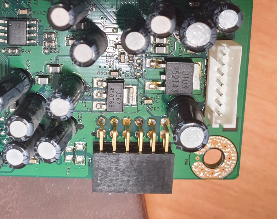

            Thanks sam_sam_sam. I used a similar method and I already know that almost all of this current goes through the 3.3V supply. Current value is about 1,9 A. Just connecting 3.3V power to the VGA board looks the same. On the VGA / DVI Logic board, the voltage of 3.3 V enters two linear stabilizers. You can see them in the photo.
            950T65 works fine. Its output is 2,5 V. But 952T43 not works properly. On his output is only 0,4 V ( Should be 1,8 V ).
            Static measurement with an ohmmeter showed a short circuit on its output line to ground.
            Looks, like I will have to check the items on this path one by one. This means that some SMD components need to be desoldered. It is a difficult task for me, but I will try.
