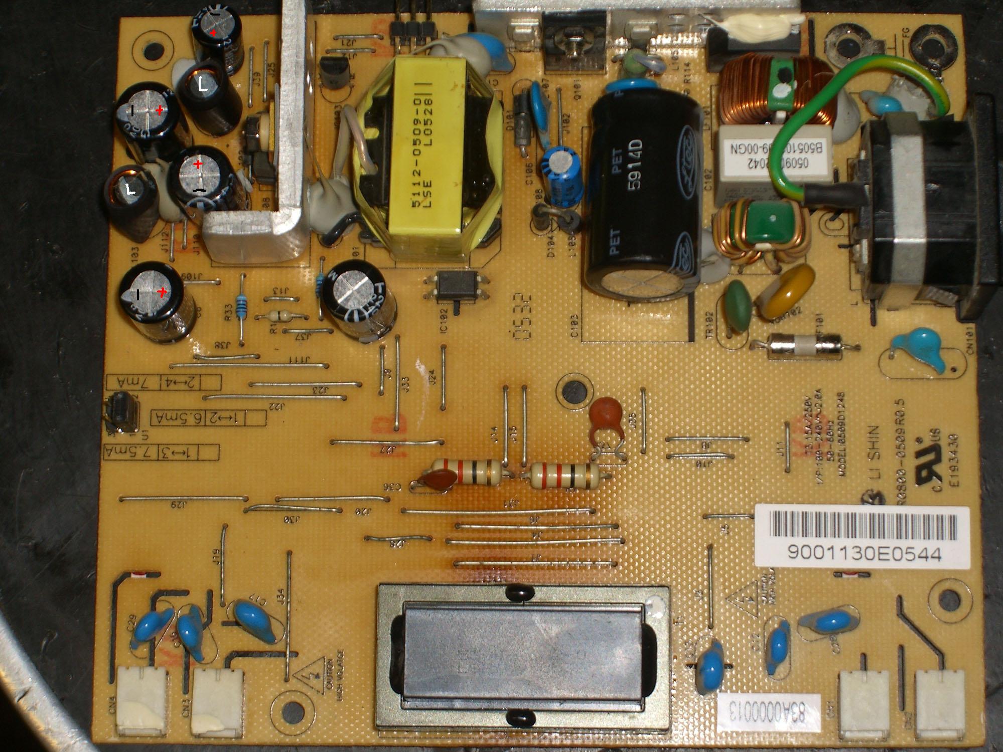

    I'm not sure what it is but it is labeled L102. D108 is what I just took out.
    This boards also has an L107,L105 and L108 surrounding the Filter cap. Not that has anything to do with anything. Just not sure what the "L" is.
    L indicates an inductor. They will measure 0.3 ohms on the multimeter. L102 is in parallel with D108 pins 1-3 (look at the back of the PCB). This explains why D108 was reading 0.3 ohms suggesting it is shorted.
    This is why sometimes, "in circuit" testing, is not reliable. We know D108 is good out of circuit.
    PS. Good job on the pics. It helps a lot.

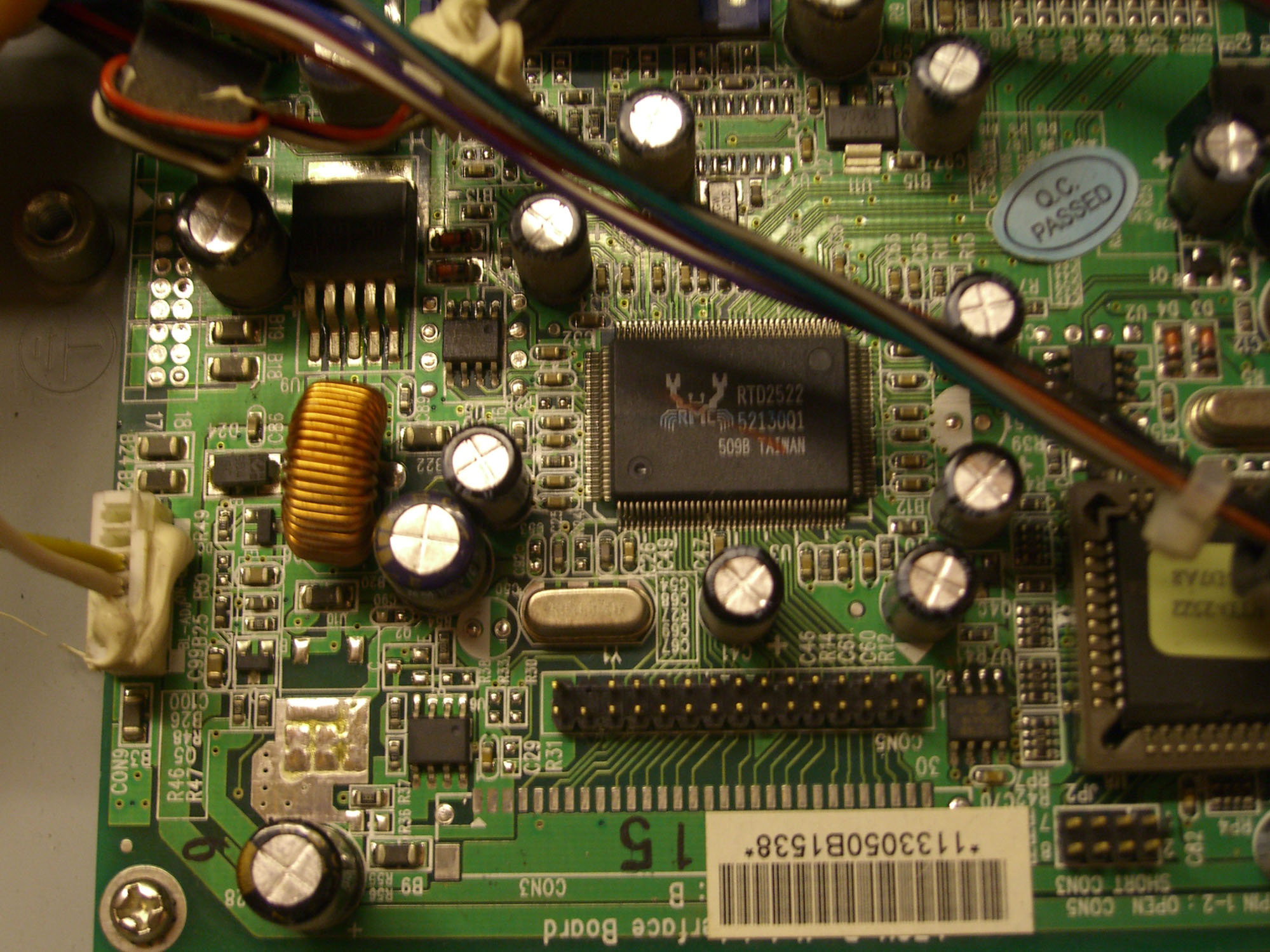

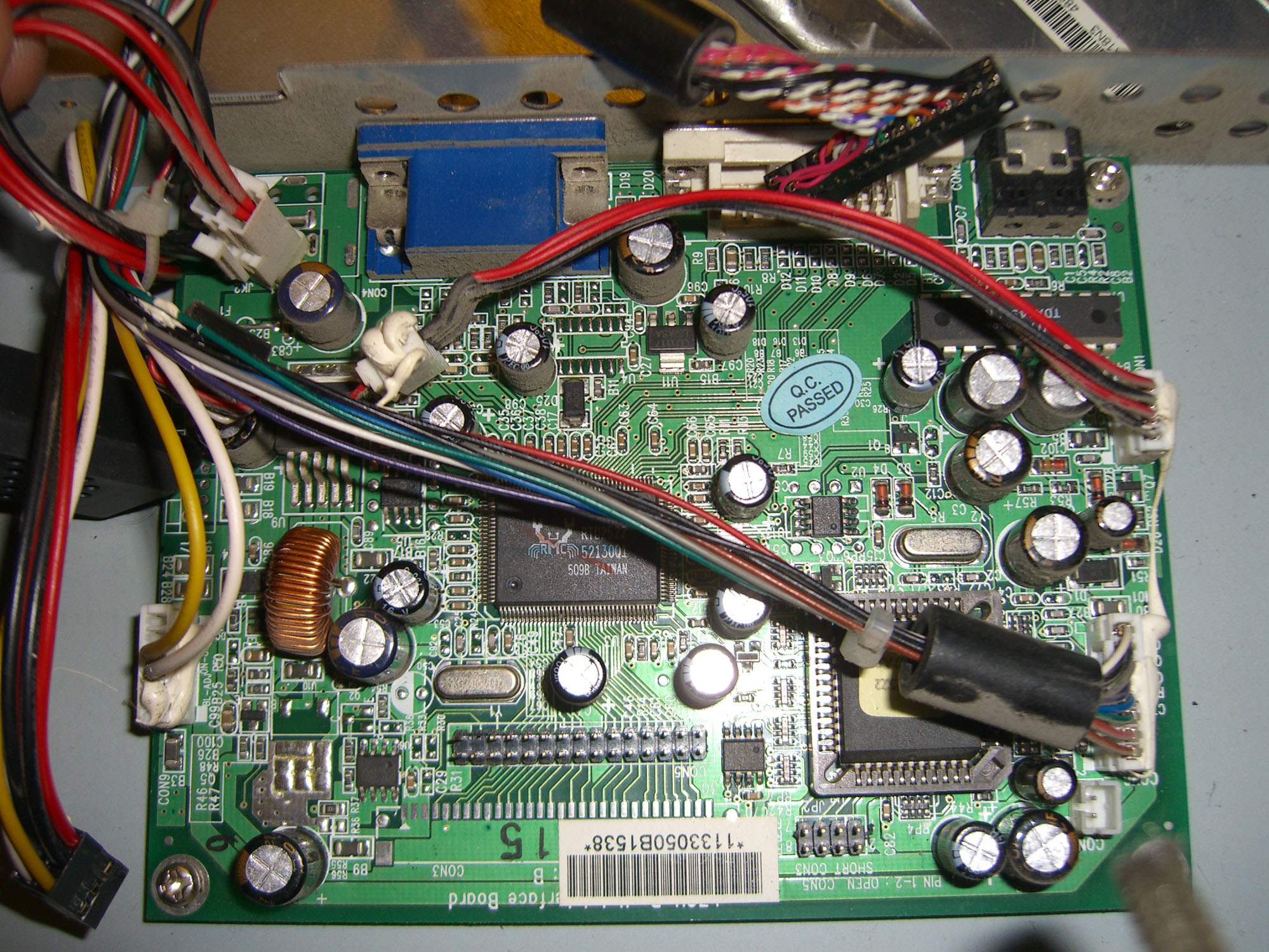

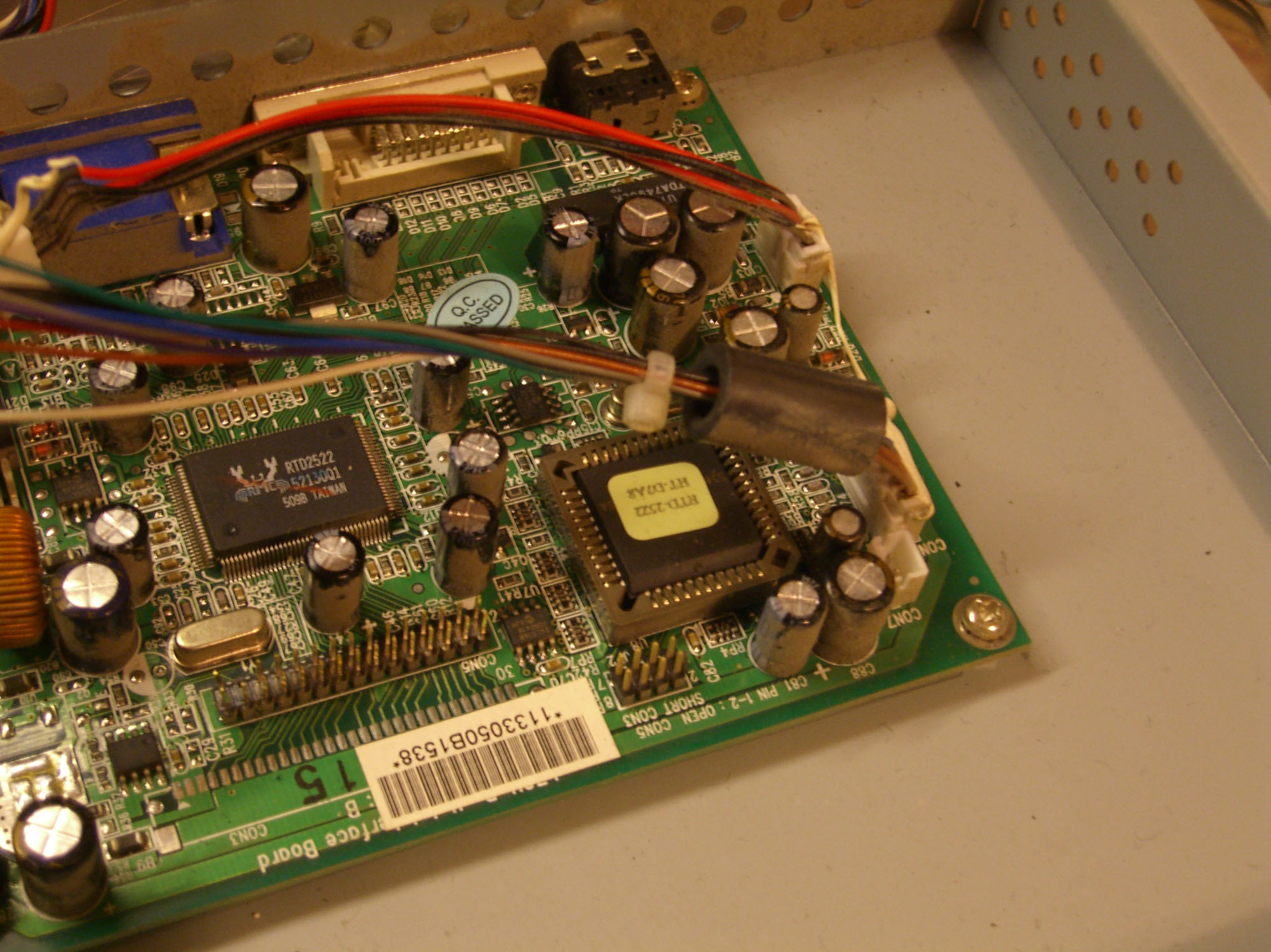

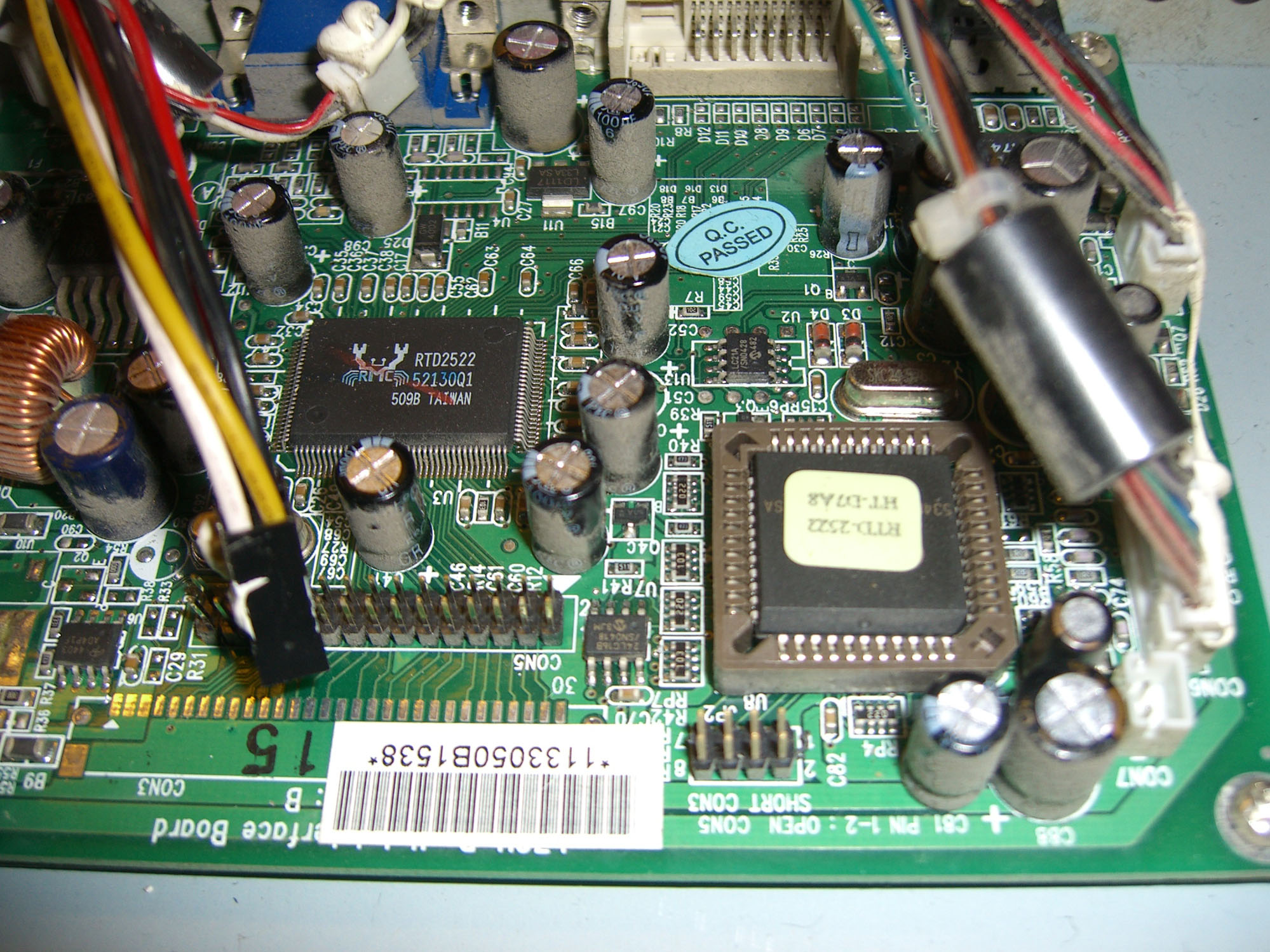

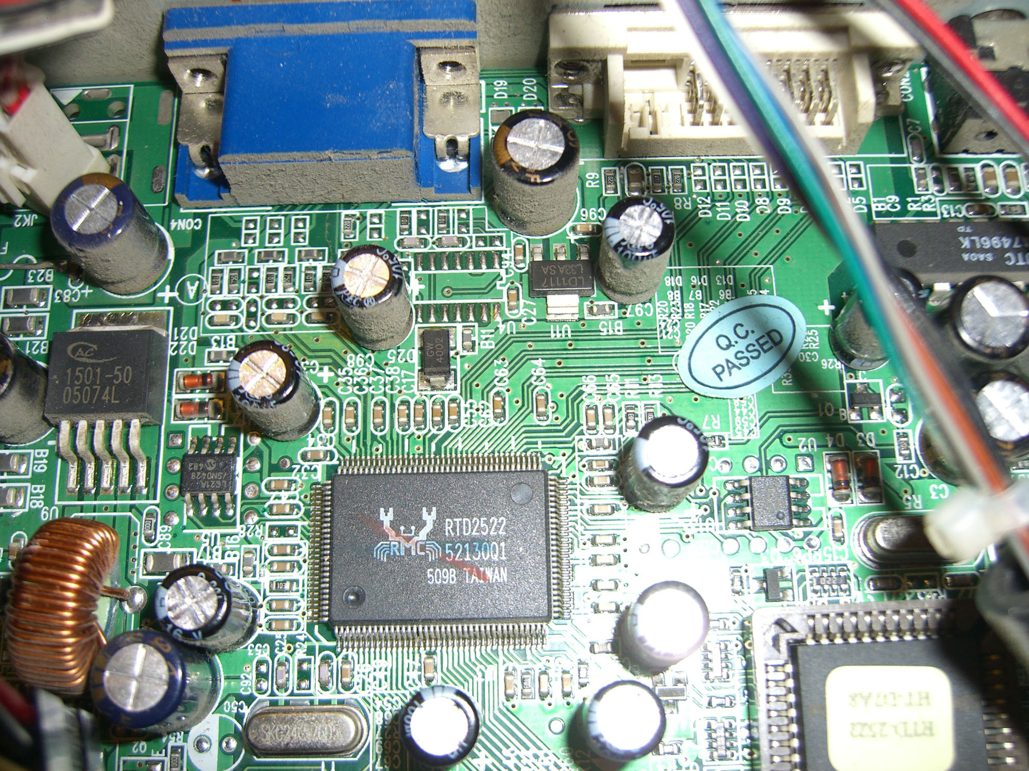

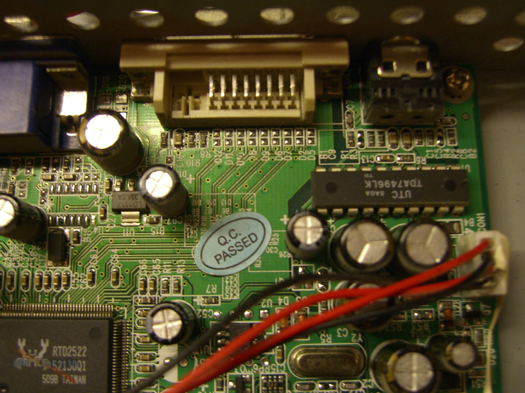

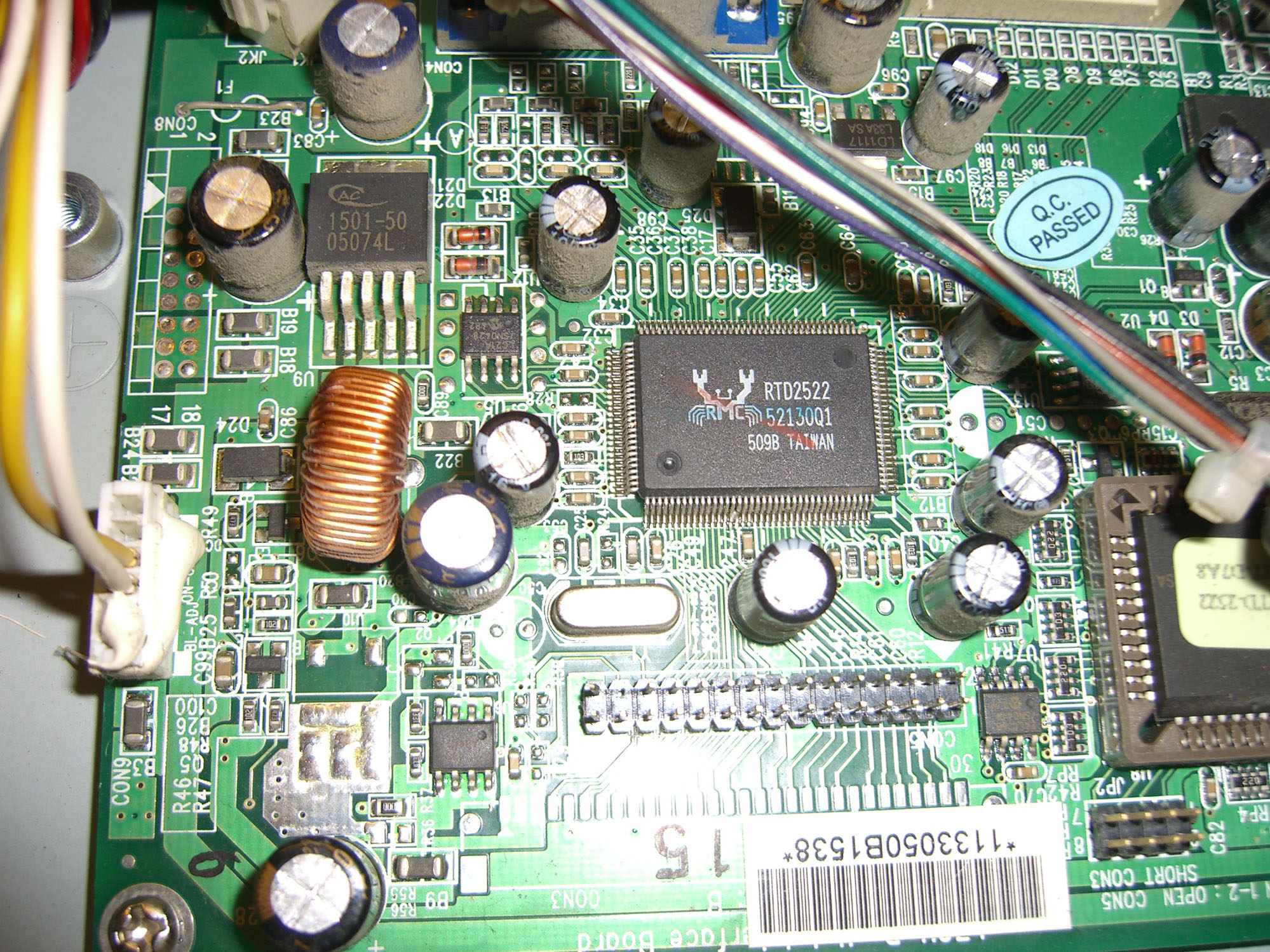

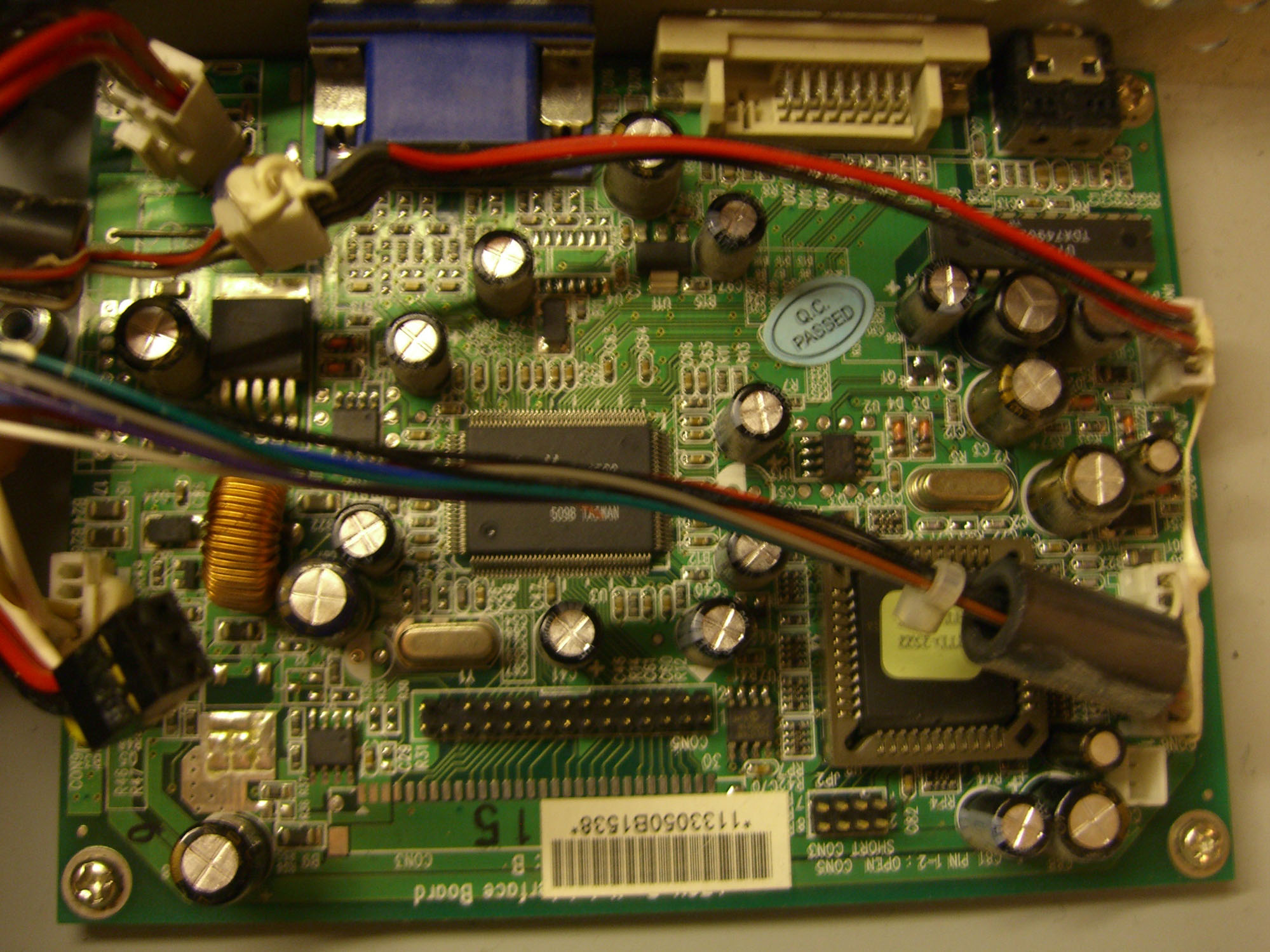

          Yes, go ahead and put D108 back. Can you supply a photo of the logic board (board that that plugs in the 6 prong connector on the power board)?
          Man, at this point I'm hoping that PlainBill may have a trick up his sleeve.
            #65
            Re: Daytek F19AH
            A few different views.

              At this point PlainBill is trying to find a rational explanation for the behavior of the output. Why is voltage detected at the input side of the opto-isolator, but not at the output? And what is the expected output voltage? Where did teh 'magic smoke' come from (or is that another monitor)?
              PlainBill

                  Re: Daytek F19AH
                  Holy. The very first monitor I repaired was coated in that dust like yours. It took more than 30 minutes just to clean up the insides to a respectable point.
                  I didn't think Winnipeg was that dusty!

                          So I put D108 back in, plugged it in and the transformer is not clicking anymore. Hooked everything up thinking it might be fixed. Did not work...Started taking it back apart again and realized after I put on the screw & nut that I forgot to solder it. Soldered it and plugged it in again. The transformer still is not clicking. I think Im now further behind then when I started. Is it time to give up yet? Would forgetting to solder that in have blown something else????????????
                            #73
                            Re: Daytek F19AH
                            There was no smoke just a faint burn smell at the time it went out/died.
                            I've got a few ideas running around my mind. I see two possible approaches. The first will require a fairly good soldering iron. The second will require a variable power supply, or you may be able to get by with several batteries.
                            The first thing to double (triple) check is the orientation of the caps you installed. I've marked what should be the + and - sides of the caps; please verify they are correct.
                            The second thing to try is I have marked two inductors in the upper left hand corner with a white L. If you have received your soldering iron, remove the lower one on the board and see if the power supply will work. This disables the inverter. (I'm not sure your 'cold soldering tool' will work on anything this heavy. That is heavy gauge copper wire).
                            Another approach will require a variable DC supply or several batteries. (Don't remove the inductor for this test). 'D' Flashlight batteries, a 6 volt lantern battery would be ideal. Even a 9V DC transistor radio battery might be sufficient. Assuming you are using a 6V battery, hook the - terminal of the battery to the - lead of any of the caps you replaced. Next, measure the voltage of the battery. It will probably be above the nominal output voltage for the battery. Hook the + terminal to one of the + leads of any of the caps you replaced. Now measure the voltage of the battery again, then disconnect the battery. No need to run the battery down. What voltage did you read with the battery hooked up?
                            PlainBill

                                          Ahh, crud. Here it is.
                                          PlainBill
