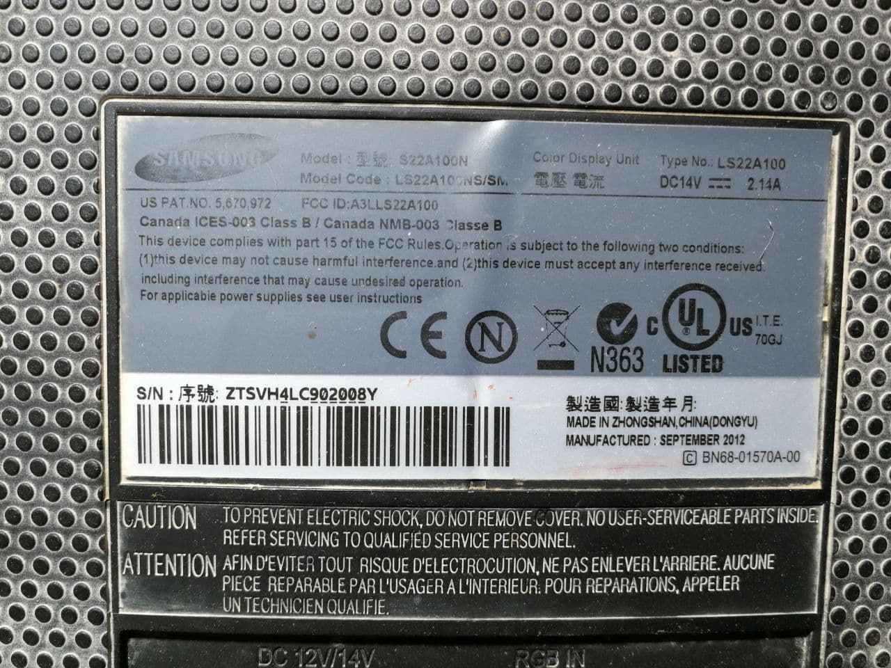

    Hi everyone!
    I need dump for Samsung monitor SA100.
    Model: S22A100N
    Thank you in advance.

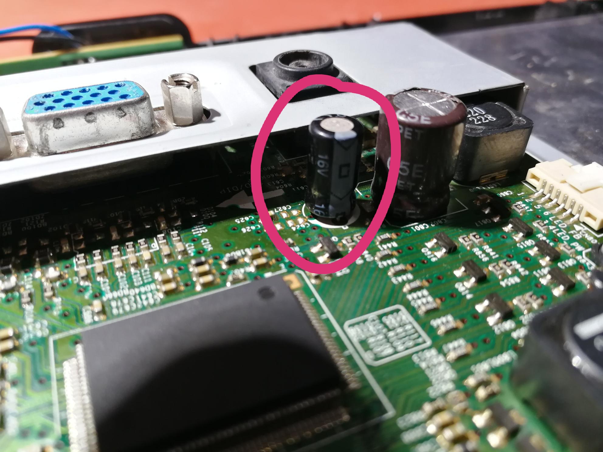

      it worked successfully at first time, but after i turned it off and on again nothing happen.
      any idea please!!!

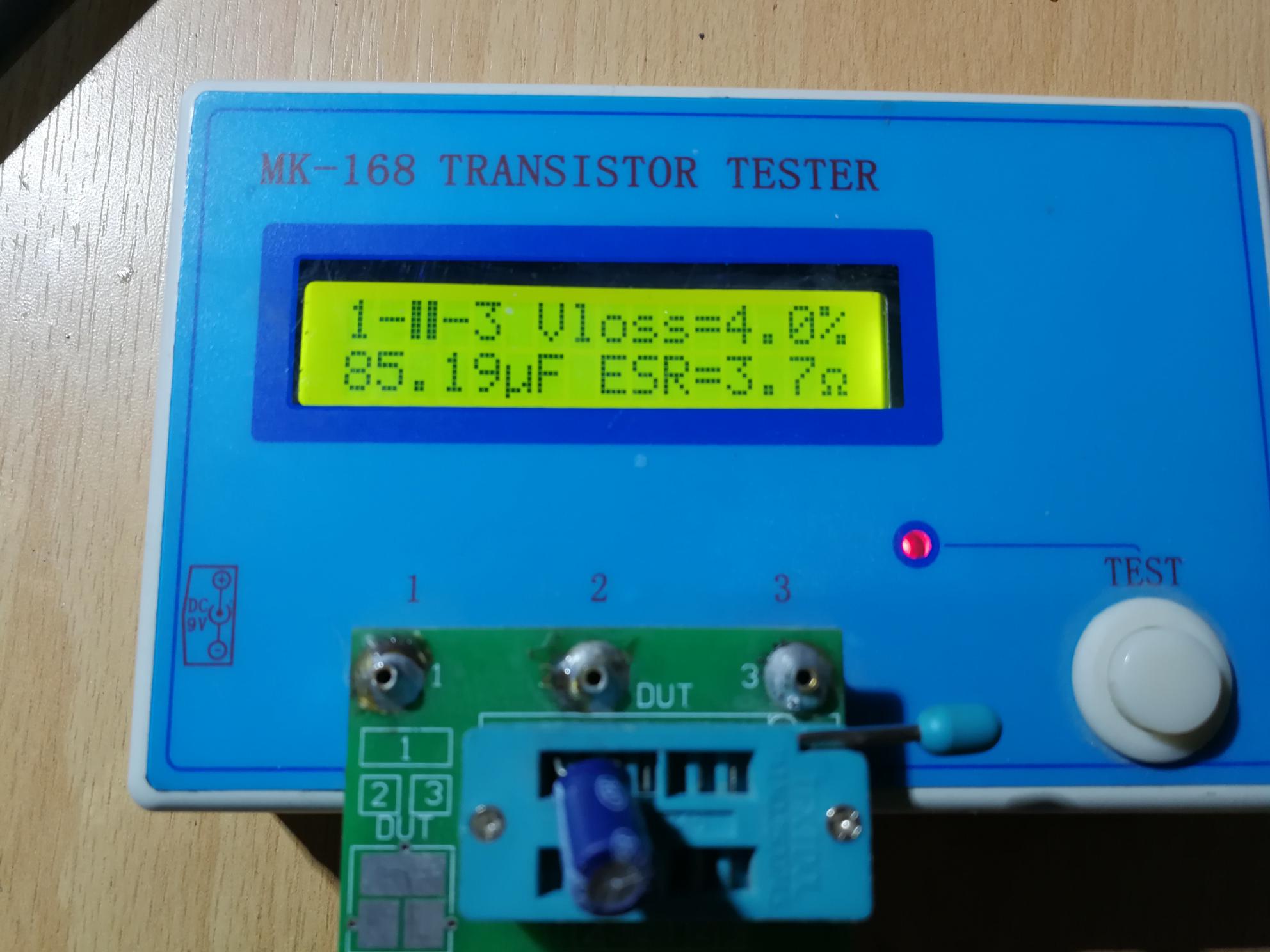

          The flash dump is fine
          I found a bad capacitor with high ESR value.
          C614: 16v/100uf
          Thanks 👍.
