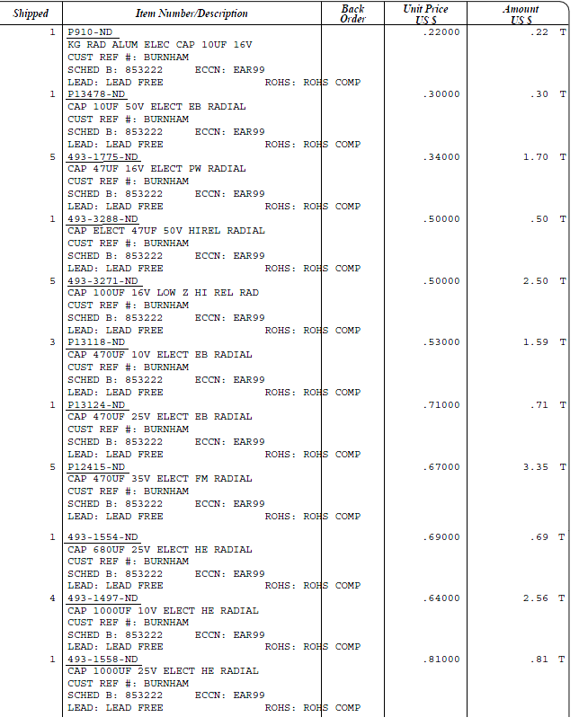

                      Hi, I looked up the part#'s on digikey and the series vary. I wasn't aware that the series mattered provided the uF and voltage were correct. I tried to select the ones with the longest hour rating with the 105 deg. rating. Here are some of the series for Panasonic... KG, EB, PW and FM. For the Nichicon I have PW, TS, and TT. I have not verified proper voltages going to the inverter board because I don't know what they should be and what wires to test. There is one red wire and 7 black wires. I did discover that the fuse (F1) on the inverter board was blown. I have a temp fuse there now, but when I plug it in with the fuse, the monitor doesn't make the audio chime. I never have gotten anything to display. Do you think the caps I selected based on the series could be the problem?
                      • king_raptor
                        • Oct 2010
                        • 16
                        #71
                        Re: Gateway FPD2485W - capacitor related?
                        In looking at 2 of the part #'s that I used which were successfully used by others - P13478-ND and 493-3288-ND they are EB and TS series, so perhaps that doesn't matter too much.
                        • Wrog
                          • Oct 2009
                          • 472
                          #72
                          The Panasonic FM is an excellent choice, along with the Nichicon PW. The others I'm not so sure about. Mismatched spec caps can cause what you are seeing. I would post a list of what you've purchased so someone more experienced than I can tell you which should be replaced with something more suitable. A lot of folks recommend Panasonic FC or FM series for this application.
                          The Nichicon TS looks suitable, but the Panasonic EB does not.

                              Attached is the order sheet for the parts I installed. Even though the EB series may not be ideal, the part P13478-ND was listed from someone else as being used and fixing the monitor, so I would assume it would be ok for mine. After removing one of the power mosfet (Q1) I tested from S-G, G-D and S-D as suggested and they were all less than 11 ohms, so it appears to be bad. The other 3 still on the board don't do this, so they may be ok.

                                The Nichicon PW and HE are great, the Panasonic FM is great, the EB are questionable. One that concerns me is the Panasonic KG (P910-ND), the ripple is low (47mA) and the ESR is high (10 ohms). The Nichicon PW (493-1767-ND) would be much better here. I honestly don't know about the Nichicon TS and TT series, hopefully someone will chime in about those. It looks like you've confirmed a problem elsewhere with a FET, hopefully that will turn out to be the problem source.
