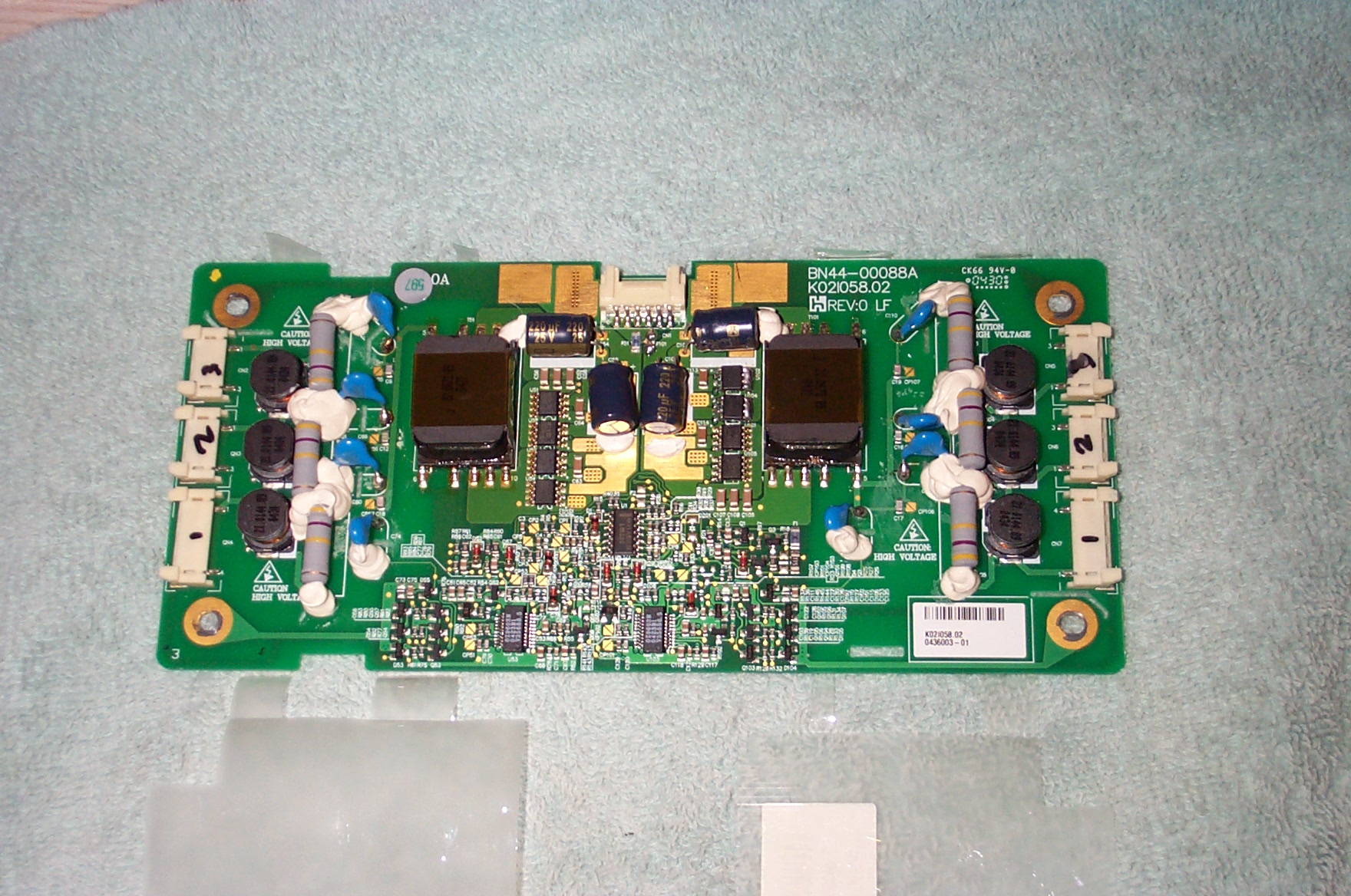

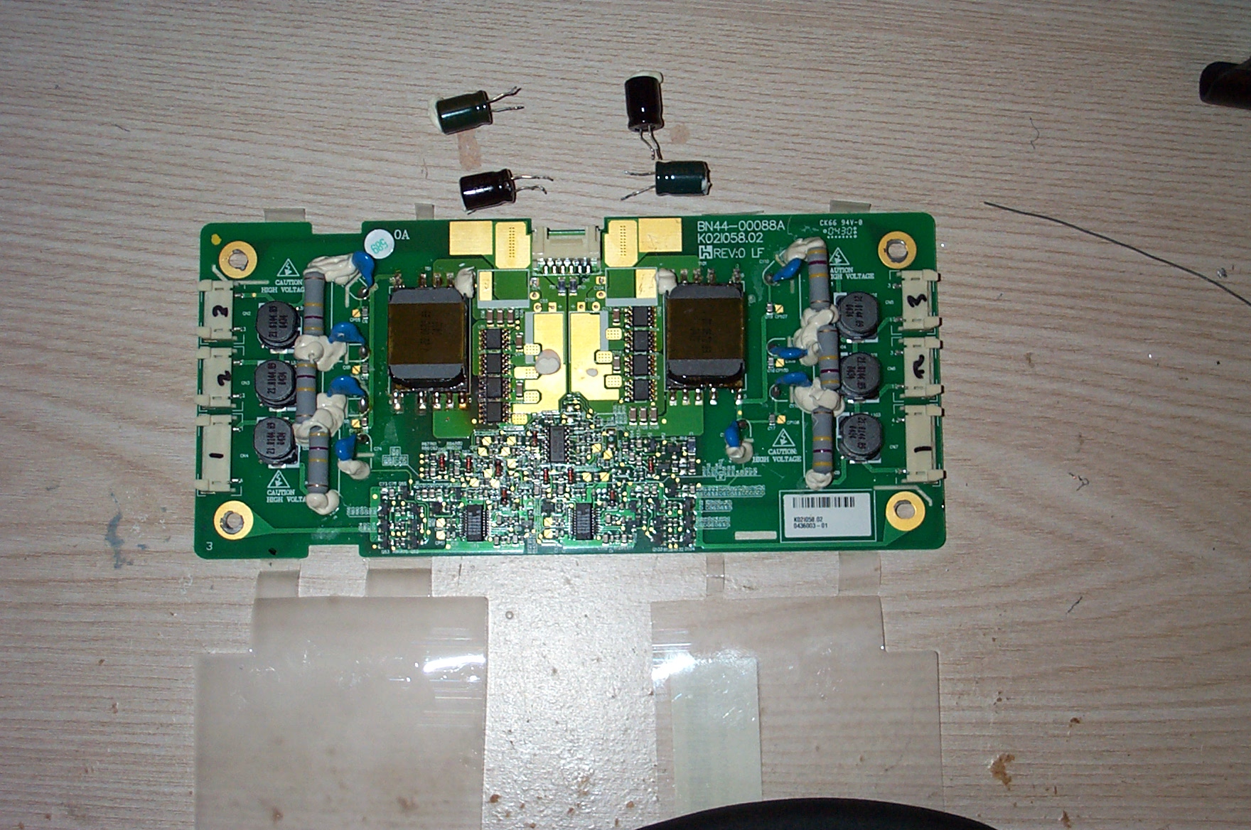

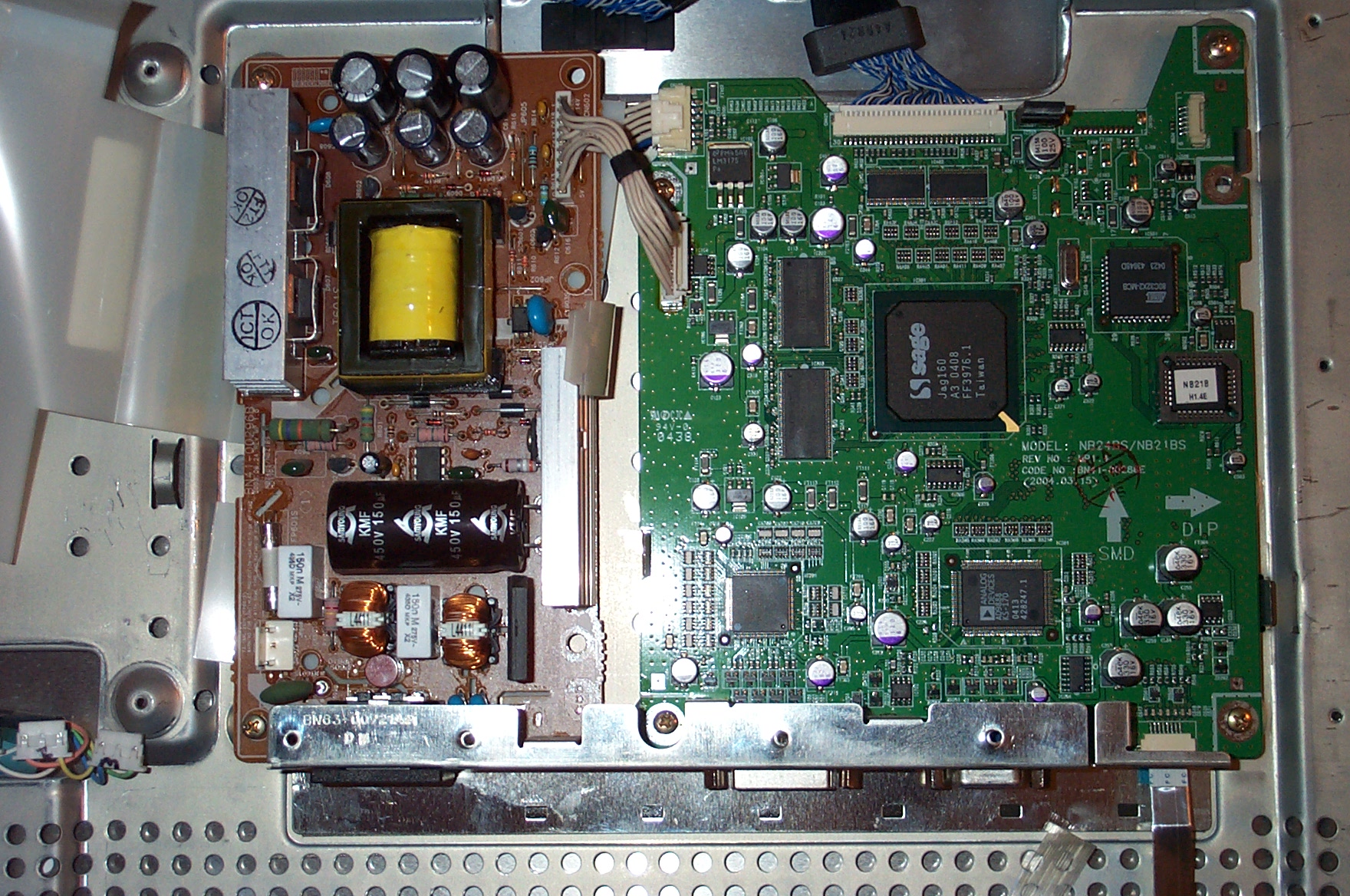

    I am working on a couple of Samsung 213T 21" lcd panels. They do not power on. I started by recapping the psu with 6 caps that I had on hand (top 3 are NHG 1000uf 25v - {i know this is bad - FCs are on the way}). Still the power will not come on. I noted that the power supply was making a clicking sound. I probed the voltages coming out of the PSU and they were fluctuating. So I concluded that the power supply was cycling.
    Exploring this idea, I unplugged the inverter board and lo and behold the clicking went away. I was then able to get a green power light to come on when I pushed the power button. I tried shining a flashlight to see if there was an image, but none was apparent.
    Now I am concentrating on the inverter. I tried testing the 4 220uf caps with my cap analyzer 88a, but it showed a short. I removed the 4 caps and tried testing them out of circuit. Apparently they are completely gone because the cap analyzer doesn't recognize them. The look like they could be domed, but the glue on top makes it hard to tell.
    The inverter board still shows a short between the holes for all of the caps and across the primaries of the transformer coils and pretty much the whole inverter board. I assume that this is not good. The secondaries of the transformers read 219 ohms.
    Can anyone make any recommendations on what to do next? I have some new caps on order. Should I just put them in and fire it up? Or is there something else I should look at? Like lifting one side of the transformers to check them for shorts out of circuit (this is scary because everything but the 4 e-caps are SMD)? It is hard to tell, but there is some goo on each side near the blue caps and big resistors. It doesn't look it is coming from the transformers, looks more like it came from the white glue stuff.

      Second picture, there are 4 'ICs' (probably FETs) in each of two columns. It appears that the 'magic smoke' has escaped from the bottom two ICs in the left column. What are the part numbers on these?

        Wow you have a good eye! On further inspection, they do look burnt. There is discoloration on the bottom of the board in that exact spot. So it looks like they got hot. The part number is (@?) 4600 BE4T1B. Guess I am going to have to learn how to surface solder.

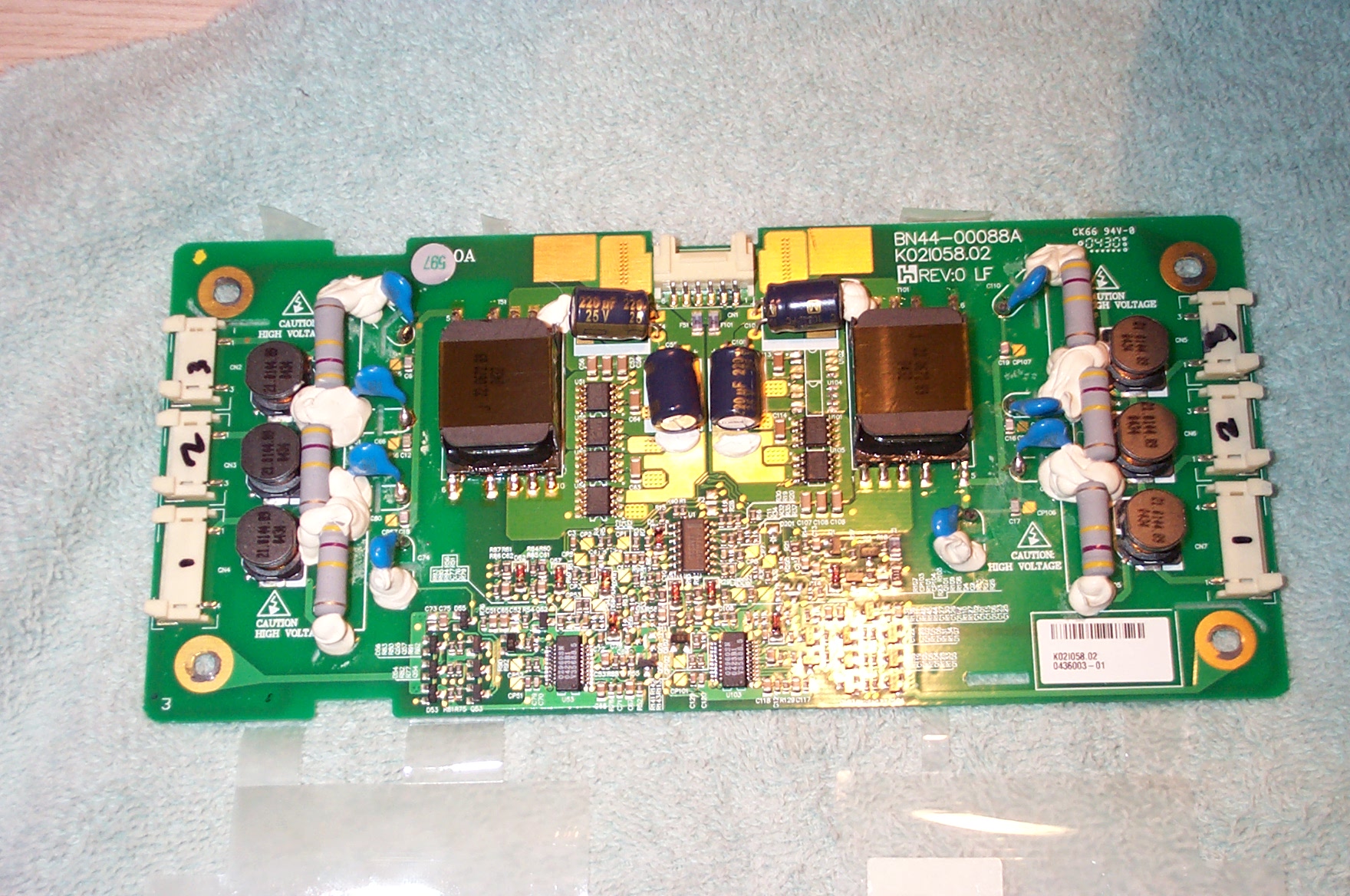

                  I have had success repairing a couple of these inverters. I used AO4619 MOSFETS (http://search.digikey.com/scripts/Dk...=785-1044-1-ND) as replacements for the 4600's. Since I had several to do, I got some chipquik that worked very well getting the old ones off.
                  If you are fixing one of these, test for shorts between pins 2 to 3, 2 to 5-8, and 3 to 5-8 on all eight of the 4600 MOSFETs. Replace any that show a short. They seem to fail in pairs. You will also need to check the two SMD fuses and replace/jumper as necessary. Be sure to replace all the caps on the inverter and the power supply while you are at it.
                  Attached are a couple of pictures showing the replacement of the MOSFETS. Pins 5-8 are shorted by the board, so I went ahead and put a big blob of solder across them. They are a little crooked, but over all not bad for my first attempts at surface soldering. Do yourself a favor and replace the caps on the inverter after you have replaced the MOSFETS.
