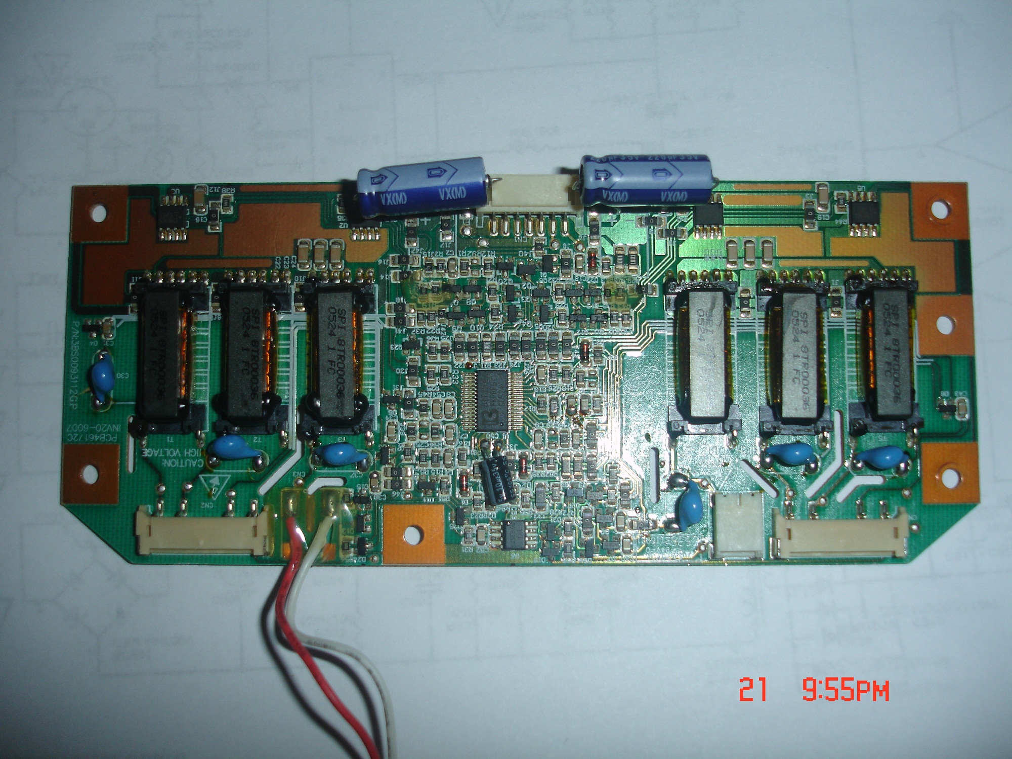

    Here's the more detail:
    The main board has all the voltages correct as specified in the circuit. I am getting all the 3.3V, 5V, 12V and 18 V on the main board. Reset the pin on GM1606 (main Chip) nothing came on.
    I dont have inverter circuit. The inverter is INV20-6007.
    There are 2 fuses on the inverter and they are fine.
    There were two 220uF/16V capacitors which I replaced with new ones.
    Any suggestion how to test/check the inverter board?

      Check the voltage to the inverter - is it stable?
      As always, pictures help us help you.

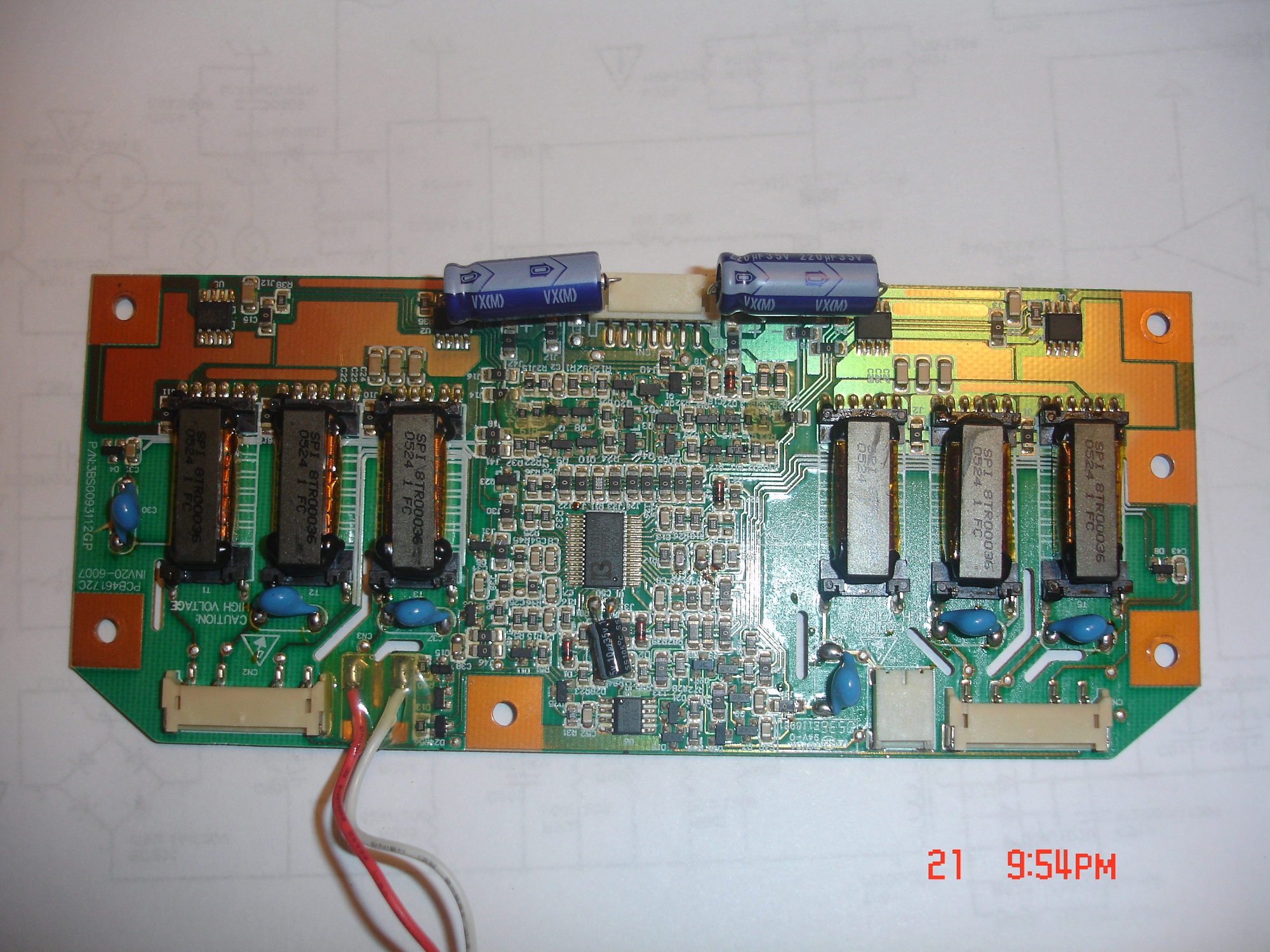

        Re: Acer AL2032W
        Thanks PlainBill......I will post the inverter picture.
        • saquib
          • 11
          Re: Acer AL2032W
          Here's the inverter pictures

                • PlainBill
                  • Feb 2009
                  • 7034
                  Re: Acer AL2032W
                  Originally posted by saquib
                  I connected the monitor to the the PC and there is no image appears on the screen. The screen is black. I tried to see if any image appear to check if its inverter issue or not but no image at all on the screen.

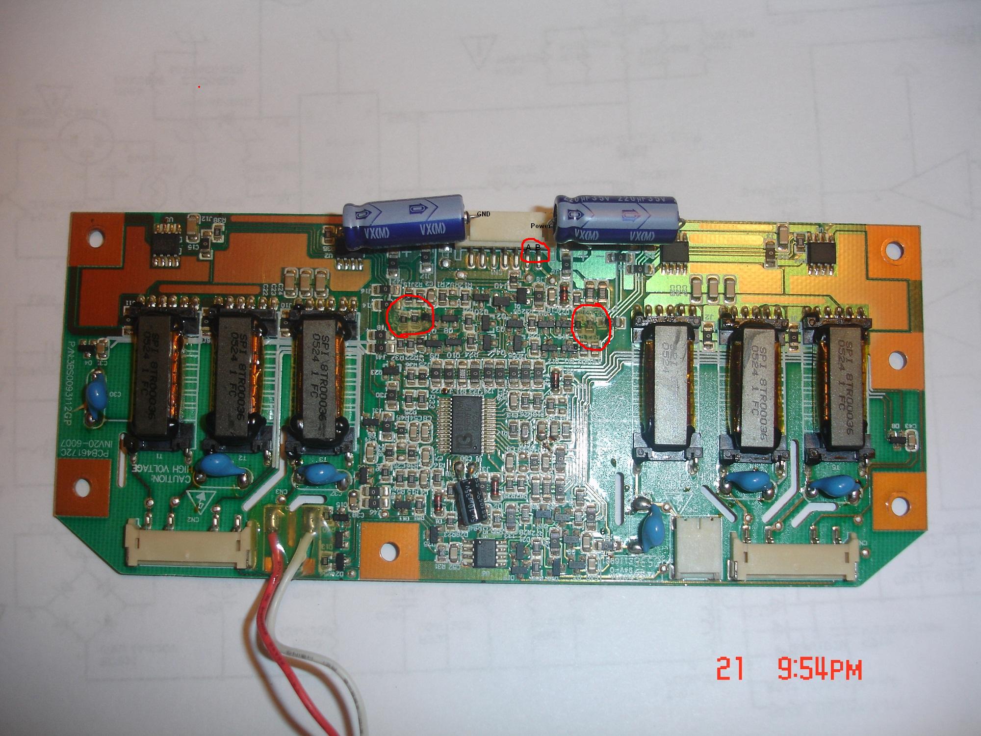

                  I've marked up one of the pictures. Here are a couple of points to measure the voltage:
                  1. From Gnd to Power
                  I've circled these next two pins on the connector. While you have the probes on these points hit the power button on the monitor several times 5 seconds apart and see if the voltage changes.
                  2. From Gnd to A
                  3. From Gnd to B
                  There are two discolored areas on the board; I've circled them in red. What are those?
                  What brand of caps did you use?
                  PlainBill
                  • saquib
                    • 11
                    Re: Acer AL2032W
                    1-The voltage between Gnd to Power = 18.6V
                    2-The Voltage between Gnd & Point A = it veries between 38.7mV to quick jump 16 V and its so quick with and without pressing the power button and heard to read the max side.
                    3-The voltage between Gnd & Point B = 0.0V no change when press the power button.
                    I also noticed that the voltage jumps @ pointn A when the Blue Power LED Flash. It goes to max side when its off and low side when its on.
                    The other red circle you did in the picture are due to the silicon grease.
                    The capacitor I used are the same values as original and bought from the Radio Shack.

                      Bingo!!! While Radio Shack has been in business for many years (89 to be precise), their product line deteriorated when they were acquired by Tandy in 1962. The might still carry decent product lines, but capacitors are not one of them. The SMPS power supplies in monitors require high quality low ESR caps. I prefer Panasonic FM or FC series. If you order from Digikey and specify USPS First Class Mail shipping you will recieve your order in 2 business days, and pay much less than you would at Radio Shack.

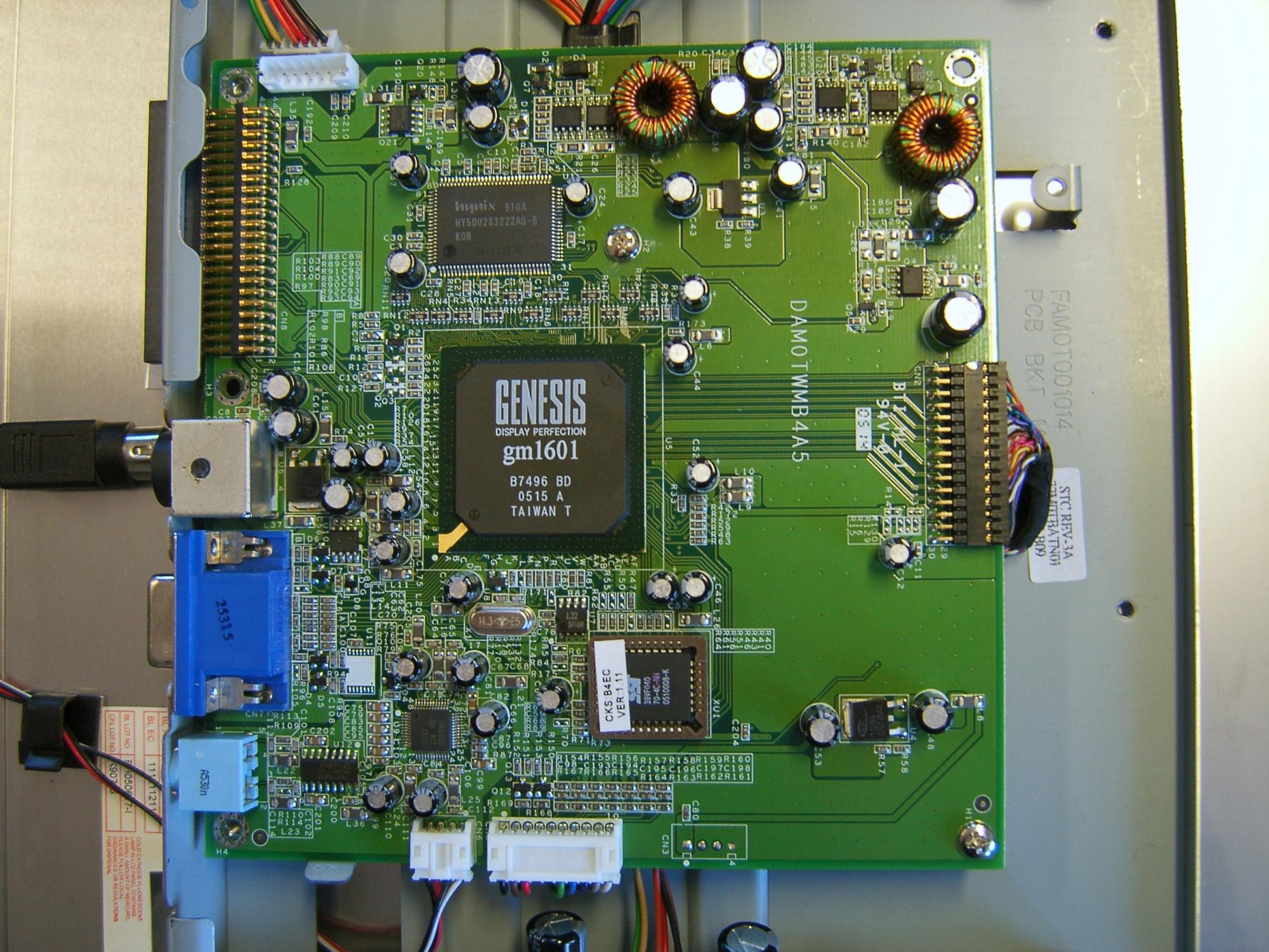

                                      I try to repair same display.
                                      Changed inverter capacitor but logic board doesn't start-up, even
                                      with inverter board disconnected. Debugging with freezer/hot gun show
                                      logic board start if hot (without inverter).
                                      I can see pin2 of U8 (max809) triggering reset at the rate of blue led,
                                      but pin3 level is good, strange !
                                      SeB.

                                        I'm having the same problem on my acer al2032w, blue power led is blinking with a faint clicking sound from the speakers.
                                        I disconnected all the plugs from the power board and it worked fine. (blue led stayed on and after a while turned orange and was possible to turn the power on and off with the switch).
                                        I connected the inverter to the power board and that all worked fine too. the lamps light up the screen and the blue power led stays on then cuts to orange after a while. all good.
                                        When i connect the screen to the power board then it goes back to blue flashing problem again.
                                        can you guys help. All the caps look in good condition just the same as the pic above.
