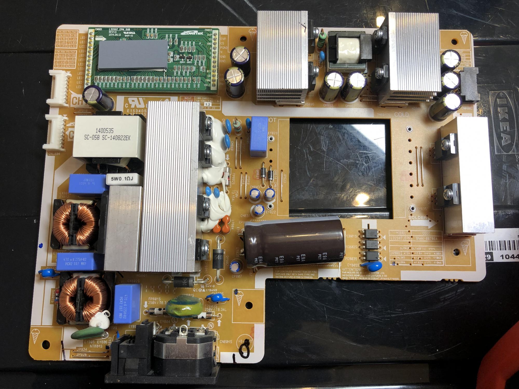

    By slapping the monitor and it starts to work almost confirms a bad connection and likely a bad solder connection on the power supply board. Post some pictures so we can see what we are dealing with.
    By connecting PS_On/Off Pin to GND you are placing it in standby mode, so of course the voltage drops.
    Check, or re-solder the connections on all components attached to heatsinks, and also the transformer pins, then closly inspect the board for other poor solder connections.

      Hi, thanks for your answer. I've had the monitor open for several times now and was inspecting the solder joints and tipping on pins. I've resoldered the mainboard<->psu connectors so far. I think it might be a last try to resolder the pins you mentioned. I didn't take pictures today, but in this video the guy is dealing with the same monitor but an obvious error: https://www.youtube.com/watch?v=tbWrSu_ESDs.

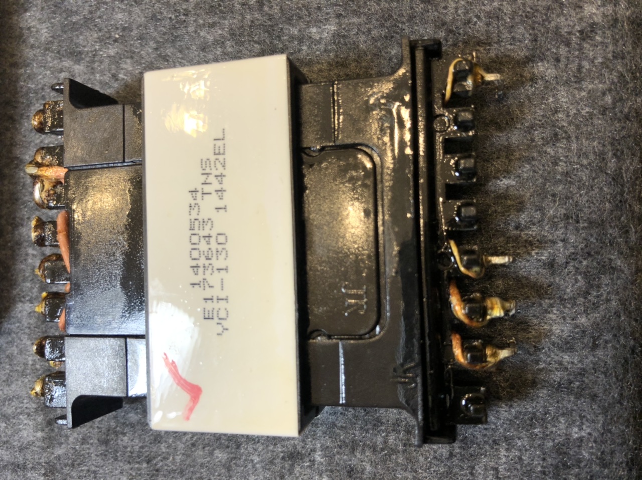

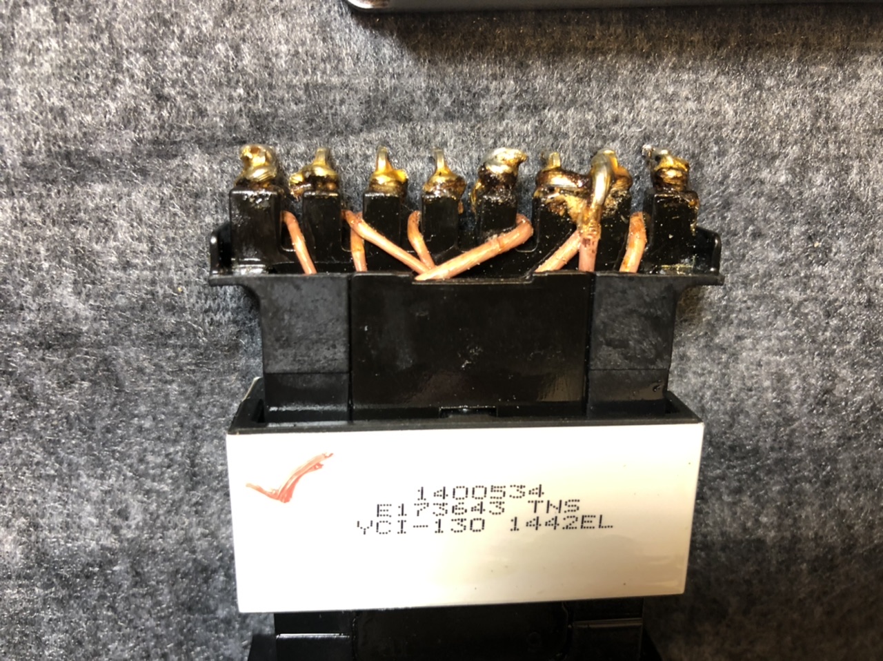

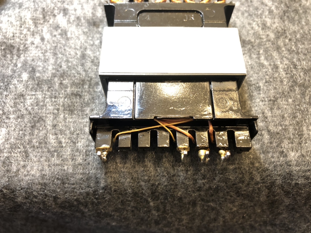

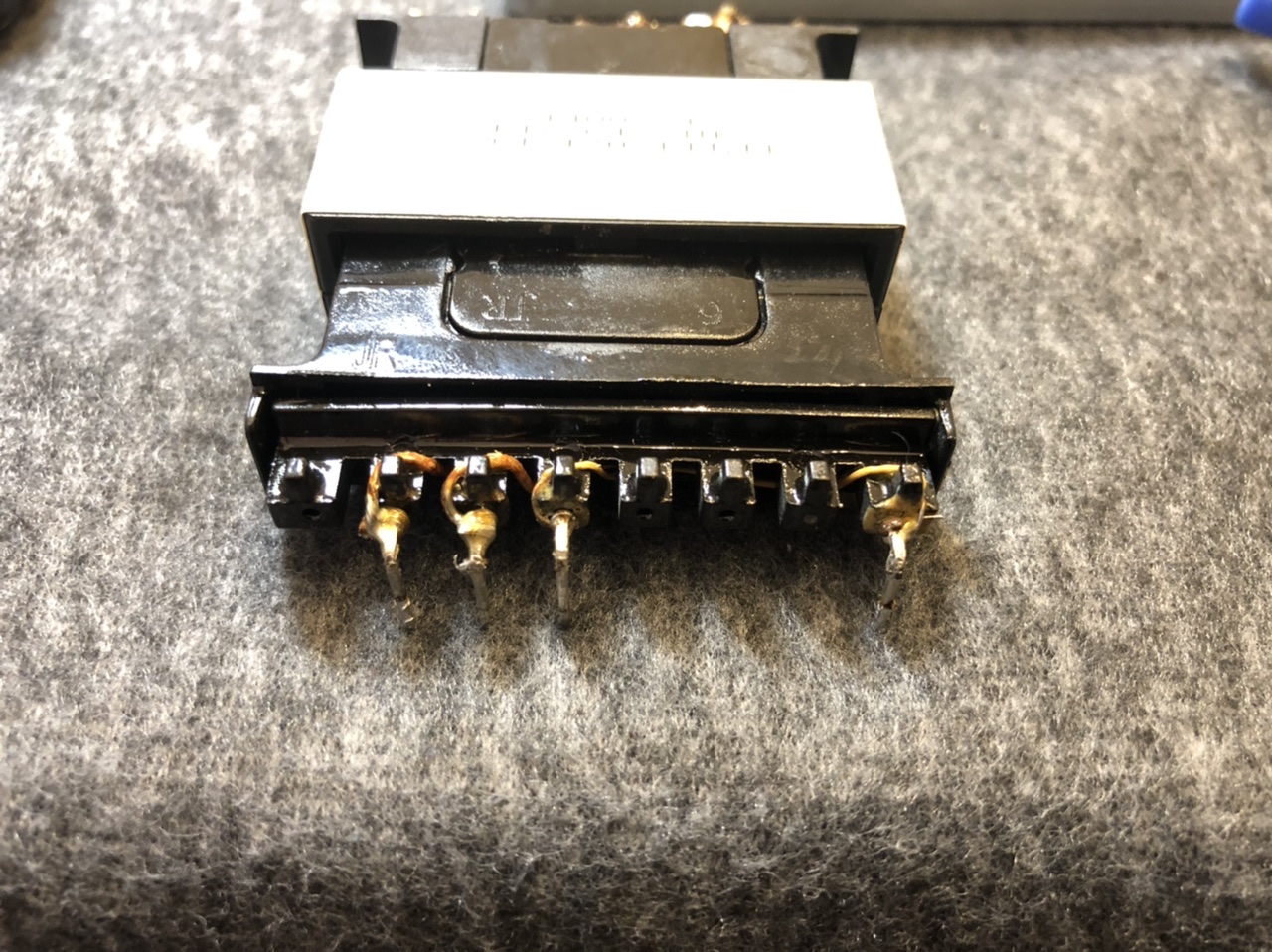

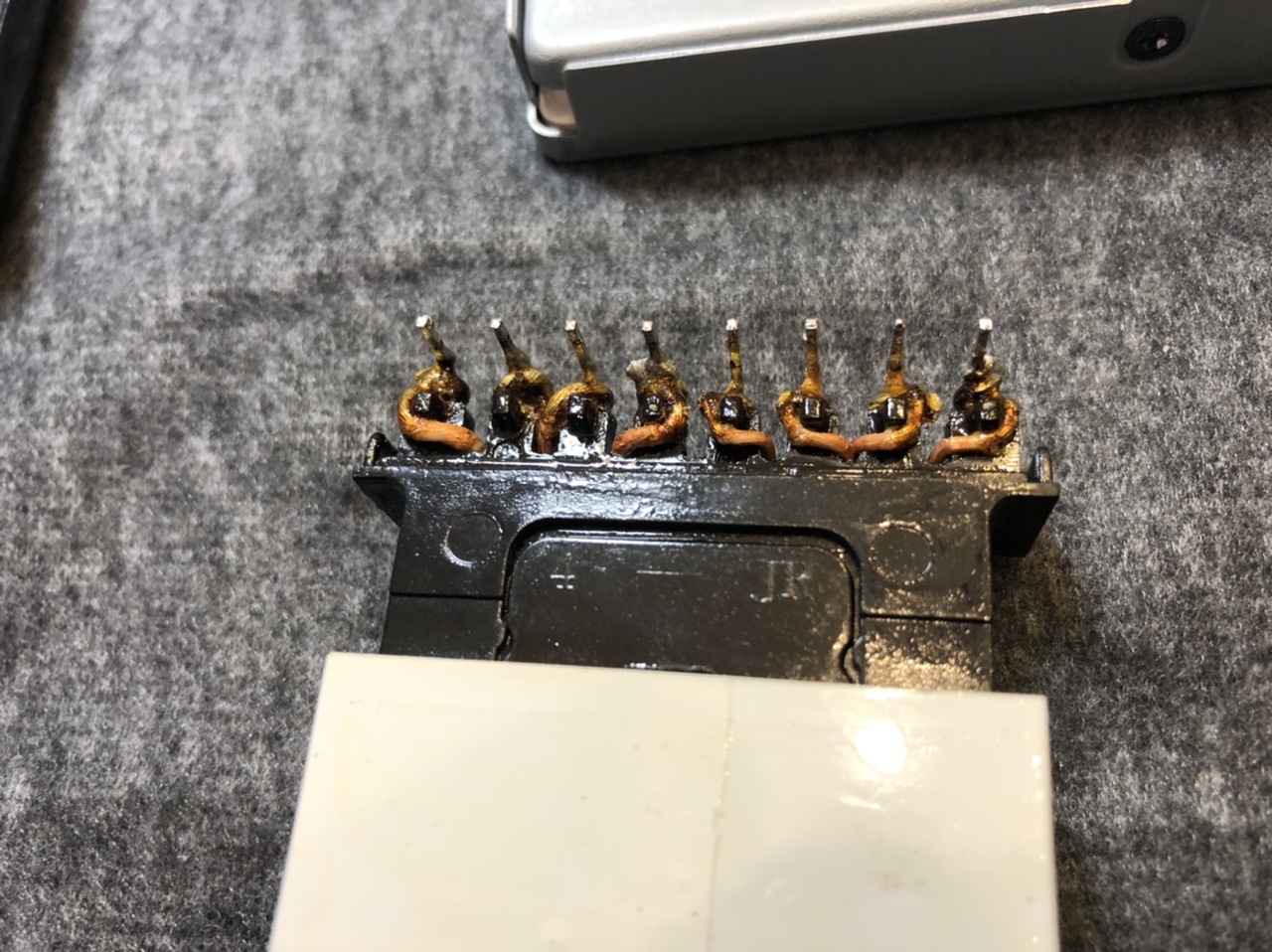

        I've desoldered the transformer, is it normal after manufacturing that the connections look a little bit burned?

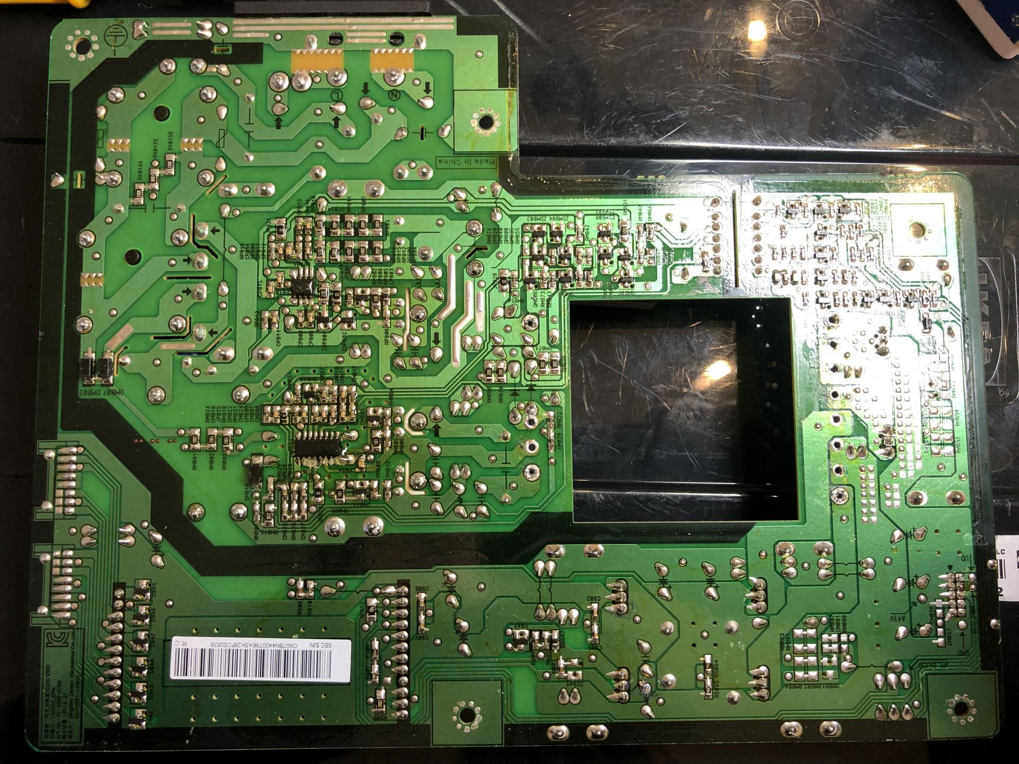

        Edit: added board photos

          There is no need to remove these parts, that is likely varnish or glue on the transformer pins, It is not the problem. If there were any defective parts, the power supply would not operate at all! Slapping the back of the monitor would have had no effect.... but it did, so there is a intermittent connection somewhere.
          Re-install the transformer, you may have already fixed the problem if the transformer's connections were poorly soldered.
          Re-solder any of the connections that use those rivets, start from the a/c inlet and the input filter chokes including the bridge rectifier.

            I think I heated the transformer too much, the Display startet shortly with backlight blinking in strange patterns, after that the backlight was off and the standby LED was on.
            I can only measure about 7,8 V on the PSU mainboard output. The Transformer Input is ok but there is no output. I think I might have grilled the thermal fuse within the transformer?
            Is there any store where I can order the transformer? I didn't find any so far.

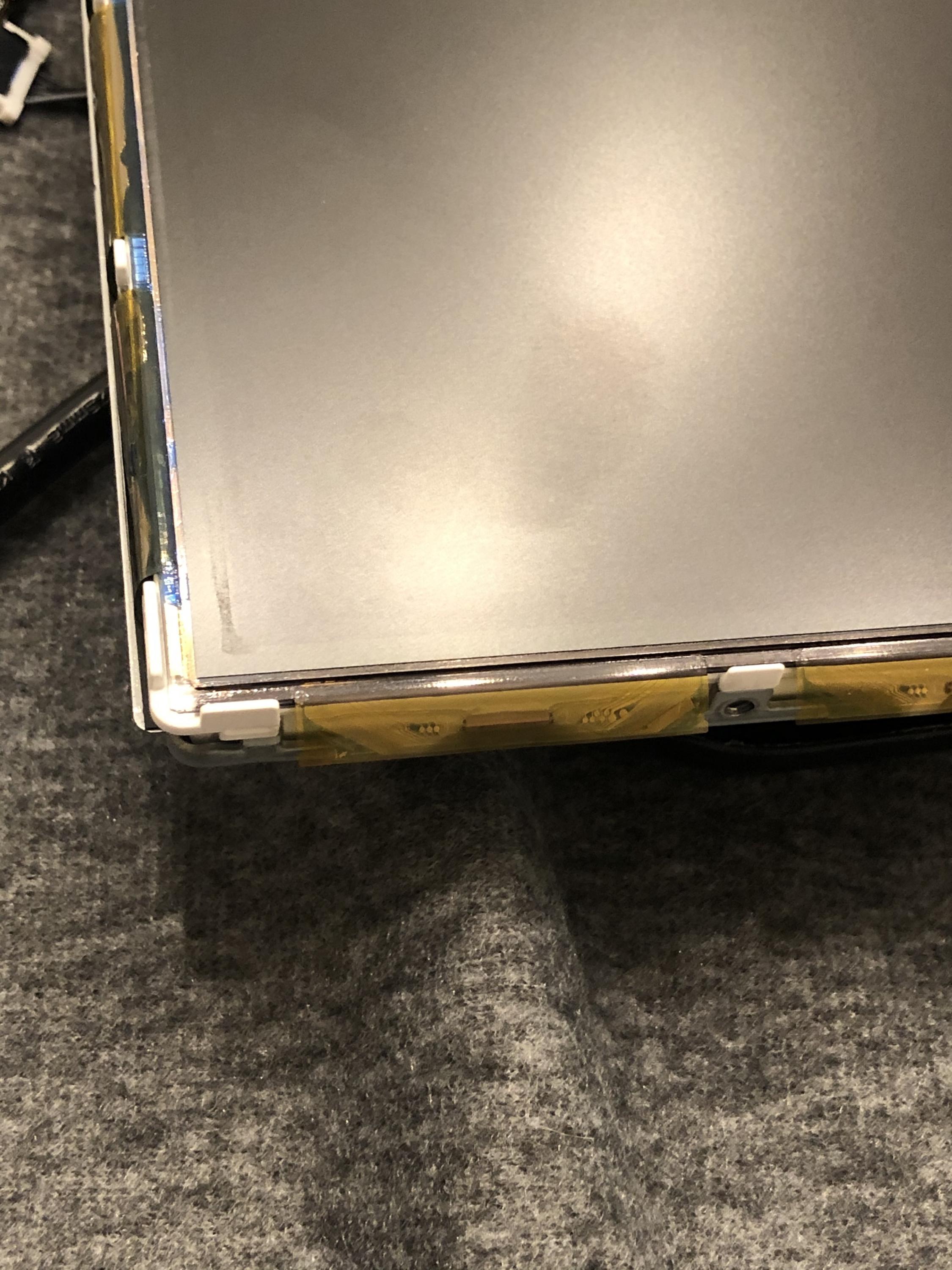

                  Okay, I found an issue, that might cause the lines on the screen. The Panel wiring snipped on the bottom left and right get untouchable hot.
                  Is there anything I can do or is the panel dying?

                    Re: Samsung U32D970Q works after slapping it

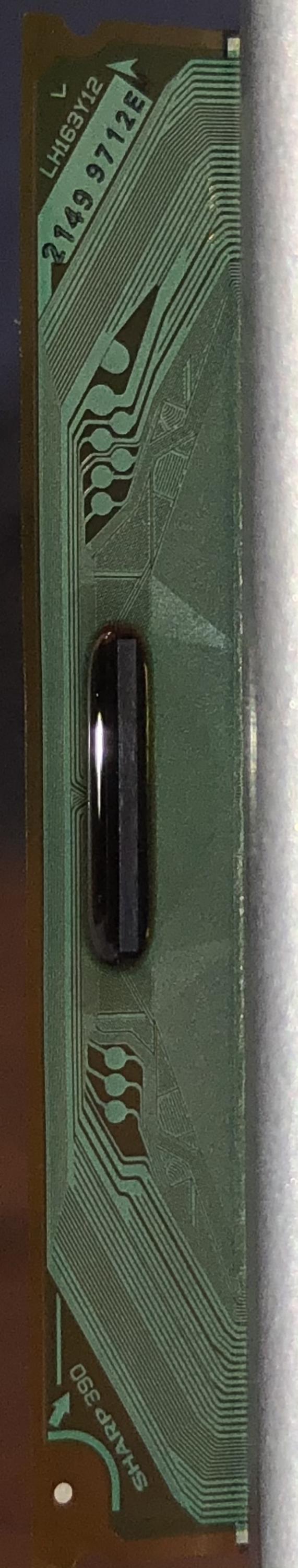

                    Does anyone have a datasheet for the COF lh163y12 by sharp?
                    I would like to check if there is any line grounded of these
