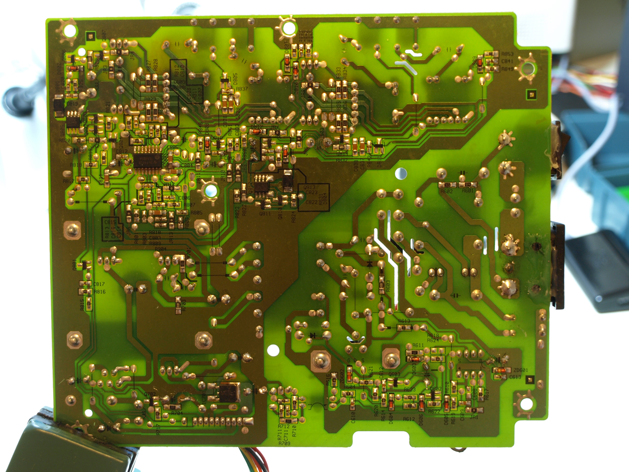

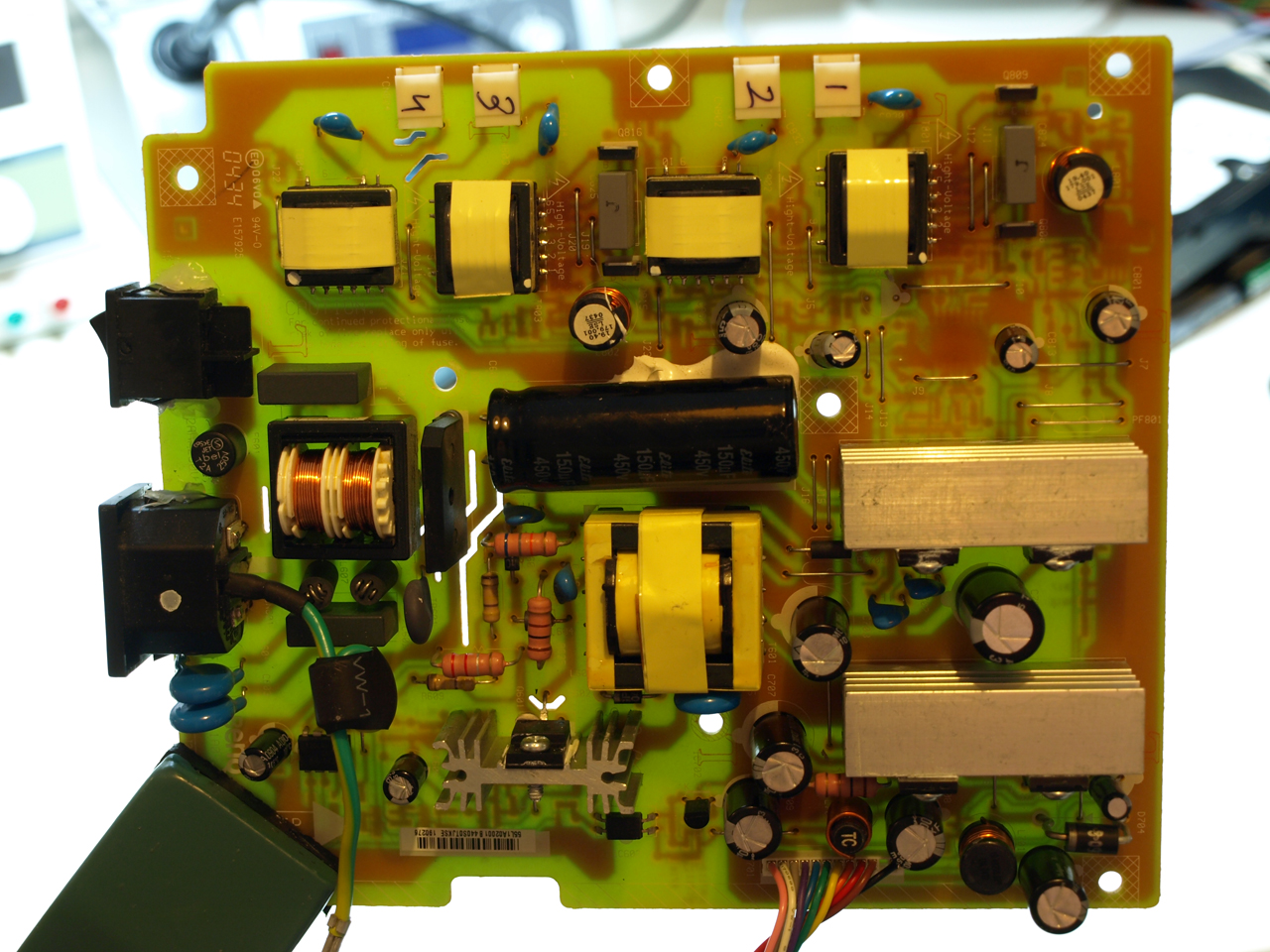

    Here are some pictures. Ive focused on the components as Krankshaft did.
    I think what alexanna was suggesting are photos of your entire board top and bottom. It's difficult to point things out for you to test if one can only see portions of the board.

        Lets try that again shall we?
        Here are some new full-surface pictures.
        If you want there are fullsize pictures here... http://gkdv.se/bilder/Elektronik%20&...1030/Fullsize/

                        There are 4 inverter transformers on your board. They're the yellow rectangular devices with multiple pins coming out each side. They appear to be labeled T801-T804. The secondary pins are numbered 8 and 10. With your meter set to resistance, measure across these two pins and post your results. Difference between the 4 transformer secondaries should be no more than 3%.

                          I start the measuring from the top transformer...
                          188.6 ohms
                          184.3 ohms
                          187.1 ohms
                          188.5 ohms

                                  I have allready taken pictures of the board on top and underneath and even given links to the full resolution pictures on my webserver.
                                  Thanks for the info about the multimeter btw!

                                        1) Let's get a picture of the logic/main board.
