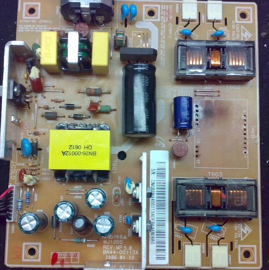

    I was given a dead samsung 920N LCD to play with and put it aside because the faulty electronics did not appear to be due to bad caps.
    There ware no mounded caps.
    All the caps passed the scope, oscillator, resistor: ESR test.
    There were 3 broken foils on the MJ19BS inverter/power board to the MJ17BS hybrid assembly pins 15,16 & 17 which were easy to repair.
    Still, no backlighting.
    I isolated the fault to the MJ17BS hybrid pulling down the 13v (hybrid pin 12) by removing the hybrid. It was starting to look like an expensive repair so I set the LCD aside.
    Then I came across a Russian site that appeared to show a repair to the E6N03, dual FET chip on the MJ17BS hybrid. Which is likely to be at fault in my case as the FETS sink most of the current.
    The E6N03 is the missing 8 pin, surface mounted device in the upper right on the photo of the MJ17BS hybrid.
    This fix is a bit outside of my confort zone.
    Has anyone tried to repair a surface mounted component on a hybrid?
    What should I be careful of?
    Where can the E6N03 be sourced when I am only buying one or two (in case I screw-up the soldering).

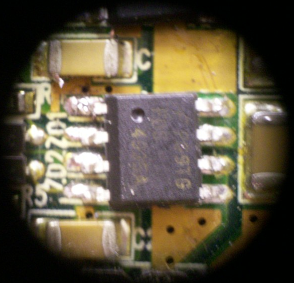

      I am still trying to piece this hybrid fix together.
      The 8-pin device that was removed from the hybrid photo below appeared to be: PF7SR, FDS.
      Another Russian blog post about the samsung 913N suggested that the "PF7SR FDS" is an FDS4935A.
      pdf data sheet attached: https://www.badcaps.net/forum/attach...id=12871&stc=1
      What is the best method to remove these surface mounted devices from the hybrid?
      Am I way "out there" on this one?
      Cheers

      • PlainBill
        • Feb 2009
        • 7034
        Re: samsung 920N, MJ19BS inverter/power board fault
        Cheers
        One way is a product called 'Chip Quik'. It is a wire made of a low melt alloy (Woods metal). You melt the Chip Quik on the component leads with a soldering iron. The solder dissolves in the Chip Quik and makes it easy to remove the part without damaging it or the board (substrate).

        • Kevin O'Henly
          Ontario Member
          • May 2009
          • 48
          • electronics, computers, badmington
          That is too cool, PlainBill.
          The idea being; change the surface mount solder in to something less sticky.
          I am going to get some just to try it out.
          THX.
          The method I resorted to involved an exacto-knife and a fine tipped iron.
          The IC leads were severed from the main part of the chip as close to the IC as possible using the exacto-knife and downward pressure. Care had to be taken not to cut foil traces on the hybrid substrate that were in the path of the knife blade.
          When all the IC leads were severed, the IC was removed and discarded. The remaining part of the IC leads that were soldered to the solder pads on the hybrid substrate were removed using a fine tip iron and copper braid.
          Worked well this time but the 'Chip Quik' is likely to be the prefered method for the future.
              Repaired the hybrid (see the attached png.s)
              ...improved on the second try.
              The component moves around as it is soldered.
              A dot of crazy glue helps hold the part in place.
              Works good, now.
              Thanks to all that contributed.

                            Flashing Power LED most likely shorted MOSFET in inverter section, new caps allowed more voltage to reach the inverter fuse causing it to open. With inverter fuse open the shorted MOSFETS are out of the picture allowing the PLED to function properly.
                            Check the MOSFETS for shorted condition, replace as required. Check and replace inverter fuse.
