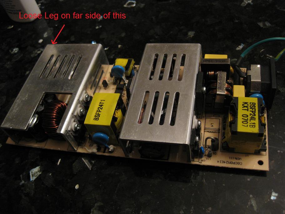

    I received a 24" monitor 1920x1200 resolution that has an intermittent issue. After about half hour to an hour of operation, the monitor seems to flip to have a reverse image so that white is blackish purple if you can picture what i mean. I opened this bad boy up and it isn't the easiest to access components.
    The only thing that I can see from visual inspection is that the one leg of one of the heat sinks looks like it has a broken solder joint. I'm not sure if this actually does anything but I am looking for advice.

    Good design practice demands that a heat sink should not be asked to conduct electricity. That said, there are plenty of designs that do not follow good practices. Of more interest would be the condition of the caps under that heat sink.

      I've seen some moron engineers use the heatsink to connect two ground planes together. So nothing suprises me anymore.
      Resolder the joint but keep looking in terms of troubleshooting.
      Probably either a bad solder joint on the video board or a connection to the panel itself. The power supply is not the place to look on this one.

        I soldered the broken connection and re-did a couple of others that looked somewhat suspect. The cables are taped and glued in place so I don't think I am getting a loose connection there. It's been perfect for about two hours. I will update if the problem returns...it feels like I just got a cheap 24" 1920x1200 monitor!

            It looks like I deleted the originals off my machine. If you look at the first picture, the power supply connection is on the far right of the picture...the main fuse is typically located there.

                              Some 'engineer' should be taken out at dawn and executed. Preferably be being slowly buried under a mountain of defective monitors. Any 'engineer' who would place caps UNDER a heatsink like this is either incompetent or deliberately designing the equipment for an early failure.
                              The large cap is definitely bad. It must be replaced. The others (under the second heatsink) are also likely to fail soon (it they haven't already), and should be replaced at the same time. If you desire help, post the details on them (brand, series, capacitance, voltage, diameter, and height) and someone will suggest replacements.
