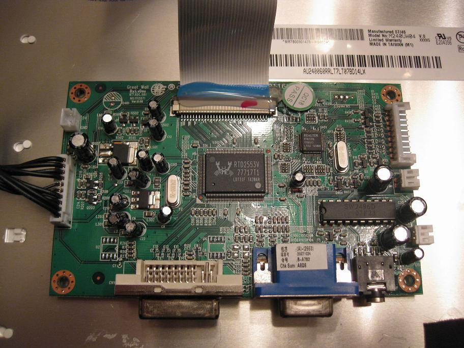

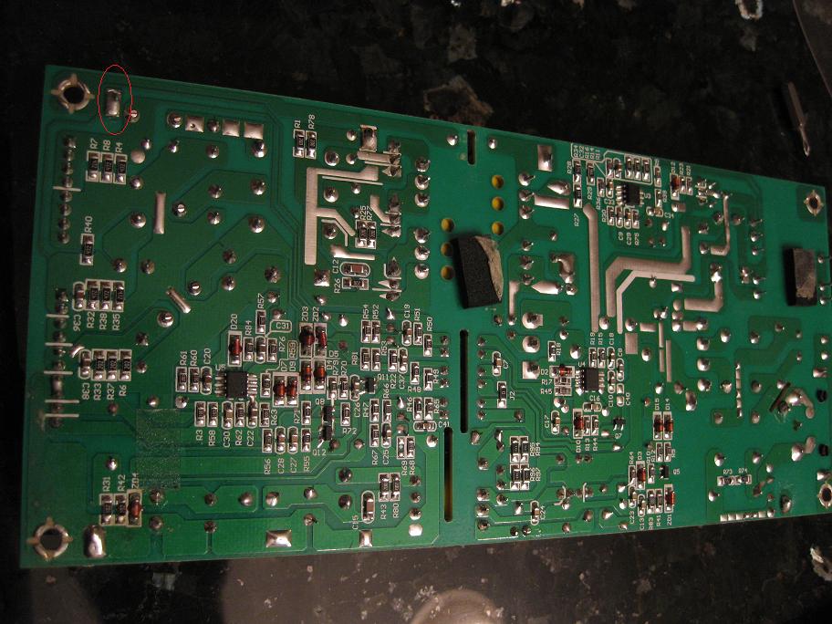

    I received a 24" monitor 1920x1200 resolution that has an intermittent issue. After about half hour to an hour of operation, the monitor seems to flip to have a reverse image so that white is blackish purple if you can picture what i mean. I opened this bad boy up and it isn't the easiest to access components.
    The only thing that I can see from visual inspection is that the one leg of one of the heat sinks looks like it has a broken solder joint. I'm not sure if this actually does anything but I am looking for advice.

    Good design practice demands that a heat sink should not be asked to conduct electricity. That said, there are plenty of designs that do not follow good practices. Of more interest would be the condition of the caps under that heat sink.

      I've seen some moron engineers use the heatsink to connect two ground planes together. So nothing suprises me anymore.
      Resolder the joint but keep looking in terms of troubleshooting.
      Probably either a bad solder joint on the video board or a connection to the panel itself. The power supply is not the place to look on this one.

        I soldered the broken connection and re-did a couple of others that looked somewhat suspect. The cables are taped and glued in place so I don't think I am getting a loose connection there. It's been perfect for about two hours. I will update if the problem returns...it feels like I just got a cheap 24" 1920x1200 monitor!

            It looks like I deleted the originals off my machine. If you look at the first picture, the power supply connection is on the far right of the picture...the main fuse is typically located there.
            Can you explain your situation more? Is there no power (LED doesn't even light up) or does the monitor turn on but there is no display? Do you get an image for a brief second and then it shuts down...please elaborate.

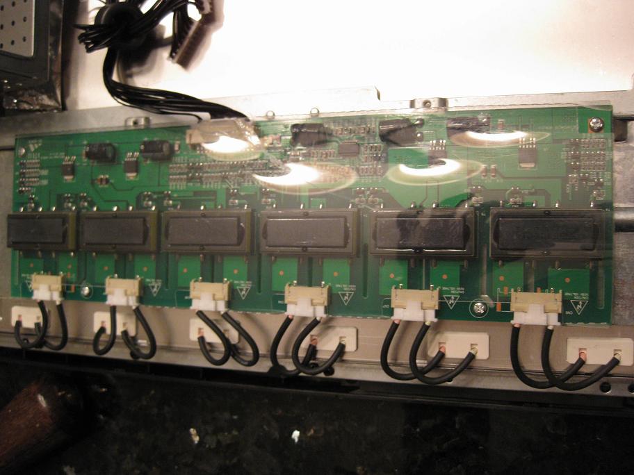

                            Sorry, for being late. After my monitor died, it so happens my mobo (ASUS P5K-VM) dies. Just my luck. Didn't power on one day, so I swapped out the PSU, powered-on and **POP**. I pulled the plug and therein loomed a rancid smell. I unplugged all the peripherals beforehand and am lucky that the CPU and the RAM are still good. Now I'm on a cheapo backup motherboard (EVGA 610i) which is surprisingly more stable than the ASUS ever was.
                            Anyhow, back to the case of the dead monitor; it's still in pieces, and I've taken some photos. Again, I really have no idea what to look for here, and I still have to get my hands on a digital multimeter (only have a really old analog one atm) before I think I can start testing. These pictures are of the power board(?) only and if i'm correct, the "big cap" is the one under the metal heatsink. I can't tell if it's bulging (that is what to look for, correct?) to the point where it might be damaged. I can't quite find the fuse location that you specified either. Hopefully you can point me in the right direct...er, the right place on the PCB

                              Some 'engineer' should be taken out at dawn and executed. Preferably be being slowly buried under a mountain of defective monitors. Any 'engineer' who would place caps UNDER a heatsink like this is either incompetent or deliberately designing the equipment for an early failure.
                              The large cap is definitely bad. It must be replaced. The others (under the second heatsink) are also likely to fail soon (it they haven't already), and should be replaced at the same time. If you desire help, post the details on them (brand, series, capacitance, voltage, diameter, and height) and someone will suggest replacements.
                                PlainBill
                                I'm surprised it even lasted this long, not to mention the *other* one that is still running since I bought the pair nearly a year and half ago.
                                From peeking through the heatsink:
                                SAMXON
                                100uF 450V
                                diameter of 1.8cm
                                length of 4.0cm
                                Trouble is removing the heatsink, which seems to be screwed on to locking pins that are soldered through the PCB. Would it be a safe go to de-solder these pins?

                                  You could try, but it's going to take a very good soldering iron or a solder pot. It might not be necessary. By the appearance it would be possible to slip the old one out after unsoldering the leads. Inserting the replacement would involve slightly less dexterity and patience than building a model sailing ship in a bottle.
