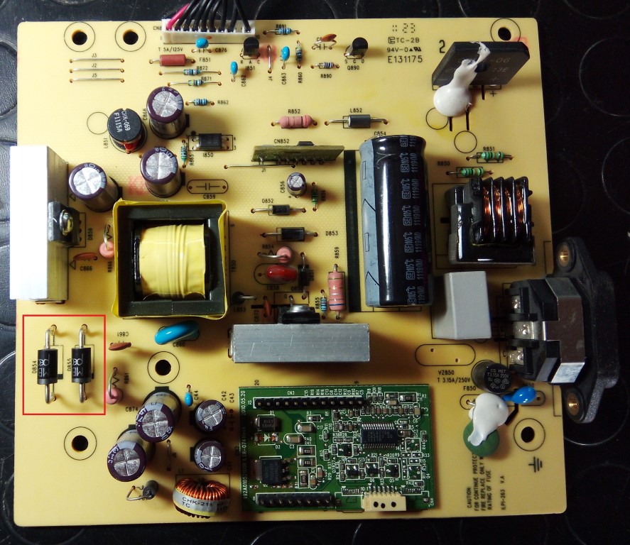

    this monitor did not power on. No even the standby.
    This model is quite new to have the bad caps problem.
    In fact the issue was in the big diodes in the power supply. They were short-circuited. This was already the second monitor of this model with the same problem.
    Check the attached picture.
    Regards
    Roberto
