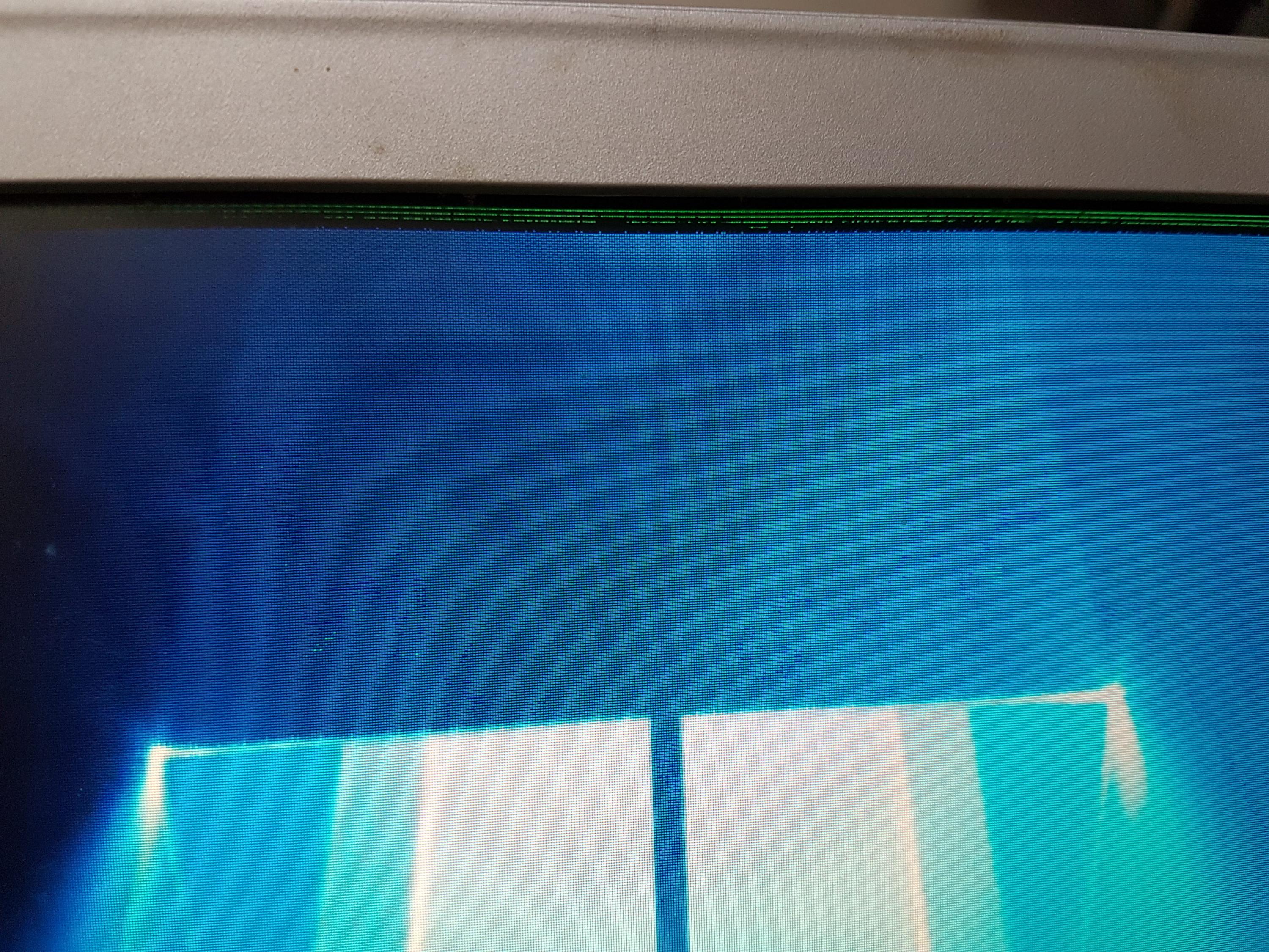

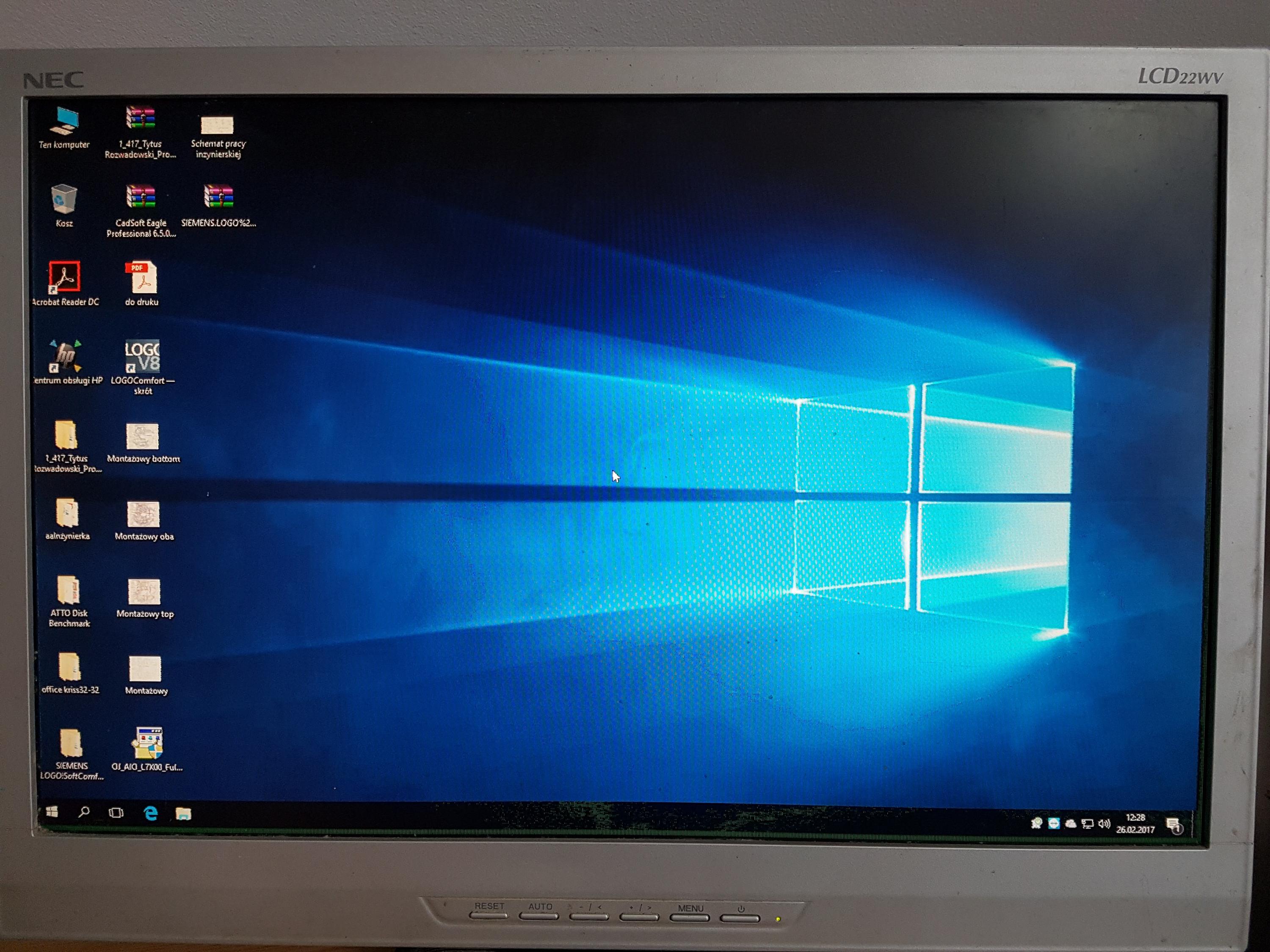

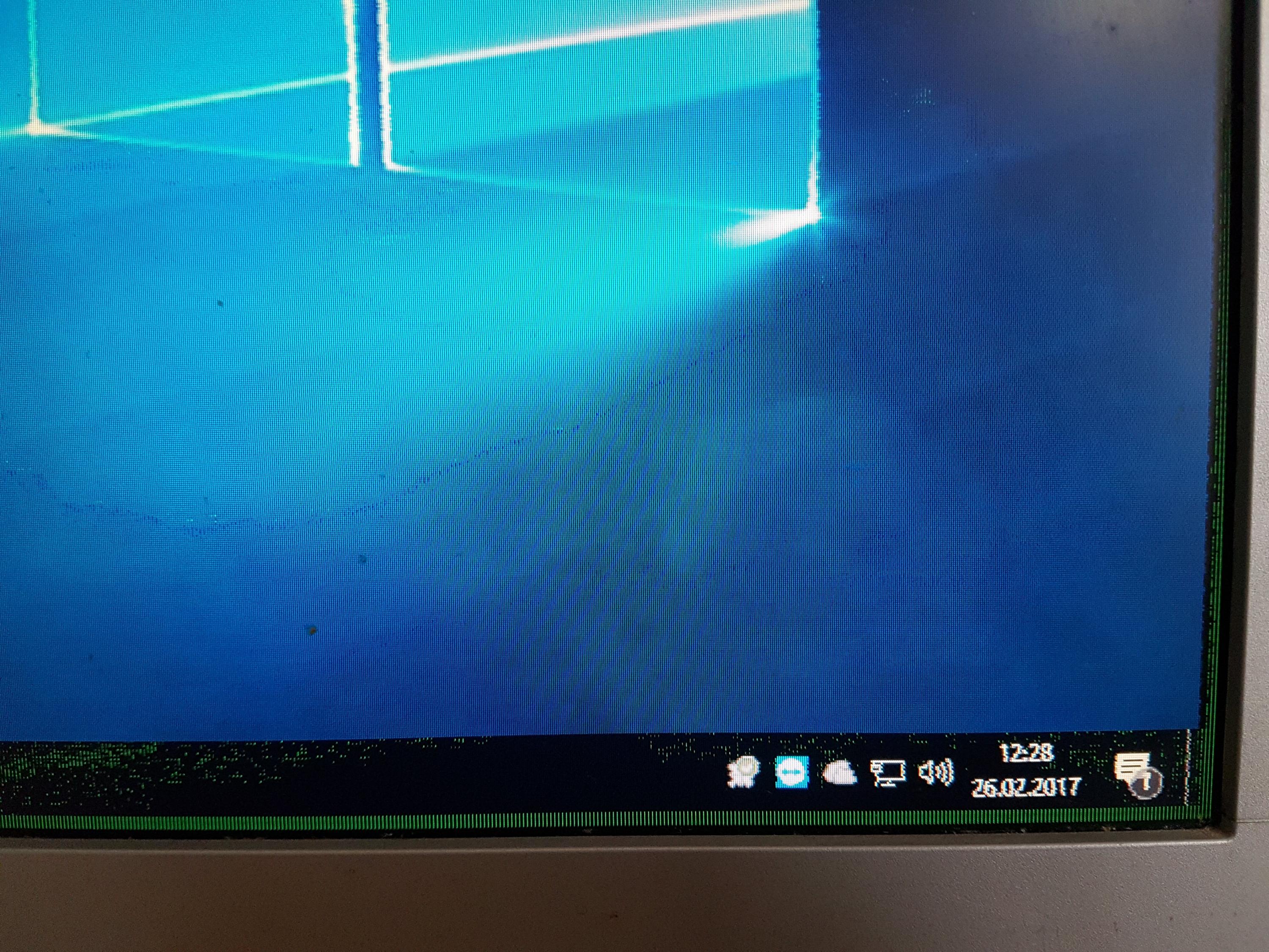

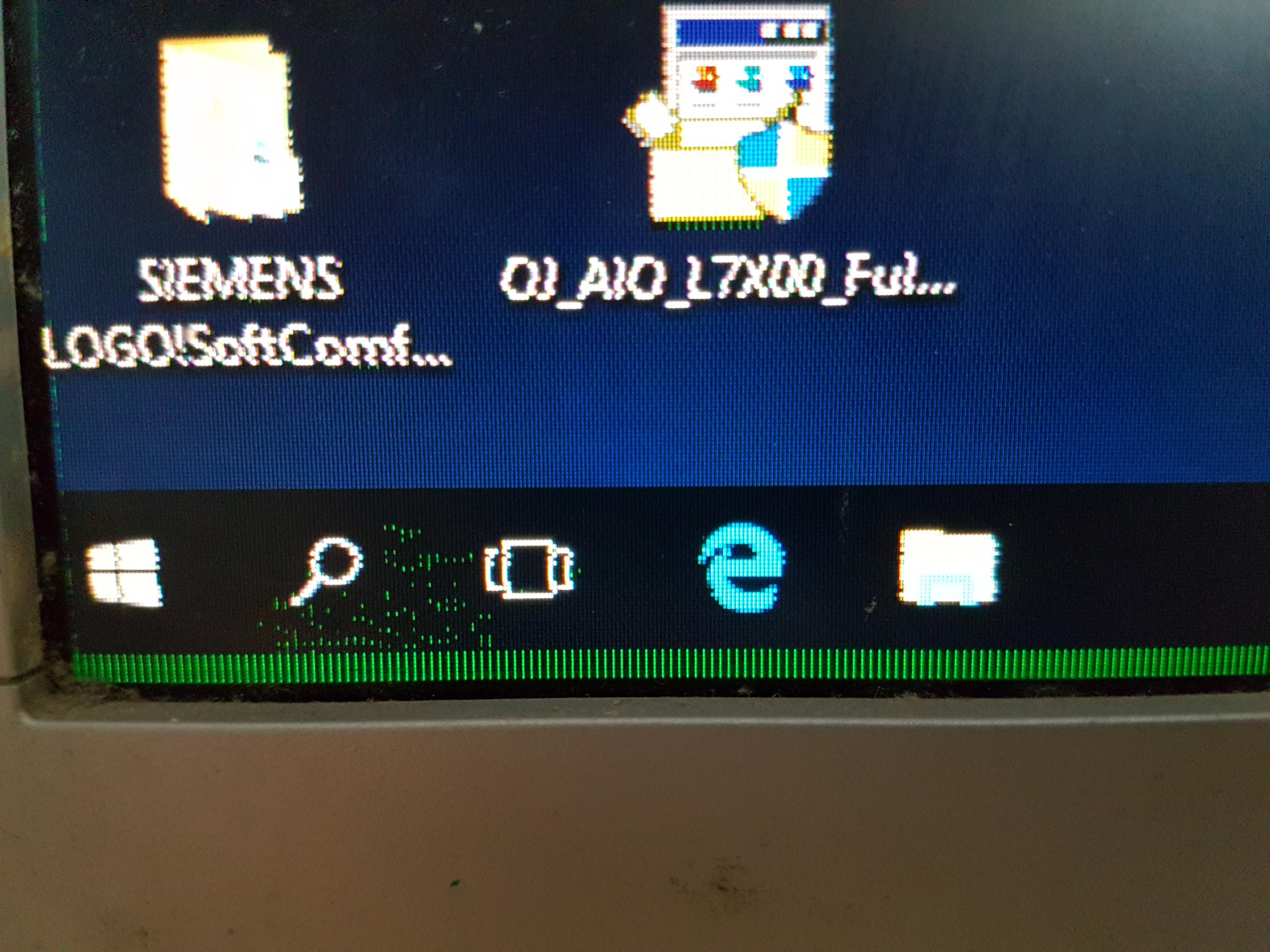

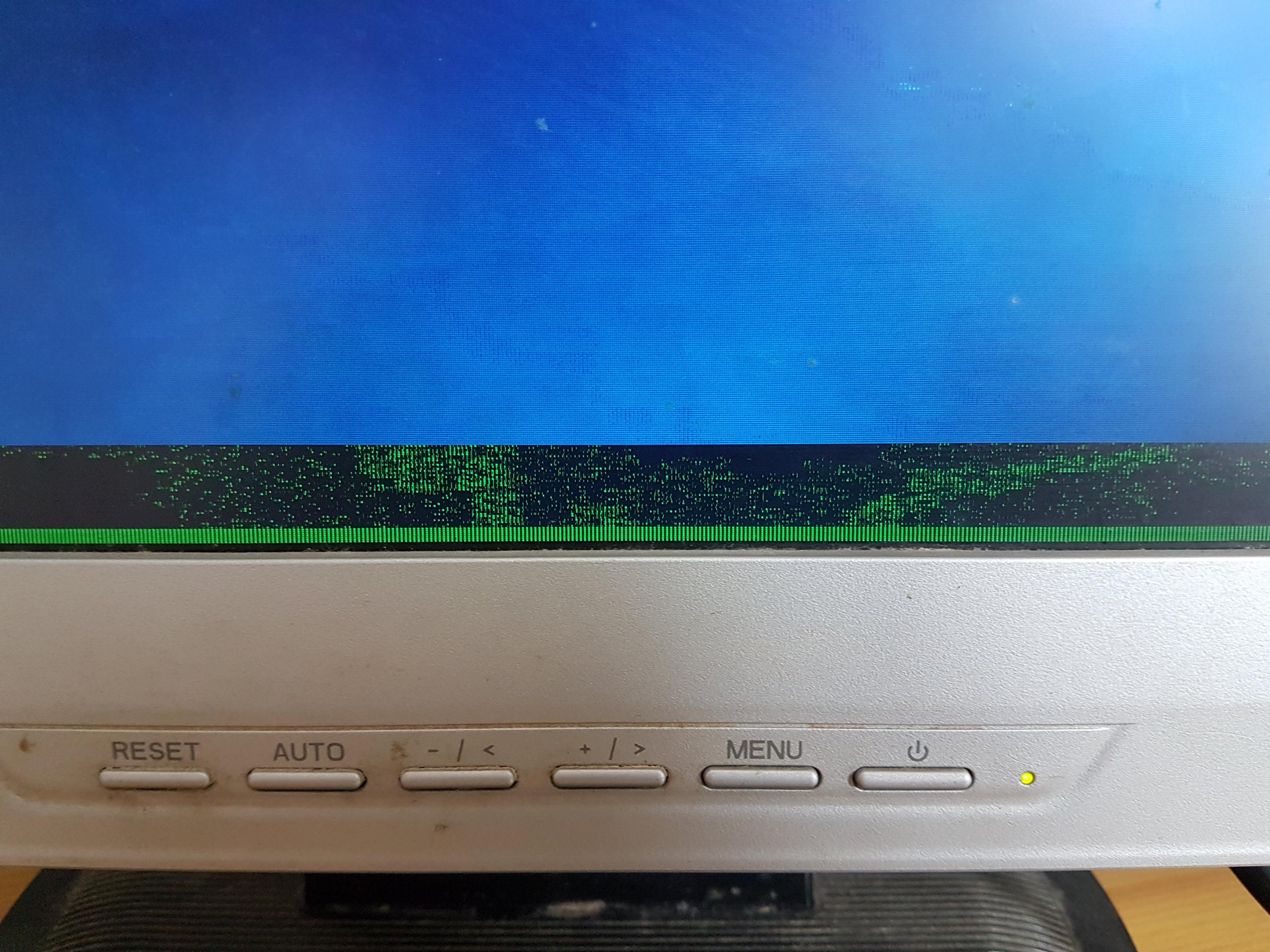

NEC LCD22WV - strange picture on the display
Re: NEC LCD22WV - strange picture on the display
I made it! - LVDS after triple cleaning with IPA patrially fixed it - but I had also to remove aluminium tape, that was holding tight connector to flex cable - tention on that element was causing green/red strange sthins on display.
Working all the time after doing that - even when I hit or vibrate whole monitor
