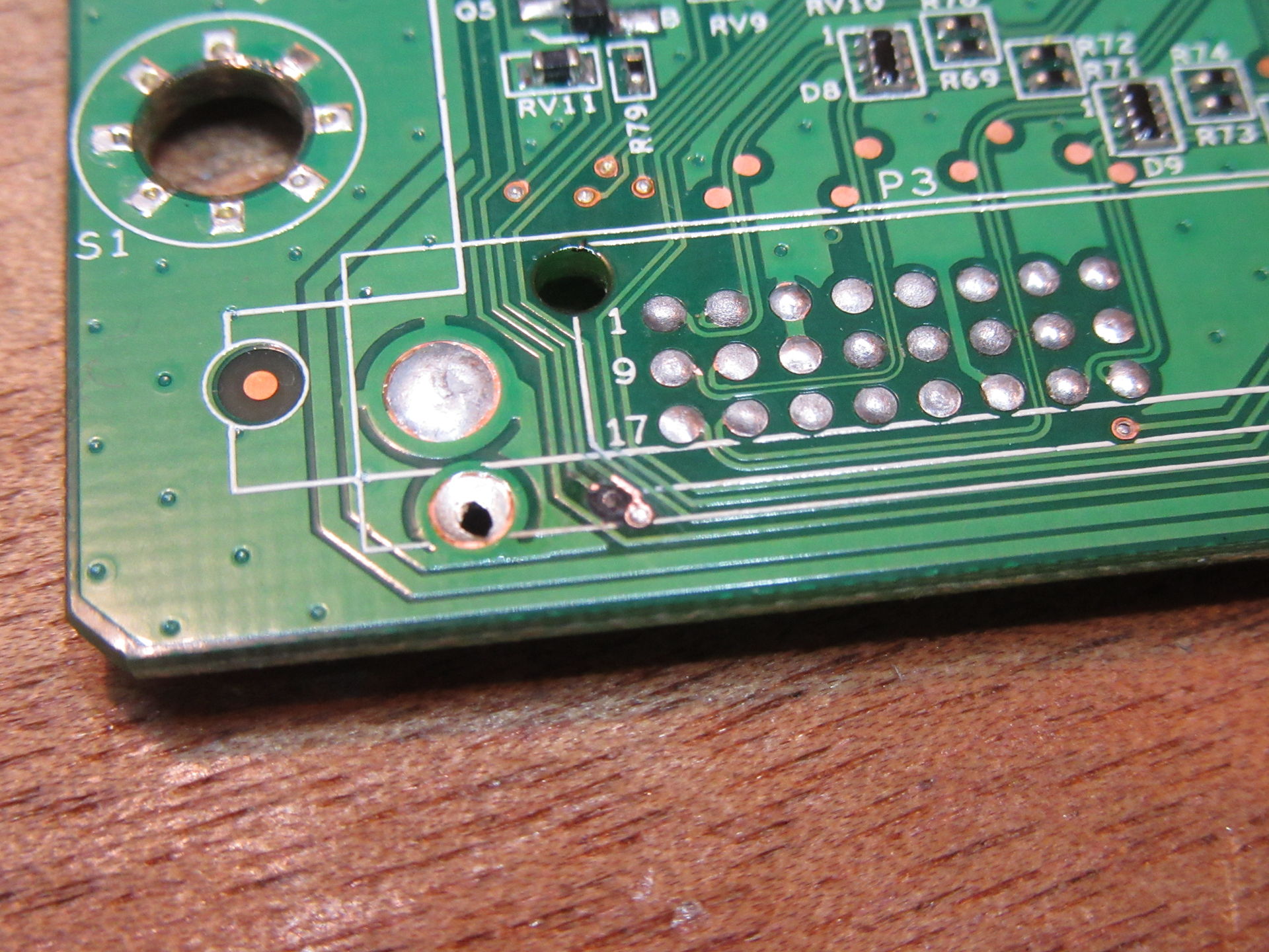

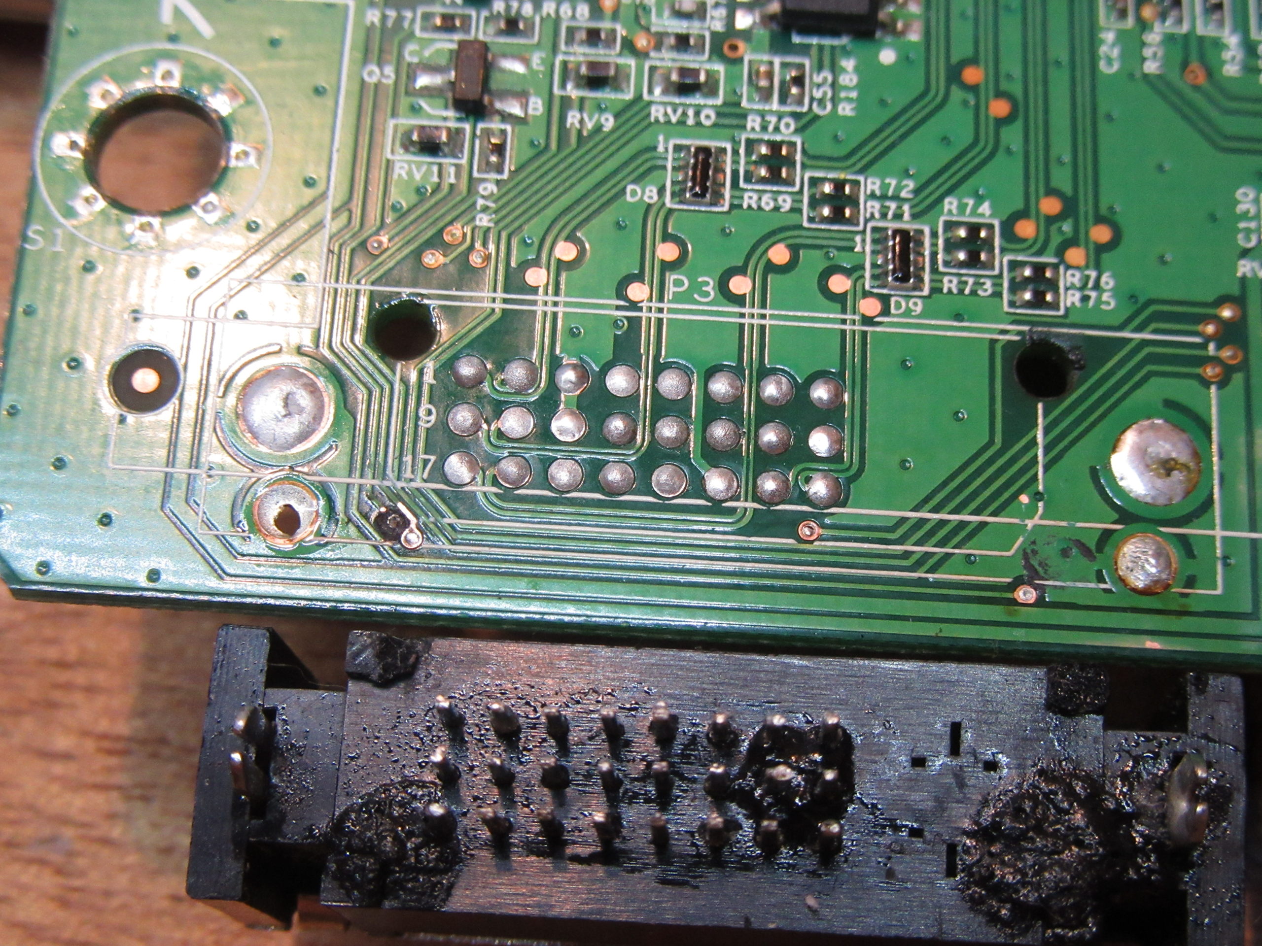

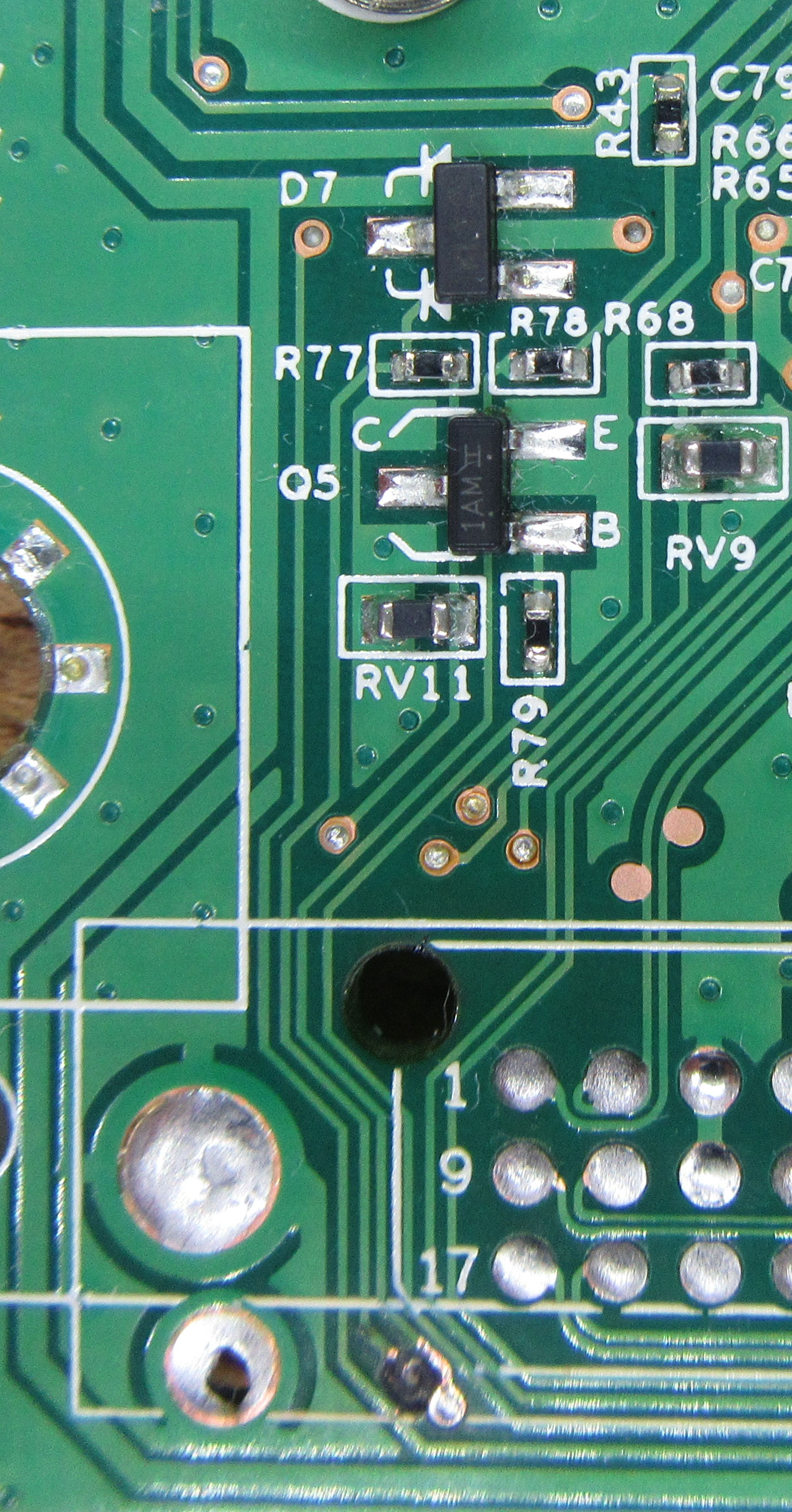

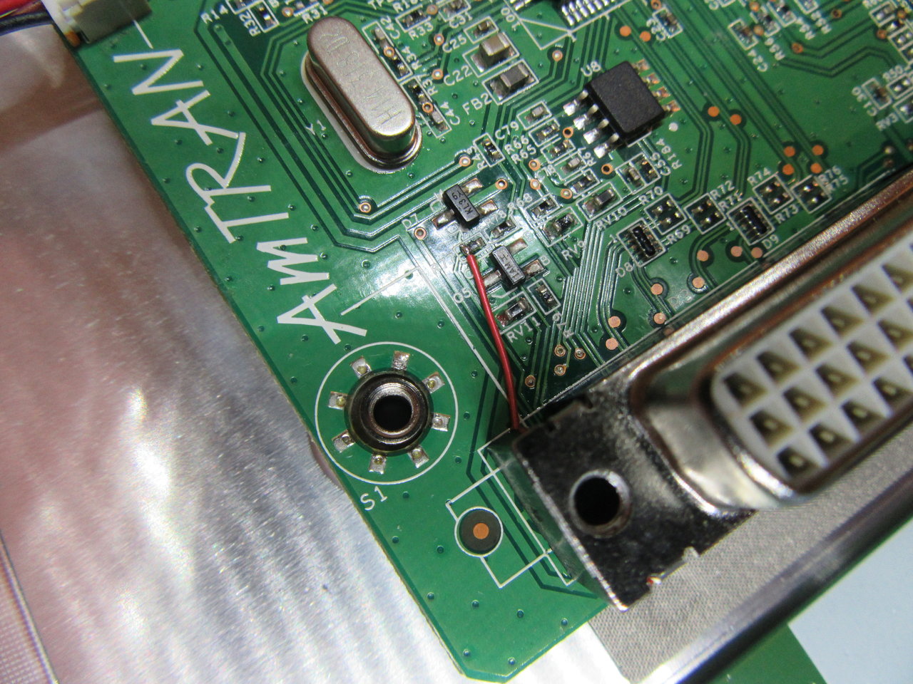

Finally I open it up. On first glances there's two things that strike me;
there's a faint splattering of coke-coloured drops all over both top and bottom of the black portion of the DVI socket ( you can see the effect on the underside of the DVI connector too in the picture )

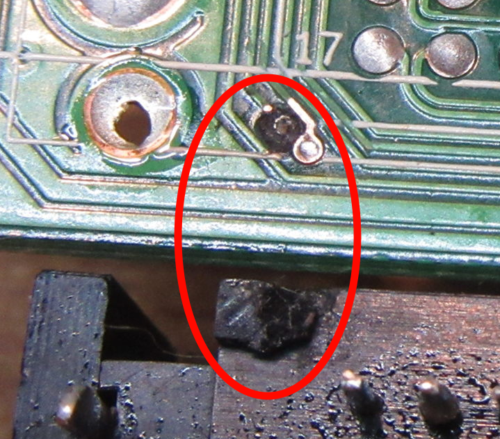

there's a small blob of plastic at the base with very faint charring around it

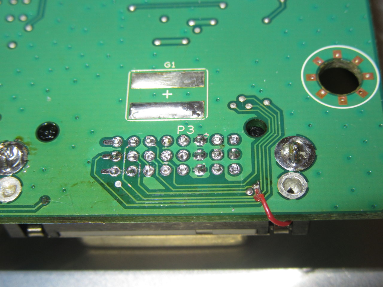

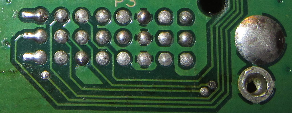

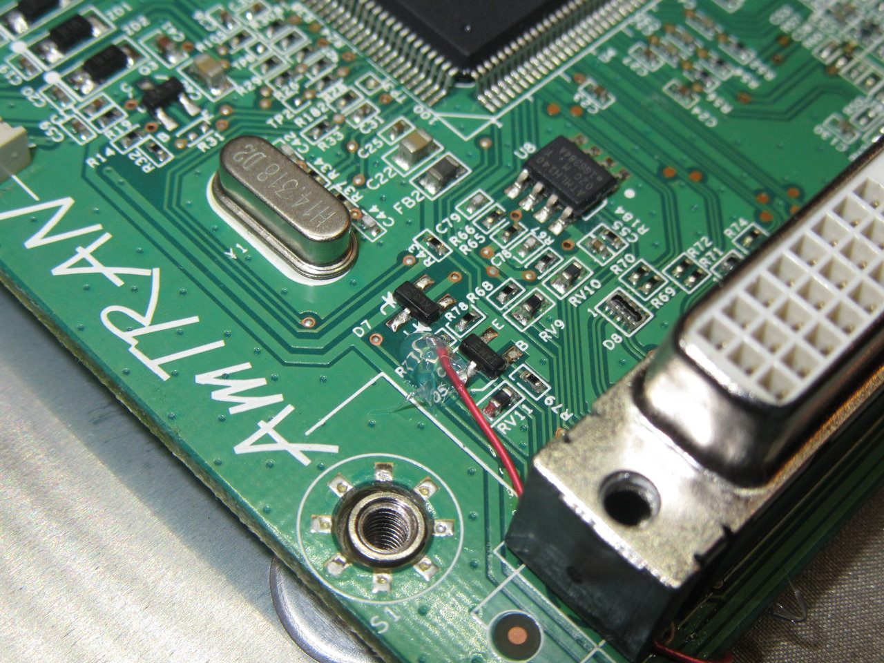

Firing up the hot-air I manage to extract the DVI socket off to reveal a pitted PCB at where I saw the blob.
The VGA side still works a treat, so I'm almost considering using it in the workshop as a status display.
