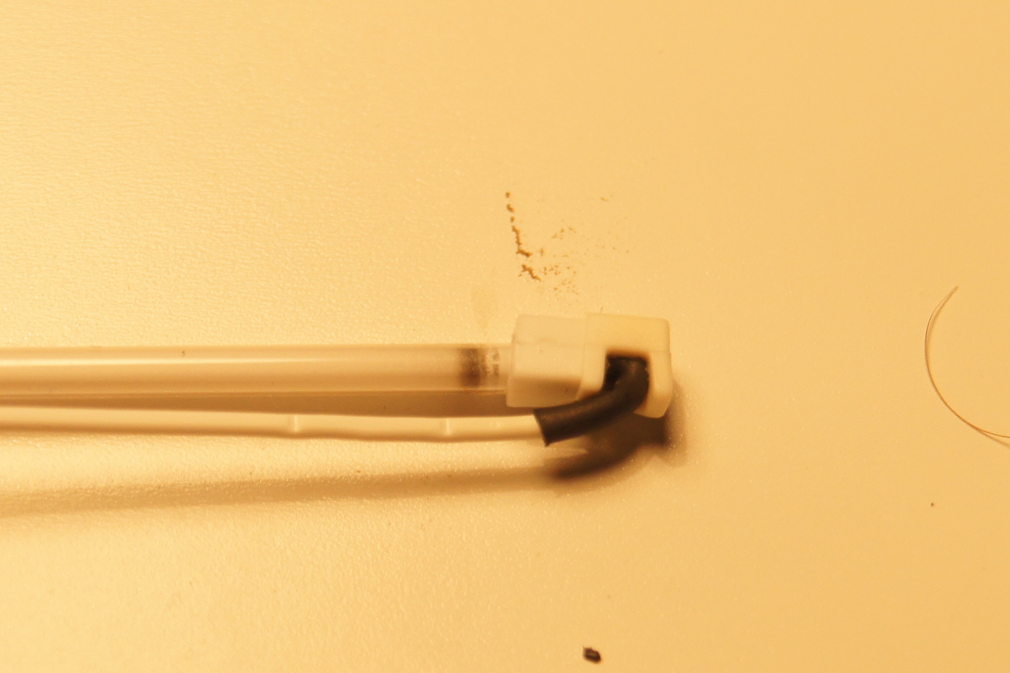

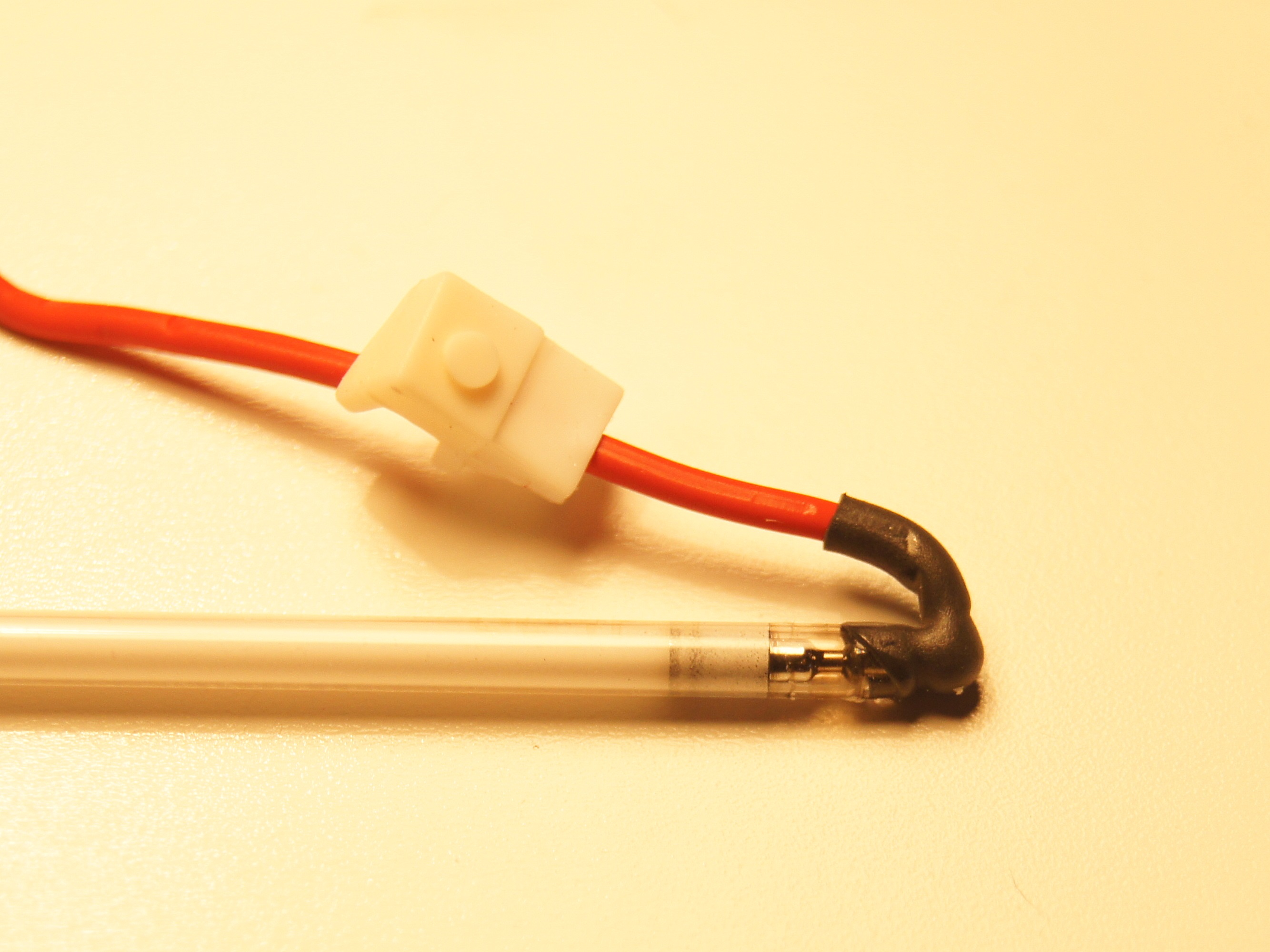

    Next I took the CFL tube out because I thought the connections on the end might be loose, I haven't cut the heatshrink off but it looks like the wires are soldered on? There are grey bands on each end.

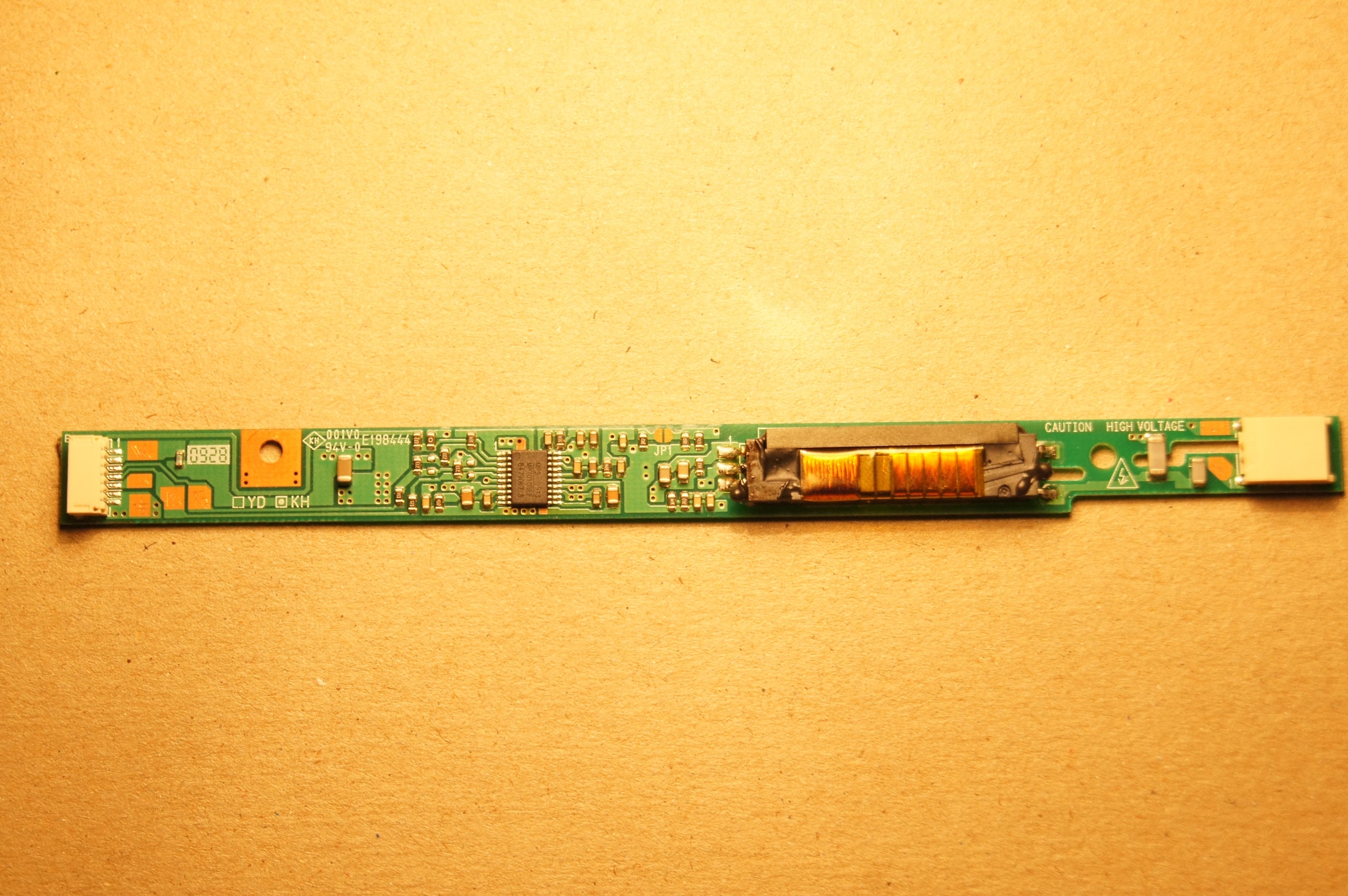

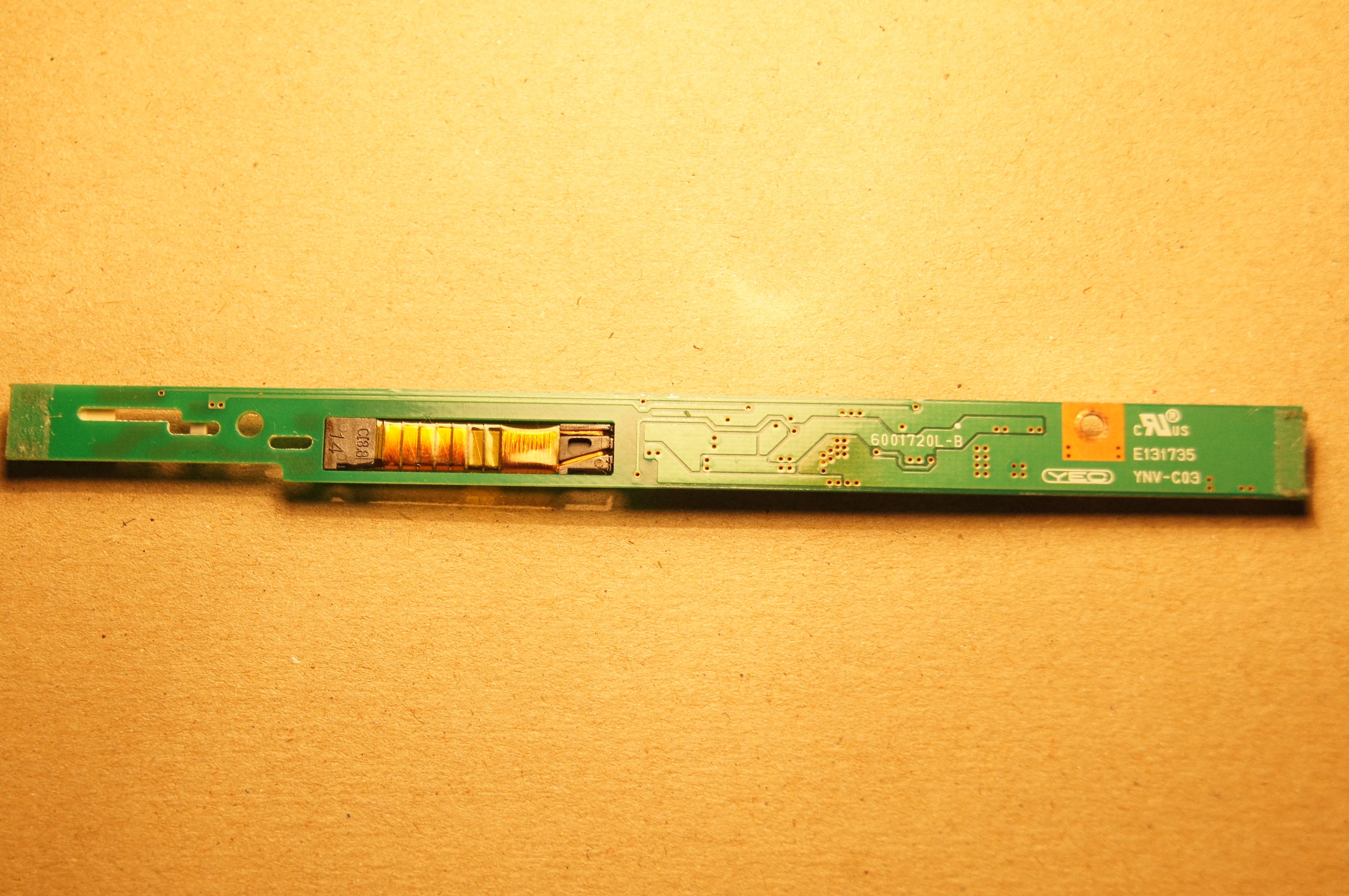

    Here's some pics of the inverter board itself. I would test it with a regular household CFL but I don't have a saw to cut one open. :/
