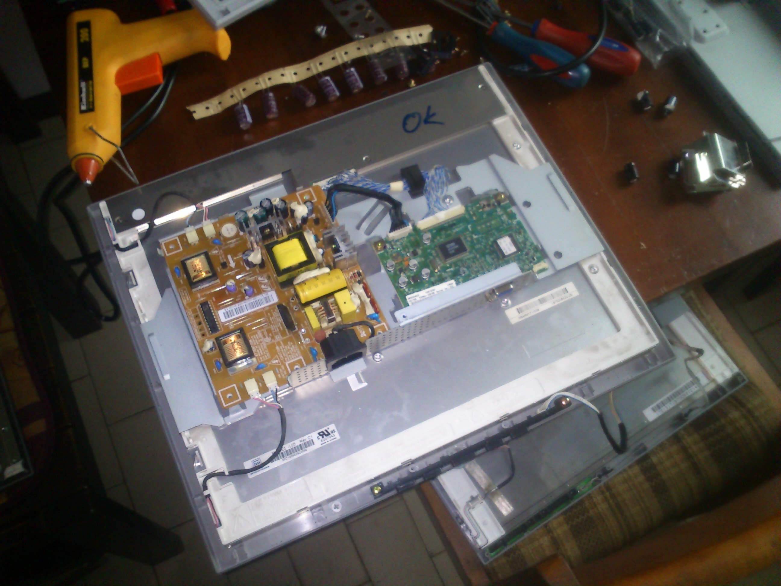

            Re: Samsung 933SN - 2sec on, then off
            Try setting multimeter on the 2000 Ohm and test 2 pins on lamp transformer (connector side of transformer) if its shorted (0 or 0L) its bad... if not you should get reading about 1100-1400 TEST OFFLINE!
            Try with another set of CCFL... Connect everything like it should but CCFL from another display... if lamps on other display are working its CCFL..........Try youtube to disassemble display... and if you are lucky you should get it working by resoldering CCFL.
            • Dragunov
              • Nov 2013
              • 47
              • Croatia
              To check voltages you need to get 2 boards out of metal casing....
              PUT PLASTIC/CARTON (NON CONDUCTIVE) COVER ON BACK OF DISPLAY... assemble boards on top of them and you can measure now....
              like in my picture BUT WITH PLASTIC UNDER BOARDS! ... (this is a bit diferent but you will get the point).

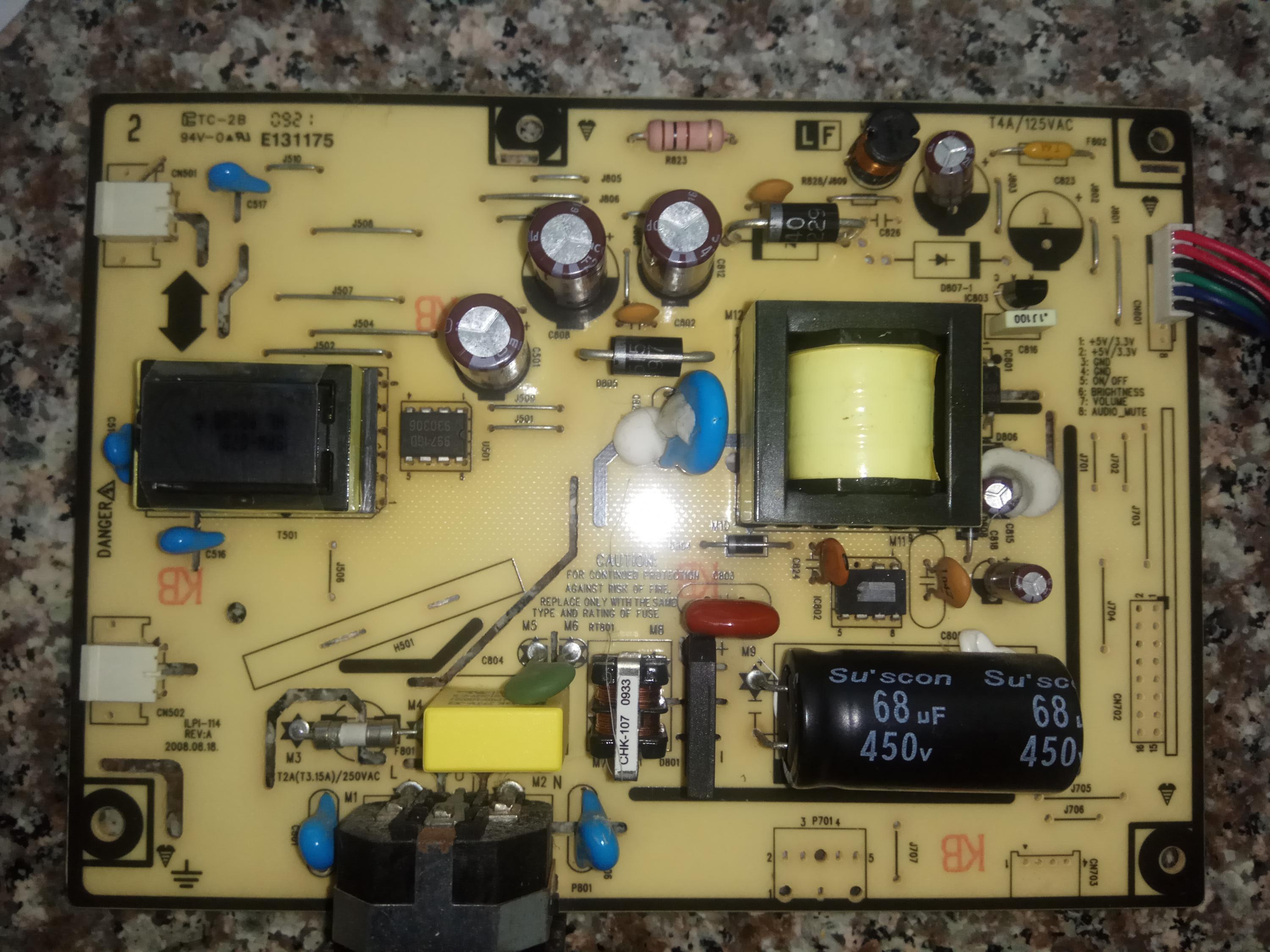

                          I know this is an old post but I have exactly the same power supply board on an LG Flatron W1941S. One of the chips is blown (IC802) and I cannot read the number. Can someone please tell me what the number is. Its probably a dual FET ic. I have downloaded a schematic which also does not make any sense as it does not tie up with what's on the PCB. Pin 3 is not used nor is there a pin 3 on the chip. Pins 5,6,7 and 8 are all joined together. See the attached pic of the board.
                          • redwire
                            • Dec 2010
                            • 3900
                            #33
                            LG W1941 service manual 2008 has some other power supply, it's not the W1941S service manual but label says it is.
                            OP has power supply IPLI-130 491861400100R
                            Your pic is power supply IPLI-114 491821400100R
                            U802 is a TOP Switch, but I can't read the full part number.
                            TOP25?PN. Guessing TOP256PN or higher power rating.
                              Thank you for your response. The top of the IC 802 is blown off! Looks like there are different versions of this power supply. I'll try the TOP256 and hopefully it should work. Will check the PCB first - trace tracks and make a little drawing to make sure I'm doing the right thing.
