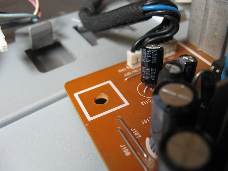

    It was quite some time ago I've mentioned about seeing general purpose or standard capacitors being used in a switching power supply especially at the output filter section (right after the rectifiers). Well, here is one of them, a Samsung SyncMaster 713N LCD monitor with those type of capacitors at that critical section mentioned...
    - Image #1: 2x 1000uF 10VDC 105C, CapXon KM series (for +5V rail, right after the rectifiers)

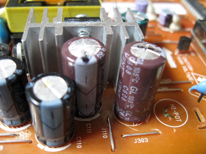

    - Image #2: 1x 330uF 10VDC 105C, Samxon KM series (for +5V rail, right after the choke/inductor)
    Furthermore there were no ceramic capacitors in parallel with them! Surprisingly they lasted this long (in a switching power supply environment).

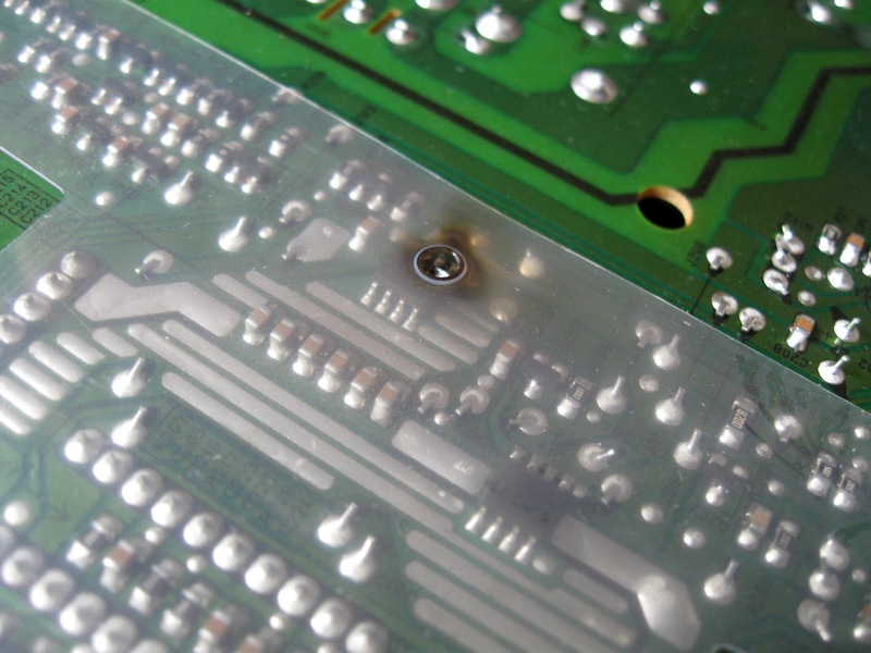

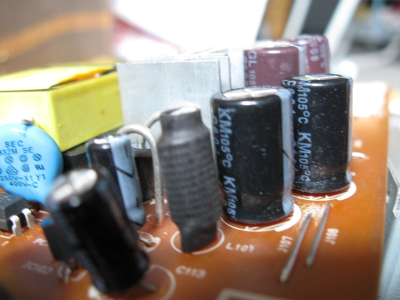

    Anyway, the problem with this monitor was 2 seconds to black. The faults found were badcaps and a blown MOSFET...
    - Image #3: 2x 820uF 25VDC 105C, CapXon GL series (for inverter power rail)
    - Image #4: 1x SP8M3 MOSFET (for inverter transformer)
    Already fixed/repaired the fault by replacing them. That LCD monitor is now up and running...
