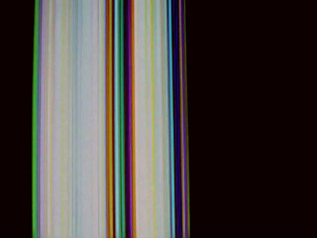

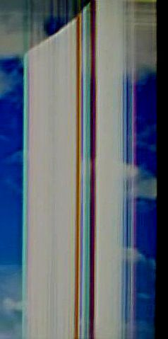

    ASUS VS247 Series LCD Monitor
    This monitor vertical lines on the right side of the screen
    view attachments
    If this was a tablet I would say broken screen.
    Has anyone seen this before ?
    Could it be caused by bad caps?
  • Topcat
    The Boss Stooge
    • Oct 2003
    • 16958
    Re: ASUS VS247 Series LCD Monitor
    Classic of a TCON problem or a bonding tab problem. First thing I'd do is make sure all the ribbons between the panel and tcon board are seated securely. I've fixed a bunch by simply doing that. Indicators of bad bonding tabs is the issue coming and/or going with heating/cooling of the monitor.
      I would ask to someone in the house if he has played Tennis in the room! It seems cracked
      (but poor images)
      • Topcat
        The Boss Stooge
        • Oct 2003
        • 16958
        Looking at the first picture, I have to agree....didn't see that the first time.
