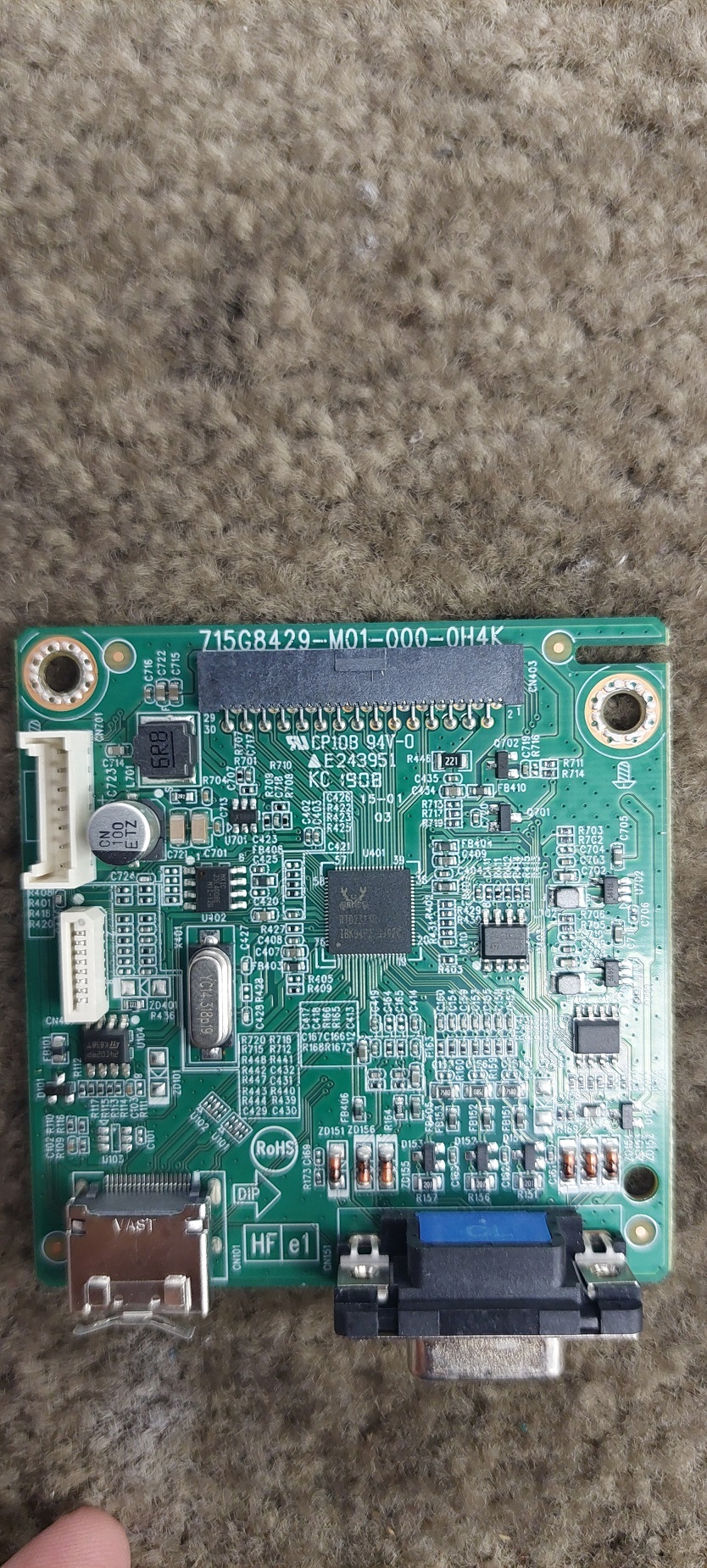

    Hi Guys, i just have a question that is probably easy to answer if you have experience on such matters.
    My Dell Monitors screen was damaged by lightning via the HDMI port. The monitor does come on but cannot display HDMI or VGA image. it says no signal.
    I have ordered the board on Aliexpress. They say 100% working. Don't trust. it.
    My question is, after installing the new board, is there anything else I need to do in order to make this board work. I know on some TV's you need to load software on the board to make it work but this is a monitor or even having to go into service mode?
    Anybody gone down that road?

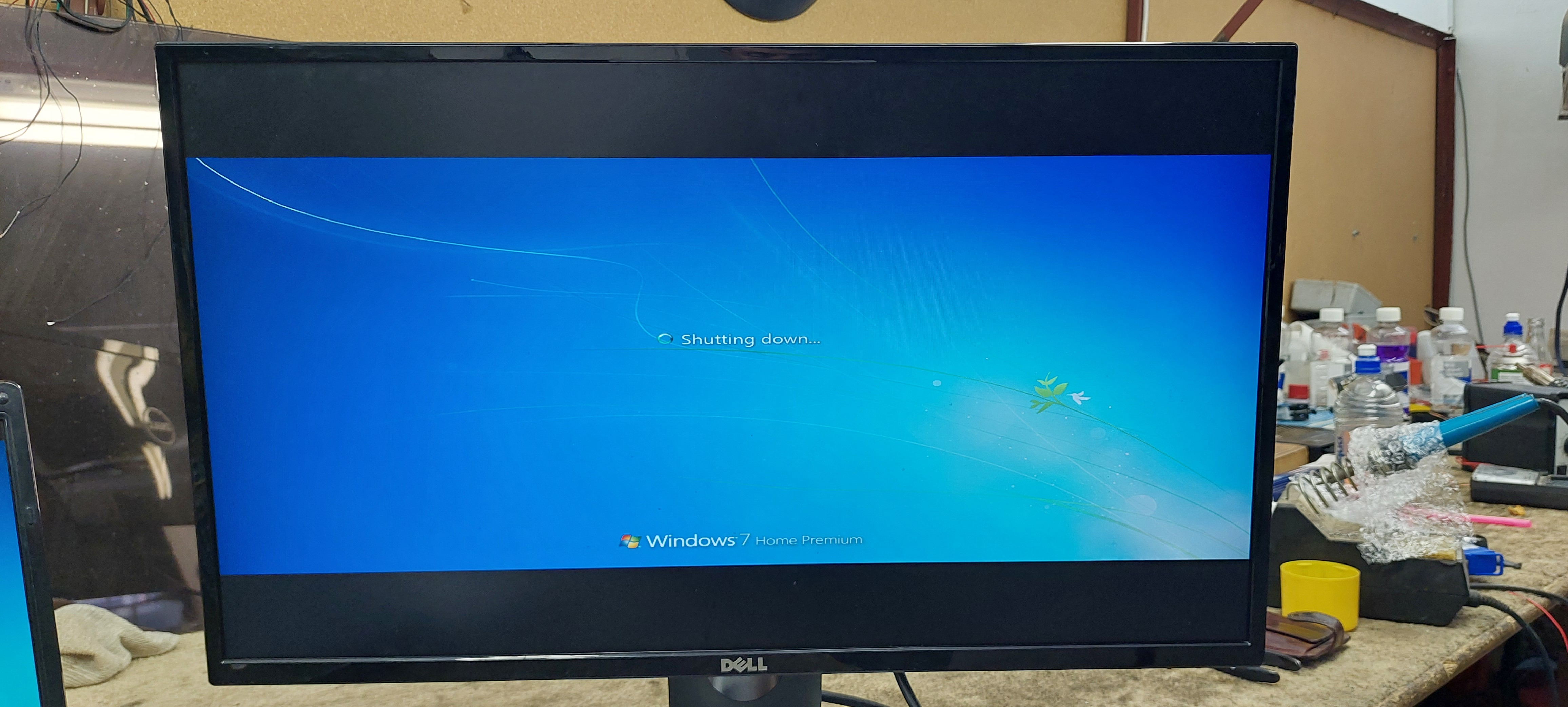

        Just an update, but replacing the main board on this Dell is as simple as plug n play. No funny tricks to get it to work.
