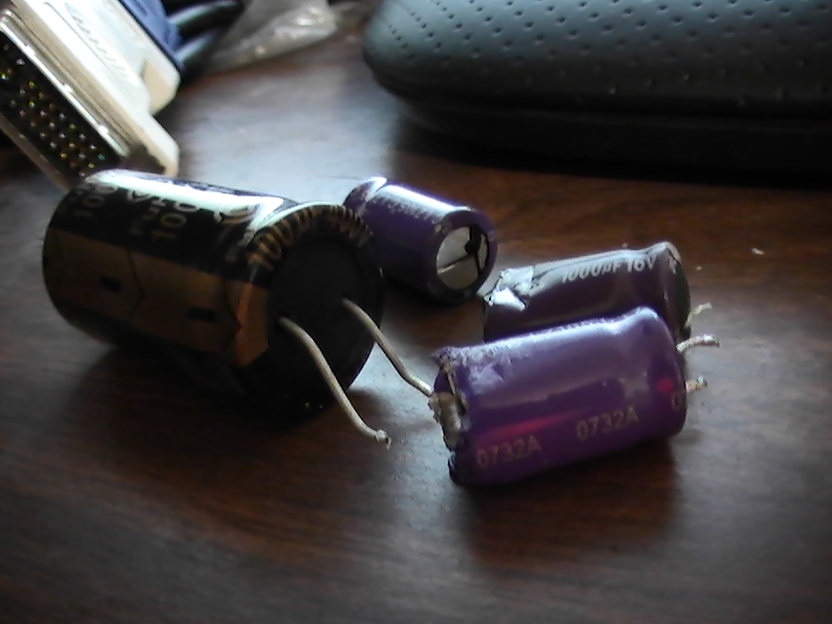

this is a soyo display that was flickering and had a shaky image when music was played through the onboard audio, it was tested and was a very obvious problem which even caused the display to shut down when i played "Sub Antix & Elliot Mars - Defend Earth" through the onboard audio.

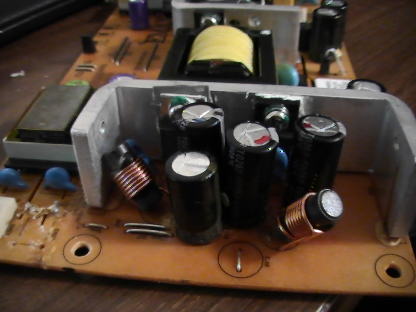

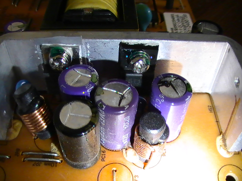

diagnosis: failed filter caps on the PSU all 4 made by "hermei" and a bad ground between the two boards.
one of the filter caps got so hot it discoloured from purple to brown ( no not the one on bottom left, the one in the centre), they were replaced with rubycon caps.

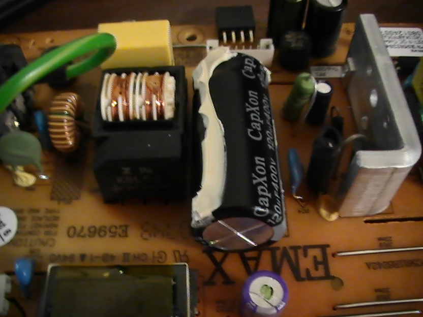

the main PFC cap was also failing, this cap was made by fuhjyyu ( i think its pronounced "fuck you"
) and was replaced with a capXon which i have never had problems with as a PFC cap; although this cap is an extra 20uF it seems to work fine.
the bad ground was caused by a bad solder joint at the pin header.
i screwed up and put 2 caps in backwards.
