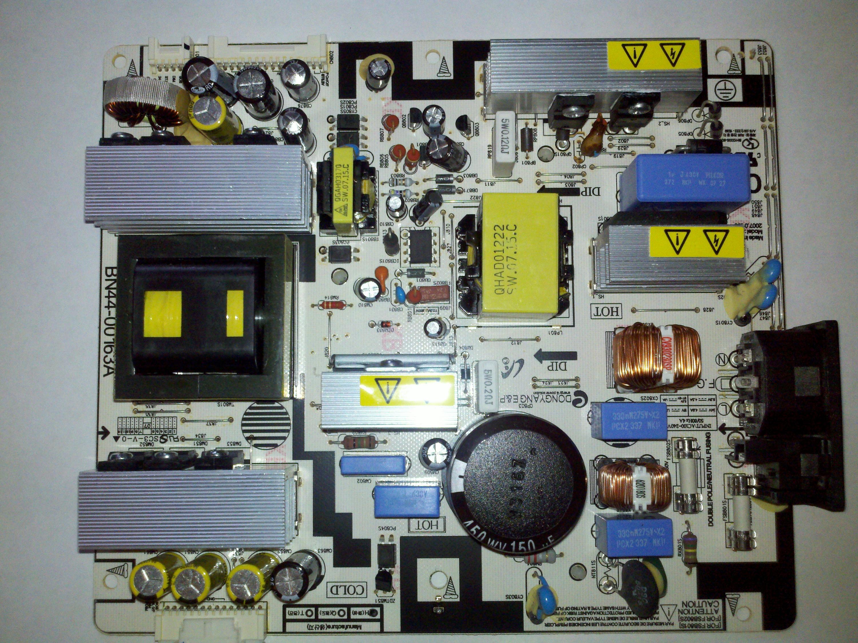

    Hi all, my Samsung 275t Plus no longer turns on. When the problem started it took a significant amount of time, up to 10 minutes at times, for the display to turn on. It did not matter if it was a cold boot or coming out of sleep mode. Flipping the power switch in the back off, then on again would usually get the display to turn on. After awhile the display started to turn off after a few seconds. I should note that the power light indicated that the monitor was off, so this doesn't fall under the "2 seconds to black" category.

    Here is a picture of the PSU board. From what I can tell, no capacitors are even bulging. I was wondering if perhaps the large one could be the culprit?

      you have 2 bad caps on the board I can see them in the pic the one is c8876 and the one be side it

        and it is best to put all new caps on the board if you can

          Thank you so much. Good eye! I just emailed this store with the information for my board. Hopefully they can help me replace all the caps on the board.

            You can always get the capacitors from the badcaps.net store, mouser, or digikey too.
            When choosing replacements, make sure they are low-esr (not ultra-low esr!), have the same voltage rating, and the same capacitance rating as the original. Be sure to get a cap rated at 105 degrees Celsius. It does help if you try to find the replacement capacitor in the right size too. If you are not sure, just ask us (the forum).
