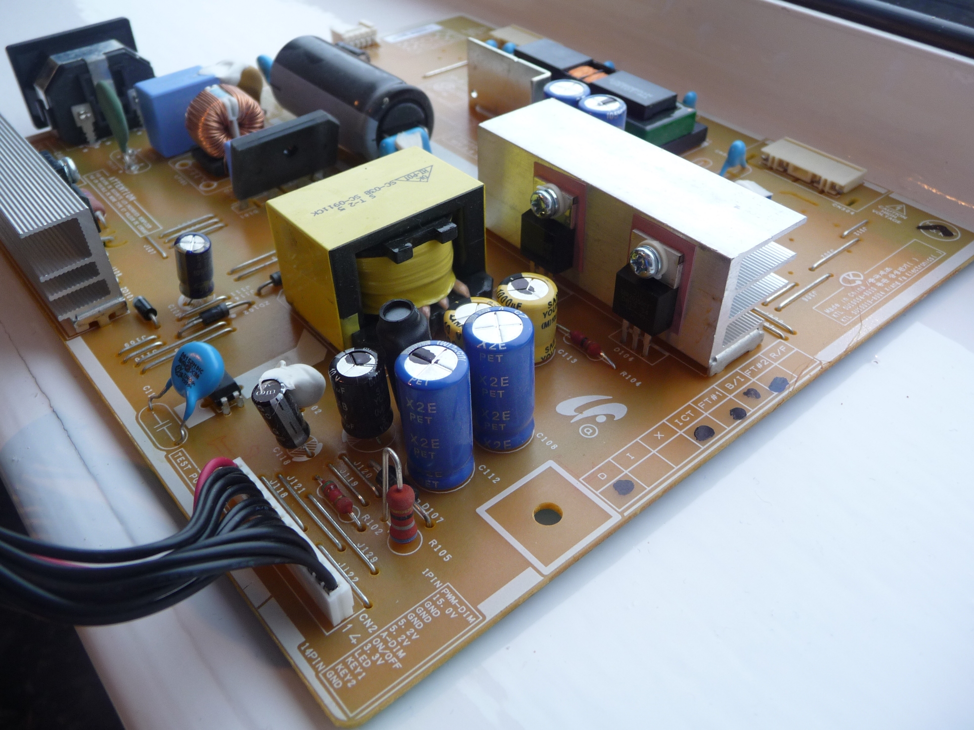

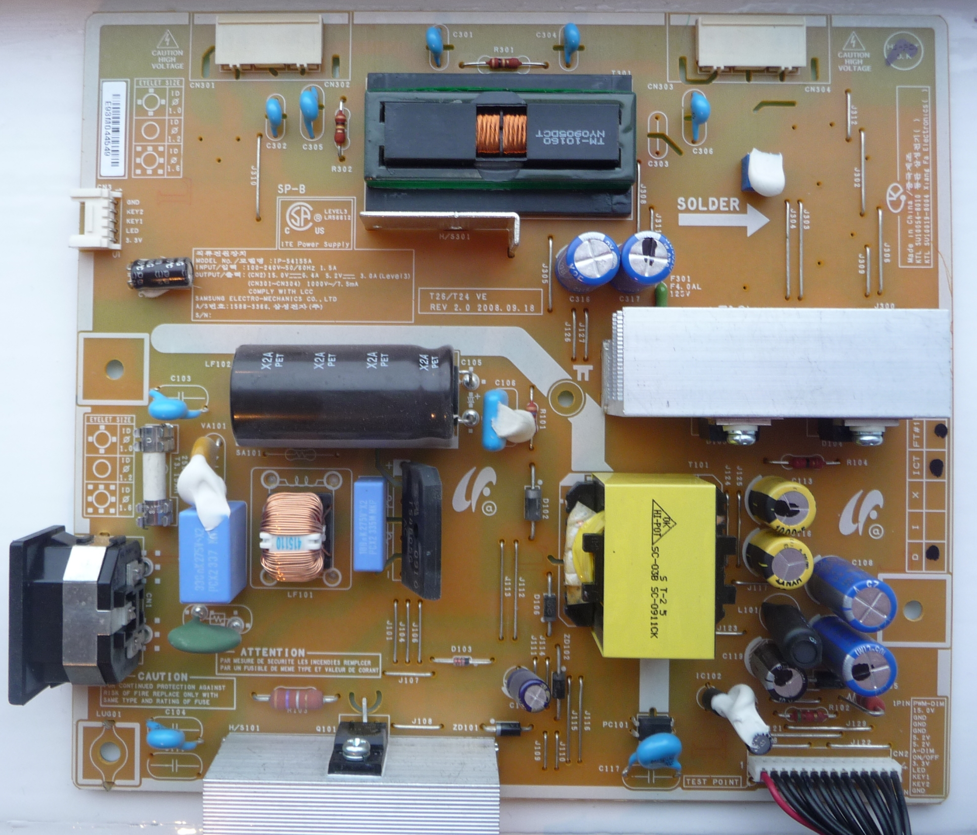

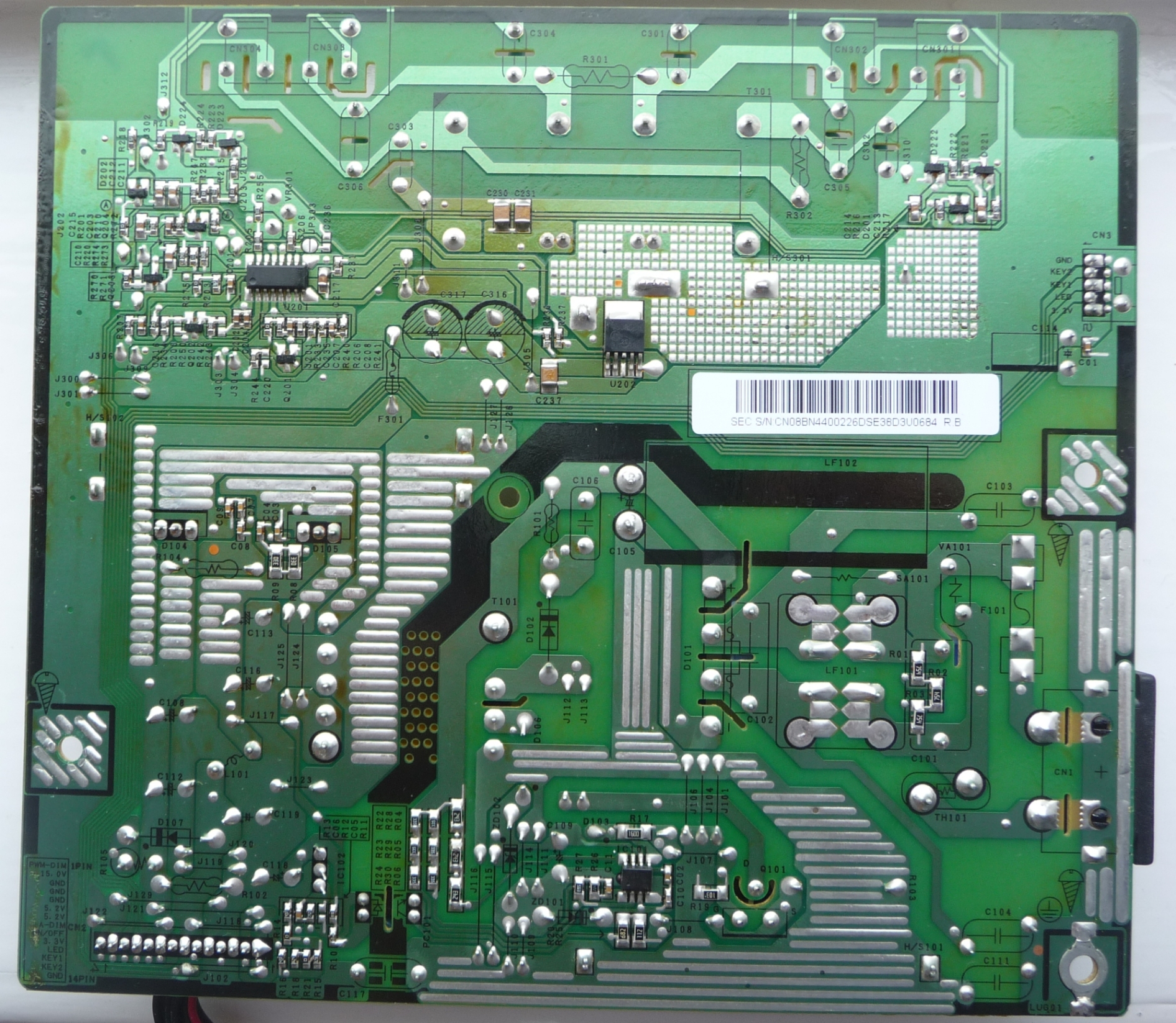

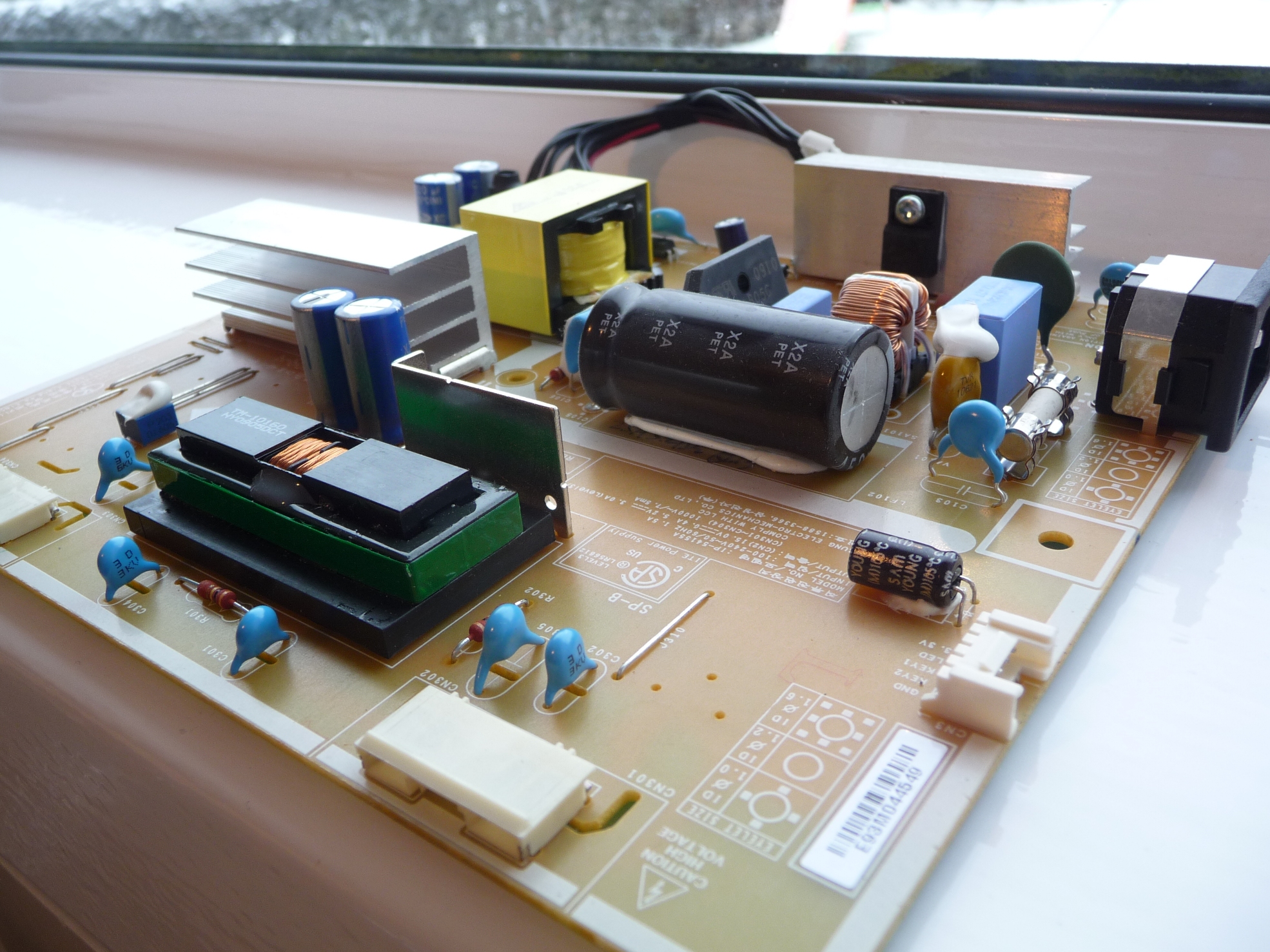

      Thanks for the reply. I'll have a look at the CCFLs later but in the meantime here's a few pics of the board.

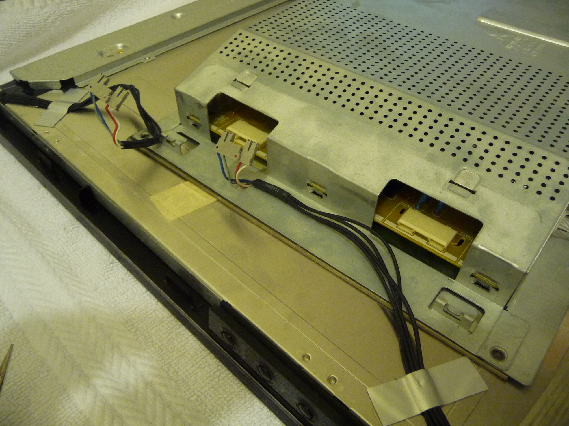

        Okay, so I've not got a spare CCFL to test with and I've not taken the panel apart to look at them so I did the following test:
        1) Plugged the bottom set of lights into the bottom connector (rightmost in the picture) and powered up. No image at all.
        2) Plugged the top set of lights into the bottom connector. No image at all.
        3) Plugged the top set of lights into the top connector. 2 seconds to black.
        4) Plugged the bottom set of lights into the top connector. 2 seconds to black.
        With my limited knowledge this suggests that it's likely that the CCFLs are fine as both gave exactly the same results and lit up in the top connector before going black. If one set was dodgy I'd have expected no light at all from it.

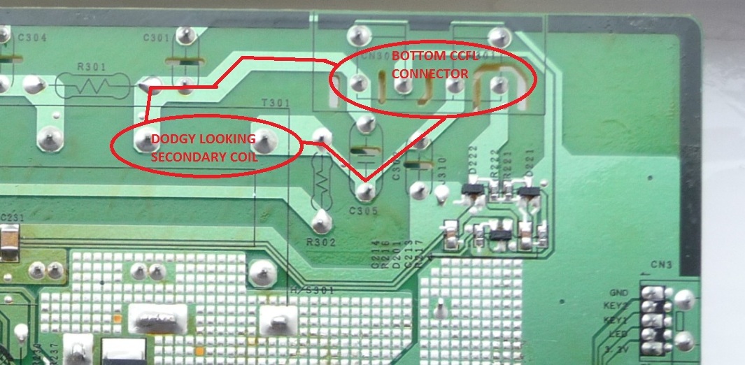

        When I noticed that the bottom connector didn't cause the lamps to light up at all I looked at the back of the pcb to try to see if there was anything up with it. It looks to me that power for this connector is routed through the secondary coil with lowest resistance (918) which seems to suggest that the inverter transformer is in fact the problem.
        So, what do you guys think? Have I solved the mystery?
          I can't tell from the picture, but try reflowing/resoldering all the joints regardless how they look in that section you highlighted in red.
          If that doesn't help, then the inverter transformer is the likely suspect.
