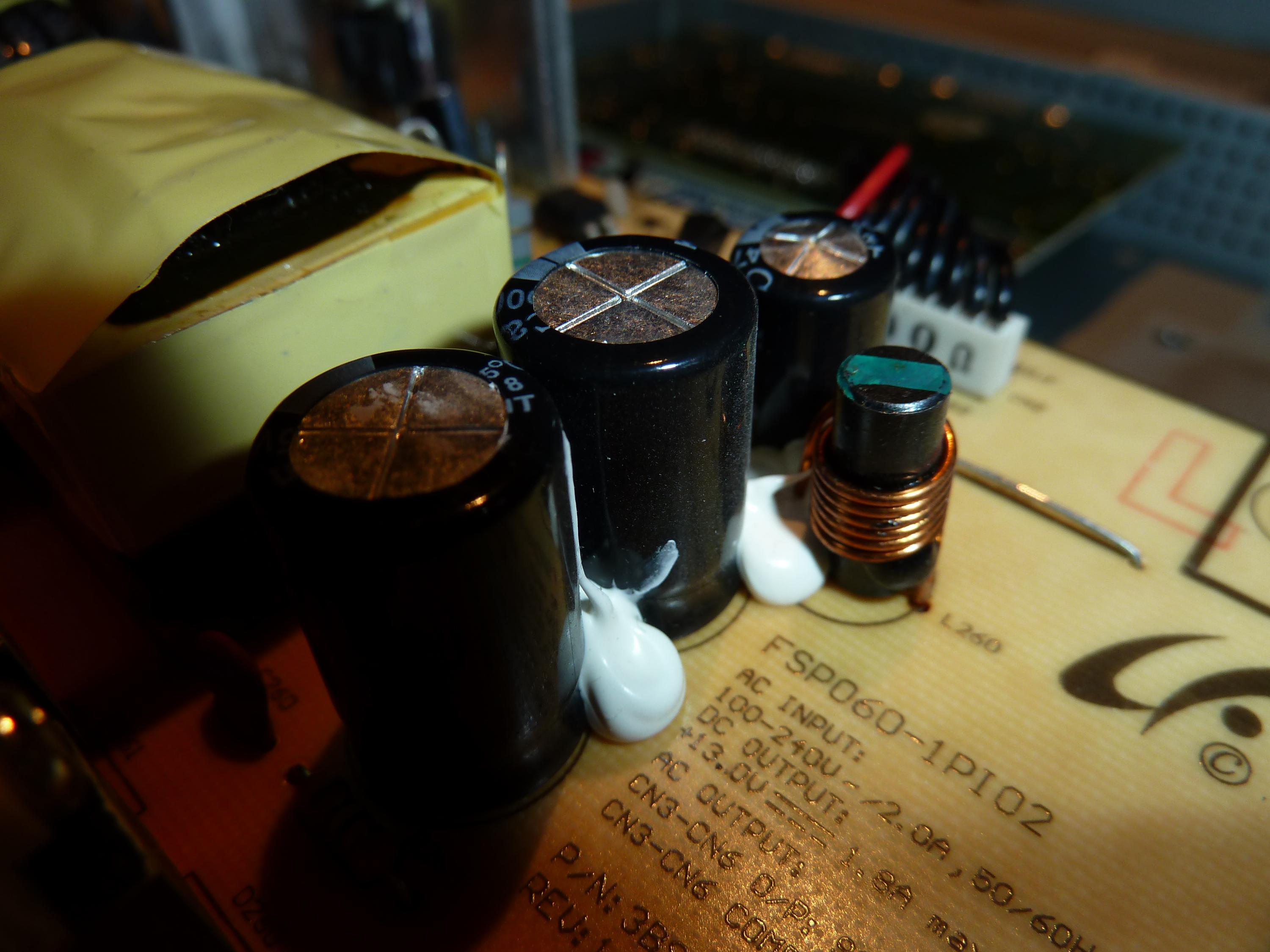

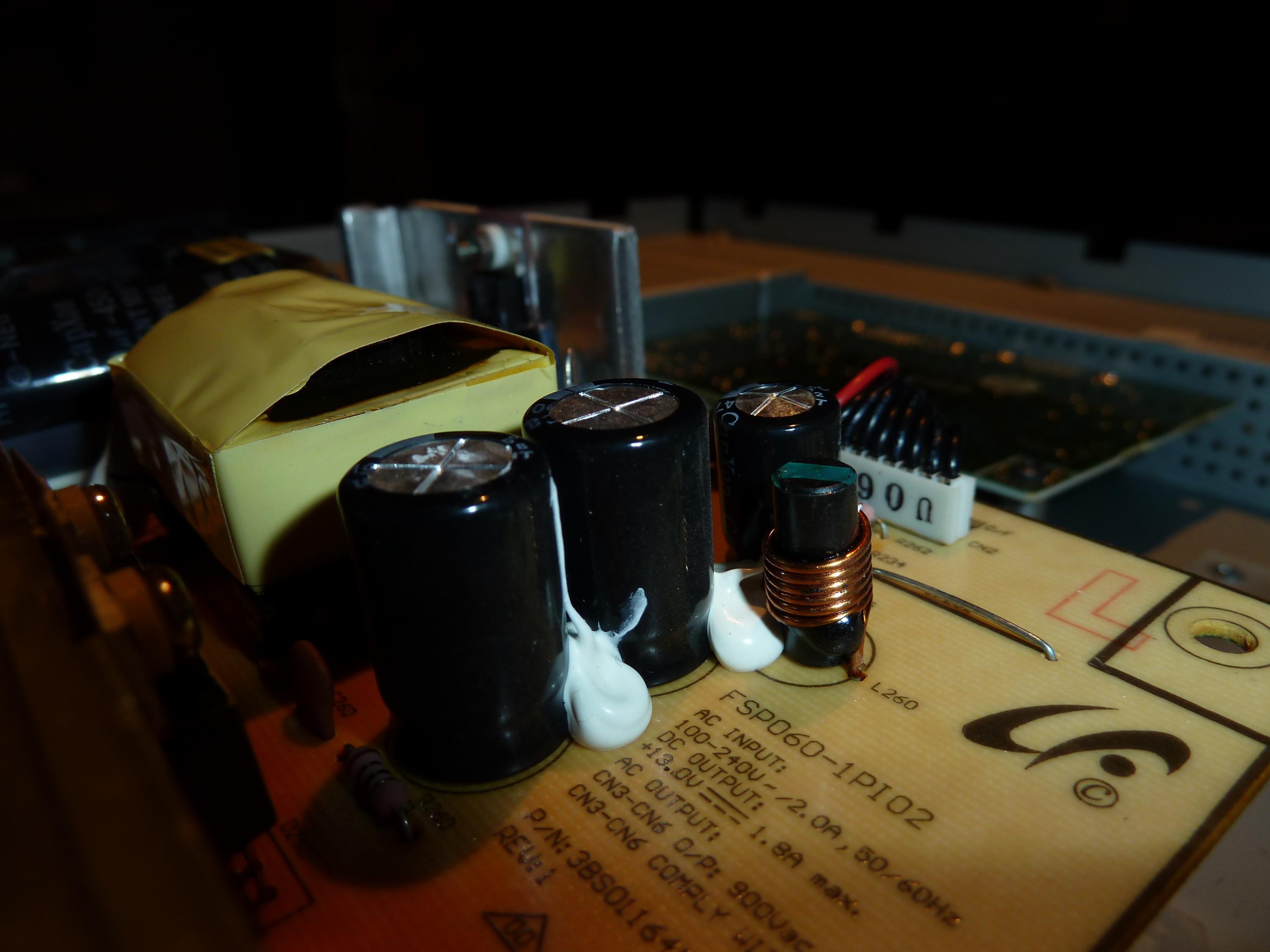

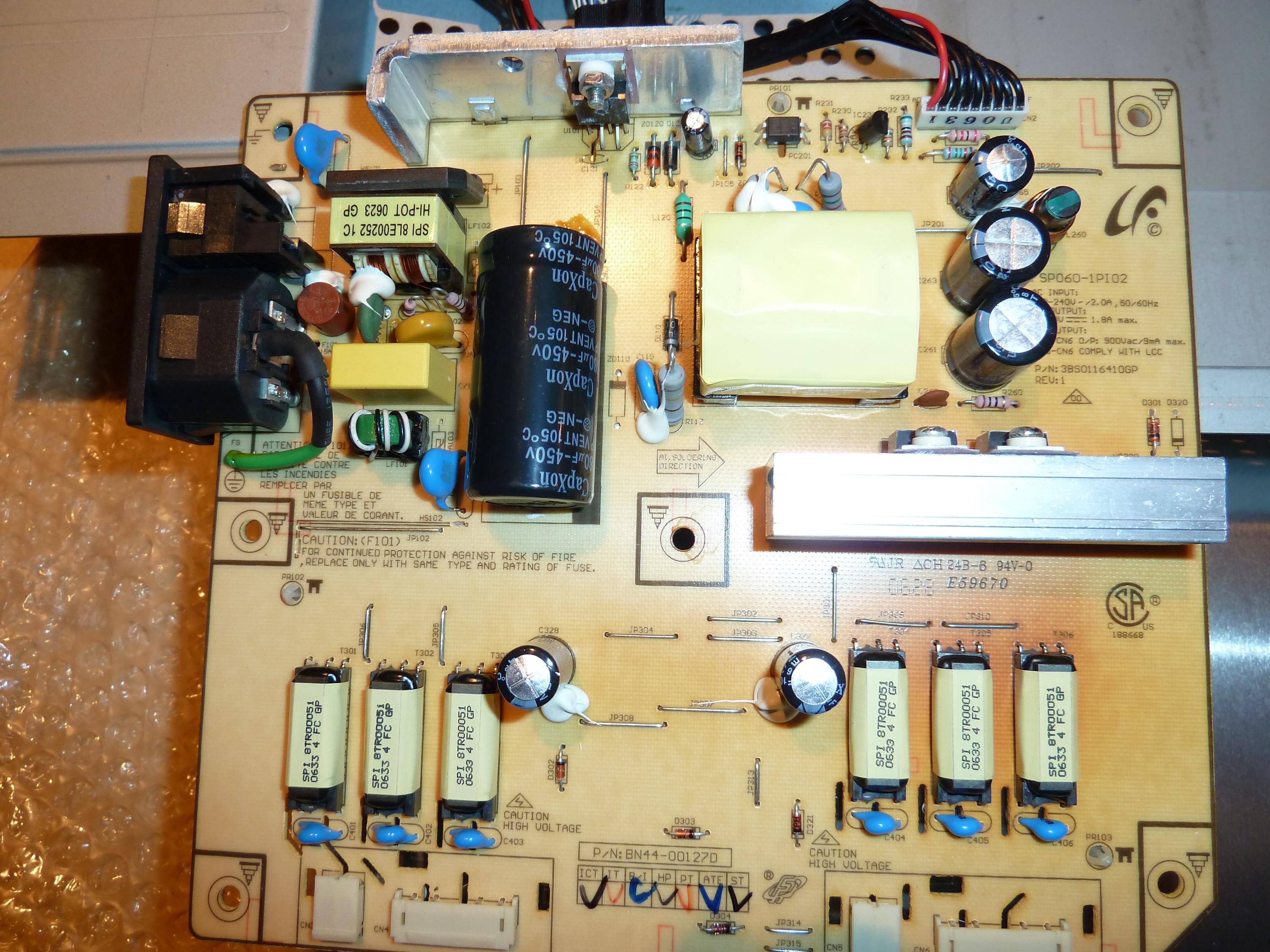

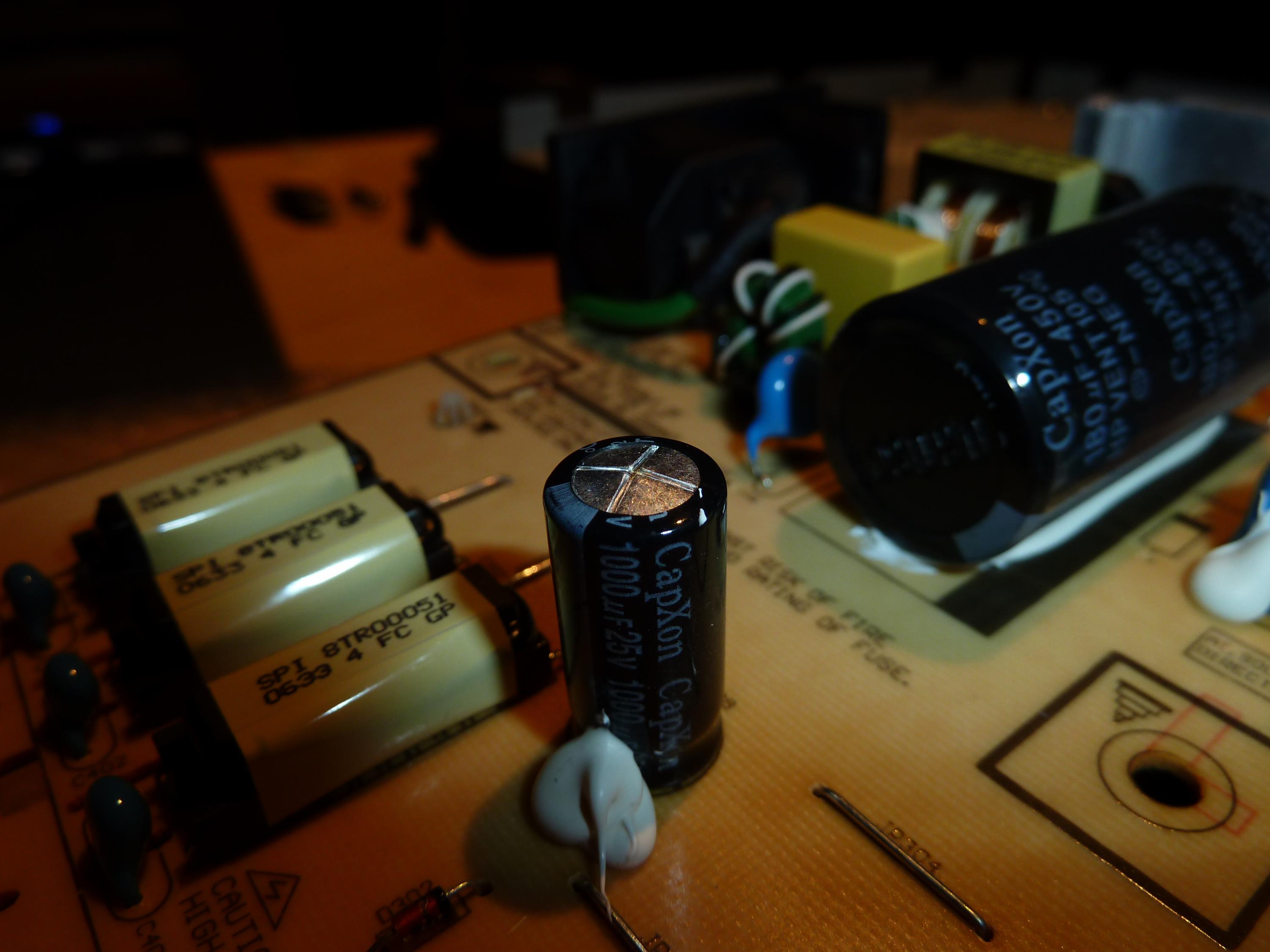

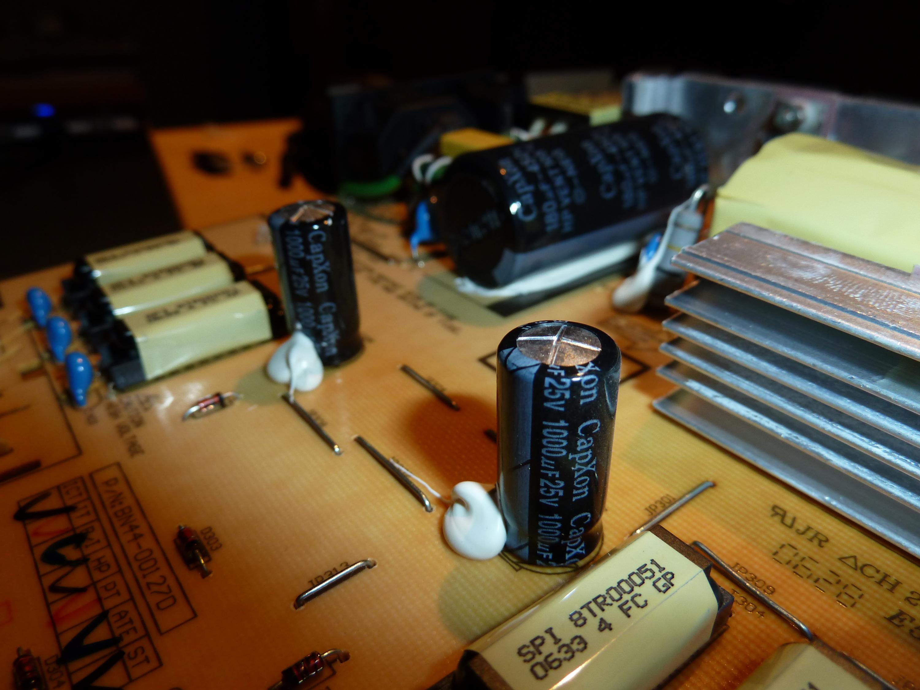

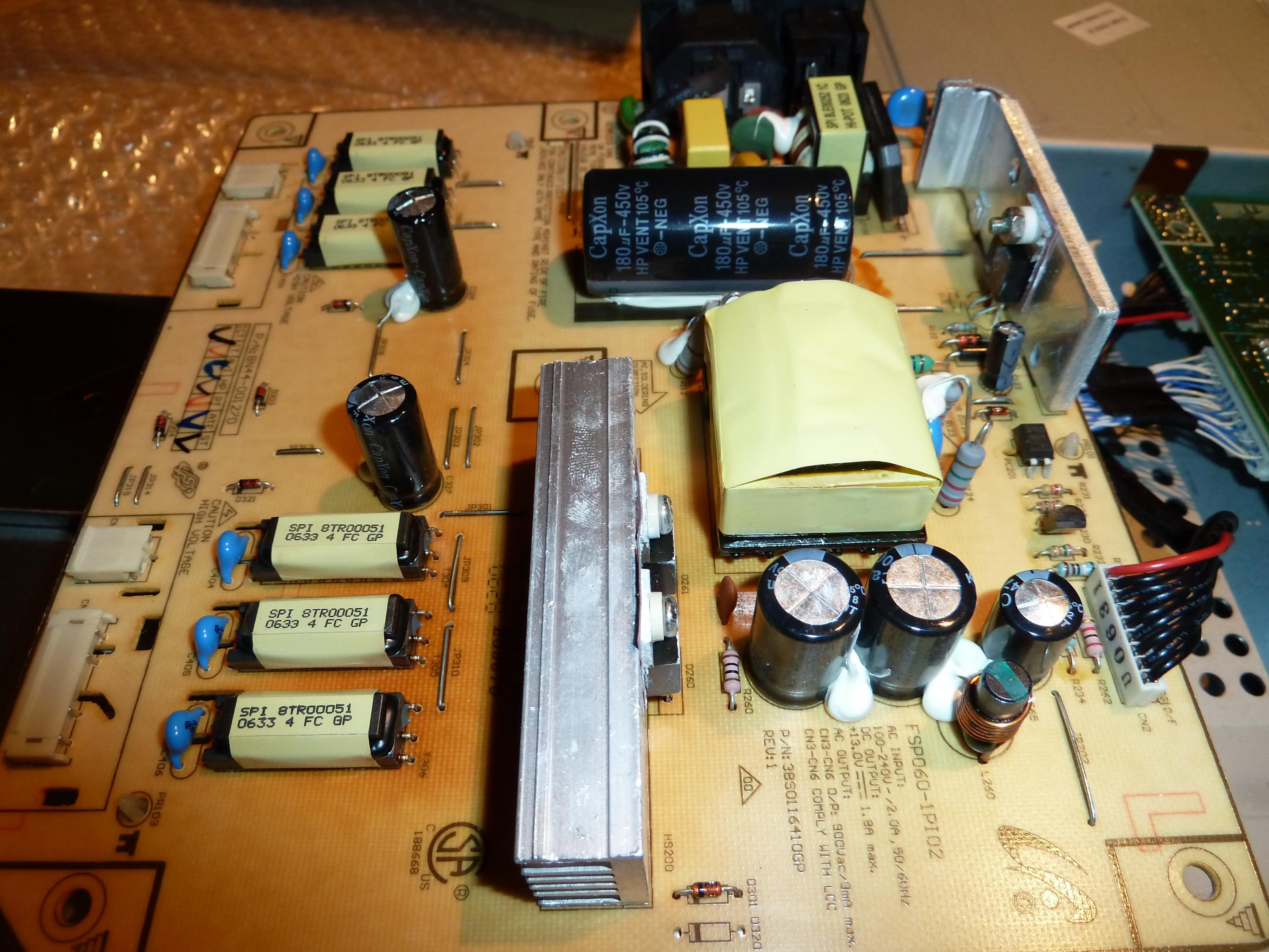

    Hi, I would like an opinion on my 205bw. As you can see from the images, it has some swollen caps on the powerboard, which having searched through these forums is not exactly unusual.
    The thing is, I have two 205bw pushed up against each other, giving me a 3360x1050 display. They are both made in 2006, one's August and the other is October. The older one, that I bought used recently, has a yellowy tint to it, a sort of nicotine stain. When it's put to full brightness, I still need to dim the newer one to half brightness, and even then the older one is a bit brown. That's after color resets on both OSD's.
    1. How much risk is there in replacing the caps? I can wield a soldering iron confidently, so that part does not worry me so much.
    2. Should I just replace the 3 swollen ones, or should I do all?
    3. Do you think this is causing the brown tint, or is that likely to be something else?
    4. Would you wait until actual failure to do something, or would this considered preventative maintenance?
    Thanks so much!
    Andy

    Don't wait until it gets worse, or the inverter chip will die too.

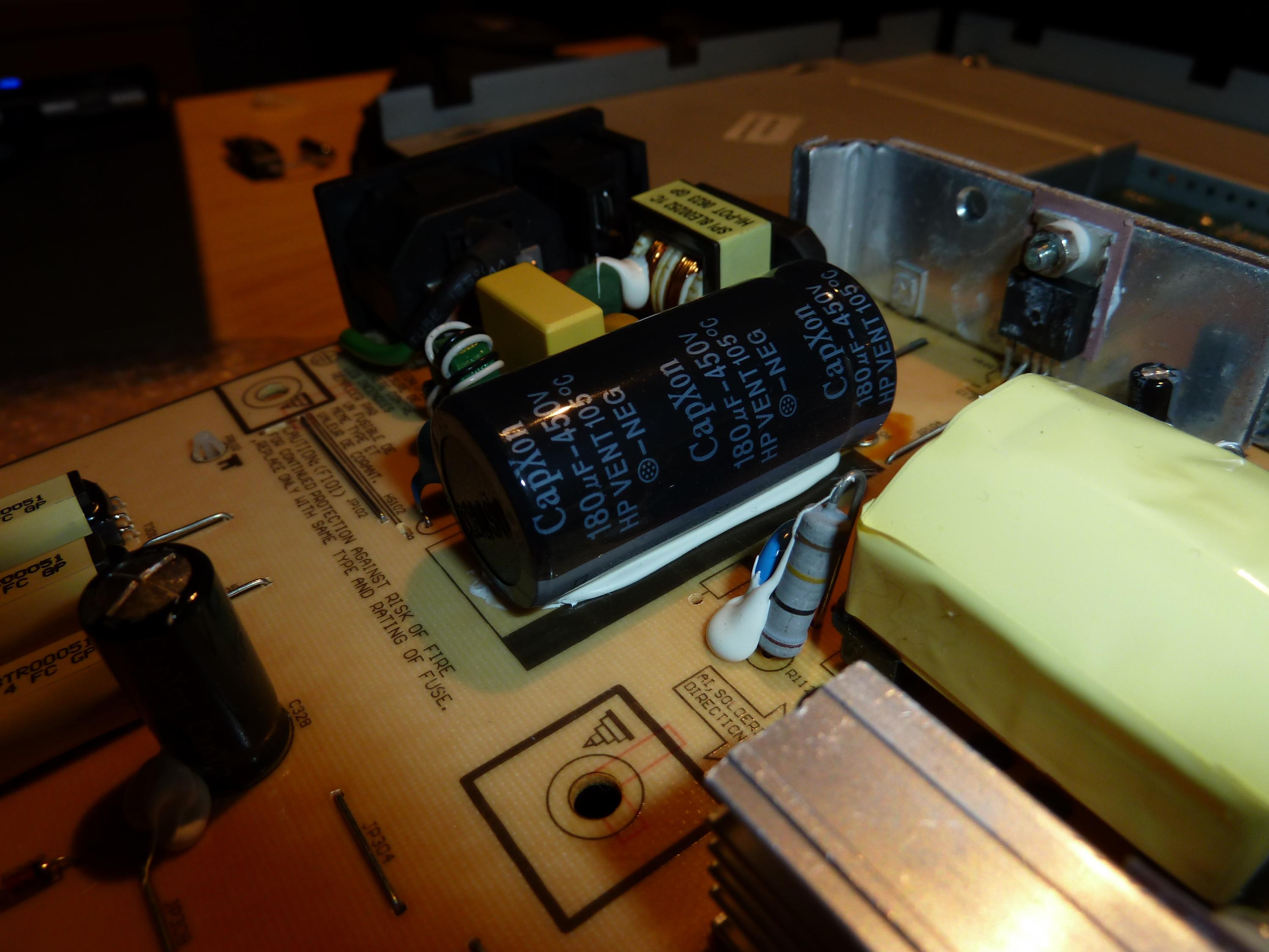

    I've fixed a few Samsung LCD monitors and it's worth re-capping them, like $6. I replace all except the big 450V one. It's low risk, as long as you write down the values and where they went, don't put them in backwards. Know the max. height either 20 or 25mm as Samsung uses short caps that can be hard to find. The big 450V part I don't change and haven't had any go, they run 120Hz low frequency, but there is another thread about this. CapXon is garbage.
    The yellowing dimmer tint I have seen with older CCFL's or ones that have been driven hard (bright). The tube ends blacken. You could swap the board with the second monitor to compare. Check the (hidden) service menu and see how many hours runtime.
    You can buy new LCD monitor parts and CCFL tubes here: www.lcdparts.net
    Changing CCFL tubes is for those with soft hands- the tubes are very fragile about as strong as a toothpick and you can't get dust in the diffuser and panel. Takes patience.

      Thanks redwire. I took a look at the service menu you mentioned, and this is what I found:
      New
      Monitor On Time 6475
      Panel Cycle 12507
      Panel 6475 (Ch. No - 0)
      Upper Lamp 6475
      Lower Lamp 6475
      Version M-HA20W9BAa-1001
      Old
      Monitor On Time 6840
      Panel Cycle 27304247
      Panel 148821 (Ch. No = 1)
      Upper Lamp 240
      Lower Lamp 56
      Version M-HA20W9BIa-1002
      The cycles for the old monitor look strangely high?
      Would you expect the yellowing to be improved by replacing the caps, or is that effect only caused by an old CCFL? Not sure I fancy replacing the tubes tbh. Do you know of any service that could refurbish the monitor for me?

        fire em both up next to each other with the backs off.look at the light leaks on the rear of the panel.normal is around 6500k.this is a slightly bluish purplish white.
        most likely the eeprom is corrupt from the bad caps.
        our shop help kid has the 225bw and the eeprom was hosed due to the main caps and the little sm lytics on the logic board being bad.replace all of them.a zerofill of the eeprom to invoke manufacturing default mode brought it back.
        i touched up a few things and got it perfect again.

            Have purchased a new power board from China, with the identical part number as the dodgy one in this monitor. Hopefully, that'll fix it. It started blinking on and off every few minutes after it's been on for about half and hour.
