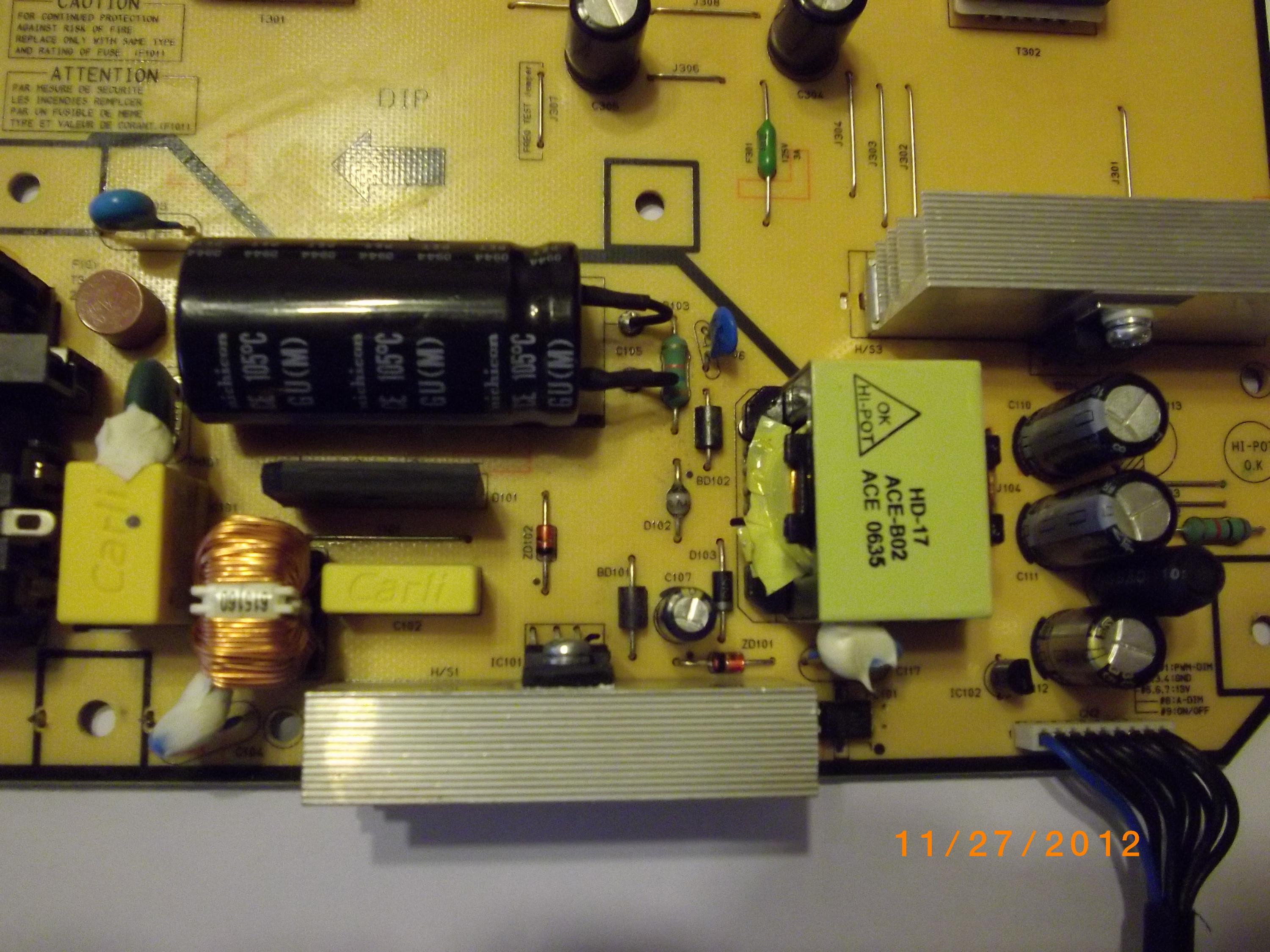

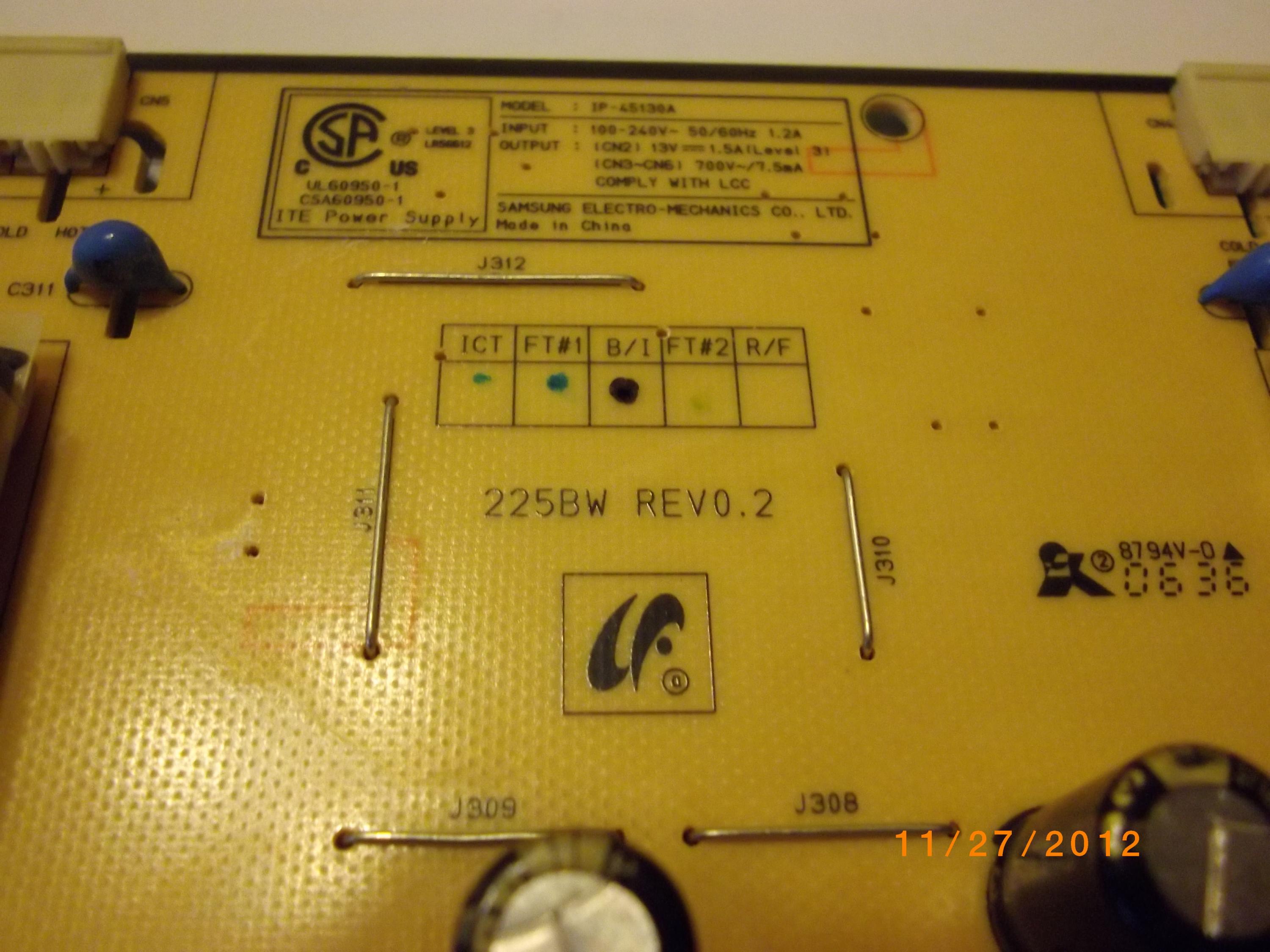

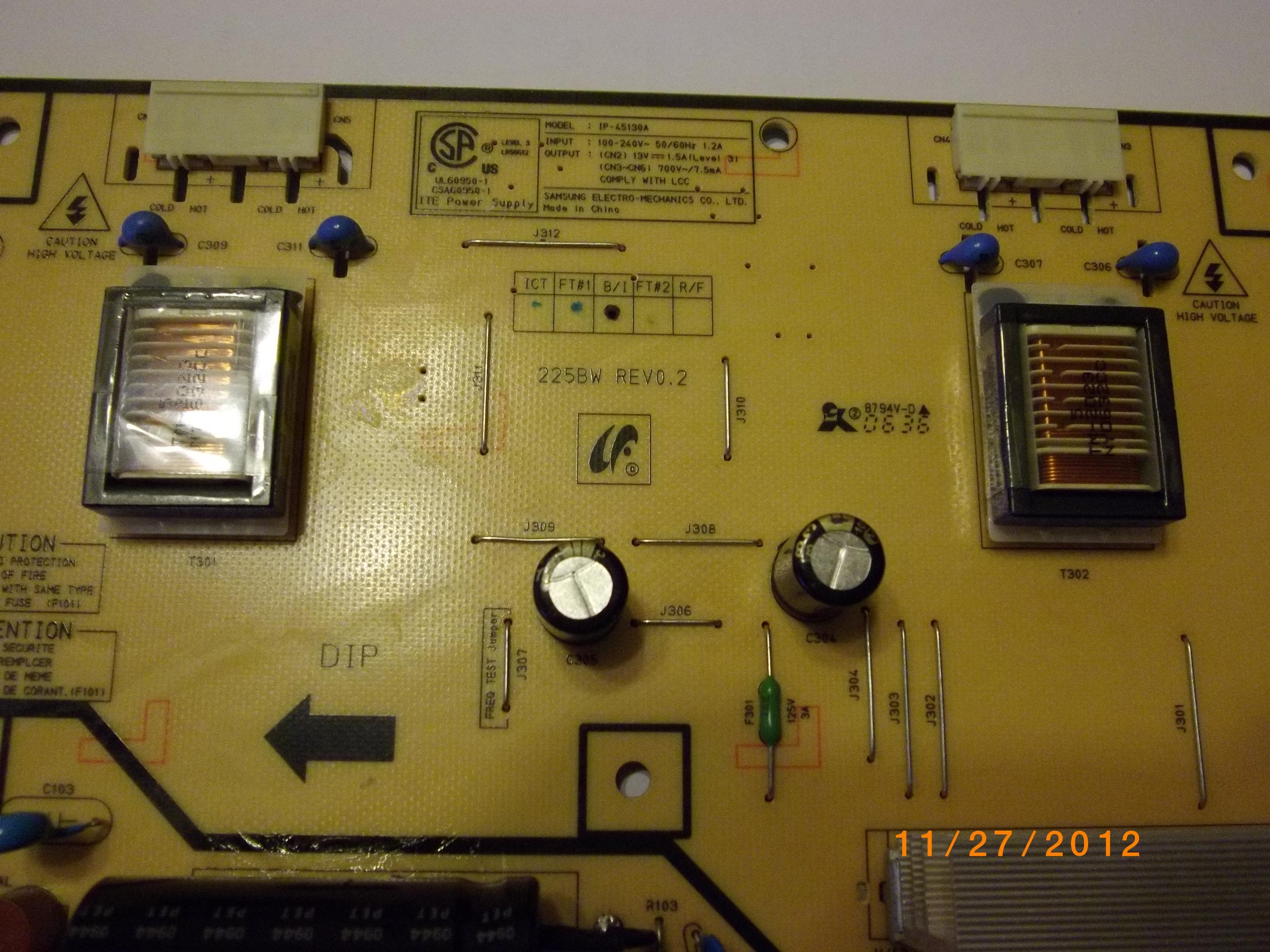

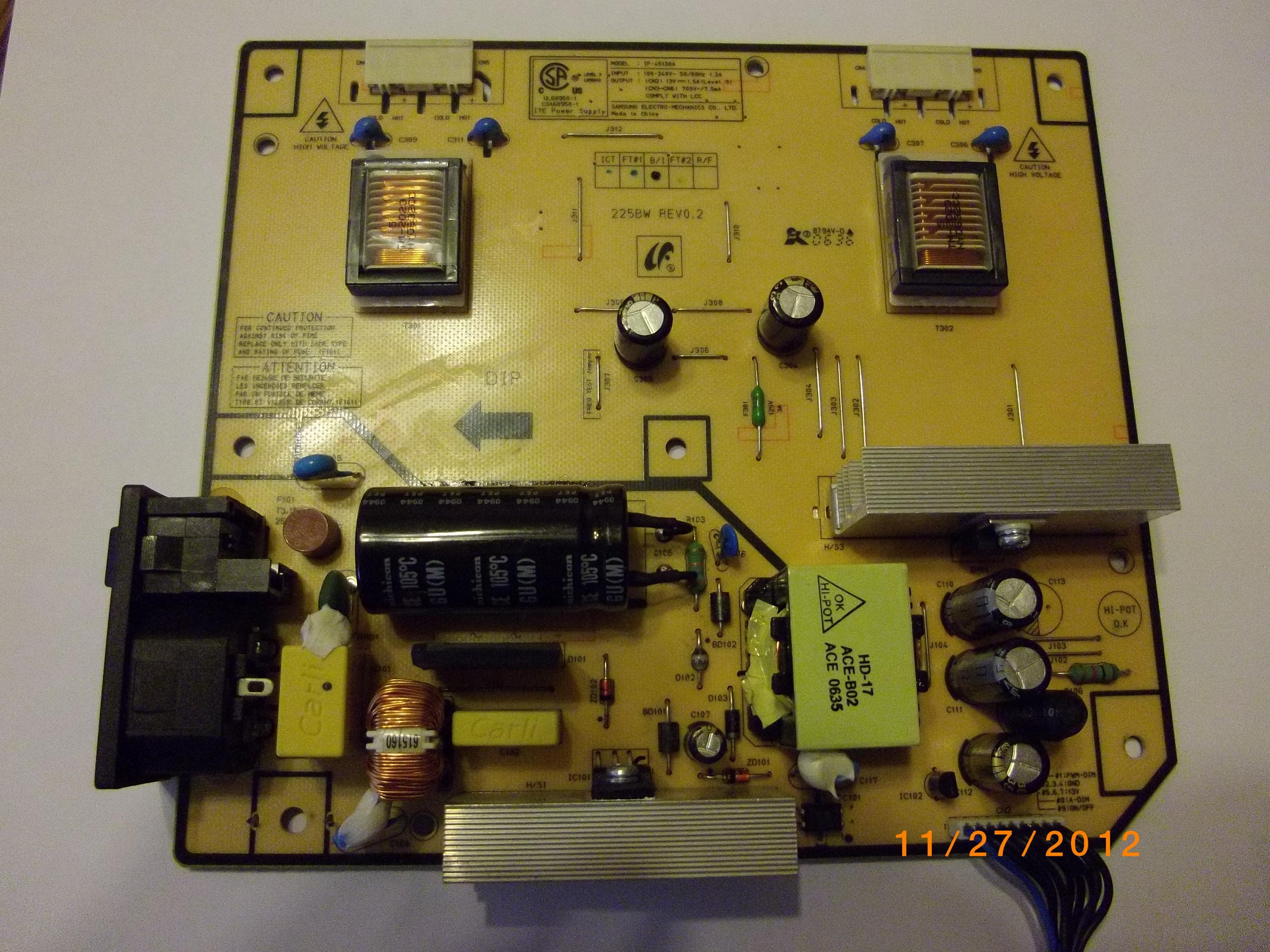

    Hello All,
    Part rant part regular post. Whats going on with all this Samsung crap? I see why other members on this site say "Friends Don't Let Friends Buy Samsung" or something to that effect.
    I have a Samsung 225BW in addition to a 205BW that I'm ready to return back to their owner and say good luck.
    The 225BW is putting out 13.13VDC after a full recap but yet the two transformers aren't showing any resistance no matter where I test. I used
    Panasonic FM,FR,FC and one lone Nichicon CE. They must use junk parts across the board, pun intended.
    Please Advise,
    lcdman
  • mockingbird
    • Dec 2008
    • 5484
    Re: Samsung 225BW Inverter REVO.2
    Try touching up the solder joints on the bottom. It gets brittle on these PSUs.
