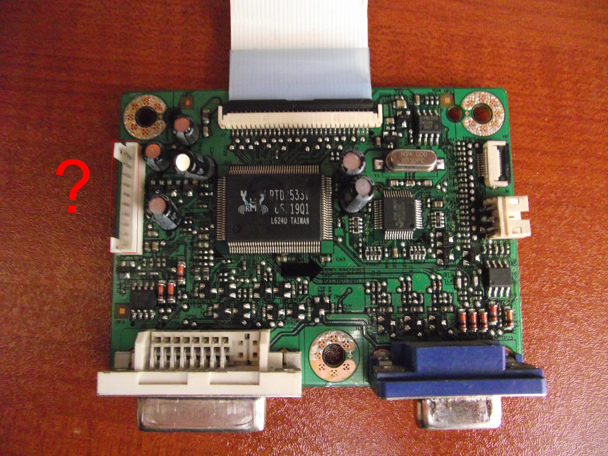

    Hi.I can not find the pinouts on this video card.There is nothing written down.I need only dim, on-off .Can anybody help me about that?And sorry for the grammar.I am trying to learn English these days.Thanks for reading.

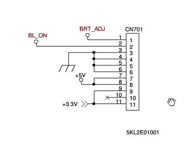

    Finally found it! Hope helps somebody.
