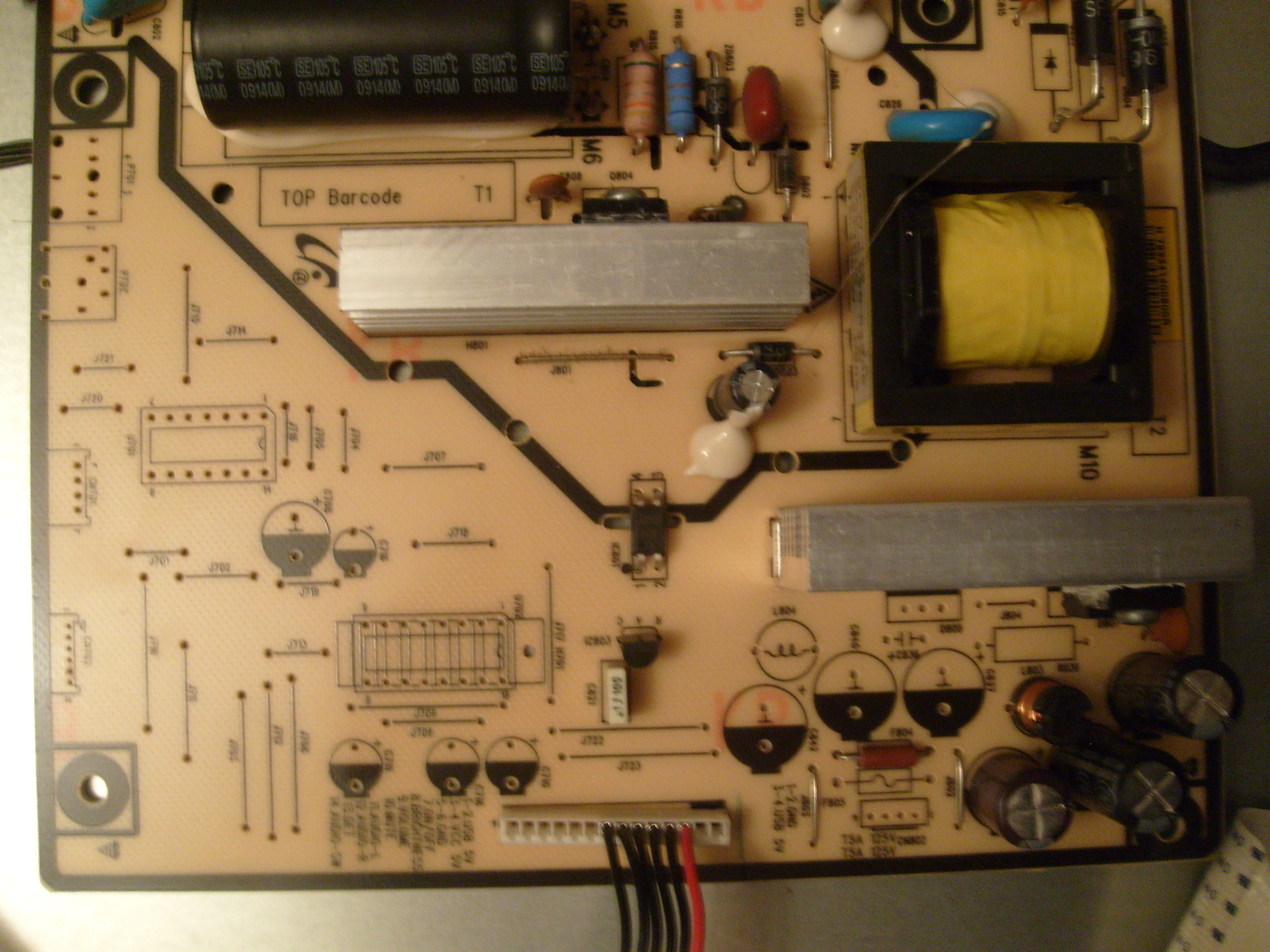

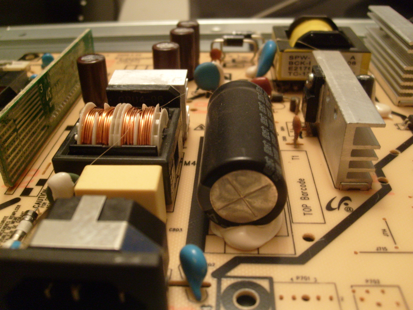

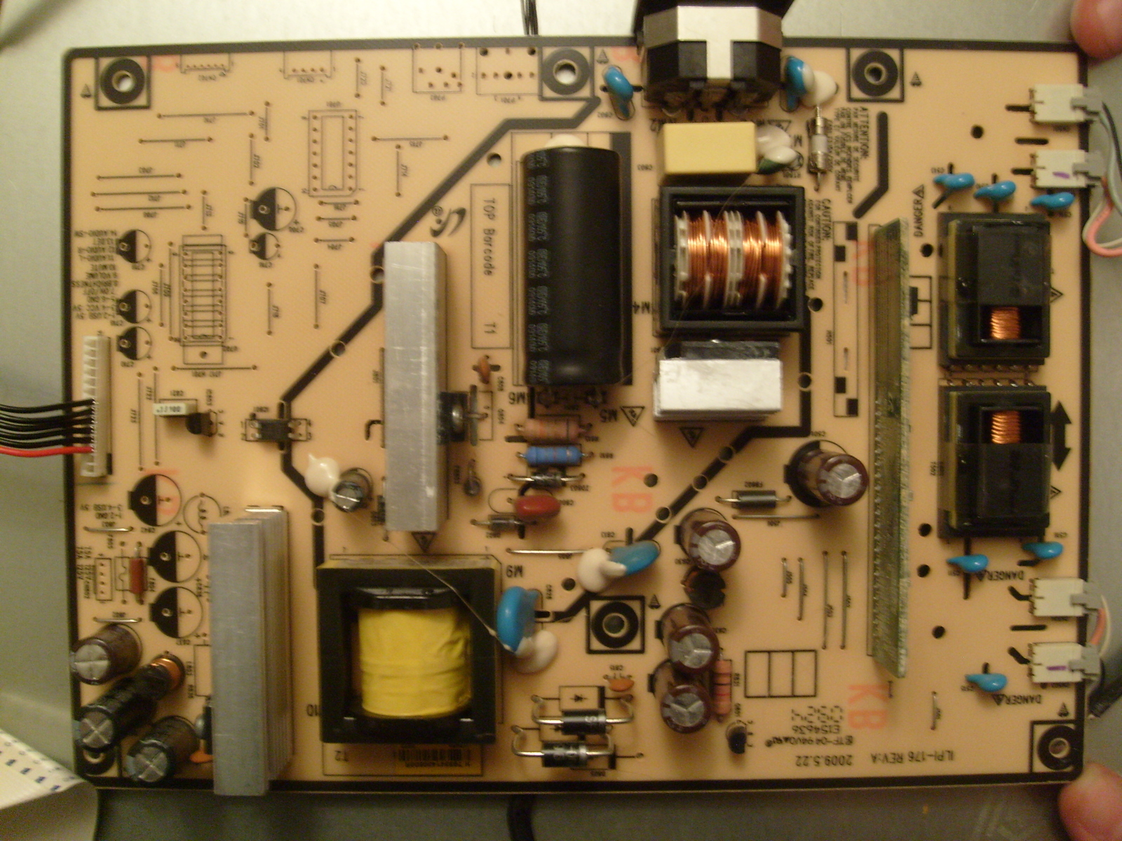

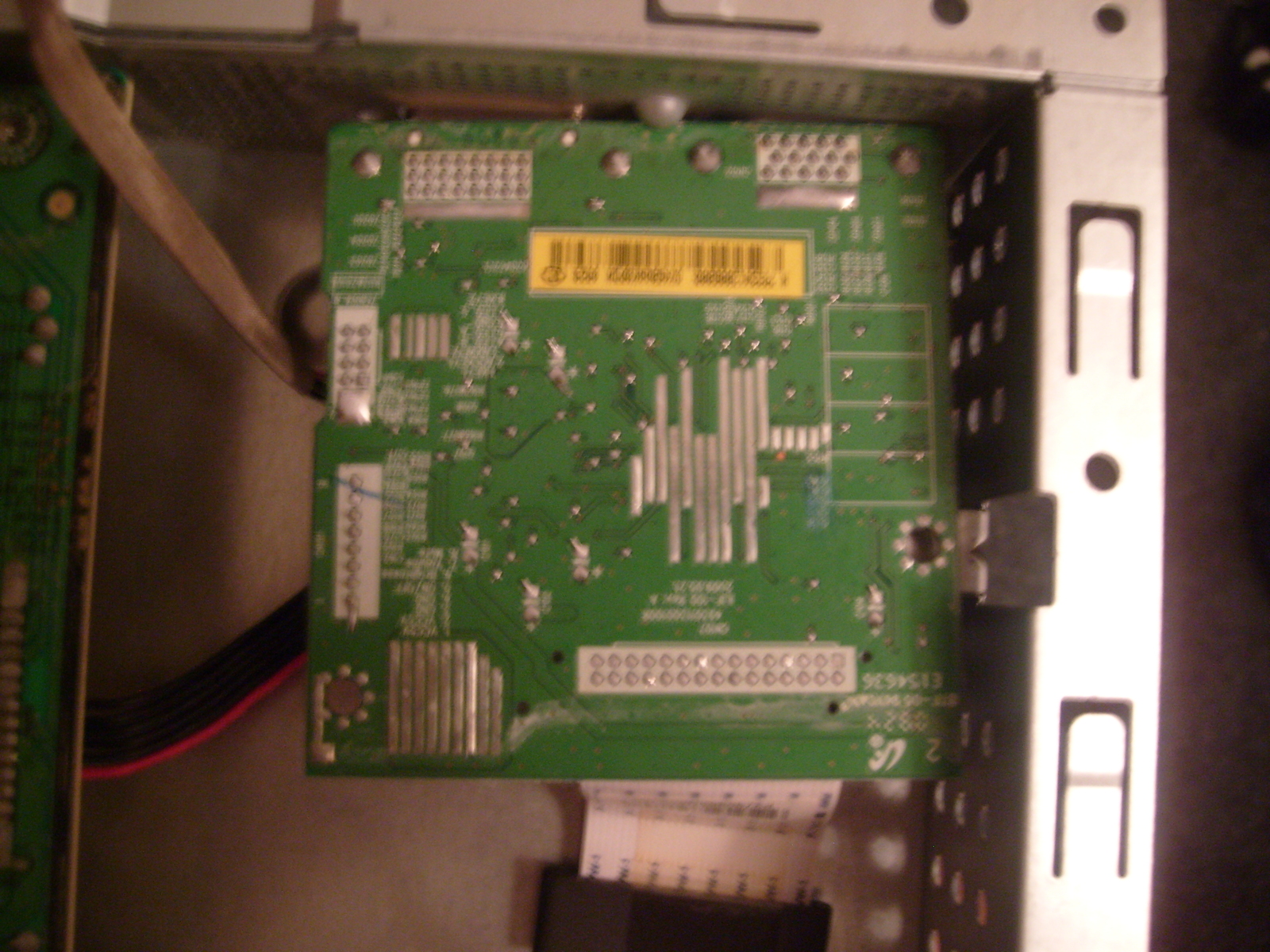

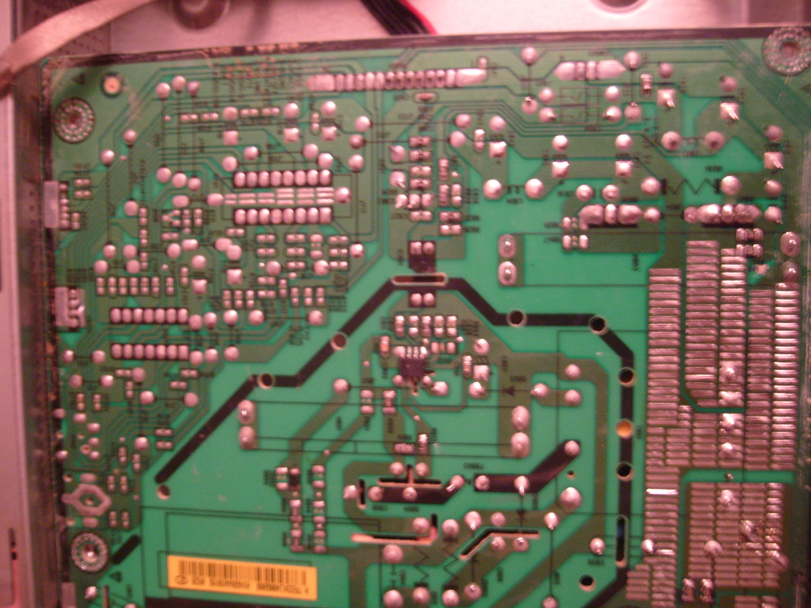

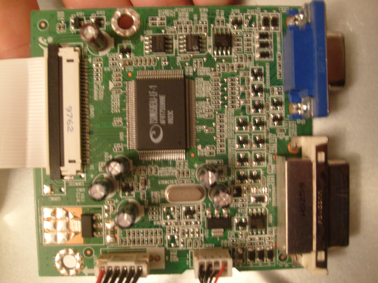

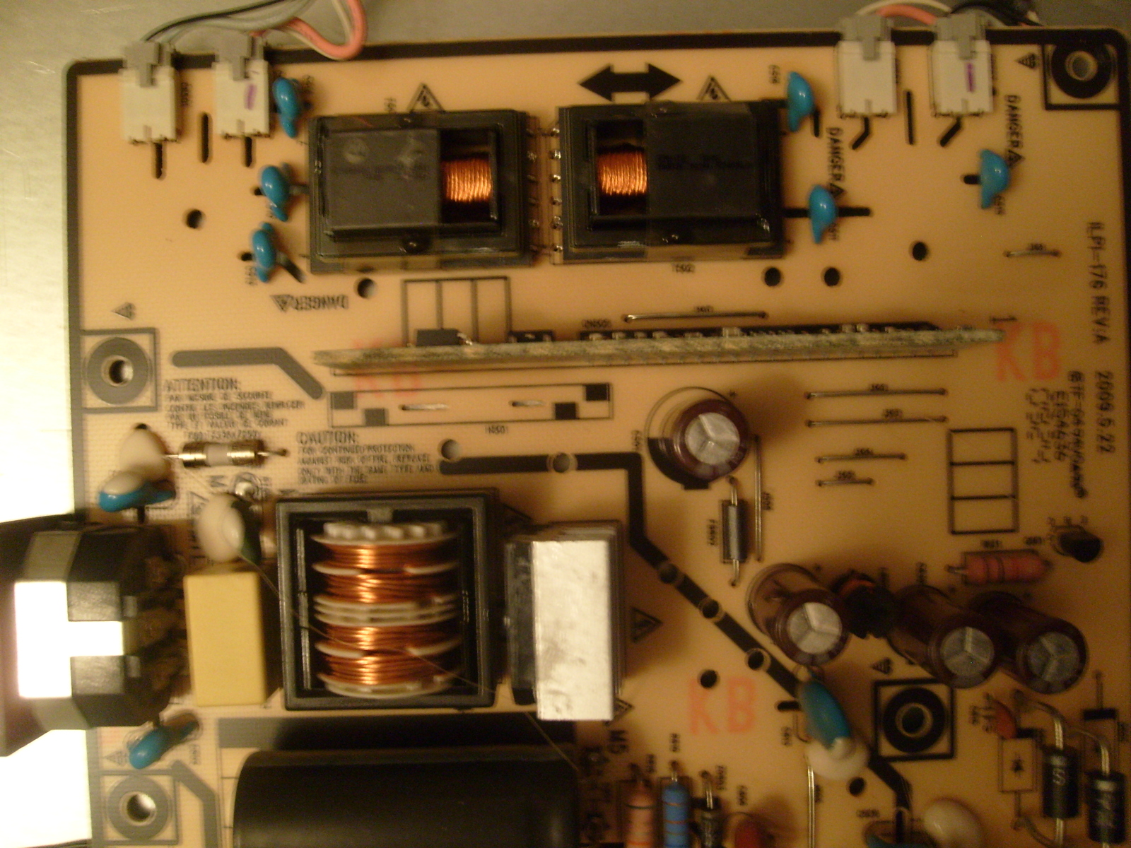

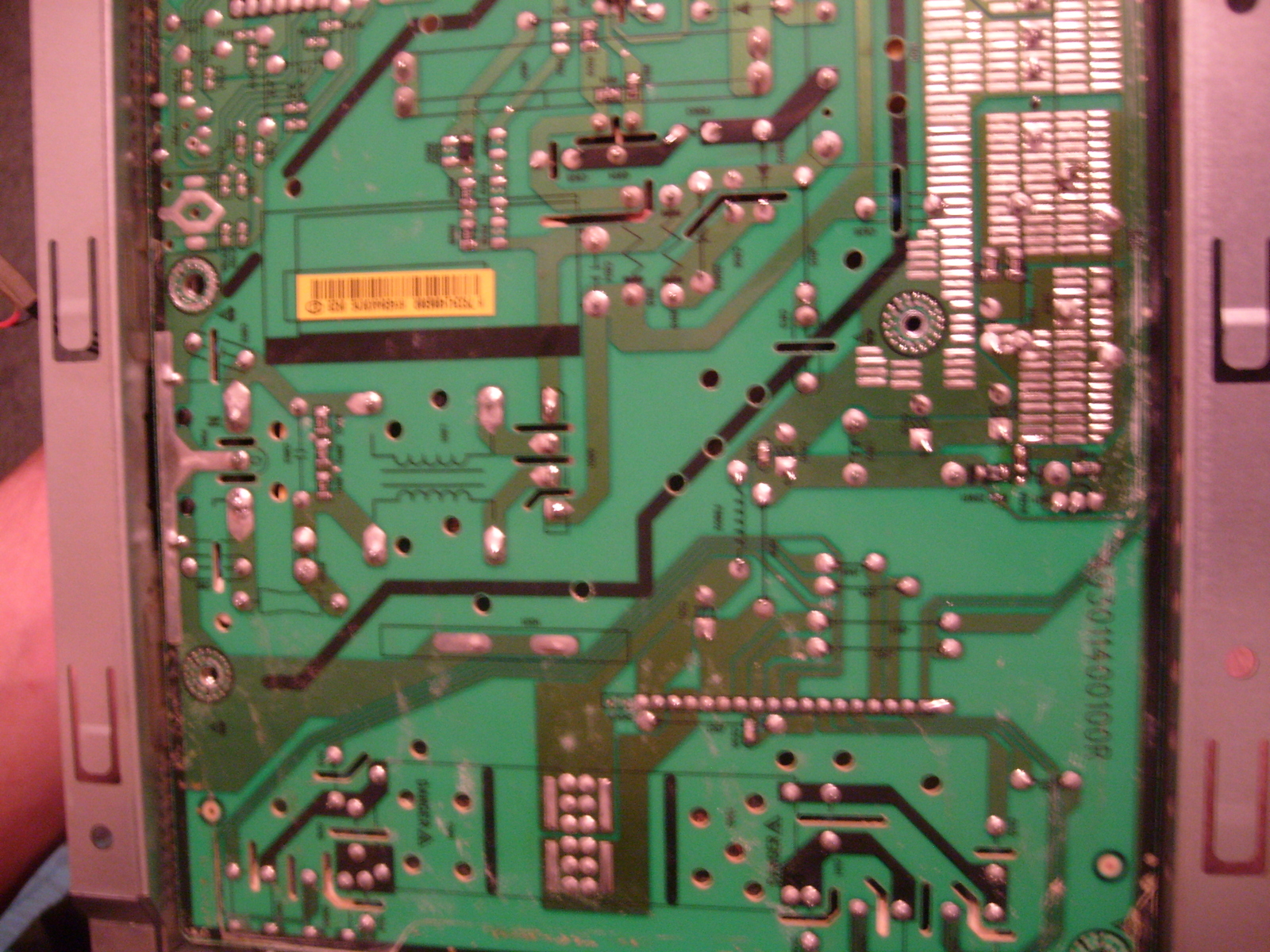

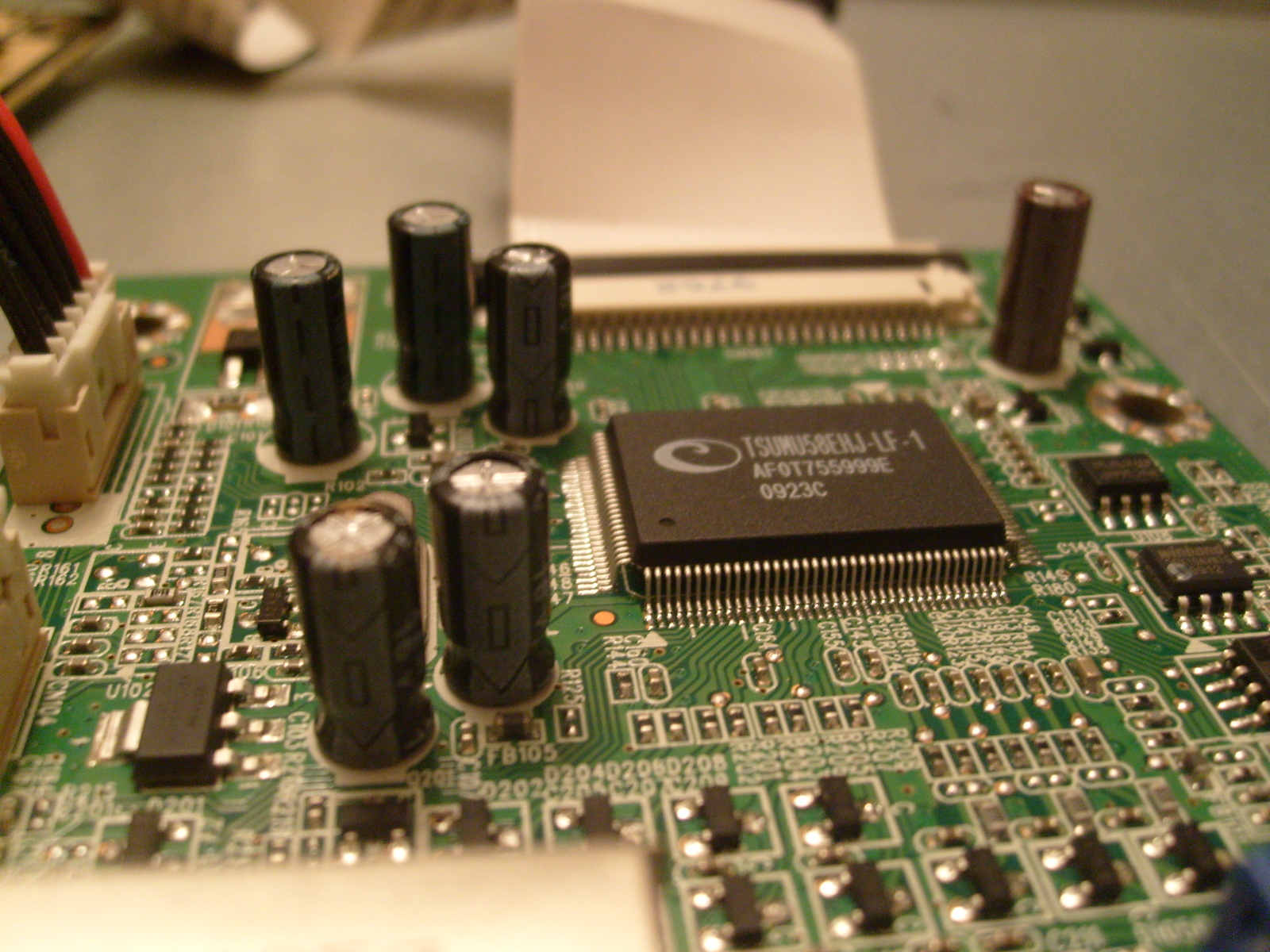

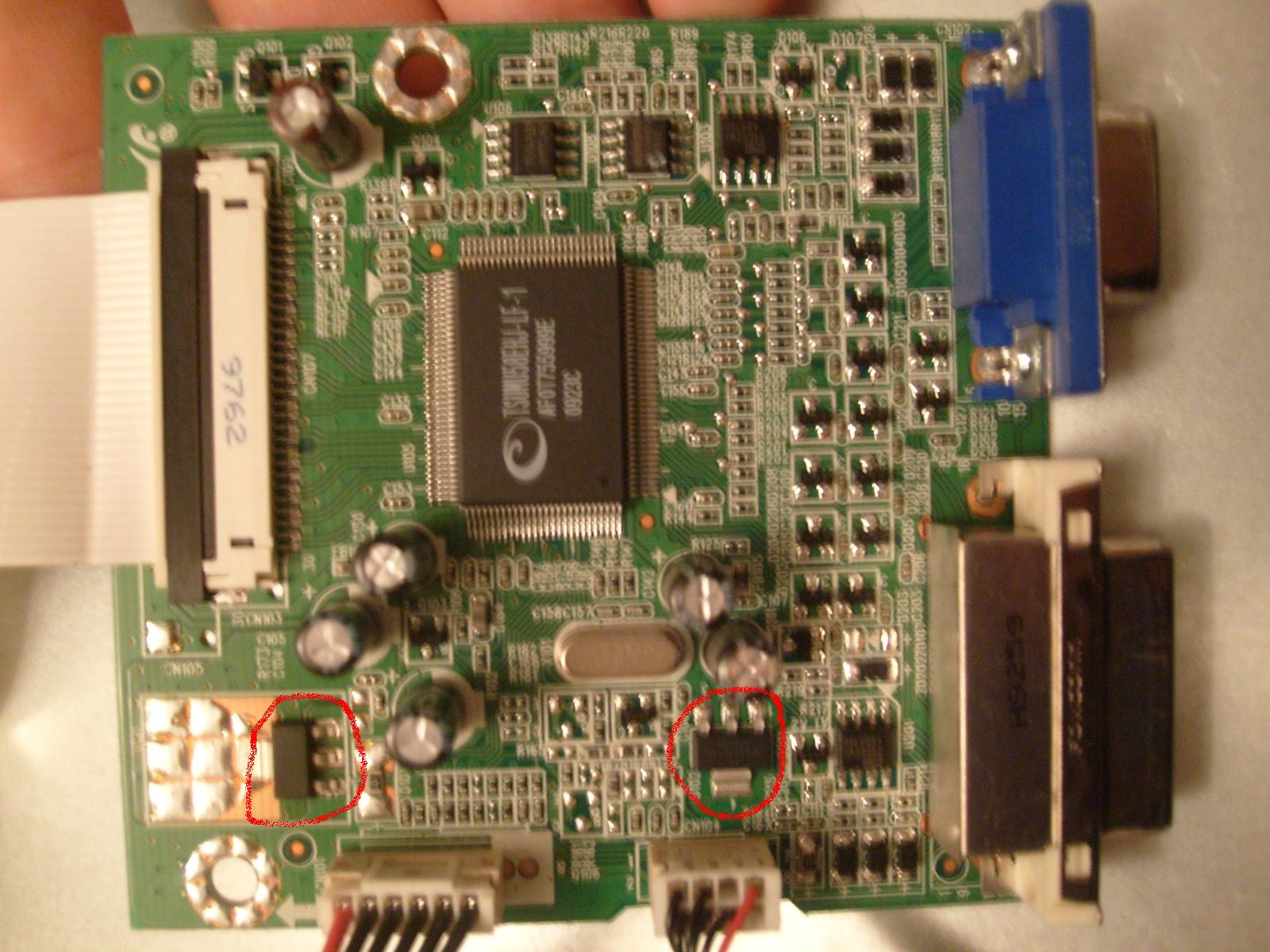

    I have a Samsung SyncMaster with some really weird problems. The screen goes black if a certain shade of blue is on the screen. If the blue part isn't big, instead of going black, half the screen mirrors the other half. For example if I have something blue in the middle of the screen, the top half works fine, until it reaches the blue, than it mirrors the first half or turns black.
    When I say it turns black, I mean that at the beginning it's white, then gradually goes from light grey to black. Exactly like in this video if you start watching from second 20. http://www.youtube.com/watch?v=5ulXm4Wix5k
    Here are some pictures I took when I opened the cover.
    The forum says something about a bad security token so I made an ImageShack slideshow .

    there is a thread that explains how this site likes pics posted! i think it a sticky! have you tried another monitor to rule out vid issues?

      Re: Samsung SyncMaster 2333 problem with colors
      This is how we prefer the picture composition. The token message is because your pic is greater than 2000x2000.
      https://www.badcaps.net/forum/showpo...94&postcount=1
      See my sig file below and follow the instructions exactly.
        https://www.badcaps.net/forum/showthread.php?t=1868
        I'm re-sizing them now. I have already tried another monitor and with that one it works fine.

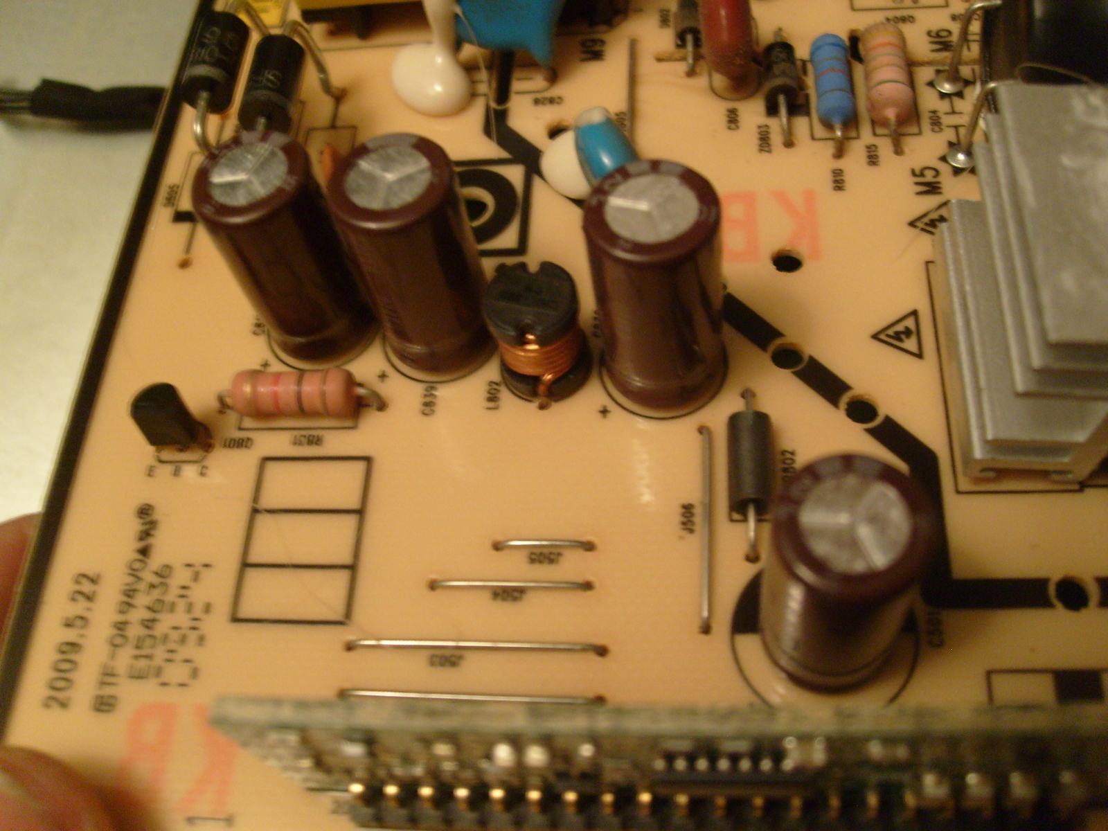

          http://img109.*************/slidesho...d=s7302243.jpg
          Resized pictures.
          Capacitors look fine to me...
            1) Circled in red are two voltage regulators.
            2) If you have a manual ranging multimeter, set it to 20V DC.
            3) Put your black probe on a ground screw on the main board.
            4) Put your red probe on each pin of the voltage regulator (ignore the fat/top tab).
            5) Report the
            a) part number for each regulator
            b) the DC voltage for each pin
            c) number the pins left to right (tab being "north")
            like so
            Part number AS1117-33
            pin 1 = 0.0V
            pin 2 = 3.3
            pin 3 = 4.99
