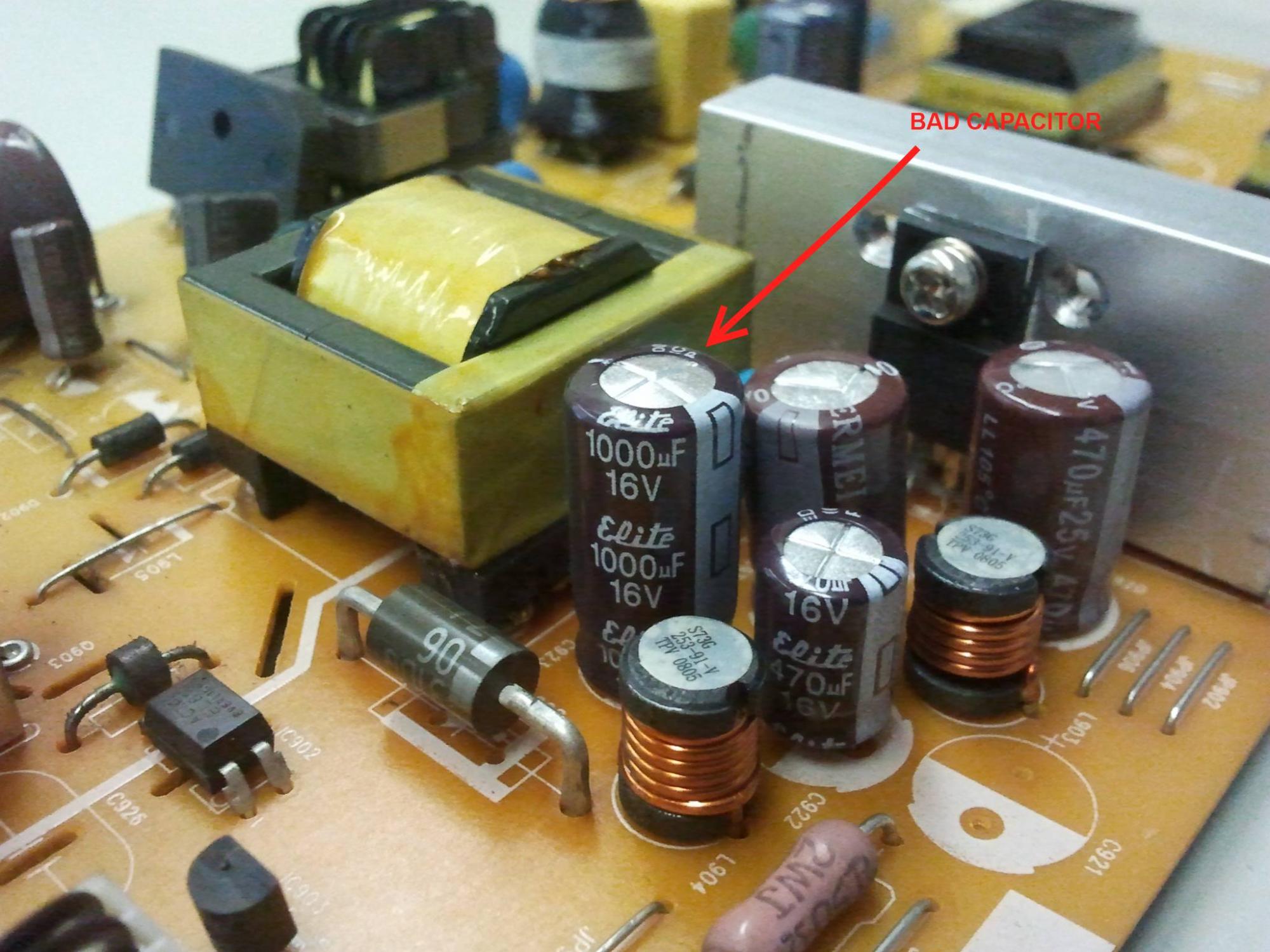

    LG-FLATRON_1934S success story
    Couldn't see any image, power led on. Dismounted and found bad capacitor in power board, replaced (old, 1000 uF, 16V, new 1000 uF, 25V) and now lcd screen working OK . Image attached of power board with bad cap

    Re: LG-FLATRON_1934S success story
    now replace the rest.unless you want to do it one at a time as they die...
