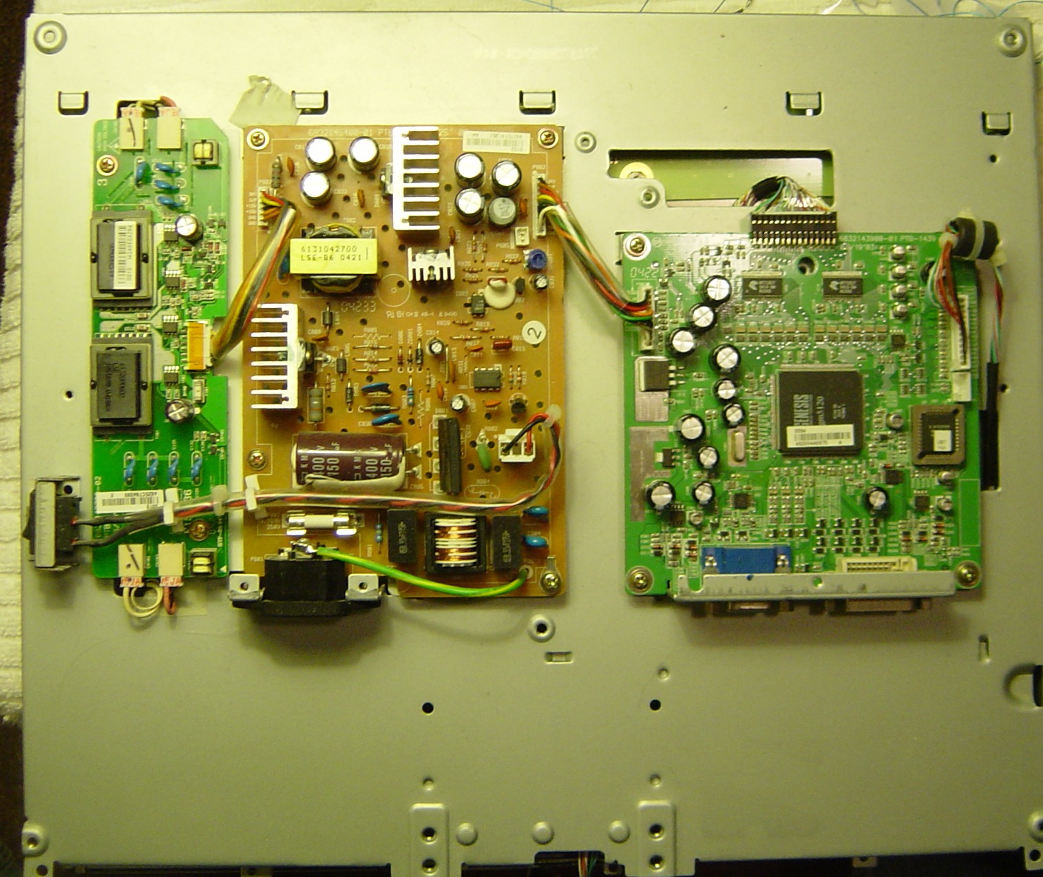

    Hello. I have an old 17" LCD monitor here, NEC LCD1760NX, model: L172EN. I was trying to fix it, mostly for fun and experience, but it turned out to be more difficult than I expected.

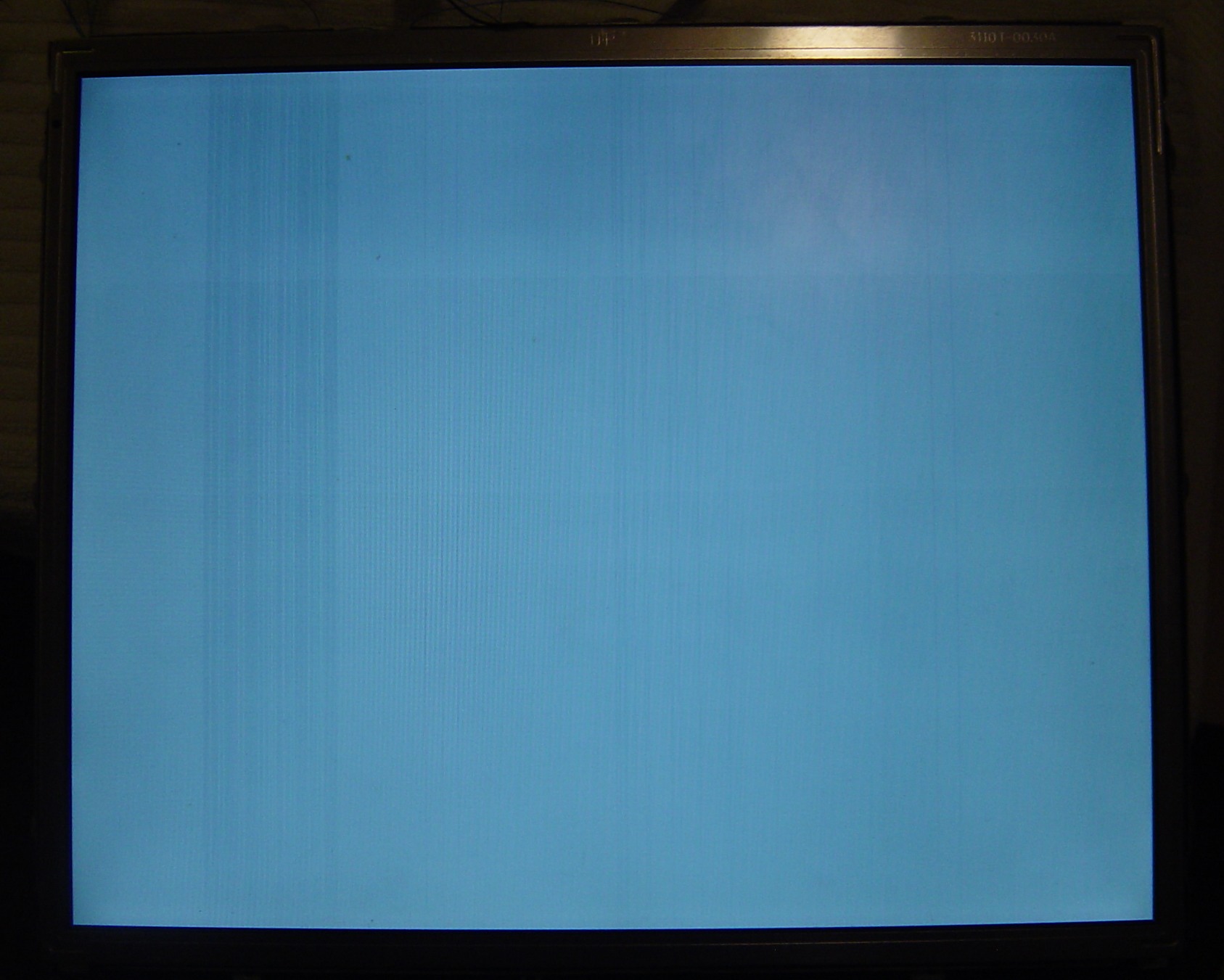

    The monitor will turn on with a fully white screen and then slowly fade to black over a 3-5 minute period. The white screen has some faint vertical lines. Nothing resembling a video signal is seen.
    I did not check the electrolytic capacitors directly. Instead, I probed the power supplies with an oscilloscope. The main +5 volt and +15 volt supplies look good, very little ripple. The backlight seems to work. The 3-terminal regulators on the logic board output nice stable voltages. The ribbon cable has LVDS data going across it.

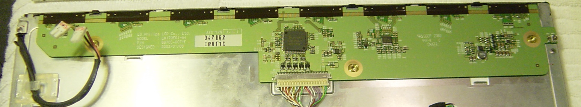

    I moved over to the T-con board and found the following voltages. Vcc = 3.36, Vcom = 4.22, VGL = -5.12, VDD = 9.95, VGH = 27.4. I don't know what voltages are reasonable for driving the LCD.

    Re: NEC LCD1760NX, can it be fixed?
    The last monitor i tinkered with that had a white screen with lines in it turned out to be the main board. I found one on ebay for $12 shipped. Swapped it out and it worked like new again.
