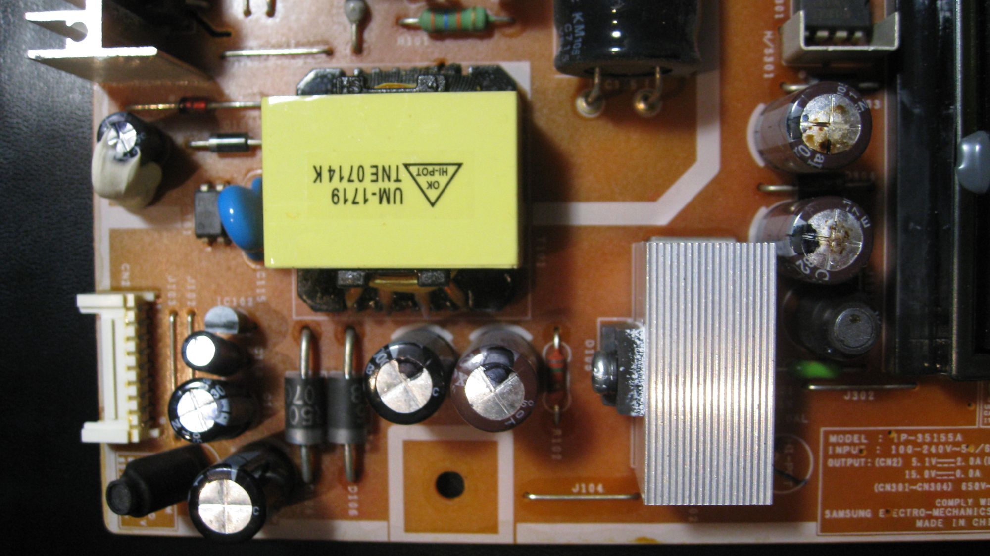

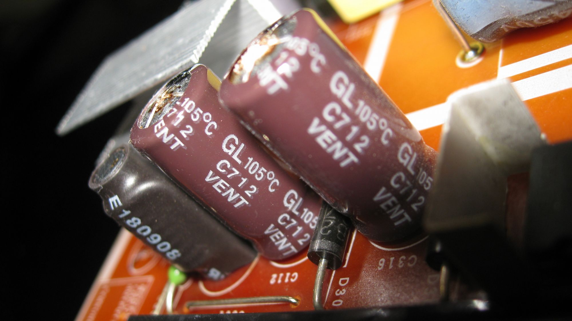

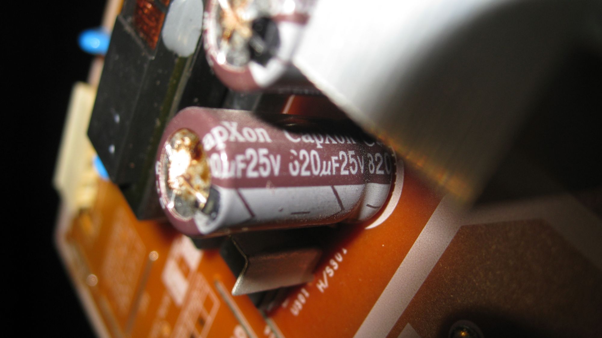

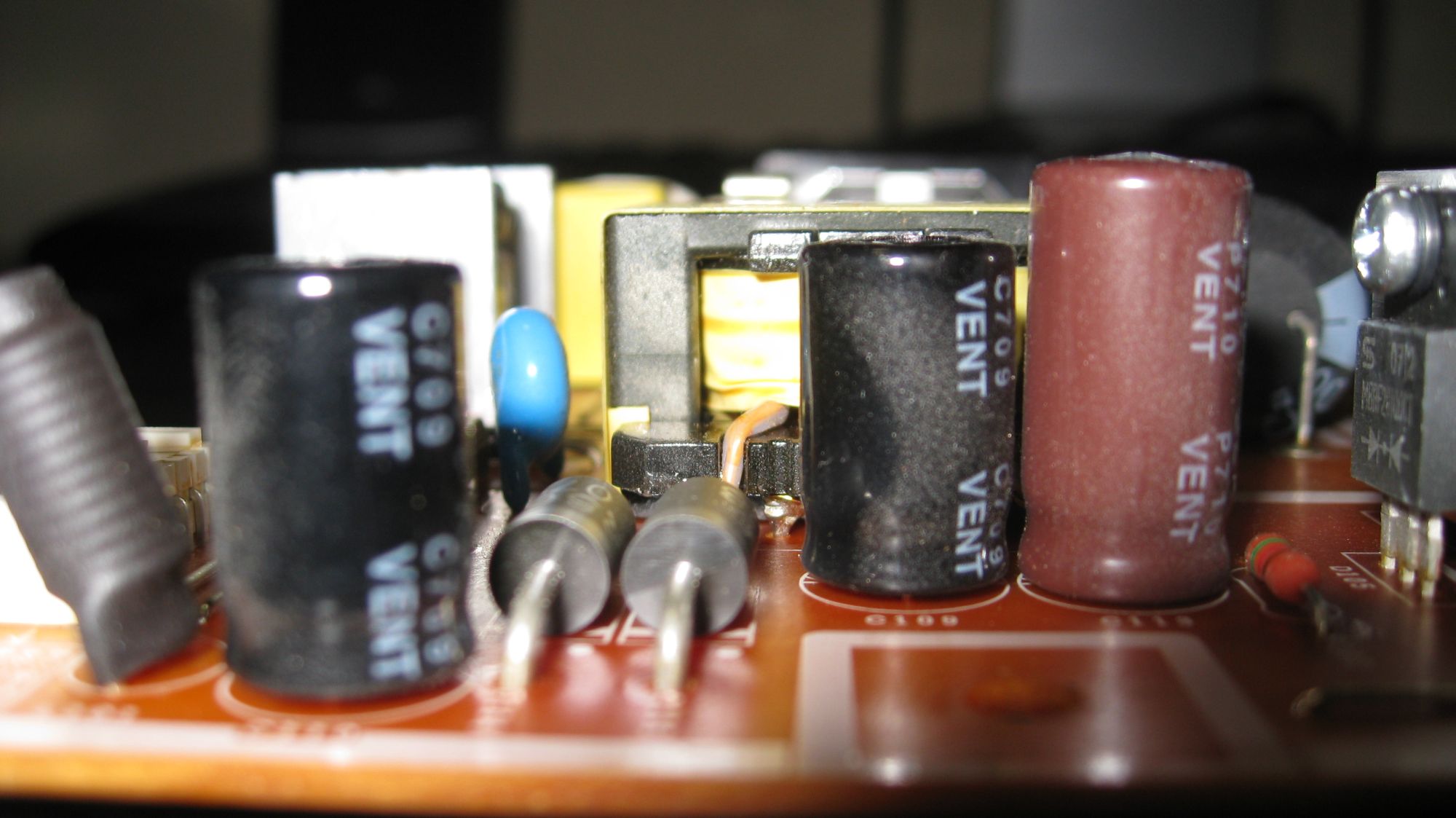

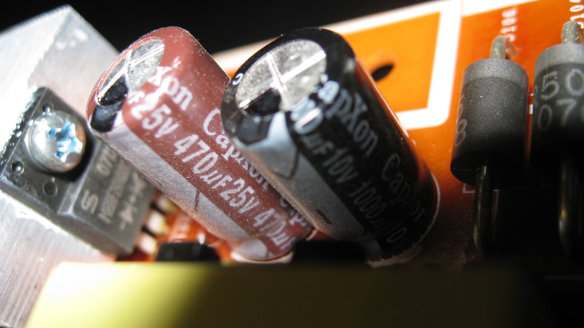

    Hi guys,
    I've had this monitor for quite some time and my problem is exactly similar to what another member posted:
    "When it's off for around 30 minutes, several minutes of flickering and hitting power switch repeatedly is needed to get it to turn on. It will flicker really fast for a bit, then turn off. When I cycle the power switch a few times, it eventually stays on. Sometimes it stays dark until I cycle the power switch a few times, then starts flickering, and after more cycling eventually stays on."
    I opened the case to find the caps at fault for my misery (pics included) and was wondering if someone could have a look at the replacement caps I'm considering as found via the guide here.
    List:
    Capaxon GL 820uf 25v (10x16mm-measured myself the data sheet lists it incorrectly, Ripple:1.46A, ESR: 43 mOhm) to EEU-FR1E821
    Capaxon GL 470uf 25v (10x16mm, Ripple:1.04A, ESR: 65 mOhm) to EEU-FR1E471
    Capaxon KM 1000uf 10v (10x12.5m, Ripple:.520A, ESR: none listed) to EEU-FR1A102L
    Capaxon KM 330uf 10v (8x11.5mm, Ripple:.255A, ESR: none listed) to EEU-FC1A331
    Capaxon KM 1uf 50v (5x11mm, Ripple:.13A, ESR: none listed) to EEU-FC1H1R0
    Questions:
    1) Should I be concerned that the manufacturer didn't post ESR rating on their data sheet making me unable to cross check them with the intended replacement?
    2) The majority of the replacements are larger than the originals in terms of height and will hit the roof of the chassis, but still fit. Is the contact something to be concerned about?
    Thanks in advance.

    Re: Samsung SyncMaster 932B- Help?
    Originally posted by gr8st121
    Questions:
    If there is no ESR spec, then they were general purpose caps to begin with. You can use "entry level" low ESR caps like Panasonic FC and it will be fine.
    You should get the proper height. I would not risk a short by letting the caps touch the chassis.
    See if Panasonic FM is shorter in the same uF and voltage. For example, this Panasonic FM 470uF 25V cap is 10x16mm
    http://search.digikey.com/us/en/prod...2388-ND/613749
    and still meets or exceeds the original specs.

          Will do. Sorry one last question, there's a cap that's caked in some kind of thermal paste (reference overhead pic) to the left of the that blue knoby thing (no idea what it's called), should that be replaced as well? If so, do I have to reapply the paste or would a new cap sans paste suffice?
          • jetadm123
            • 2169
            Yes, the cap should be replaced. The white stuff is adhesive that's used to hold the cap in place during the soldering process. It does not need to be replaced.
              On the board, there is a PCB designator. It should start with a C for capacitor. It is a ceramic capacitor.
