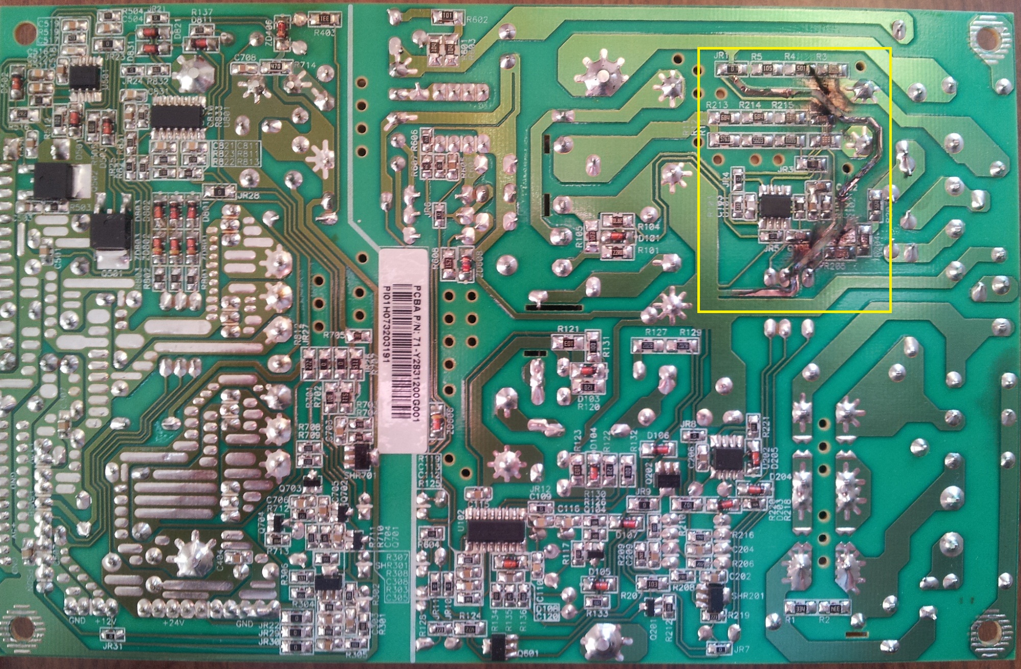

              Re: Hanns G HG281D White Out on Sides
              Originally posted by g2diablo
              Do you think it is worth a shot to try and recap the board?
              Ummm... I just messed something up. While trying to put everything back together, I plugged in the monitor and the PSU blew. Here is what it looks like now. I have no idea why this happened because I made sure nothing was shorted. Well, at least I thought I did.
              The section I highlighted in yellow is completely charred!!! What happened there?

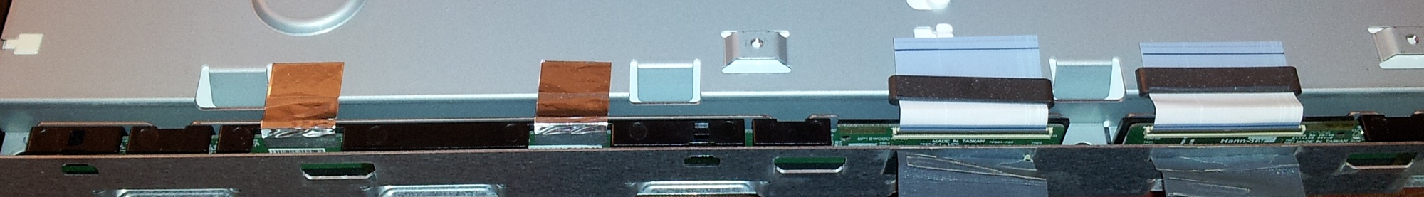

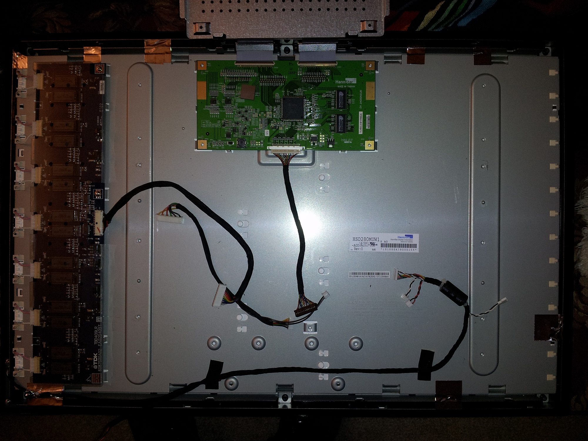

                I forgot to ask if there is a panel board on this lcd? It would run the entire length of the monitor at the top. It may have a fuse on it.
                I checked, but couldn't find anything. Here is the pic of the monitor's back.
                Looks pretty basic chinese crap. Inverter, T Conn, and LED bottom left, with the control buttons. I have the newest model of this monitor taken apart too and it looks very similar.
                  I plugged it in when the heatsink was grounded. BOOM!

                      #30
                      After closer inspection of the PSU, it looks like only a small section is damaged. I was thinking of soldering a wire between the two points I drew in red. What do you think?
                        It could be underneath that metal shielding? Can you see any green PCB behind the metal shielding? Those 2 cables from the t-con plug into something?
                        Be careful when taking things apart as the ribbon cables are very fragile and may be bonded.
                        If you can't see anything, then I'm probably mistaken. I haven't personally physically worked on this monitor. I have just helped out others with it.

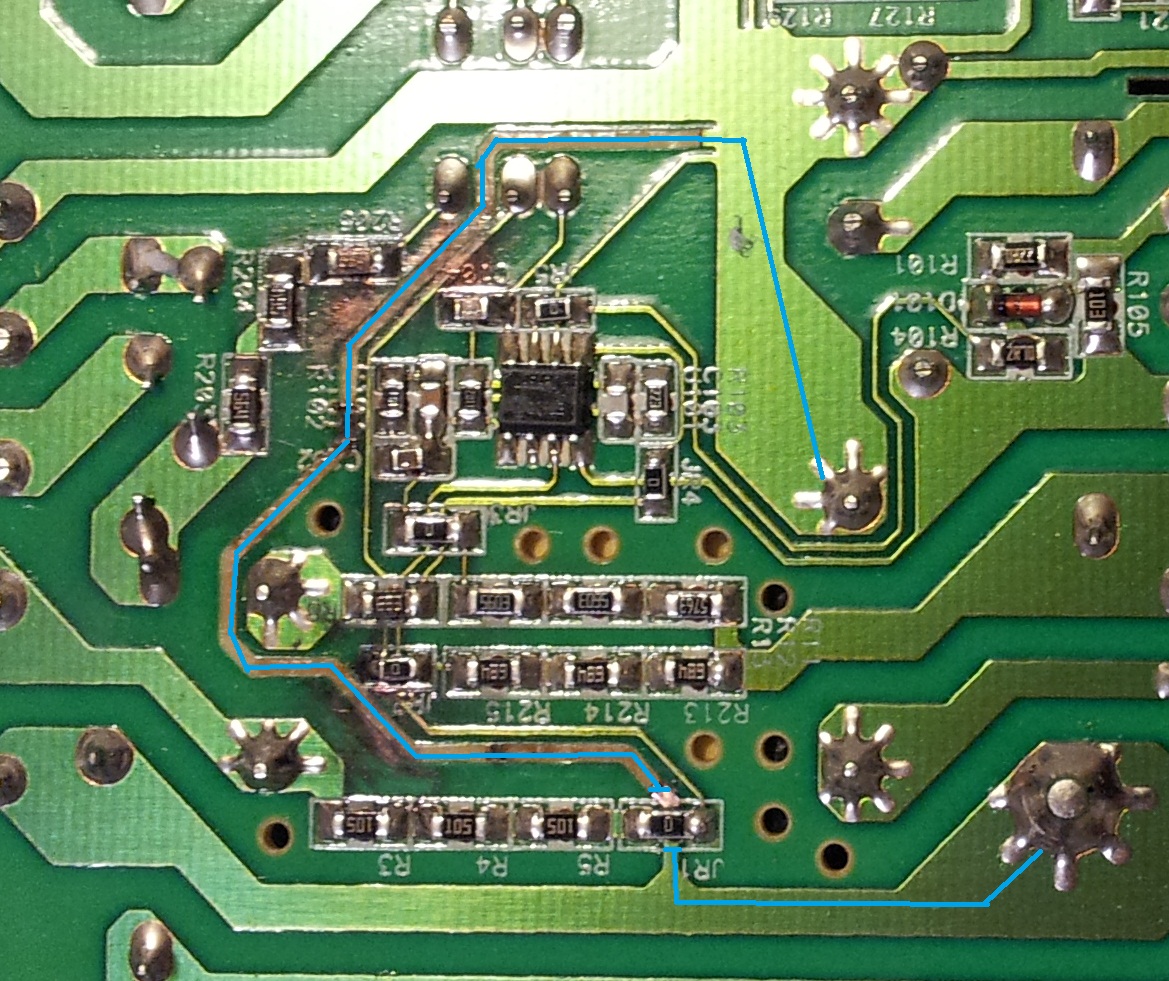

                          #32
                          No idea if there was continuity there before or not so I can't say 100% if that is a good idea or not.

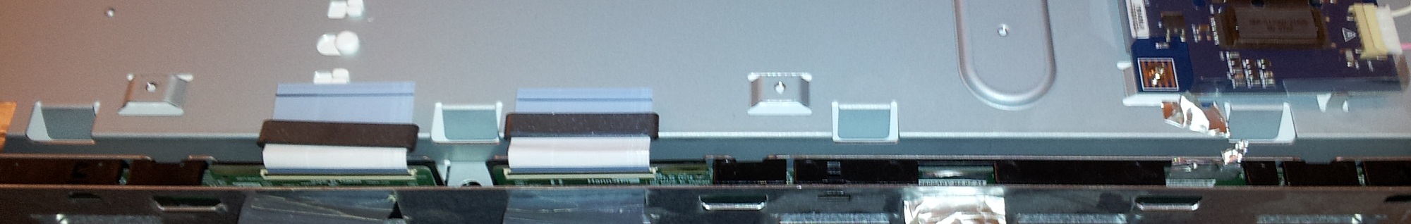

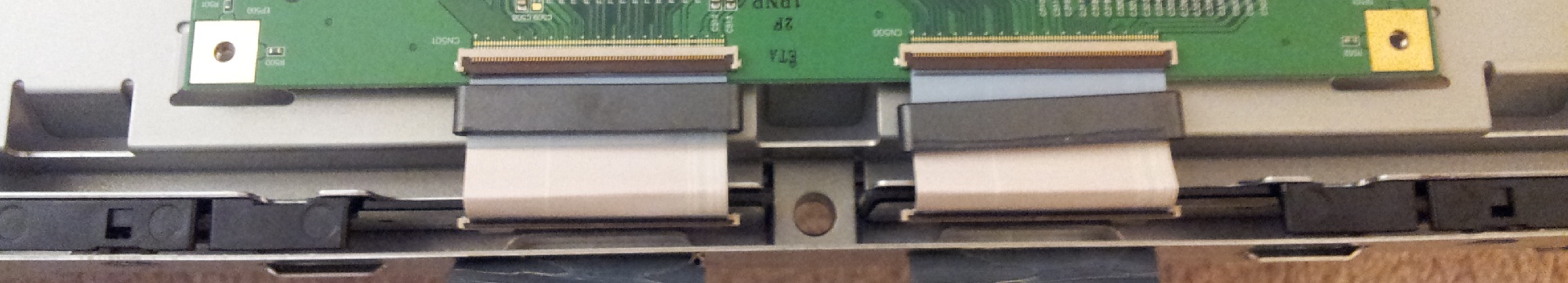

                            #33
                            I took some more pictures after removing the LCD from the housing. It looks like they plug into green PCB's that go directly to the LCD. I can't see anything and I don't think they come out. I don't think these pictures are good enough to tell.

                              #34
                              I drew in blue the path that it took, so I am assuming this should put it back to where it once was.

                                #35
                                Your picture and blue line makes a compelling case for continuity. See if the multimeter agrees along each point.

                                  #36
                                  When I check it with the multimeter it has no continuity between the points. I checked at several locations and this looks like it might work. There might be a small run that will need soldering as well. Oh, nvm, it appears that all other runs are good.

                                      #38
                                      Hmm, I'm starting to think maybe your t-con is bad wrt to the white screen. If it is, a recap obviously won't accomplish anything until t-con is fixed/replaced.
                                      I would check U404 and U406 for shorts between pins 1-2, 1-3, and 2-3. If they are not shorted, measure the voltage across each leg once the bridge rectifier is replaced.
                                      The only other user replaceable component would be D200. All the other stuff looks custom or proprietary.
                                      If those are out of whack, that could explain the white screen, but again, t-con are somewhat new to me. I replaced one for a friend (on PlainBill's advice) and it worked. That is the extent of my t-con knowledge.

                                        #39
                                        I just wanted to let you know that the monitor is up and working now. I have to thank retiredcaps for helping me. I am so thankful for all the tips and information provided.
                                        I ended up resoldering the power supply and ordered a new T-Conn board from China. It took a long time to get here, but it is worth it. This monitor has an amazing picture.
