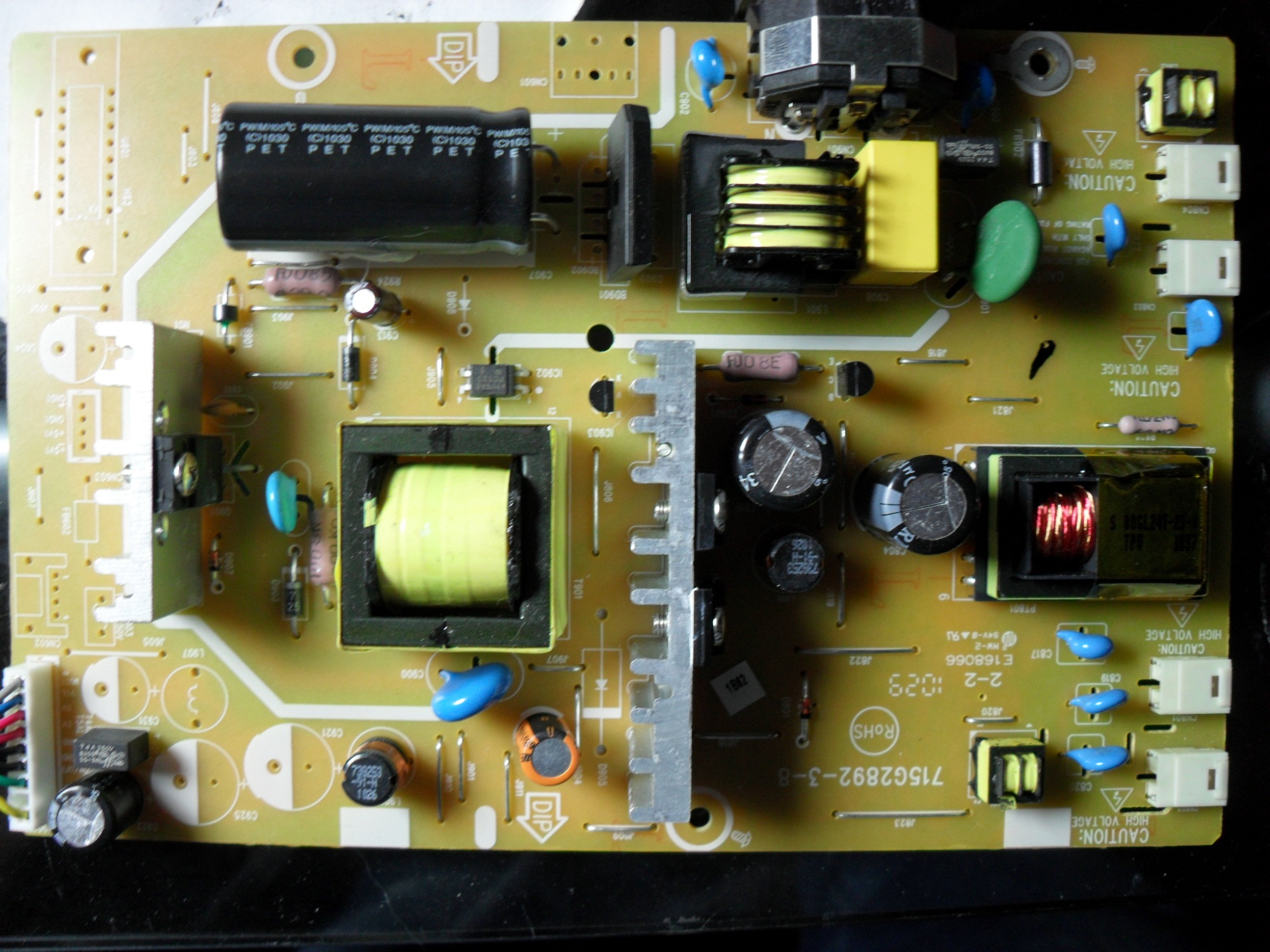

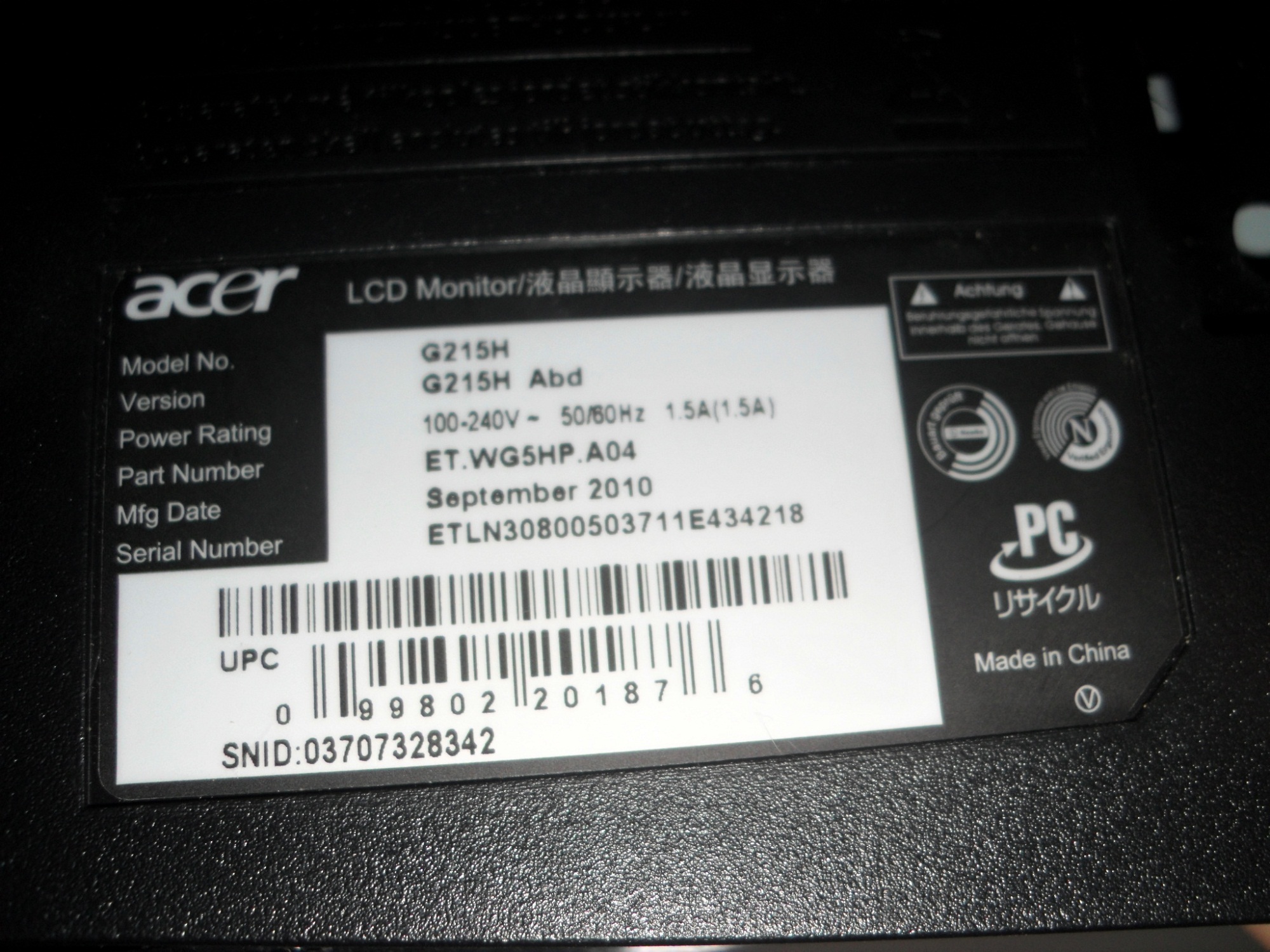

    Screen Turns on, only has a sight line at the top that shows the desktop or any kind of view. backlight does come on.
    sometimes the LCD will come on for a few mins and show the full screen then shut off to stand by.
    please note i picked this project up from someone else.

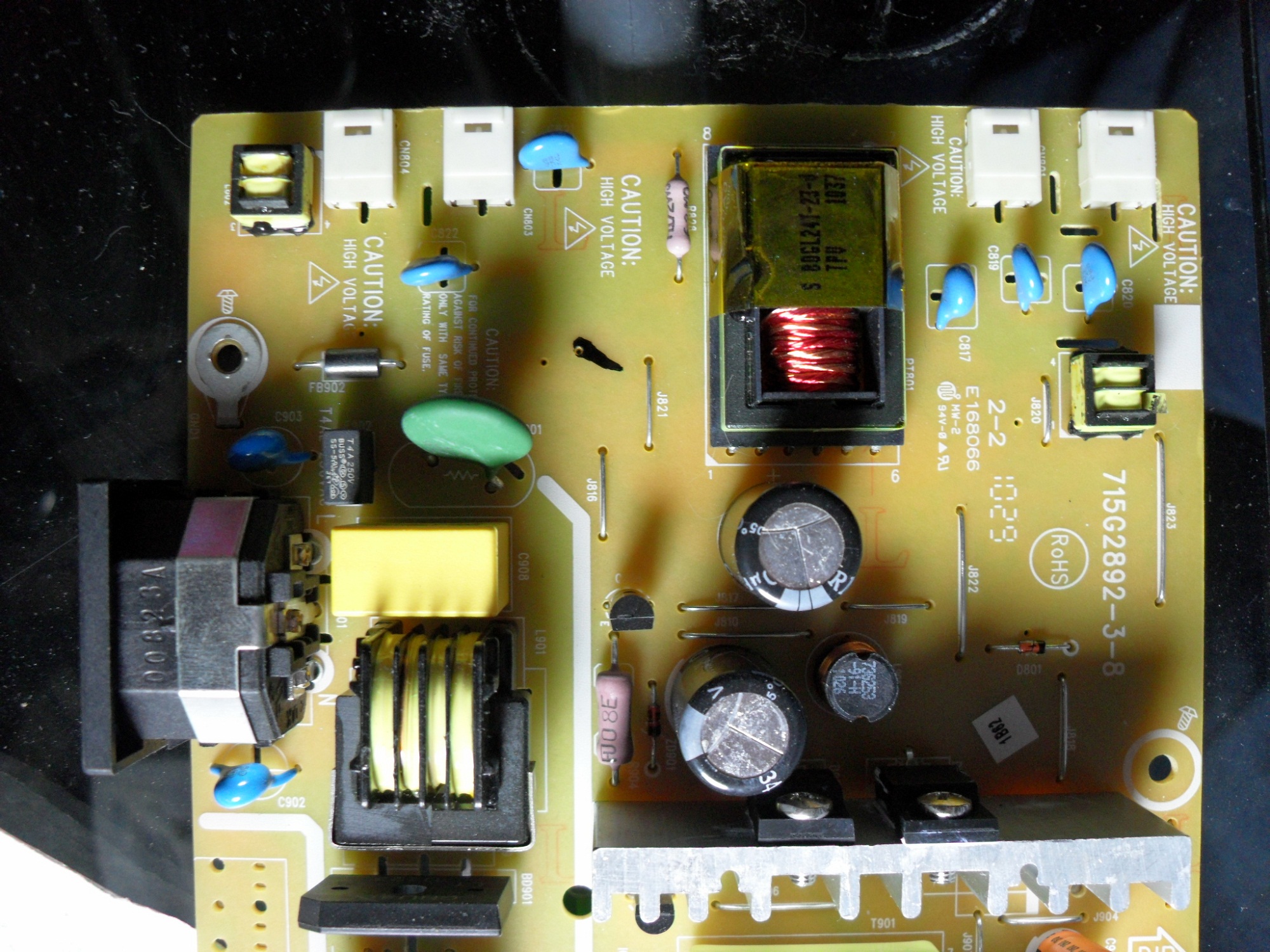

    It appears that you have a leaky capacitor on the main board. (c706, blue capacitor in the 6th picture)
    I suggest you replace it and also the the other blue capacitor. (c702)
    My schematic shows both are rated at 100uf @ 25 vdc. Replacement capacitors are available here: Badcaps.net

      Re: Acer G215H ABD
      replaced those LCD comes on and has like a blackish white background, no picture.

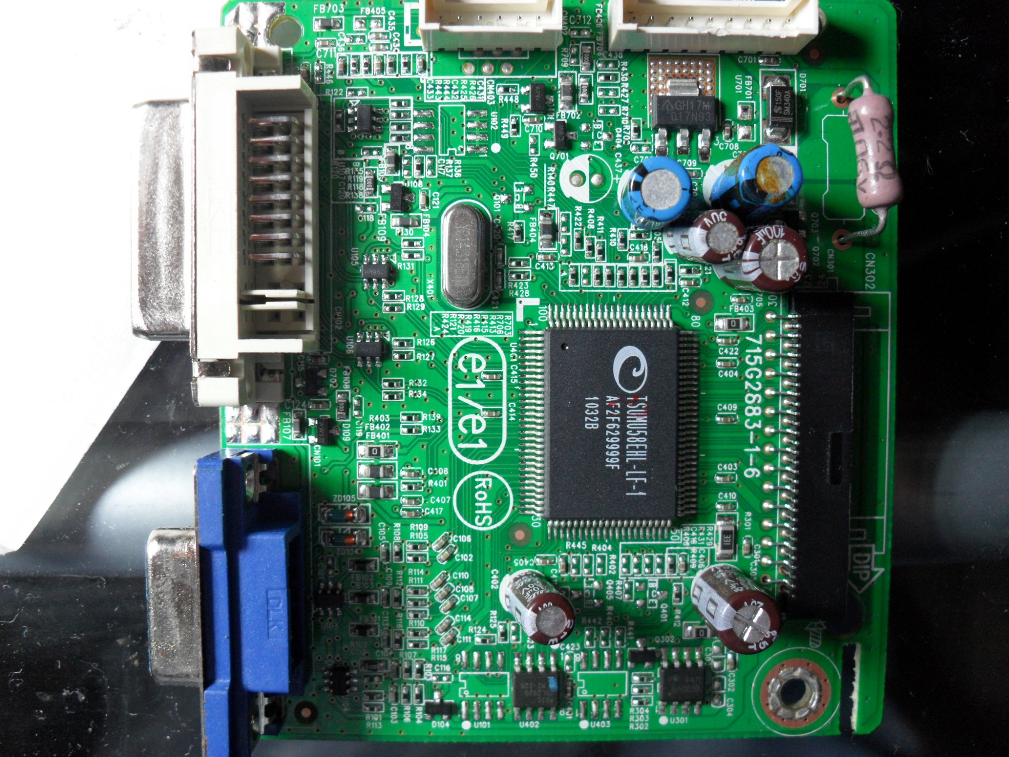

        Replaced every single Cap on the main board screen turns on and stays on very small line at the top that's white then fades out within a few secs and totally backlit screen. can't see options or dvi single or anything on the monitor.
