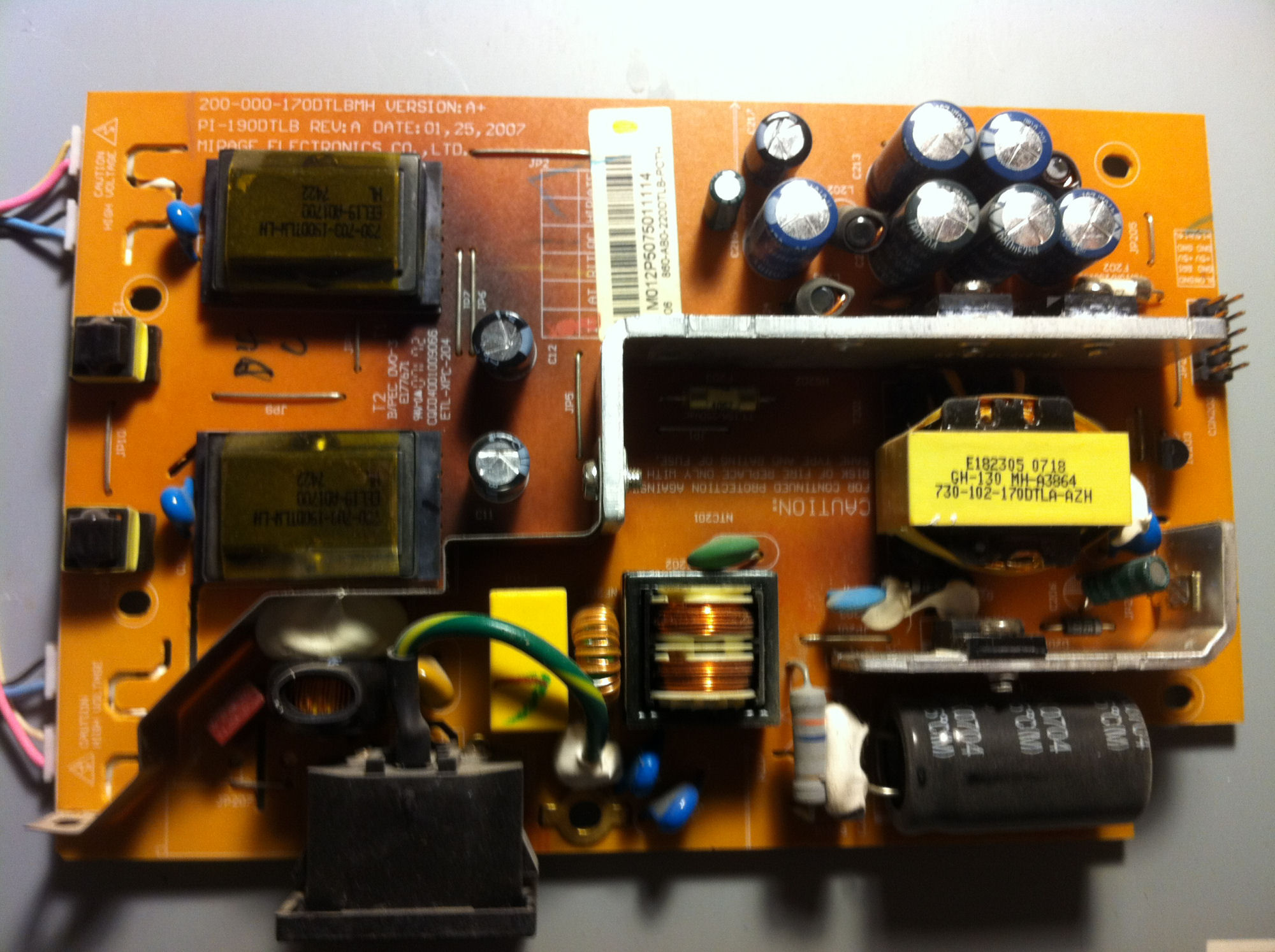

        OK. Here are the pics.
        Even i can see the burn marks on that power board
        Caps look like they are slightly bulging on it aswell.
        Thanks again!
        ThunderBob
        Newbie to Badcaps Forum
          Re: MAG LT2219WDb display probs
          You have at least 6 bloated caps. If the ones with the "K" vents are Rubycon, those should be good.
          Replace all the caps (regardless whether they are bloated) or not unless they say Rubycon.
          For replacements, we suggest Panasonic FR, FM, FC (in that order of preference). You can follow PlainBill's instructions at
          https://www.badcaps.net/forum/showpo...33&postcount=2
          edit: Don't forget to replace the small little cap by the yellow SMPS transformer. It plays an important part in the SMPS startup process. The biggest one can be left alone as it rarely, but not never, fails.

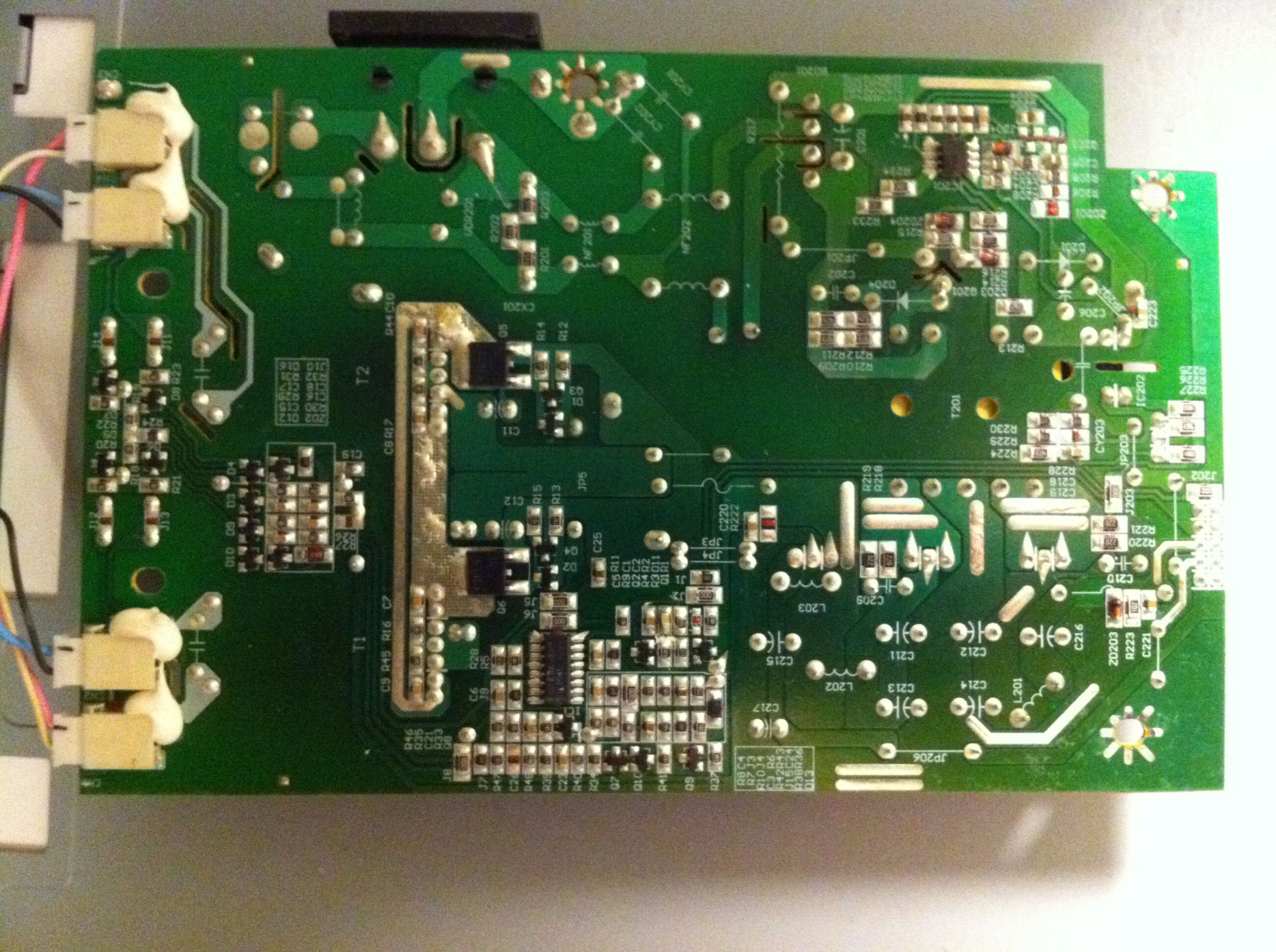

            The browning of the pcb is "normal" because there are two mosfets on the back of pcb that get hot during operation. Don't worry about the browning. Replace the caps and chances are the monitor will work again.

              The caps on the board read as follows.
              4x xunda 680uF25v TP0704 105'c (4 biggest caps)
              2x xunda 470uF25v TP0704 105'c (2 smaller blue caps)
              1x xunda 22uF25v TP0704 105'c (little green cap)
              Thanks again. I really appreciate this.

                  Ok, I purchased Rubycon and Samxon caps to replace the old ones and........
                  WORKING MONITOR!
                  Only odd thing is that the power LED no longer works. Oh Well i can handle that.
                  Thanks guys. Saved me having to buy a new monitor
