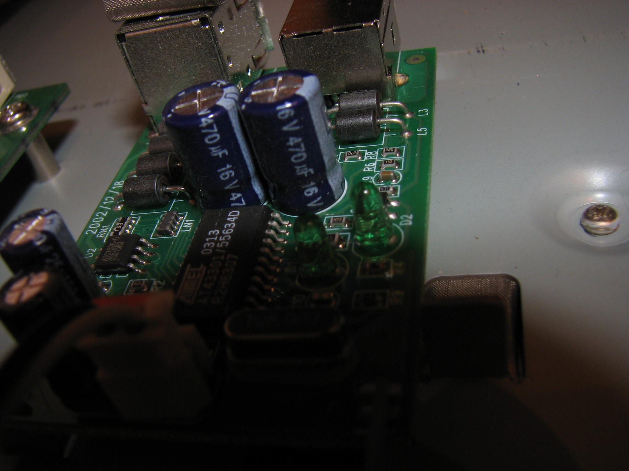

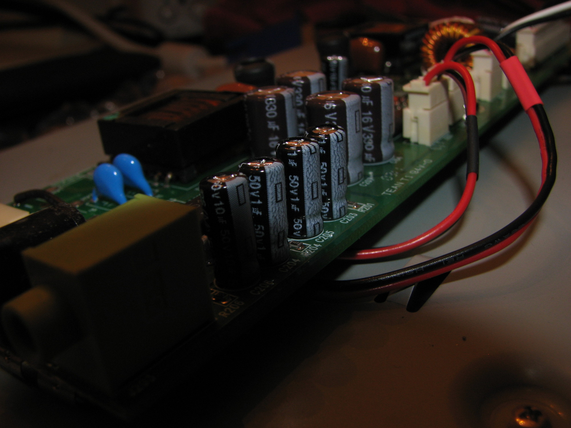

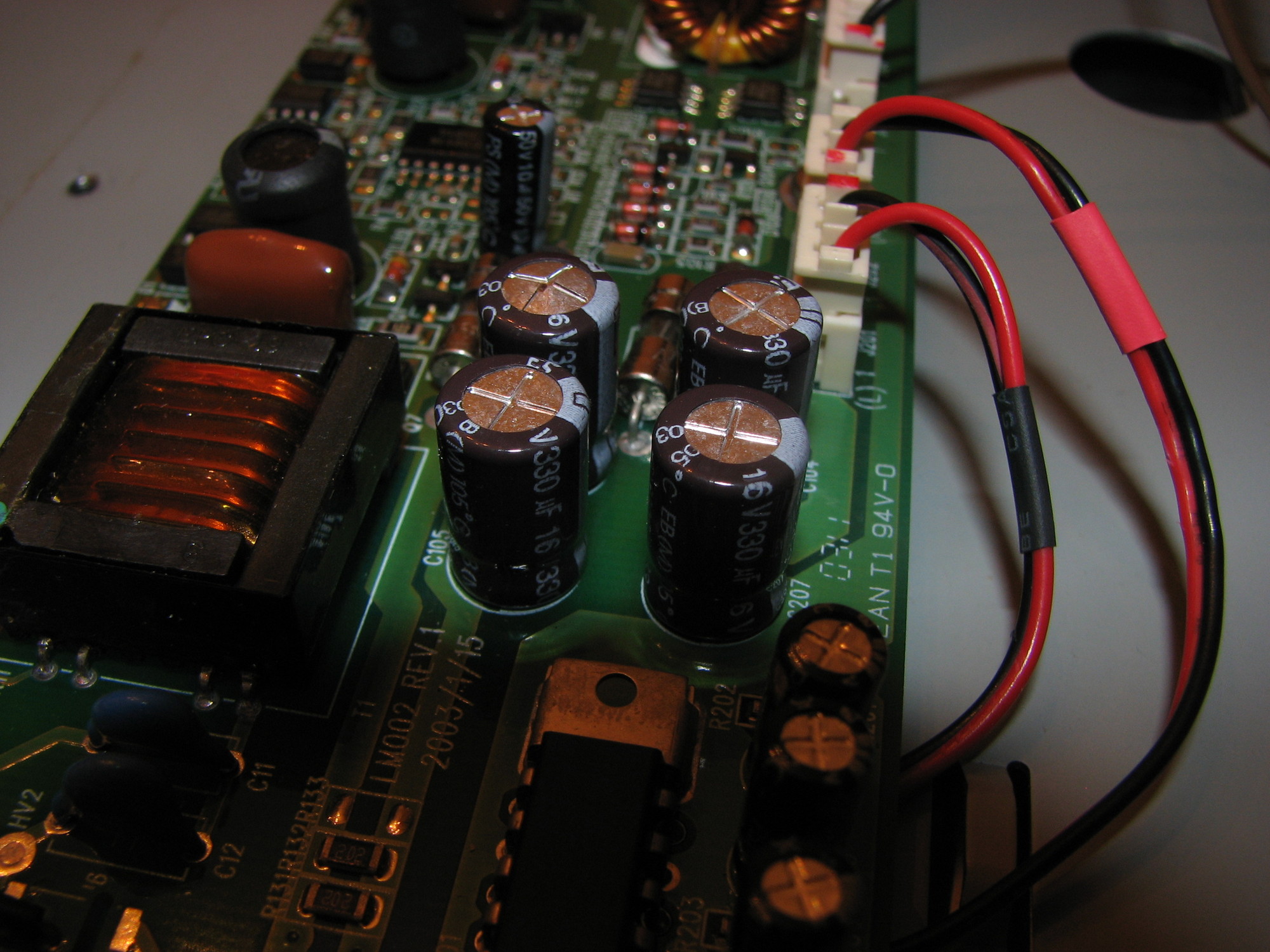

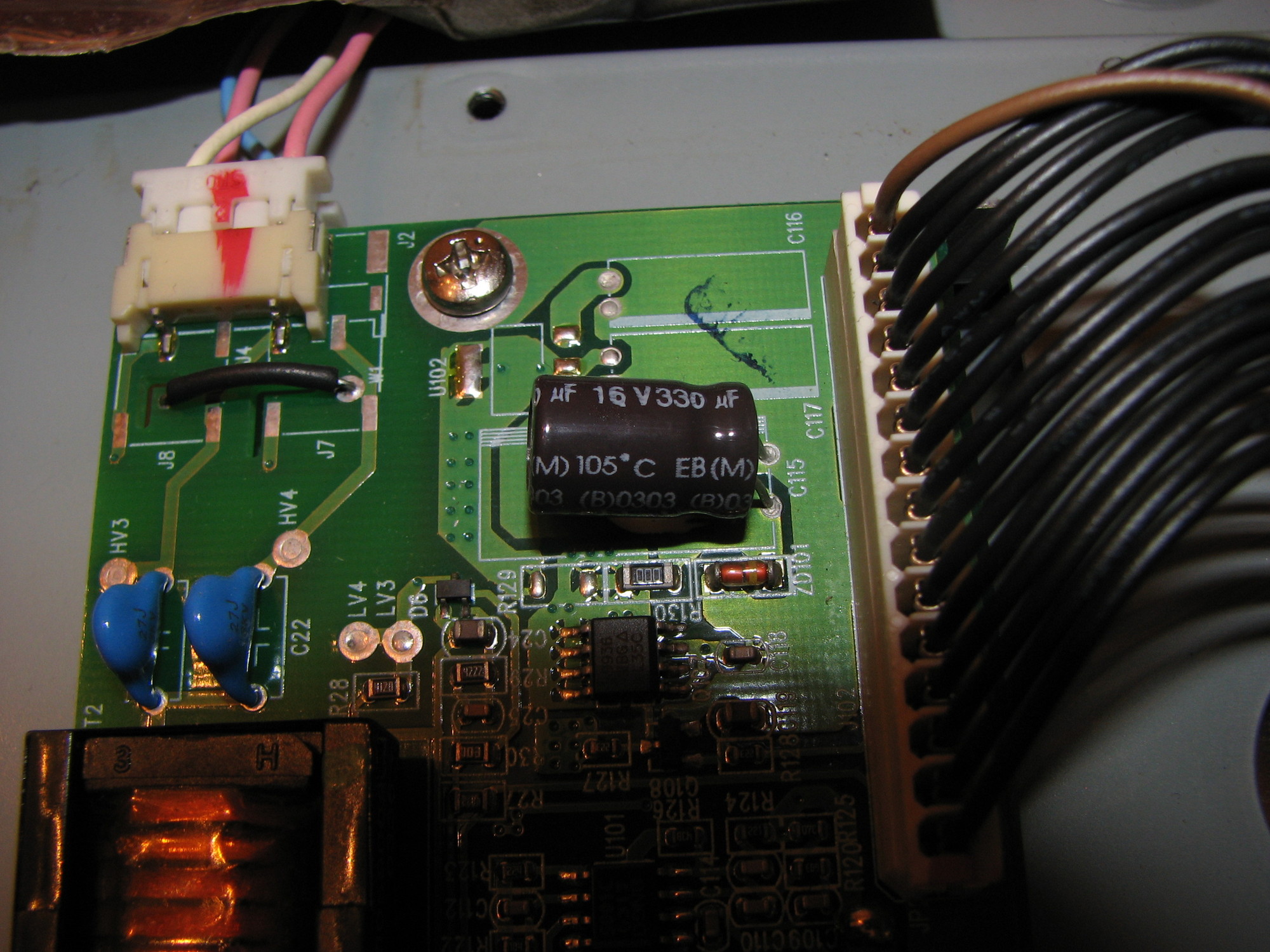

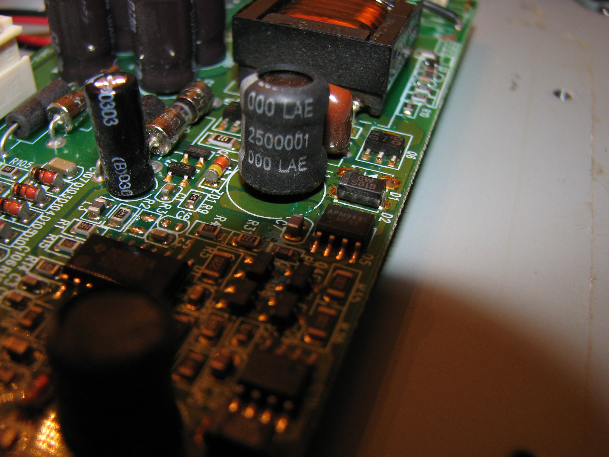

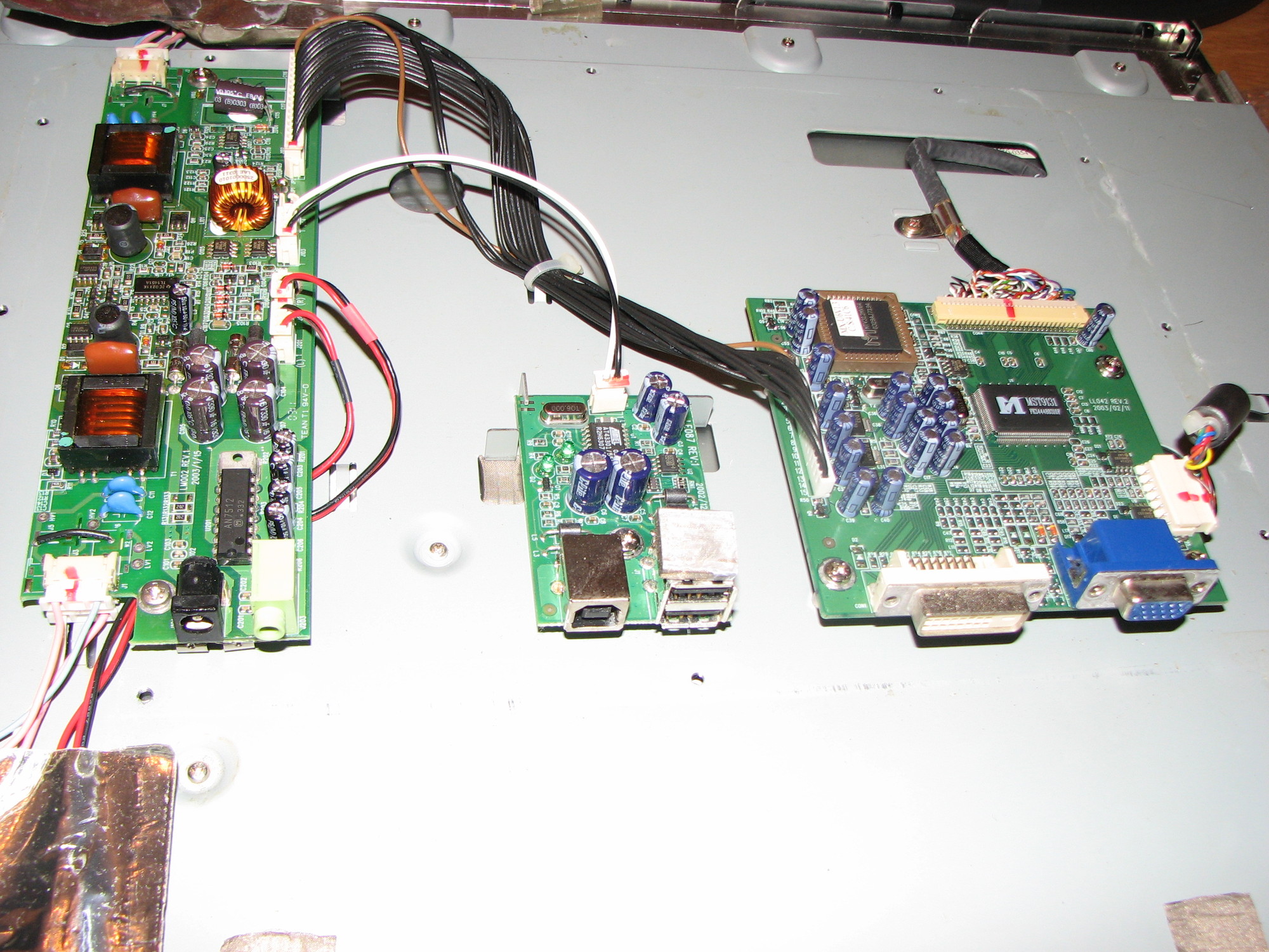

    Hey folks. I have a Planar PL191M here that has no backlight. I've verified with a bright flashlight that the display *does* work - the CCFLs just fail to light.
    Upon opening the case of this display, I found three boards - video, usb, and power/audio. On the power/audio board, there's a single vented cap (Elite 16V 330μF EB(M)), and what appears to be a blown fuse (a similar fuse on the same board appears to be intact).
    Are these enough to cause the CCFLs to stay dark?
    A list of caps found on the three boards of this monitor (all of them are Elite, except for two cans labeled '000 LFE 2500001'):
    Power/Audio:
    5x 16V 330μF EB(M)
    2x 50V 10μF PS(M)
    3x 50V 1μF PS(M)
    1x 50V 3.3μF PS(M)

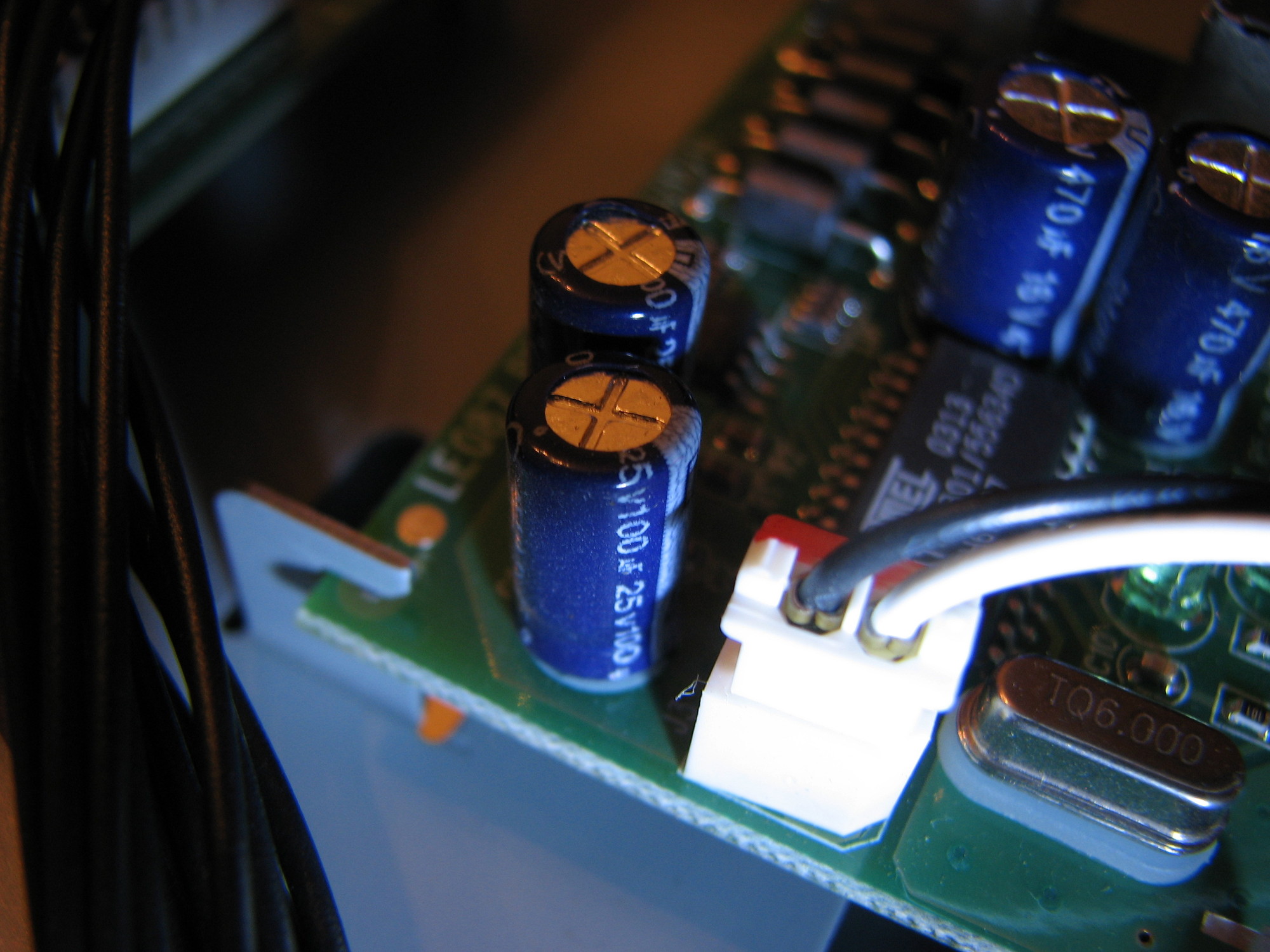

    USB:
    2x 16V 470μF SM(M)
    2x 25V 100μF SM(M)

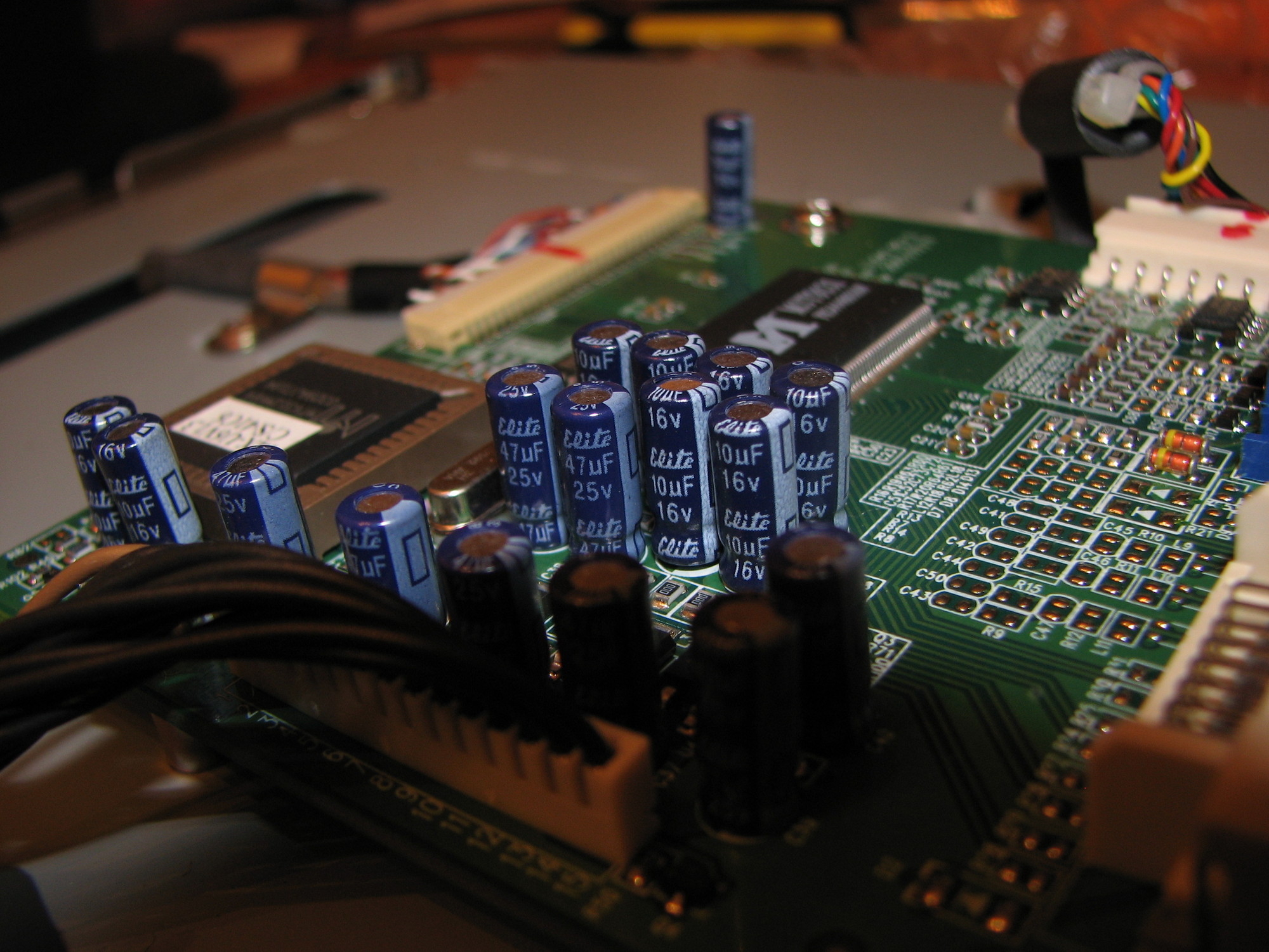

    Video:
    9x 16V 10μF SM(M)
    8x 25V 47μF SM(M)
    Should all of these caps be considered suspect? Should I only replace the 5x 16V 330μF EB(M)? Or should I only replace the one obviously failed cap?

    Yes, a single bad cap can cause the ccfl to not lightup especially if that cap is on the inverter board. The same for a blown fuse. A good fuse should measure less than 1.0 Ohm on your multimeter.
    Power/Audio:
    5x 16V 330μF EB(M)
    2x 50V 10μF PS(M)
    3x 50V 1μF PS(M)
    1x 50V 3.3μF PS(M)
    I recommend replacing ALL the electroytic caps that you listed for the power board. They all play an important part in the SMPS process and undergo a lot of stress.
    The USB/main board caps undergo less stress and probably can be left alone.

      I'm not sure what those LFE cans are (see the last attached pic to my original post). Those are located on the power board as well. Should these be replaced?
        If that is LAE and the pcb designation begins with the letter "L", that is an inductor. Caps begin with the letter "C" on the pcb board.

          Whoops, LAE - you're right. The PCB designations are L1 and L2, so I guess they're inductors. Thanks!
