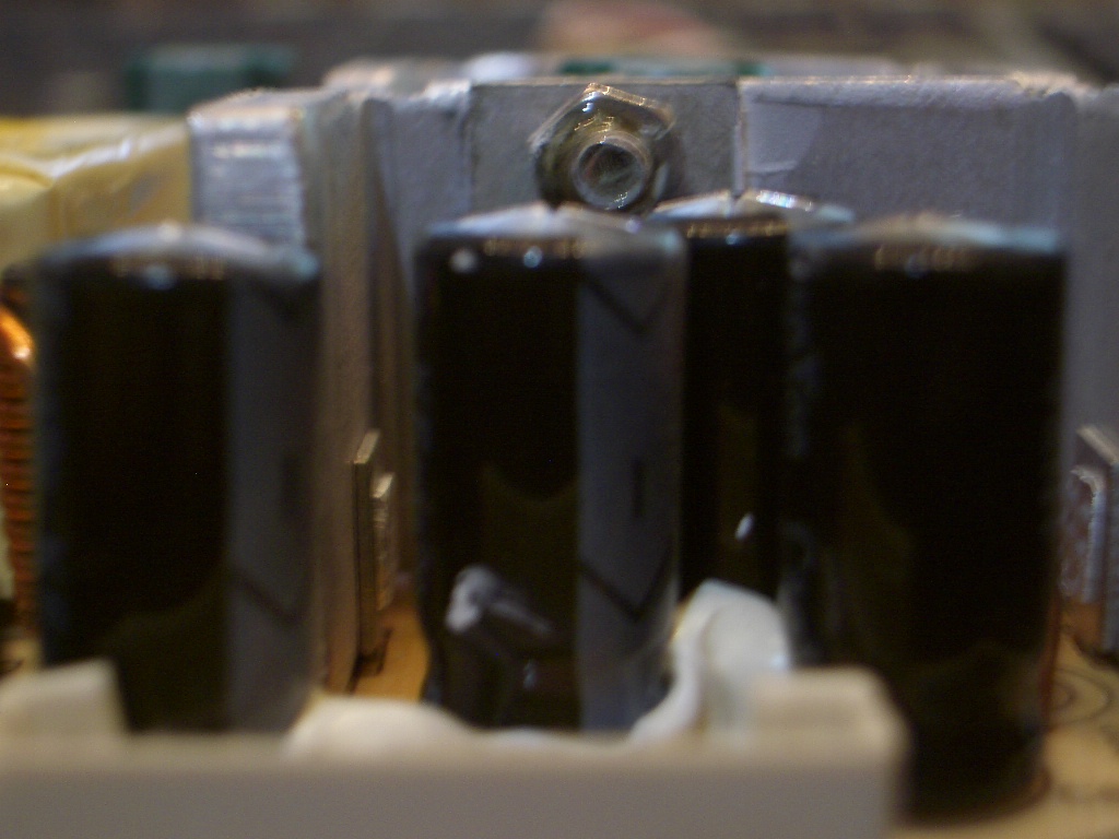

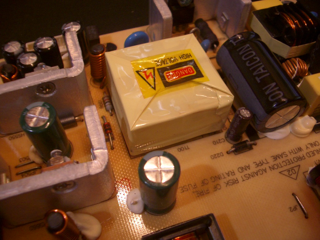

    I'm trying to help a friend of mine troubleshoot a 22" monitor of his. It's a Sceptre W22WG-Gamer and the symptom is that it will go into sleep mode but never come out of it. The way he described it he said the problem got progressively worse over time so I thought that sounded a lot like component degradation and asked him to bring it over.
    I took it apart (which was a slice of heaven let me tell you) and looking at the power supply it appears there is a bank of capacitors that are visually faulty (bulging at the top). I don't see any other signs of scorch marks or blown fuses (which wouldn't really go along with the problem in my opinion).
    The first picture (IMGP5489) is a close up of the bad back of caps. They say GapXon 470uf 25v and there are 4 of them. In the second picture there are four caps left from right:
    Big Green: 16v 1000uf
    Little purple: 33uf 35v
    Big sideways one: can't read it, wasn't going to replace it.
    I was hoping for just a little hand holding here on where to purchase and what is safe to substitute. I have soldering experience (no surface mount but this stuff I can do) and i'm not afraid to replace them, I just haven't done caps in the past.
    My thoughts are replace the bank of 4 and the other 3 just to be safe, but leave the big one alone.
    Any help would be great, I hope I was clear enough.

      Excellent summary and plan of action. Just a few points.
      1. I suspect the caps are CapXon, not GapXon.
      2. Yes, replace all but the big one lying on it's side.
      3. I prefer Panasonic FM or FC series capacitors; other reputable manufacturers have equivalent high quality low ESR caps. See the 'Which Capacitors Should I Buy' thread in the 'Frequently Asked Questions' section.
      4. We encourage you to update your profile to include your location. That makes it easier to recommend suppliers. For example, my preferred supplier is Digi-Key. They have good prices, and shipping a small order within the US is very reasonable - under $3.00. Their shipping charges are a lot less reasonable if you live outside the US.
      5. Check the 'Where can I Buy Good Capacitors' thread in the FAQ for possible distributors in your area.

          They are also different diameter. It looks like your capacitors are 8mm diameter. You should measure and check for sure. The 10mm caps will be wider and may have issues fitting. The 8mm FM will likely be a fine replacement, but to say for sure, you will need to let us know the series of capacitor as well. CapXon usually puts the series next to the temperature. So it will say XX105°C. 'XX' would be the series identifier.
          The green caps appear to be Taicon. They usually put the series in parenthesis i.e. (XX)

            Ok, The 4 CapXon all say KF105°C and the 2 large Taicon (you were right) say 105°C(HF)p. The little tiny CapXon (by the big capacitor I'm not touching) says GL105°C.

              There are two ways to do this. You can look up the specs for every cap on the board, then research which name brand cap has a series that best matches those specs. Or you can remember that most of those specs are 'better than' values. Reference point 3 in my earlier post. The monitor will work perfectly well if the ESR is a little lower, the surge current tolerance is a little higher, etc.
              Stick with Panasonic FM and FC, then concentrate on the critical parameters:
              Capacitance is a 'must match' parameter.
              Go up in voltage only if the correct voltage is not available and the higher voltage cap will fit.
              Compare the diameter and height of the originals to the proposed replacements. If two of the original caps are physically touching, you can't go with a greater diameter.
              The replacement caps should be no higher than the highest cap on the board. VERY IMPORTANT. You must be able to put the covers back on!!
