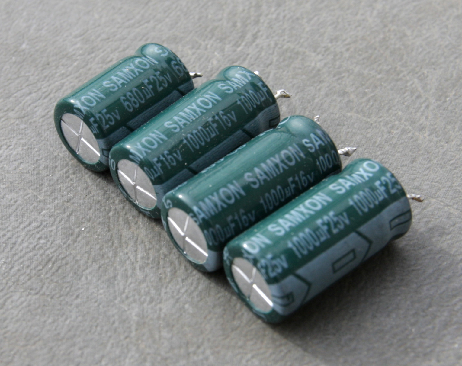

    • smason
      • 1652
      Re: LG 226WTX several seconds to white
      I'm jealous!
      For the newbies, pay attention. smason noticed one bulging cap, but caps do not have to be bulged in order to be bad.
      And it was just barely bulged. 20 monitors ago I wouldn't have noticed it, it was pretty subtle.
      I stared pretty hard to see it.
      'course green GFs are replace on sight anyway.
      36 Monitors, 3 TVs, 4 Laptops, 1 motherboard, 1 Printer, 1 iMac, 2 hard drive docks and one IP Phone repaired so far....
      • smason
        • 1652
        Here are 4 of the caps, bloating just barely noticeable
