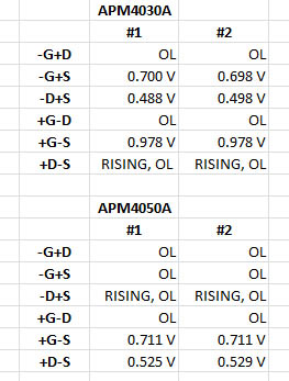

    Blue led on 24.44V, led off -> Decreasing V
    Repeating on off hits 24.44V, decrease, 24.44V, decrease ...
    I made this table using diode check. MOSFET legs by datasheet goes G,S,D
    OL when out of range. No shorts between legs.

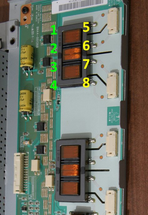

      Re: Samsung 245b Plus
      MOSFETs look fine.
      Transformer checks:
      With the 6 lamp connections to the right >>>
      Measuring the resistance from pin to pin should match on all 3:
        light connector side 1-2 3-4 (?) shows:
        1-2 1.7k
        2-3 1.7k
        Maybe I'm getting it wrong..
        other side
        5-6 10-20M keeps changing whenever I read resistance
        6-7 near 0
        7-8 10-20M keeps changing whenever I read resistance
        5-8 10-20M keeps changing whenever I read resistance
          No. You got it reversed.
          See attached pic.
          Try a lower scale instead of 10-20M. That's too high.
            Not much change..
            Applies to all 3 units:
            1-2 starting from 12-15M and rising along time
            1-4 3.6-3.9M
            2-3 ~0
            3-4 starting from 12-15M and rising along time
            5-6 ~1.7k
            7-8 ~1.7k
            Using lower range on 1-2 and 3-4 results OL.
              Well, I can't imagine all 3 transformers being bad at the same time. The ability to read 1-4 and get ~4M, but not to read 1-2 or 3-4 and get ~2M is odd. Probably attributable to the meter, not the transformers.
              At this point I would recommend recapping the PSU complete. Without the ability to apply 24v to the inverter, and because the testing you have done does not point to any failure, that's the path I would follow. It could be nothing more than a small voltage discrepancy on the 24v and the inverter is shutting down because of it. Be aware that the 5.3v is derived from the 24v.
